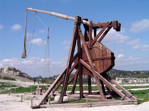

Picture from Carlos Felipe's link.

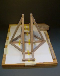

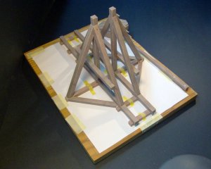

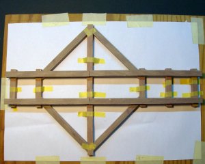

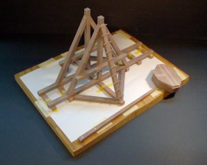

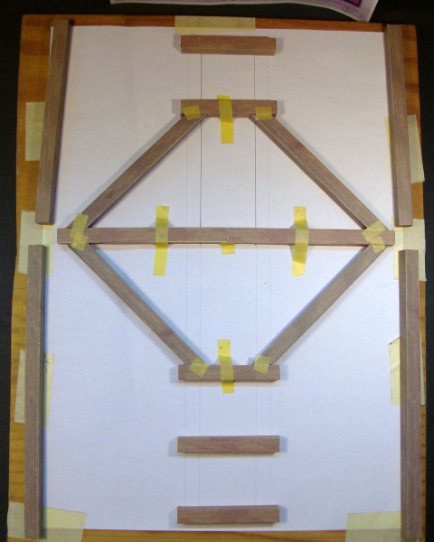

The author provides a jig to help assemble the model straight. This proves to be vey helpuful, as with time, parts tend to warp as they are quite long.
If you build this model please avoid my mistake: I was so excited assembling the beams I forgot to leave the face with the paper joint facing down. On those I didn’t the look is terrific, those I left the joint up look… terrible.

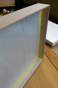

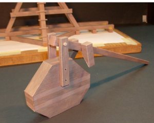

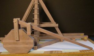

As suggested I added weight inside the counter-weight. Reinforced the box with thick cardboard and then plied a piece of lead sheet and taped in place. The arm swings perfectly acted by the weight. Not as violent as I imagine it would have been in the real thing that was able to throw a 300 pounds stone some half-mile to pound stone walls. It must have been nerve wreaking to the besieged population to listen the slow smashing and crumbling of the walls.

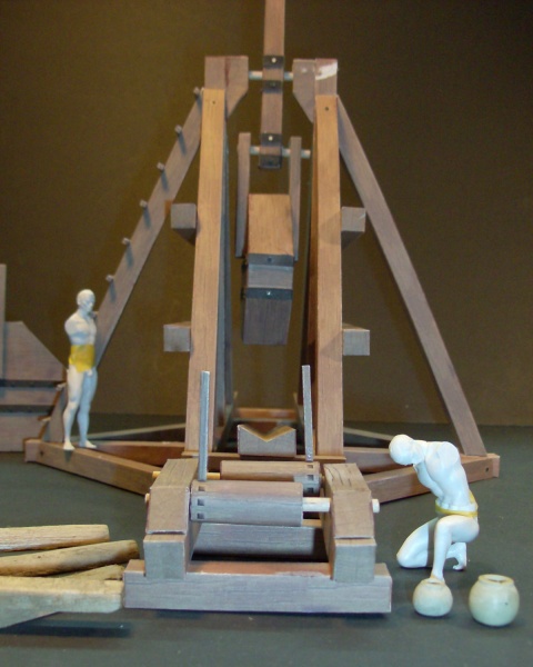

I thought to add some figurines to give a notion of scale to the machine. Used Preiser’s 1/24 nude figurines, an excellent base for scracthbuilding. Initially two, now narrowed to only one (still unfinished…).
I had a problem assembling the axle where the counterweight swings. The hole I drilled thru the assembly (the two supporting arms of the counterweight and the arm) is not correctly level, so it needs a little tweaking to assume a level position.

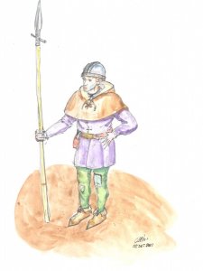

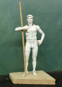

I simplified the scene and intend to use only one figurine. The initial sketch depicts a rookie on night watch, before the trebuchet is even fixed to the ground.
The pose of the chosen figurine differed a little, so I’m working on it with a pose I remember to see in my youth when traveling to rural areas. A relaxed, confident, almost defiant pose. The pole was used as a defence weapon as late as the 40s of the XXth century. In popular fests, brawls could happen among the youth of rival villages…
Actually there was for a while an attempt to turn it into a martial art, as a sport, but it died out.

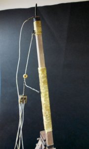

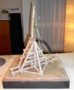

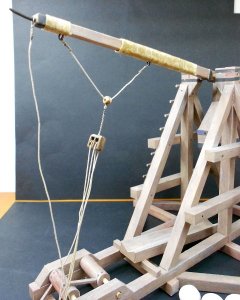

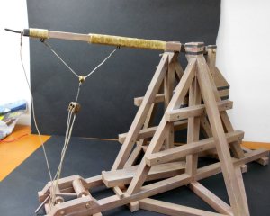

I had a lot of doubts about the rigging and not yet convinced. I just went the Hollywood way: “making it look good”…
The author proposes a sheave traveling on a rope. There is even a photo of a life-size model rigged that way, but it is hard for me to believe if it really worked .
Then the model comes with two winches. Again there’s a life-size model done that way. Initially I thought it would serve to distribute the tension, but the rigging goes from one winch to the other thru a double- sheave (is this the correct expression?), but that also doesn’t make sense to me. One unrolling whilst the other wrap? I’m not a sailor, I cannot understand these matters.
I made a new sheave with balsa and used a jewelry prop in wood to slide in the arm’s rope.

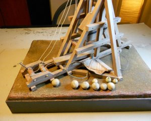

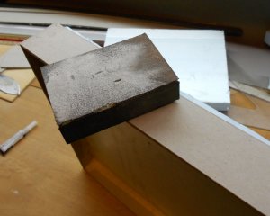

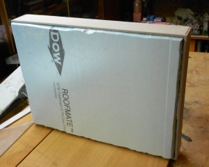

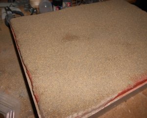

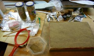

Building the base. I think the photos are self-explanatory. A piece of roofmate framed with heavy cardboard.
The ground cover is a layer of Das-Pronto clay, a rather disappointing material that when dry turns into pinkish red, not clay (at least the one I’m familiar with).
To seal the cardboard from moisture and give a little texture I applied two heavy coats of PVA glue. Brushed on and then hammered with the brush bristles on the vertical. After a light sanding, a cheap spray bought in a convenience store made the final finishing.

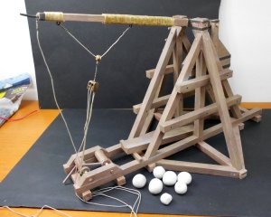

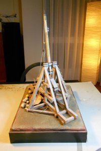

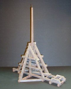

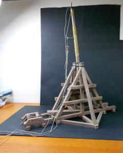

The finished model still without the figure. It is over 40cm tall (15.75’).

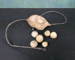

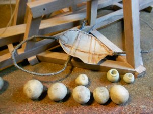

The sling was done with lead foil. the author suggests a net, but as lether was also used, I went for the easy way...
Now is missing the figurine...
Wish all a Happy New year.
