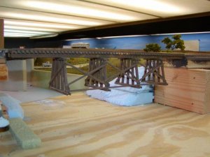

Speaking of trestles...! Is this a case of the ground fitting to a prebuilt trestle?? Is that long beam at the bottom permanent or is it there just to hold everything in place 'till it meets the ground? Good looking trestle.
Gus (LC&P).
Probably the best way to build a trestle is to either build it first, then make the site fit the bridge, or build a well-planned site, and make a bridge to fit it. While my bridges over water were fairly well planned, my two steel trestles were built to suit the scenery (landforms) which was already in place, but had in no way been prepared as bridge sites. That's why the length of the legs on each of the towers varies so much on this bridge, which is probably not very prototypical. This area will eventually become heavily overgrown with trees and brush, so most of the visual problems should be hidden.
These bridges were also built on site, with no real provision made for installation. The bridge in the background suffers from the same problems as the one in the previous picture. Footings for both were made by stacking layers of .060" styrene sheet, each successive sheet cut larger than the one above it, until each was tall enough to reach the ground beneath each leg. The sheets were cemented together with lacquer thinner, then the sides were filed with a large mill file until the properly sloped sides were achieved. Then, using an X-Acto knife, the bottom of each footing was carved to suit the terrain upon which it was intended to sit. The bridge in the foreground sits on cast plaster piers and abutments. While each abutment is particular to this site, the piers are all similar except for their height. Because of this, only one mould was made, and it was designed to be used "upside down": The required height (plus a little extra) for each pier was marked on the inside of the mould, then the mould was only filled to that point. That "little extra" on the bottom was an allowance for carving the bottom of the finished pier to fit the site. Both of the abutments for the bridge at the rear where also cast in plaster (only the one to the right is visible), but this was done right on the layout. While the cast piers were easy and enjoyable to make, the cast abutments were not as much fun, and the styrene footings were tedious. Next time, I'll plan things out more thoroughly before construction.
On the bridge in the forground, the short vertical steelwork immediately above each pier is keyed into a depression cast into the top of the pier. This helps to keep the bridge, which is removeable, in line.
