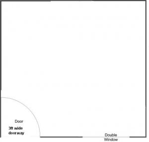

Hi,
Calling all trackplanners...... I need some help. I've hit a brick wall in trying to come up with a trackplan. I've done the Duthers questions (listed below) and have also attached a picture of the space I'm going to have avaliable. Anyone with an idea, please either give me a weblink, or a picture, or a napkin sketch, or something. :)
Railroad Name: Cosynook Railway
Scale: N scale, Std gauge
Era: sometime. I like UP, not a specific time period.
Region: North America.
Railroad: Union Pacific
Space: 3m x 3m room, with insulation on walls. This is approximately 116" x 116". Door opens inwards (std 3ft door). There is a double window in the wall with the door. Space is totally open. Nothing else in there at all. Lighting is 2 x double tube florescent lights (4ft length tubes). Bench work will be built to accomodate the layout. I will do it with a double layer of foam on top, for scenic possibilties.
Would like single or double main line, with continous running, as well as shunting possibilities. Around the room or U-shaped (walk in) ideas. I would also like a space for a desk to work on, for doing building's etc. Doesn't have to be too big. No double deck layouts. I'm 6ft 4", so about 3" depth is maximum.
desired minimum radius: 12"
absolute minimum radius: 10"
desired normal train length: 10 to 15 cars
minimum normal train length: 8 cars
maximum acceptable mainline grade: 3%
maximum acceptable grade: 3%
primary track system? flex
couplers/uncoupling system: couplers are a mix of rapdio's and microtrains. Slowly converting everything over to microtrains, as finances allow.
DCC or DC? DCC
Willingness to pay extra for walk-around control? Yes, already in the christmas wish-list.
Willingness to build liftout, hinged bridge or gate? No duck unders, but a swing bridge will be made for around the room.
my favorite aspects of model railroading are (list your top up-to 3 in order; 1, 2, 3)
operation of a scenicked layout
building structures
building benchwork and laying track

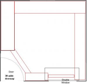

Forgot to add this to the previous post...
Here is an approximation (not to scale) of round-the-walls benchwork. I put your desk under the window, which is crossed by a bridge (or even just a narrow section of benchwork) in order not to block the light.
A really nice round-the-walls layout that I have visited on several occasions is Mike Hamer's Boston & Maine:
http://www.ovar.ca/Mike Hamer/Hamer.htm
http://bostonandmaine.blogspot.com/
His room is a little larger than yours, but you get an idea of what can be done. He employs a duckunder instead of a swing/lift gate, but you might get some ideas from his pictures.
You can put some storage or extra work space under the layout. If you put it at 48" high or higher, you should have plenty of space above the desk.

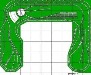

A potential trackplan
Hi all,
Did some doodling, and have come up with this option so far.
Squares are 12" in size.
Overall view shown.
Comments / suggestions?
That looks interesting enuff Evan although your robbing yourself of scenery possibilties around the backs unless the rear rails will be in front of hills elevated . Are you thinking of having some tracks elevating like up an incline with bridges across gorges or rivers?I think your making the right decision with around the wall :thumb:

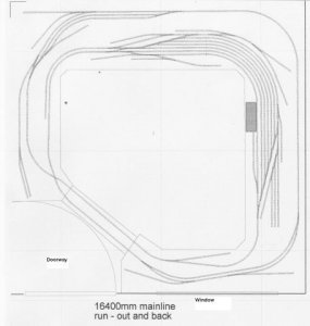

Final plan
Hi,
After much scribbling, loads of paper / questions / comments / books being read, I got to a final trackplan. One of the chaps at our club drew it, and I am proud to present it here. :)
The room preperation starts on Monday (buying supplies this weekend).
The plan is attached. I haven't decided yet on the placing of rivers / mountains / city etc etc yet. That comes this weekend.
Any comments / suggestions welcome as always.
I like the new plan. It shows something about the effect of a side entry. With turnback curves, a once-around plan goes twice through the scene. With the gate, it takes a twice-around to go twice through the scene. A good double-ended yard, but I have one concern. The total car capacity of the yard exceeds that of all other sidings and spurs on the layout. This is far from ideal for way-freight operation; it suggests that most switching is done at the main yard. If that's what you want, then this plan is good.
