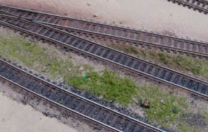

I say as far as what colors go where, just put em anywhere! Look at the photo's on the last few pages of this thread and you'll see what I mean:
http://www.the-gauge.com/forums/showthread.php?s=&threadid=8886&perpage=5&pagenumber=23
Look at the difference in color betweenthe two exposed tracks in the 4th pic down here:
http://www.the-gauge.com/forums/showthread.php?s=&threadid=8886&perpage=5&pagenumber=24

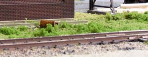

And if you haul grain, don't forget a little greenery here and there :D

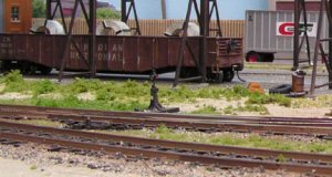

Originally posted by spitfire
As per Fifer's suggestions, I will be running a line of grimy black down the center of the tracks, but for now, here's another shot of how it looks.
Have you got a tea strainer? Just get a piece of black or grey chalk and run along the centre of the track using the tea strainer to powder and "dust" the oil/grit/dirt on. I use a range of "dirty colours" (black, grey browns, and even white!!) :)
