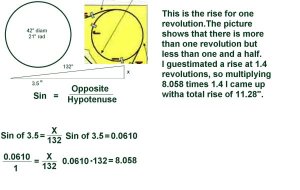

Here's what I came up with. The formula should work with any scale.

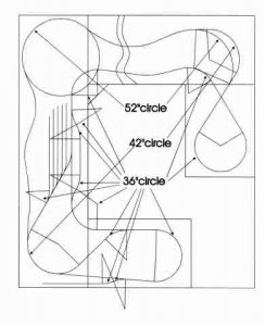

You got a interesting formula there Clark. And a rise of 11.28" would be accurate if the rise started at the edge of the circle, but if you look closely at the plan you will see that the rise starts before the track enters the circle. Taking this additional rise into account then the total rise will be 12" or better, depending on how much ramp leads up to the helix. This way there is room for the return track that skirts around the front edge of the mountain through a tunnel.
So the rise of track depends on the elevation of the helix.
Good point though. A fine detail that I had to work out when I planned it.
Thanks for the interest. :)

You are absolutly correct. My formula only takes account of the helix itself so any rise in the approch track or the exit track would be added.
