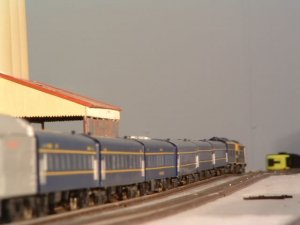

Guys,
To the eye? It looks perfectly straight, flat and no ................. bumps. I used a level and long steel ruler to ensure it was straight and flat and it's on roadbed, and flat chipboard base with a solid support. But look what telephoto will do to it!! (Just forget the photo quality. Not enough light to get a good depth of field using a high F stop.)
AAAAAAARRRRRGHHH!!!!!! Should I be fired as Chieft Tracklayer of the Garahbara Railroad Co??? :eek:

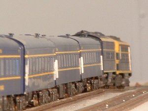

And here it is not so zoomed in, but still zoomed. (and still wonky lookin' track) Again, forget the pic quality, but the concept is there. That's what I'm after, really, is that long, straight, dusty, desert heat haze look for Garahbara. But that track work is a bit wonky!!! hmmm...... I ain't glued it down yet, just track pins. And it took me hours to get it that level and straight!! Is straight level track a no-no??? :eek:

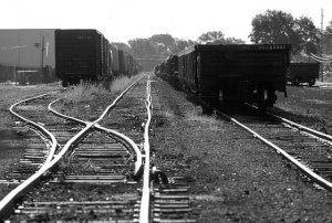

Looks good to me. I don't know if I've ever seen straight and level track in the real world. Heres an example got this from The Web Yard. Almost thought it was track I laid. :D

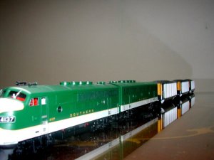

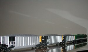

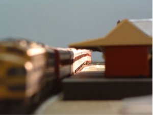

took these pick's on a glass coffee table with a cheap'o digi camera after seeing your pictures i tryed to get the right angle, the trains are HO and measure about 3ft in length if its not your camera lens that's at fault it may be moisture or heat to wood or track, like the others have said what looks more natural.

Humps and dips like that (second pix) will cause random decoupling if you are using Kadee couples. Fred
How does the chipboard look if you lay a straight edge on it now? I'll bet it's to blame. It's very unstable. All those chips expand and contract in different directions. Blue foam is very temperature/humidity stable and not likely to do this. Track, cork roadbed, liquid nails and such are also stable. I have a portable with no gaps cut in the track that survives swings from Indiana's summer highs of around 100 F and 90% humidity to winters 0 F and near 0 humidity without a problem. If you can get the foam over there, I would start over :(
