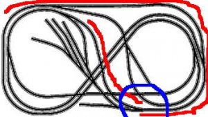

Hi all,
Below is a picture of my layout. I'm wondering how to attach the feeder wires to the track while maintaining separate rail polarity. Along "S" curves, the inside rail becomes the outside. How do you handle the polarity change? Assume rail A is red, B is black. After the S turn, the colors would change and then later down the line the colors won't match. Won't this cause a short? Maybe my pic will explain it better. Look at the top middle part.
Any help would be appreciated.

Yes it will cause a short,Isolate before and after each loop and make that a seperate section.You could either get a reversing unit,or if using DCC and have a booster hook it up for a reversing section or the old fashion way Double pole Double Throw Switch.
If you trace carefully, and you have no additions to the track plan "Granite Gorge and Northern" from the Atlas series, you will find there are no reversing sections. The track plan was deliberately designed that way. The layout is designed for the 2 figure 8s to be operated in opposite directions. The apparent "reversing sections" are actually crossovers from one figure 8 to the other which put the train in the right direction on each figure 8. Try as you might, you cannot reroute the trains to get them to run in the opposite direction on the same figure 8; doesn't matter which direction you start in.
What I'm saying can be changed by adding normal crossovers between the 2 figure 8s. Then you will have reversing loops. But unmodified, the track plan has no reversing loops.
yours in wiring
Looking at the pic,the left side inside turnout should be insulated from the track that goes to the left and travels to the Right side inside turnout (insulated at that turnout also and make it a reversing section.Also insulate the same switch on the left hand side from thr turnout where it is going straight then over to the right side outer turnout and insulate it and make it a reversing section also.I might be wrong on this,but that is just what i see on this track plan.
Harold, I don't want to beat a dead horse but no matter which glasses I wear, the left turnout taken straight will make a complete but folded circle. If the same turnout is taken diverging it makes a crossover to the outside track. Maybe a poll could be taken. This is one heck of a track plan. Joe hamr
Joe,take the inside track and follow it thru the turnout taking the turnout to the right side to the inside turnout on the right side and to me it seems to reverse the train direction to the outside track.Am i seeing this wrong¿
Help us guys, are we seeing it differently or what ? The left turnout taken diverging is not reversing direction but transferring the train via a folded figure eight seemingly to Change the direction but continuing on to the original starting point does not . Help, Help, Helphamrhamrhamrhamr
Well, if you want another opinion, with my glasses on :) I traced all of the routes with my cursor three times and always return to my starting place heading in the original direction. I'm not seeing any reversing loops although that inner loop that twists over itself on the right side gives the impression of one.
Ralph
I pulled out my Atlas layout books. Their wiring diagram does not show any reversing sections except the optional turntable in the yard.
John Armstrong - designer of most of the Atlas layouts - said in a sidebar in the older editions of his book, "Track Planning for Realistic Operation", stated that there were no reversing loops to keep the wiring simpler. Adding crossovers between the 2 figure 8s would enhance operations but would have complicated the wiring with reversing loops.
Of course, if you are using DCC, the only real impact of designating reversing sections in the layout is the extra cost of the auto-reverser which will never be used as such. :) In DCC you are going to insulate both rails anyway where ever you decide to set up separate blocks or power districts.
my thoughts, your choices

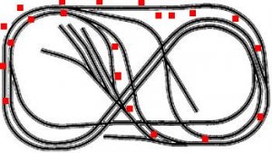

Is your track down?? Take a box car, put a piece of sticky tape on one end (this is the front) pin a piece of paper to starting point beside your track..push the box car around and if you return to the same spot with the sticky tape at the same front end, you do not have a reverse. Years ago I went to a dollar store and bought couple packages of colored push pins..one pk green the other red. Put your thumb on one rail (this the red track) your first finger on the other rail (this the green track)..work your way around the layout, every 3 to 4 feet or so (and before and after every switch) put in a colored push pin to the appropritate spot beside the rail. Once you are done or along the way you can see if you are going to have any shorts and can make adjustments..Once the layout is done this way then you can start putting in the feeder wires for the appropriate sides of the rail to maintain the correct polarity.. this can also work if you have a large enough paper copy of your layout..Ron..
Thanks for the replies everyone. I didn't mean to cause you any headaches :) For those of you who don't see any problems, where are you starting from and which direction are you heading? Clockwise? I've gone over and over it and still end up having black meet red on the same rail, either at the right upper or right lower section of the layout. I'm obviously missing sometime obvious :oops:

Here's where I see the most apparent problem. What am I doing wrong???? The blue circle is where I get a short every time. Now where's that 4 x 8 oval plan at... 8-) I'm going to try the colored pin idea tomorrow and see what happens. Thanks for the suggestion Ron.
Jayson
