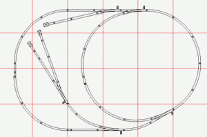

I was planning on building a permanant layout something like what is pictured here....The type of track to use and where to get it is my first roadblock. For the track I have listed, here is the list of materials:
(5) Atlas 9.0 in straight
(2) Atlas Mark III #4 left-hand turnout
(19) Atlas R-18 30° curve
(3) Atlas Mark III #4 right-hand turnout
(1) Atlas 2.50 in straight
(1) Atlas 1.25 in straight
(2) Atlas 3.0 in straight
(1) Atlas 1.50 in straight
(1) Atlas R-18 15° curve
(2) Atlas 6.0 in straight
(3) Atlas #43 track bumper
I am assuming Atlas is the brand of track...where can I purchase these pieces? As far as I know, there is no hobby shop around here where I could get this stuff. How about internet ordering?
