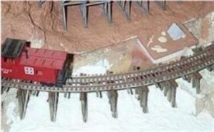

I just glued Atlas flex trak with plastic ties to a wooden trestle using Liquid Nails for Projects. I dabbed a very thin layer on the underside of the ties and then clamped it to the trestle top plate stringers overnight. Worked great.:thumb:

Oh my!!
Doc Holliday said:
.......... Liquid Nails for Projects.
And I always thought the Liquid Nails I read about in track laying, was referring to the construction adhesive and went and used it to lay some of the track on my diorama..worked but it was a bit messy but I don't think the track will ever move.
