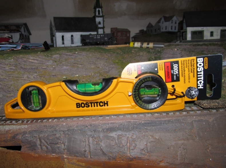

While shopping for some stuff for my home railroad rebuild at Lowes, I stumbled across a second indispensable tool ; this little level. it has an adjustable level on one side. here I have it on the upgrade at Tom's bend, between Murray (a undershelf passing siding) and Crooked Creek, my Milltown. this grade is nominally 3.3%, and is to be equal to the ruling grade on the mainline of my rebuild should all go as planned.
I can set this level on the grade, adjust the adjustable level to center the bubble, and I can use this level on roadbed elsewhere to check to insure I don't exceed this grade elsewhere. I started my other railroad trying to match Bumpass's 6% grade, and math errors and carpentry errors eventually pushed the ruling grade up to 8.5%. between figuring my grades in metric units to simplify the math, and using this level I should be able to be much more consistent with my grades.
with the use of these two tools , I'm hoping the rebuild of my current railroad will allow my rod locomotives to run the lenght of my mainline, allow longer trains, and not cause as much pannic with visiting enginerers as they face an 8.5% grade for the first time in thier life.

Bostitch makes nice tools. You can learn much with a sine bar, but this takes care of all of that. The only problem I see is that you must make sure you are taking you reference point from a plane which is established to a flat in a referenced Gravity field, not the table, maybe the floor. Thar just means that you can't trust the zero point if the tool is set on the track. You have to know what the "0" plane is relative to gravity. You could measure 8 degrees but really be at 11 degrees relative to a flat plane referenced to the relative gravity. :)
this is true if you are building new construction, and wanting to build your grade to a certain specification.
In my case, I am adding to an existing layout, and am attempting only to insure that any new grades are equal to or more gentle than the grade I have selected to be my ruling grade. in this case it is nominally 3.3%, but it was built a long time ago, and figuted with english measurements, which leaves a lot of toom for a mathematically challenged dislexic like me to intoduce error.
I have learned a lot since then. with my current tools I trust I can do a lot better. When I rebuilt my downstairs bathroom on my 130 year old farmhouse, I had to replace the outside wall that enclosed a former back porch. to help me with that construction I got one of those laser levels, which gets me a little more accuracy than I used to get with a line level and a string. that lazer level now can help with modeling projects.
the lazer level gives me my base line. (it has three levels on the tripon base to zero it out) I have a metric tape measure, that I can use to measure my run, and doing the math needed figuring the various elevations elevations allong the roadbed is much simpler using the metric system. . the level with the adhustable level is more of a tool to help me check my work, and allert me if I have made a mistake,
