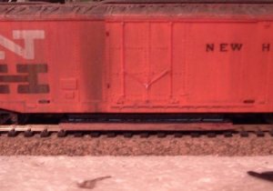

Solder most of the joints is a very good idea, leave a few random ones--about every 10-12 feet--undone for expansion, wiring a jumper from one to the other instead. As for the track cleaning, a Bright Boy abrasive track cleaner is tops and much less fuss. As for coating?cleaning solutions, they are banned at our club. Every train has to have a masonite pad equipped track cleaner in its consist. I have had success with Wahl Hair Clipper oil, a small drop on each rail every 10 feet or so does the trick then allowing the travel of the trains disperse it. Change out you plastic wheels to metal ones as you can afford to as well, they do a very good job keeping the rails clean when a layout is run regularly.

I am afraid to drill holes in my passenger fleet, not to mention the length of the car on tighter radius curves would have the pad catching on trackside details. Passenger consists are exempt in our club as they make up less than 10% of the traffic. Since we went to the rule, the rail dirt problem has gone down considerably. I do plan to add cleaners to an REA express reefer as part of some consists.
My pads are made from scrap masonite picked up at any Home Center. They provide an abrasive wiper that doesn't allow dirt to build up on the rails. Scuffing them with some light sandpaper once in a while keeps them working and they last forever.
