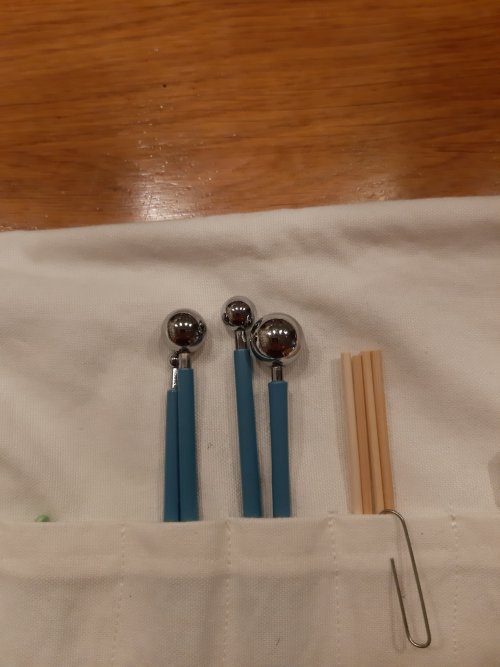

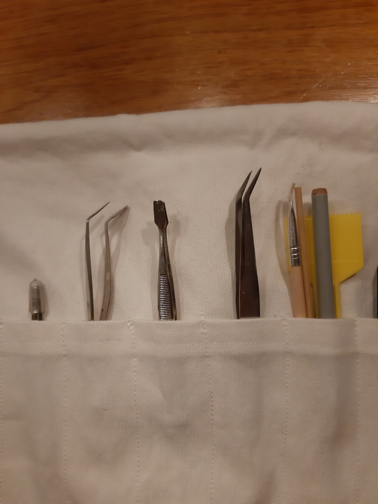

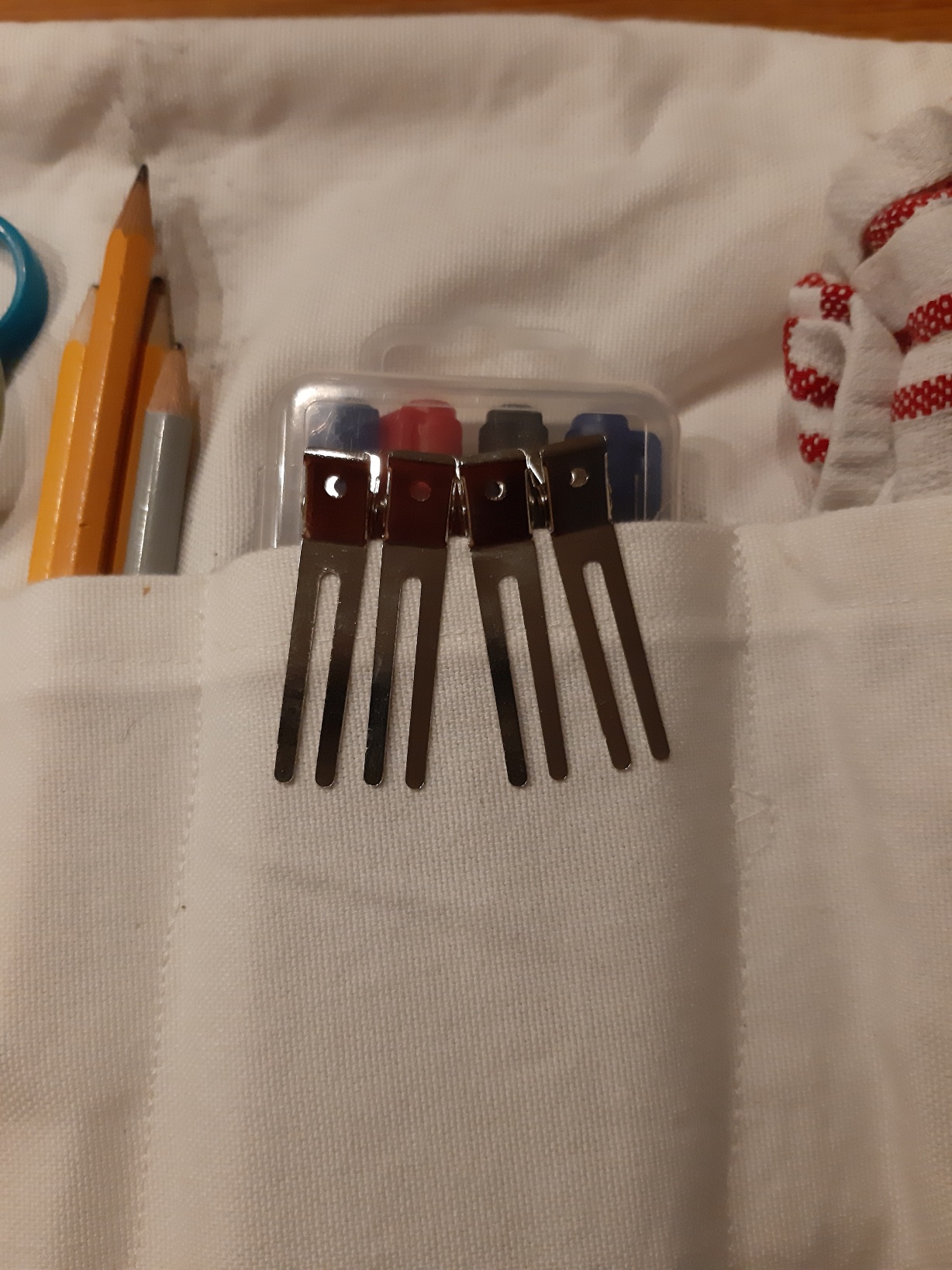

It depends on the model that you are making. I work a lot with spheres and rounded shapes so my tools are adjust to that. I will post a image of my setup.
Reactions: micahrogers

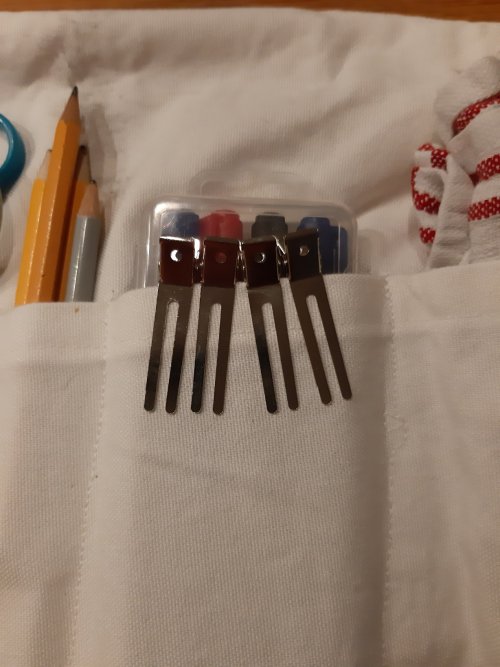

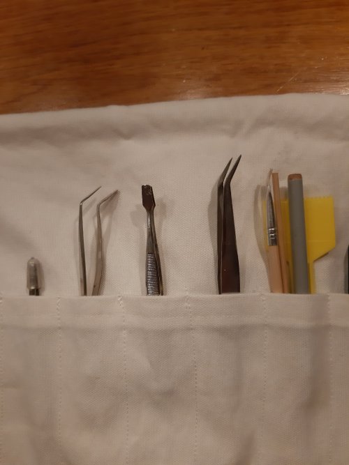

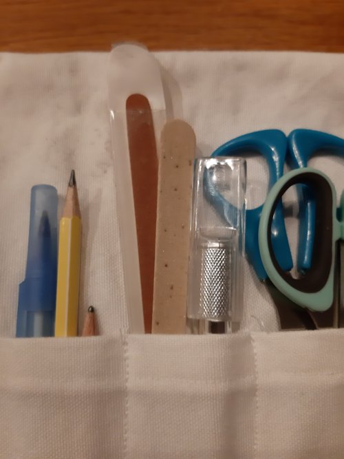

This is a very good question. Most of the same tools that you would use for plastic (and resin) models can be used for paper/cardstock model building as well (i.e. cutting board, hobby knife, sanding paper, tweezers, hemostats, and other such). However, I would strongly suggest a good inkjet printer (Laserjet prints are not good for printing templates. The ink will flake off when you manipulate the parts). You will need something to score the fold lines (I have an old (very dull) scalpel (that has the blade integrated into the handle, making it a solid piece.). Yes, you can use other things like a butter knife or old dried out ballpoint pen. I use watercolour paints for the edges. You will want several different sized dowels for shaping tubes (I like to use metal knitting needles).
With that being said, just keep your eyes open and look at different tools to see how you could use them to help you with your models.
This is my basic kit.
