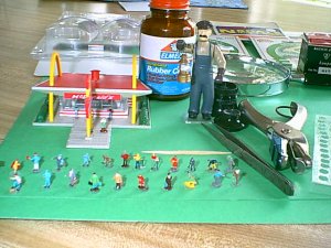

I have been trying to figure a way to add figures to my N scale layout without gluing them down permanently and this morning while cleaning my G scale trains I noted that all of the figures are mounted on a clear plastic base. I took a heavy plastic pack that my two way radios came in and with a hole punch made a bunch of bases and glued my figures to them with rubber cement, it is easy if I want to remove them later, some structures like my McDonalds I don't want to glue anything to. This way if I want to move them around or change structures which I do once in a while.
