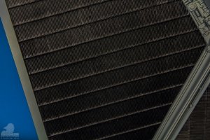

As for the texture, here are some closeups of the coolshade material used on the original:

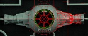

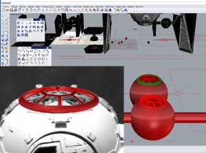

Here is my WIP model of the cokcpit compared to original
and I even started to model some details from kitscans, so If you have some questions, I am able to answer, feel free to ask .

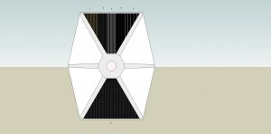

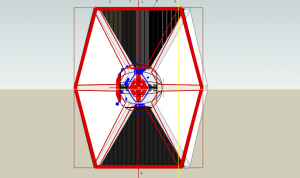

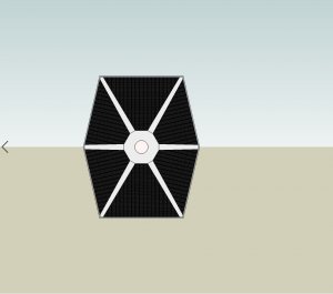

After a couple of lessons sketchup i finaly (4th attempt) have a first drawing of the solar panels from the TIE fighter.
Dimensions 12,2 cm high and 10 cm width
I tryed different colors for the solar plates but I think nr. 6 looks the best.
Please feel free to give your opinion.
How will the wing finaly look.
I will use a base panel, followed with the solar panel. Then I will instal the solar support frame.
And finaly the arms and the centre piece with the greebies.
Looking forward to your remarks
I have to say that you are off to a great start on this project! You have made very good progress. I would have to agree. I too like Nr. 6. It looks more "realistic" to what solar panels look like on a vehicle like that. I am really looking forward to seeing how this turns out!
KEEP UP THE GREAT WORK!!!

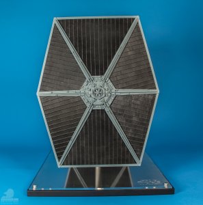

Thank you all for your kind words. thumbsup

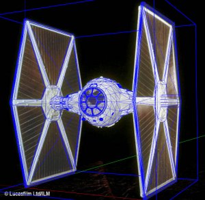

Love to see that I'm close to your wing. Thank's for sharing this picture
Indeed there are difrent dimensions off the TIE fighter on the internet.
I used the measerments from the TIE fighter owners manual and those are almost the same as the Bandai.
So I will keep these wing's en see how they come out

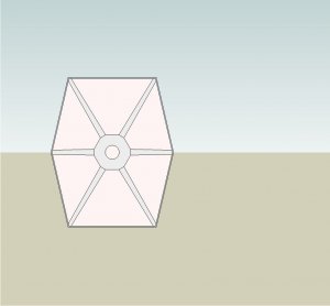

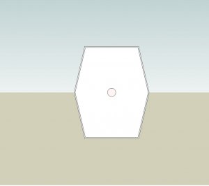

And here I have an update on my TIE fighter wing
This is the base panel
The solar collector will be fitted on the base panel

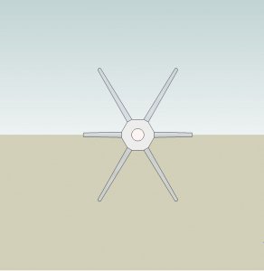

The solar support panel will be fitted on the solar collector base panel.
I have to remove some parts to see the solar collector.
And finaly the support arms will be fitted.
The collors of the arms are Metal_Aluminum_Anodized
If I build the wing like this I will get a layerd wing.
