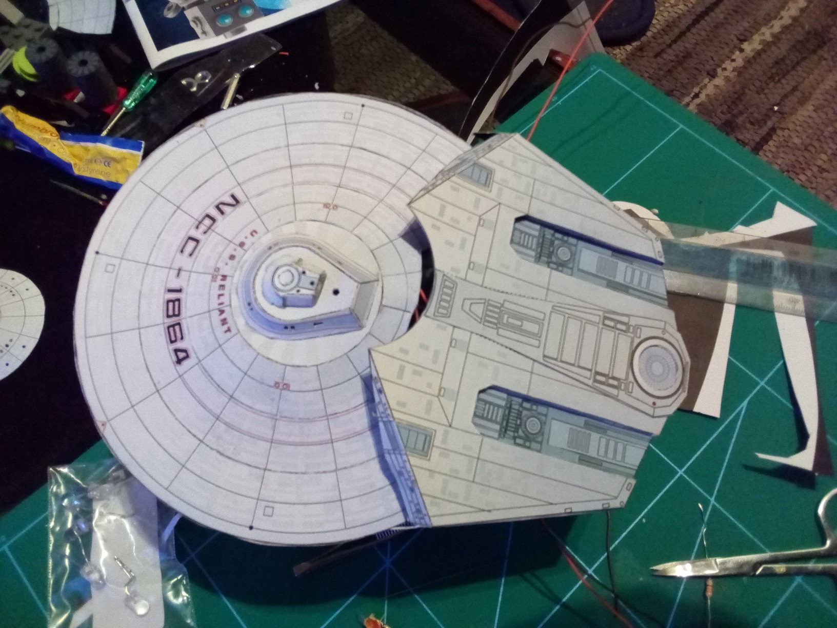

I seem to have shook off the slump I was experiencing, for the first time (in forever) (sorry, just watched Frozen 2 with my daughter... :hammerhead:) I have left a model incomplete. The Spitfire is on hold while I embark on a project I've been wanting to do for quite a while.
I'm starting on as diorama (as such) of the battle of Mutara Nebula from Star Trek II: The Wrath of Khan. I'm using pretty easy models from SF paper gallery, partly due to space issues :(
I think I needed some light in my life as well....

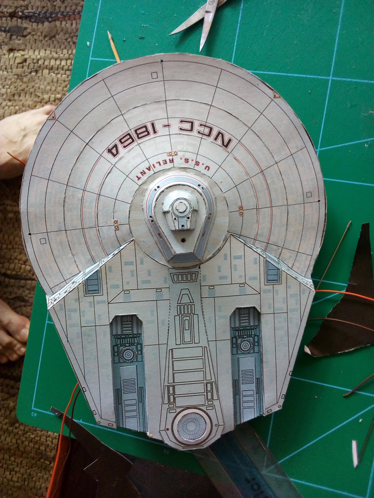

Here's the first session's work, I started with the Reliant.

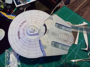

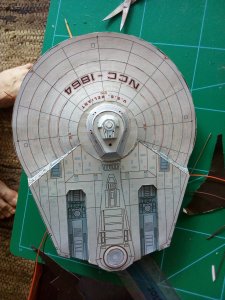

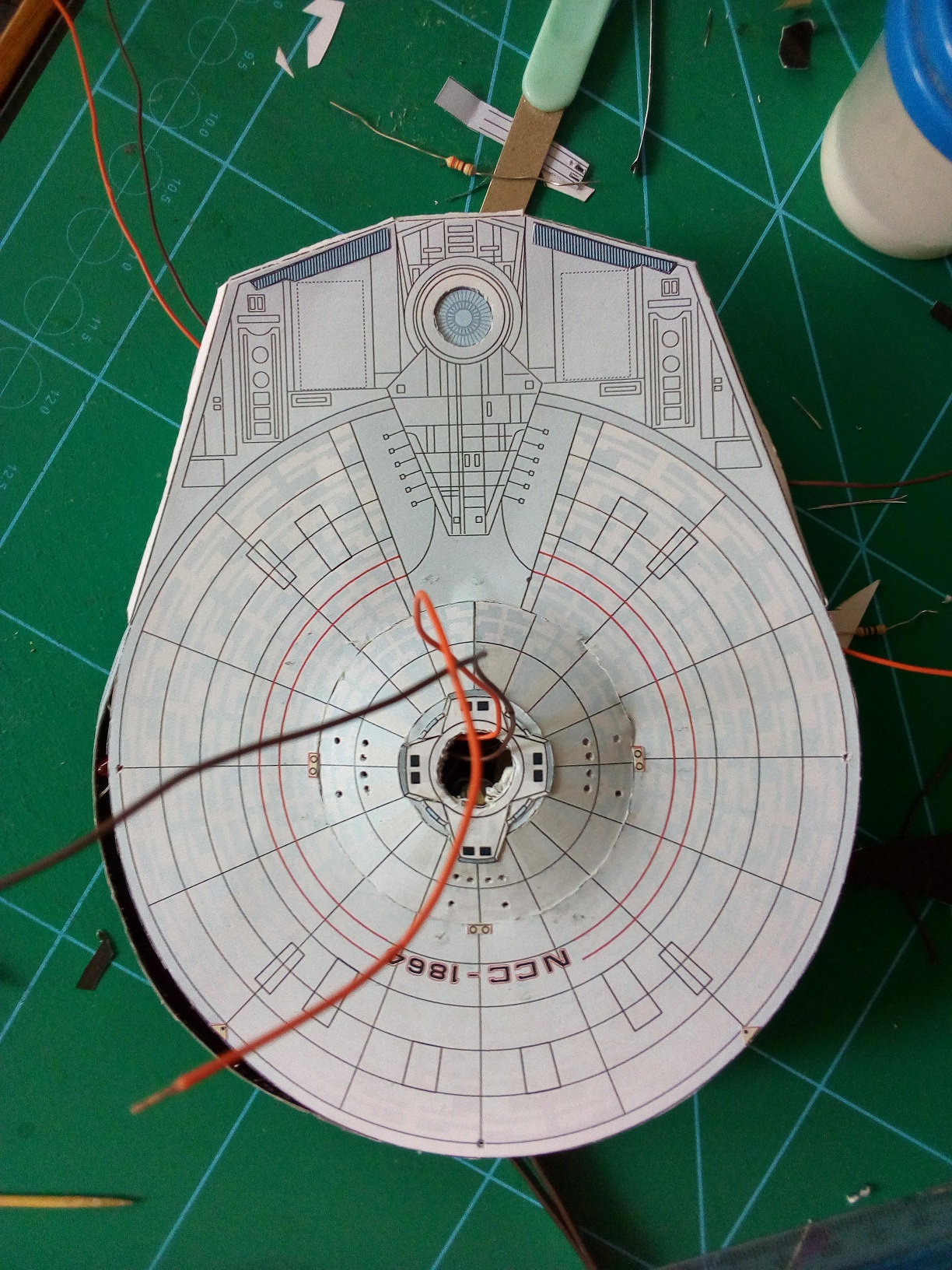

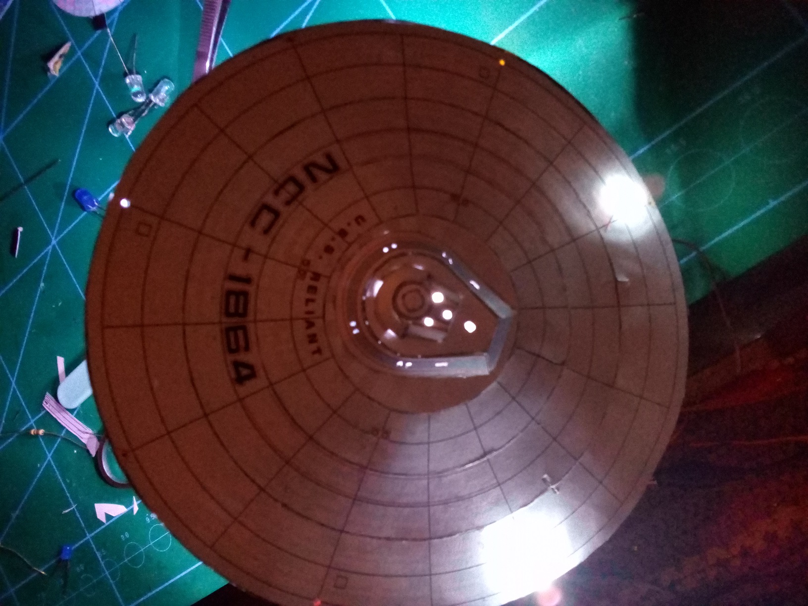

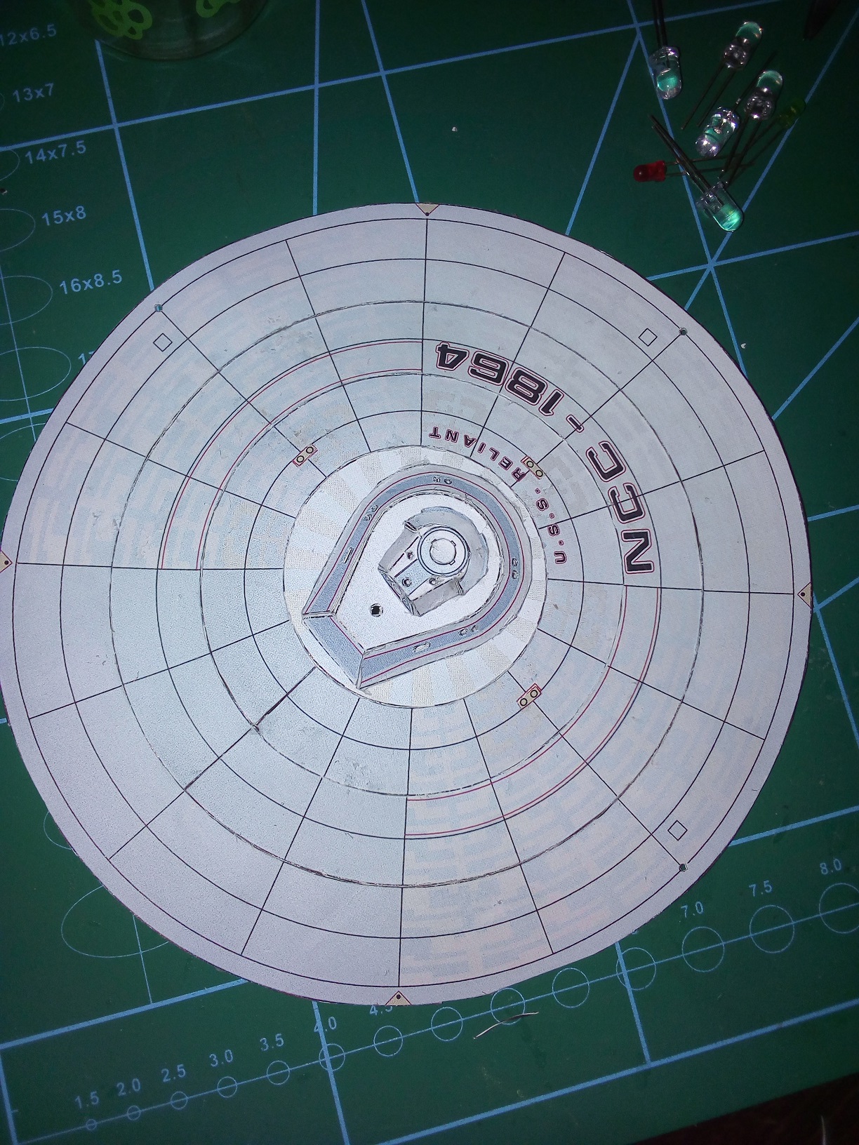

So we hit the first, major snag. The template is flawed!!
The top and bottom do not align!! You can see the huge gap on the underside once the rear is aligned. The thrusters don't align the rim is out of alignment!!
:hammerhead::hammerhead::hammerhead::hammerhead::hammerhead:
Haven't made my mind up if I'm going to continue.... It's very annoying when you have to do damage control to a freshly printed template....
I had a similar problem when I built UHU02's Viper. The nose hull would not align correctly. I printed it about 4 times to get a nose that somewhat fit (not perfectly but it was the best I could do). It was an enlarged kit and in theory that should not happen but life is full of surprises. It drove me so mad! In your case I would check the dimensions again and make some small incisions along the rim. Glue it together with small overlaps to decrease the diameter so that it matches the curvature of the top piece. Alternatively you may cut out small triangles and glue together the rim from behind with a paper strip which will give you a smooth finish. Then print out the rim again and cover up the incisioned one.
Reactions: micahrogers
You might have to cut it free and run blank sheet around the bottom rim and then trim when glued shut.

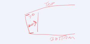

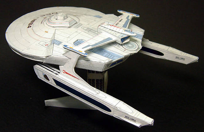

Yep! You can see that the saucer rim is inset, even in the build on SF Paper... It should ( do to the ARC in the parts ) slant from bottom to top...As it will form a smaller diameter on the bottom arc that is formed...
Looks like they tried to make it fit straight up and down, which it will not do! As you can see in the build pic...
and you should be able to catch any slop as a good deal looks hidden by the rear section. Over Lap cut-off, what-ever needed.
