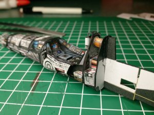

The Dunglish update, which seems an age since the last one!!!

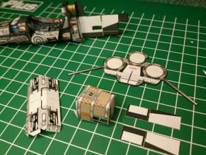

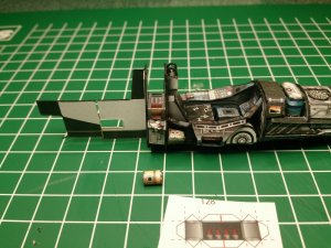

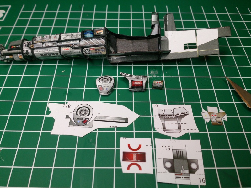

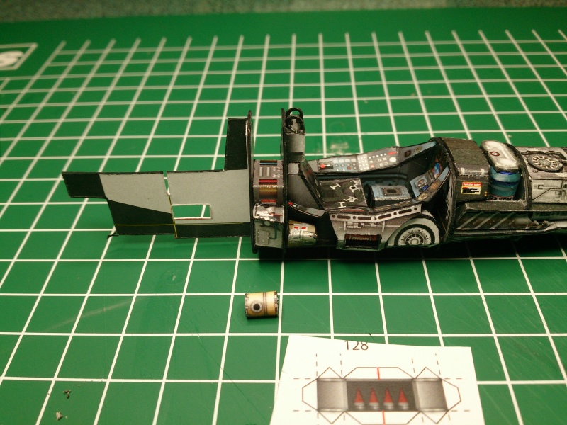

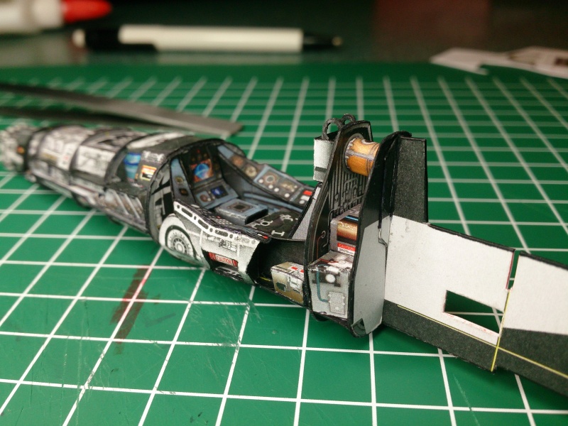

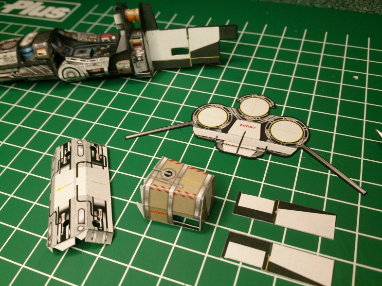

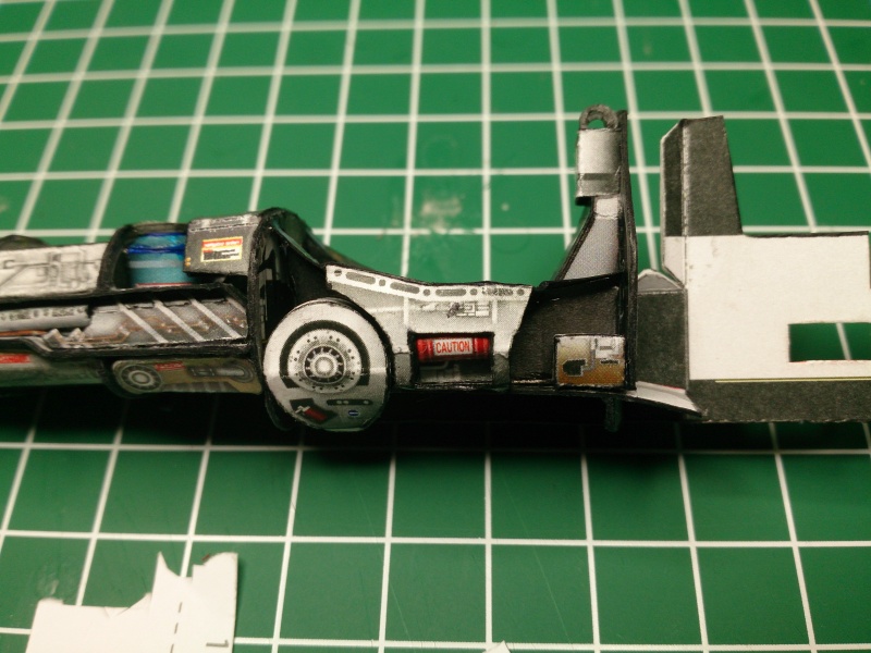

I built up the canopy sides and back, following the instructions.

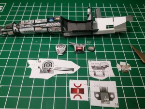

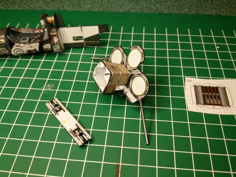

For the next module, I deviated from the instructions slightly.
The cross member that the intakes and engines attaches to, can be removed and replaced on the main frame, even when the intakes and engines are attached to it.
I want to use this to my advantage, to make sure the intakes and engines line up true when I attach them to the cross member. It will be a lot easier without the rest of the plane attached to it!!!.
I put the cross member in place without glue and attached the two side plates to part 132 and the cross member, but not glued to the main frame yet.
I made triple sure that everything was square and lined up properly while the glue set. Part 132 was also not glued to wall behind the cockpit yet.
Once the glue had set, I removed the assembly again ready for the intakes.
Actually, once the assembly is in place on the main frame and the landing gear mounting bar is slid in place, you don't actually need glue, as everything fits beautiful and snug.

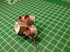

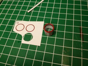

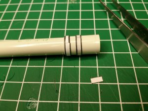

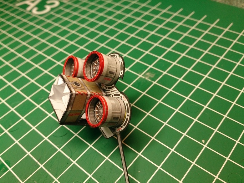

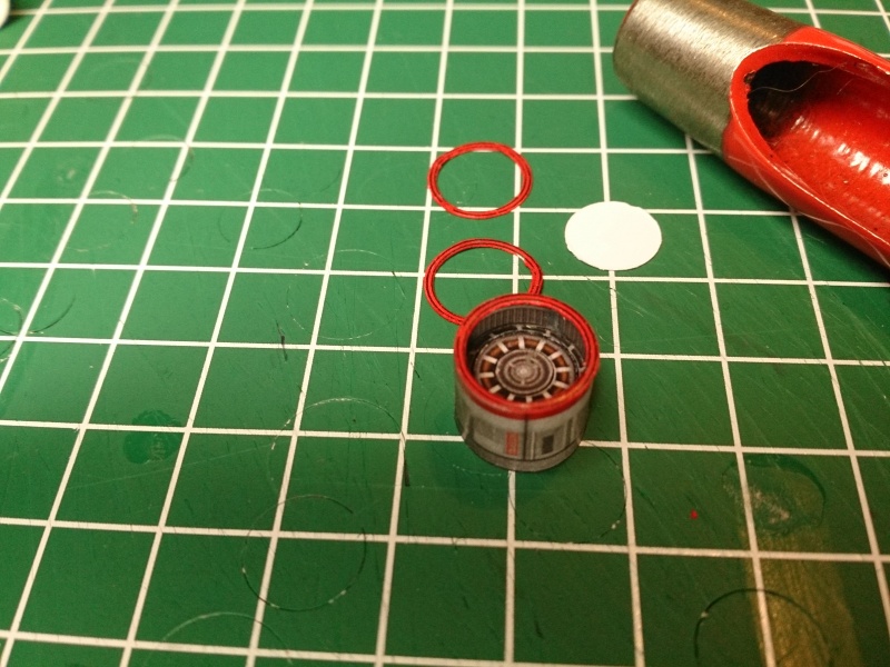

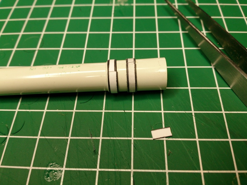

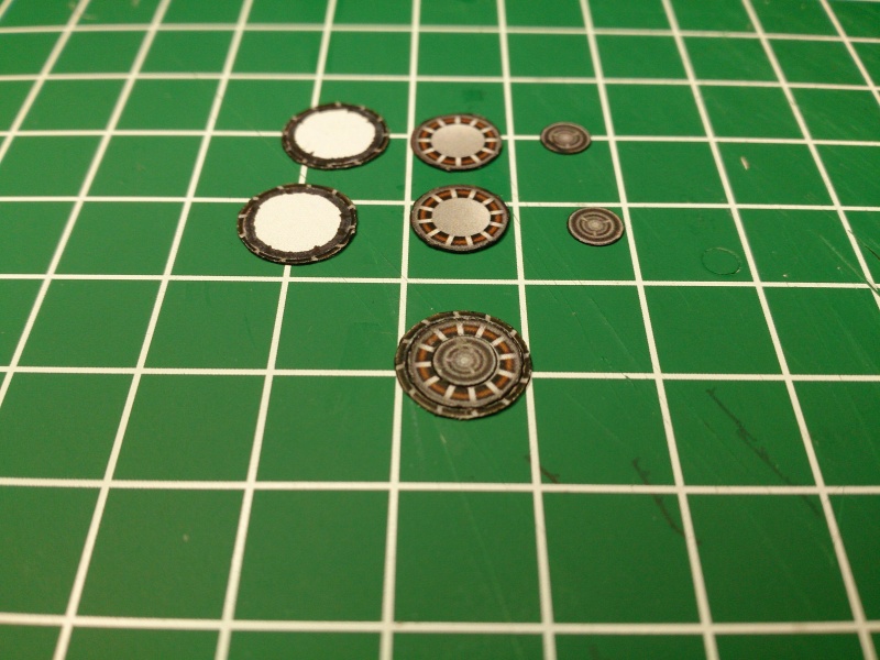

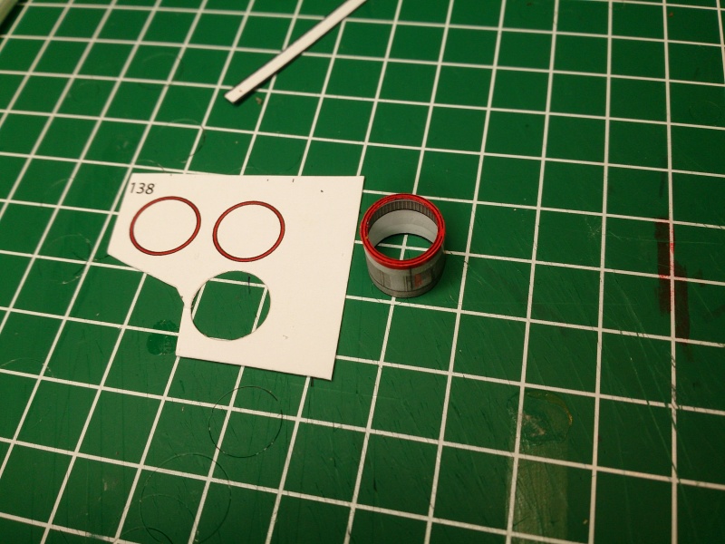

So, time for the intakes. I made up the intake compressors as per the intructions. I made up the inner ring parts by winding them around an old pen, that turned out to be exactly the correct diameter.
I decided to use two rings per intake to strengthen the rear bond to the cross member and also keep the circular shape true. I glued on the outer skin while the rings were still on the pen, making sure everything stayed perfectly round while the glue dried.
Also, in the photo above of the pen jig, you can see that the pen steps up in diameter to the one I needed. That is in front of the first ring and it tapers to the correct diameter. This turned out to be a perfect way of aligning the rings to the front of the intakes while gluing.

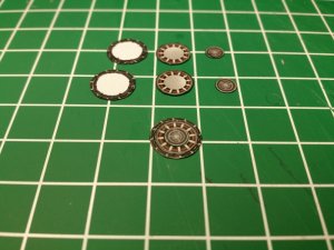

I cut out the rings using 11mm and 12mm hole punches. It took a few attempts at getting the alignment right.

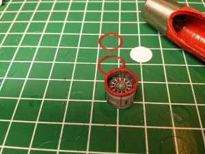

Using the pen jig I then glued them in place. Once dry, the fan assembly was inserted and glued in place.
Back in a sec ...... :mrgreen:

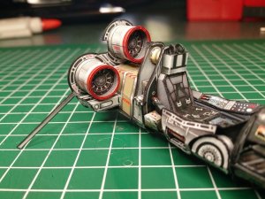

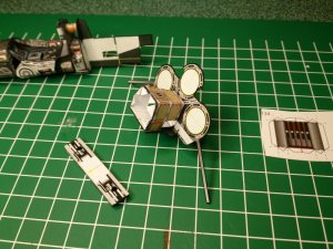

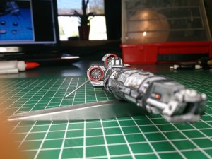

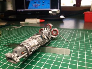

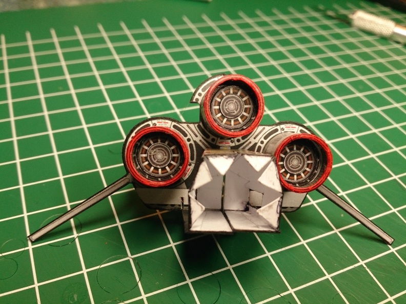

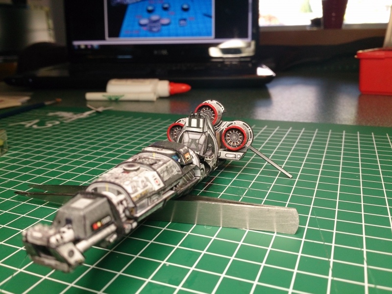

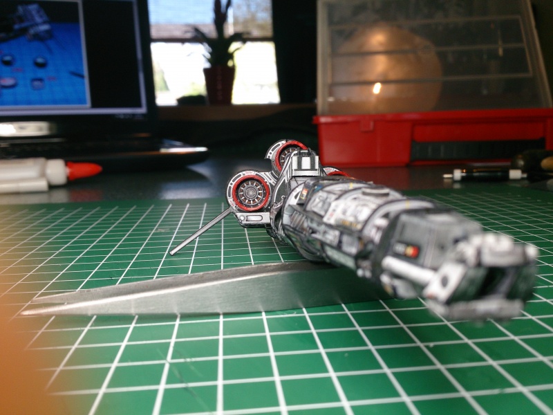

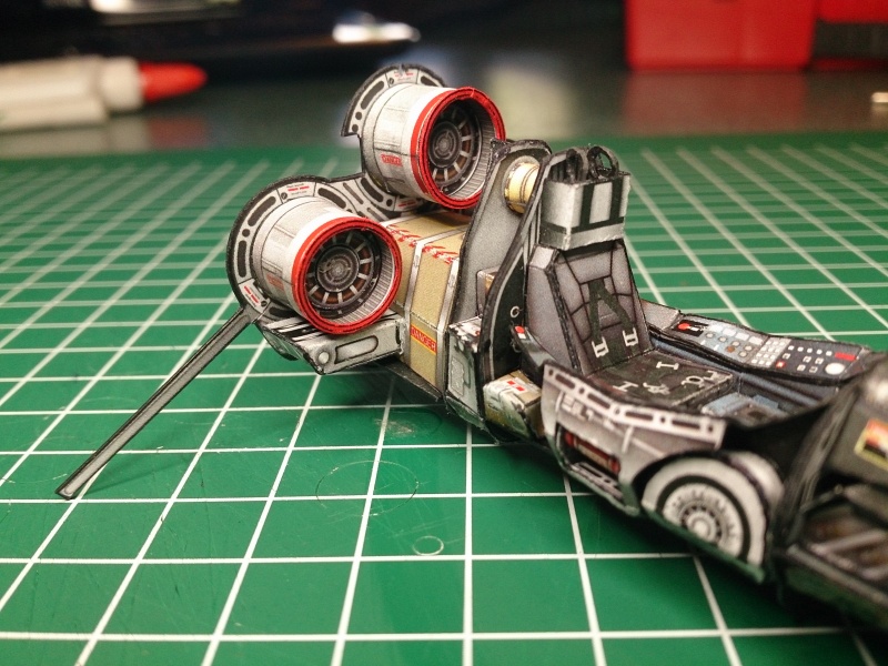

Once all three of the intakes were complete, I attached them to the cross member.
You can see here how it looks with the assembly attached to the main frame (still without glue.) I am pleased with the look of the intakes

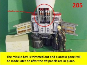

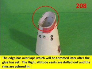

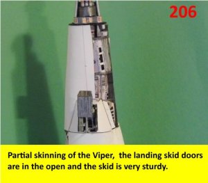

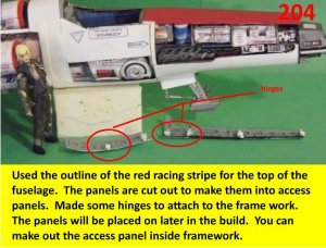

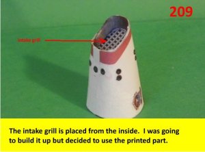

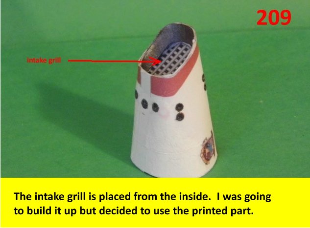

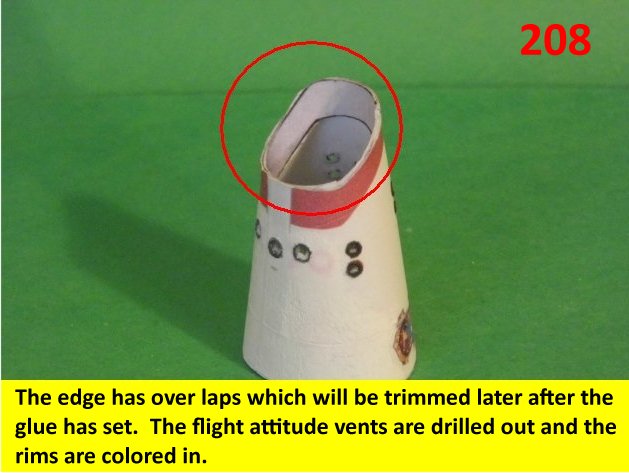

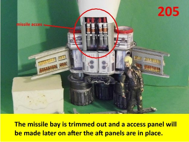

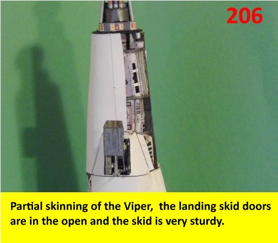

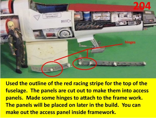

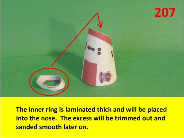

Keeping the postings alive, here are a few updates on my build. I am still working up my diorama idea and how the different parts will be placed in it. That nose is a bit tricky, but it will not be attached to the viper. It will be placed to the side in the diorama. Not shown here but the vents will have exhaust smudges added to it later on. Enjoy and see you all next posting.:thumb:

the level of detail you are bringin to this is amazing Silver. Uhu02 did an amazing job with the model, and you are taking it to the finest level.
:thumb:
@Silveroxide: The detail that you are putting into this model (which in its own right is a SPECTACULAR MODEL already) is taking it to a WHOLE NEW LEVEL!!!
wow...you are taking this to whole new level....
