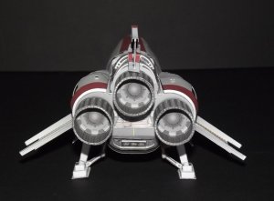

Thanks for the comments guys. After I attached the Rear exhaust section, An idea popped up, but I had already glued the parts. Since the exhaust fits snug on the mounting ring, I could have made the other exhaust versions, with the colored exhaust templates and switch them as the mood fits. Exchangeable jet nozzles is an option. Glad that you all enjoyed my build but I still depend on those who are ahead. From those who are already skinning their Vipers, I learn of the tight or hidden problems that may arise. The landing gear will be interesting since I have another idea over the prescribed instructions. They will be the same parts but made differently so that the pads lay flat on the deck and not turned up at a different angle. Enjoy and see you all next posting and keep building up the Viper squadrons.:thumb:

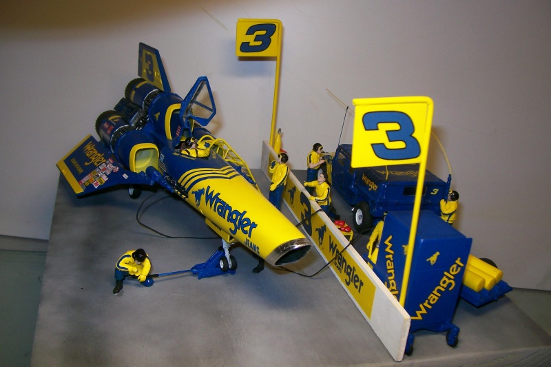

Well, since there are some concept ideas, here is one from us NASCAR fans. What would Danica do?
Probably the same as Starbuck, crash it.:crash:

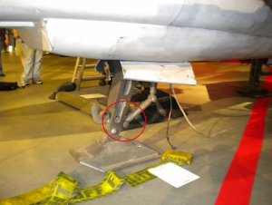

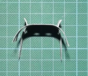

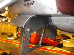

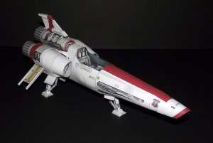

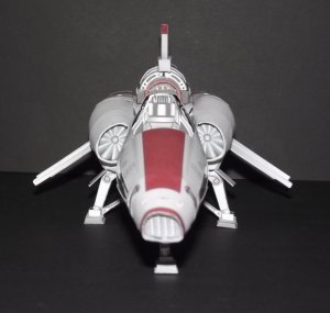

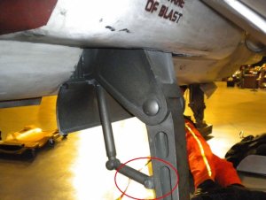

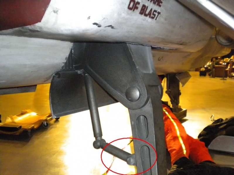

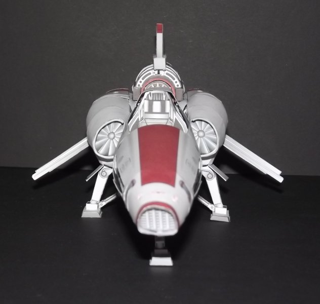

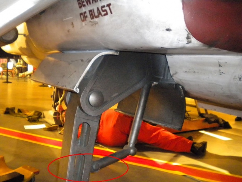

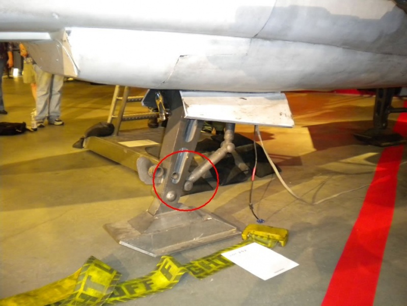

There is small error in the landing gear struts. The long one is for the front landing skid and there is a short one for the rear gear. I will post soon, as I have to re-do the gear details.:crash:

OOPS! But that should be an easy fix. Thanks for pointing it out. I noticed a missing texture at the front of the Apollo cockpit skin, too.

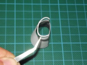

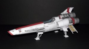

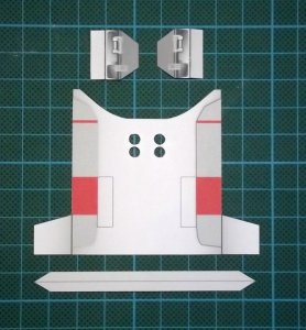

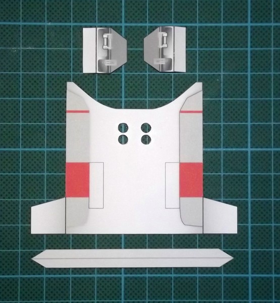

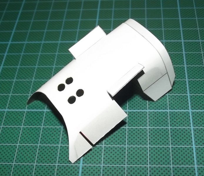

The bottom skin between the wings is a very easy assembly: Four parts only, and they come in a very good size. As you can see in the pics I have pre-shaped the parts BEFORE cutting out the rectangular openings for the landing gear and the slit. So I made sure that the part is curved evenly. If I had made the cuts first there would have been the danger of getting an irregular shape and / or making a dent in it.
I curved the covers of the landing gear compartments slightly.
The skin fits perfectly and lines up with the cockpit tub skin very well.

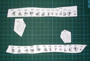

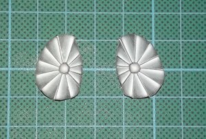

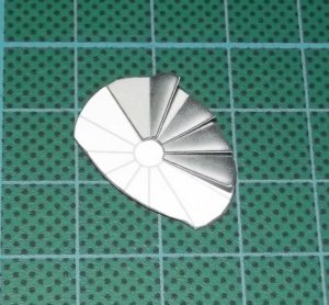

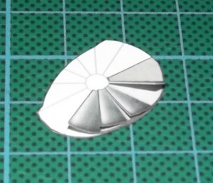

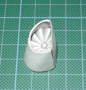

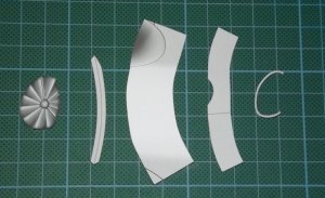

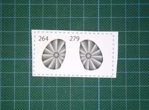

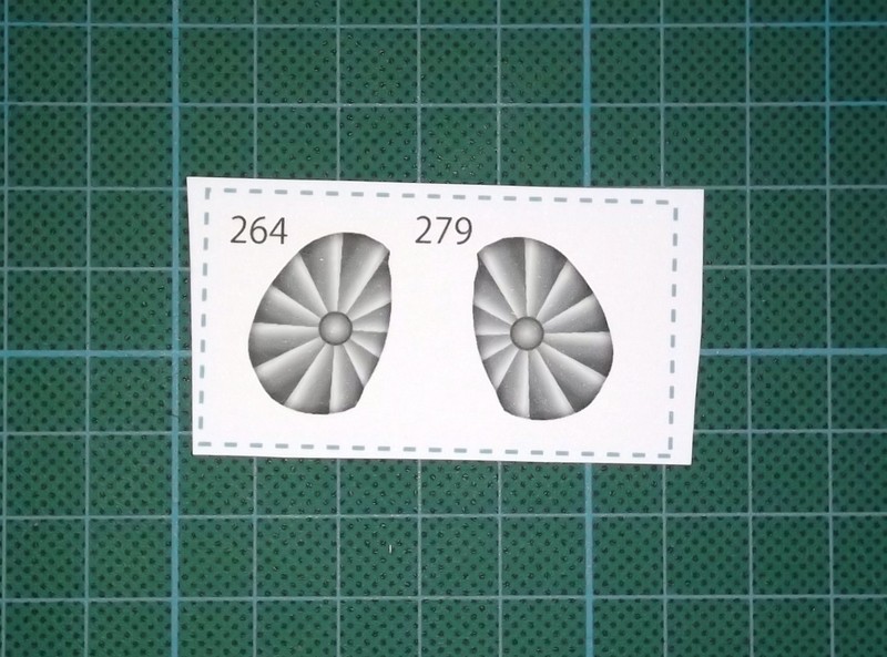

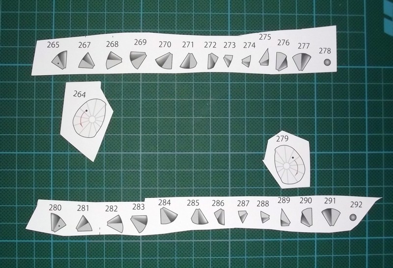

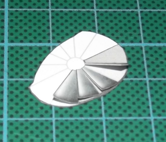

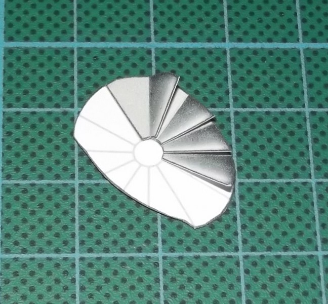

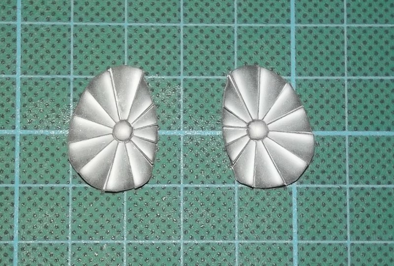

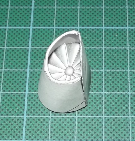

The turbine fans are assembled very easily, too. UHU was so kind and supplied the builder with a simplified flat version. Naturally, I took the challenge and went the full route. :mrgreen:

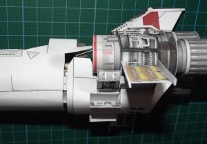

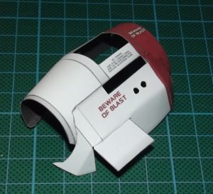

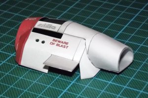

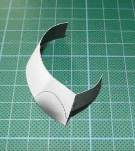

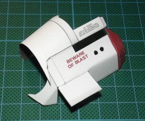

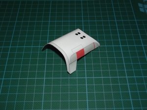

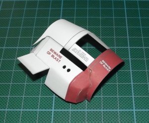

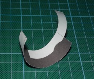

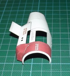

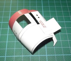

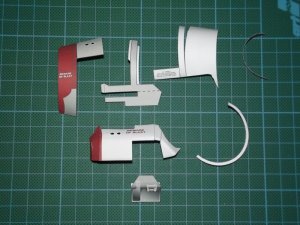

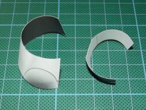

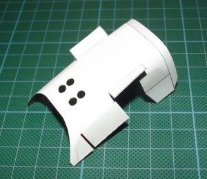

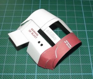

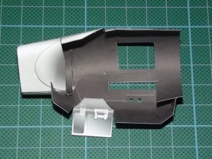

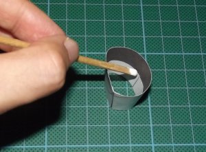

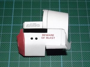

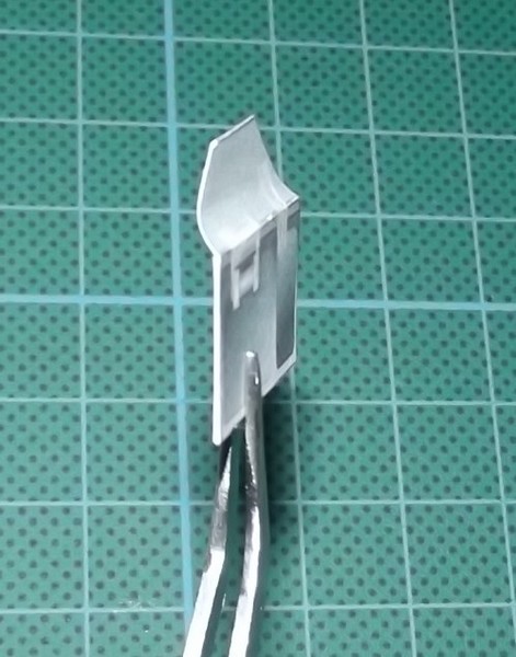

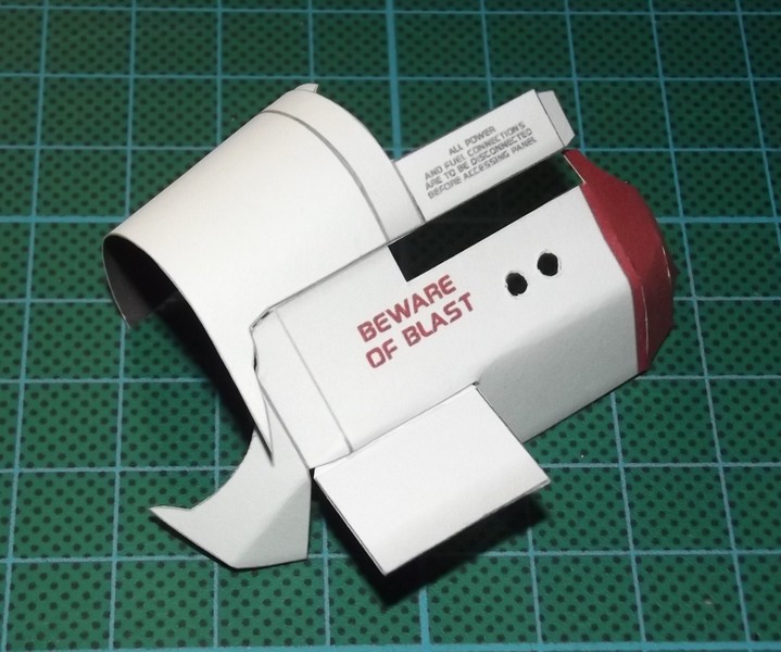

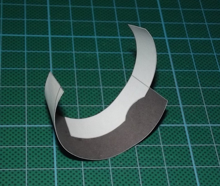

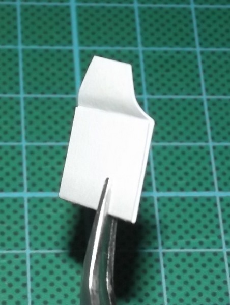

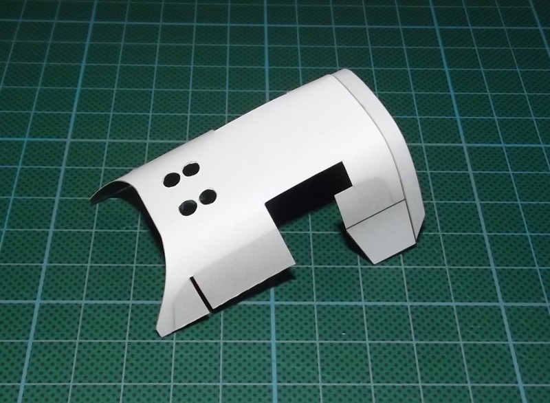

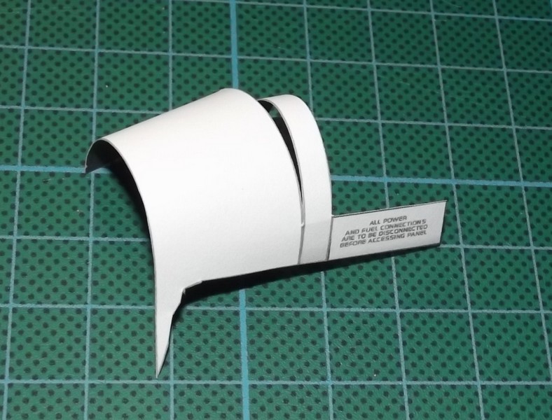

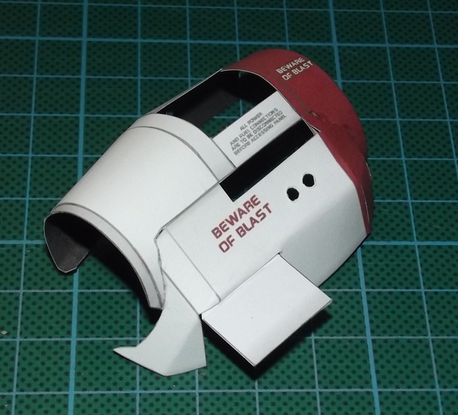

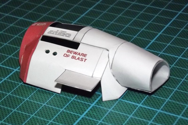

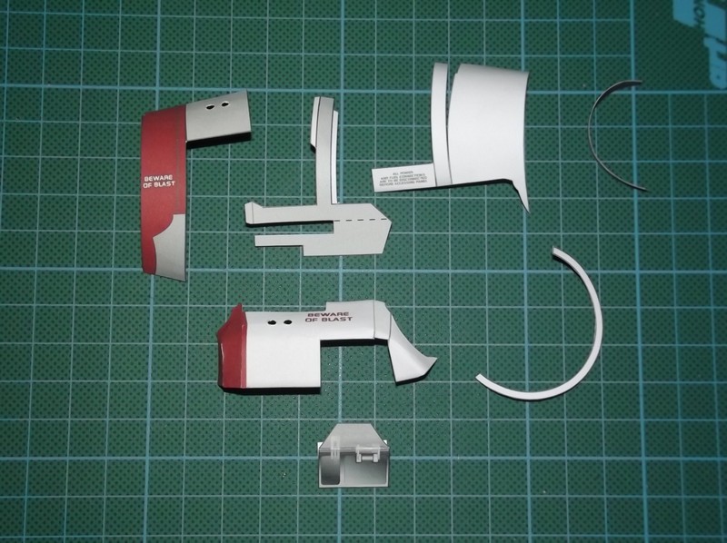

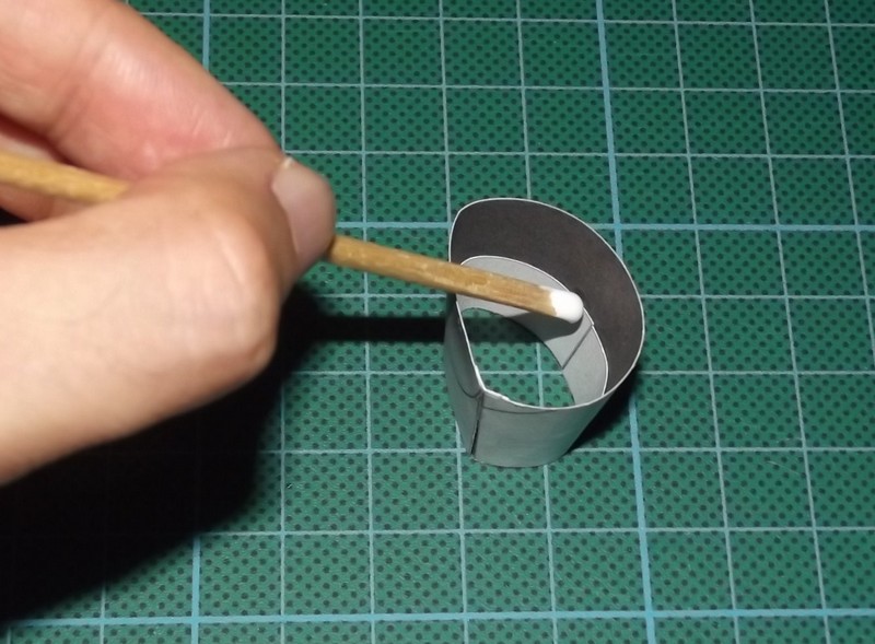

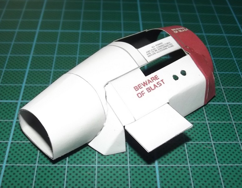

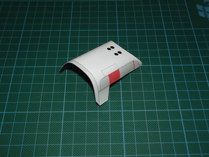

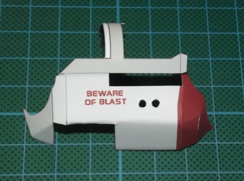

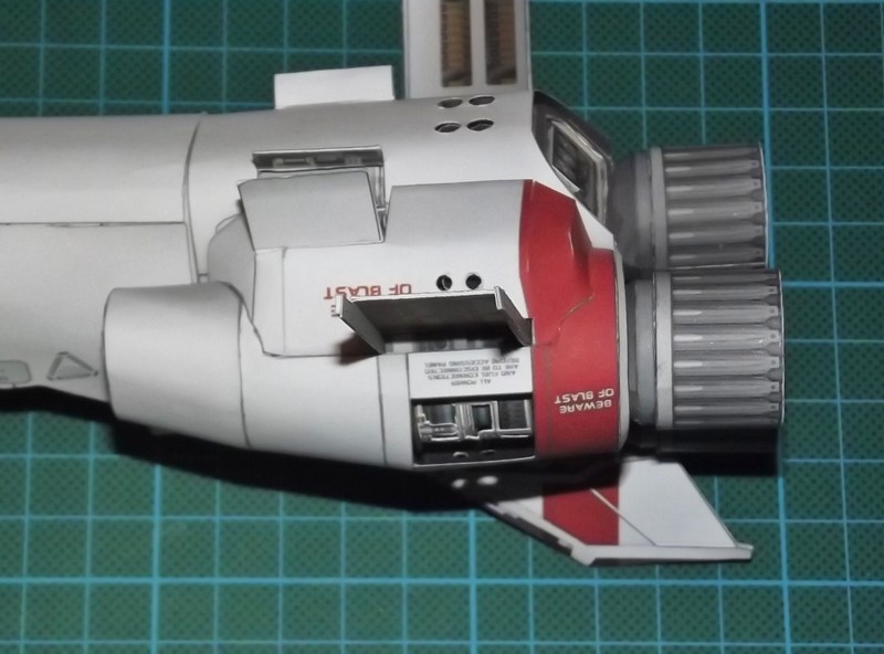

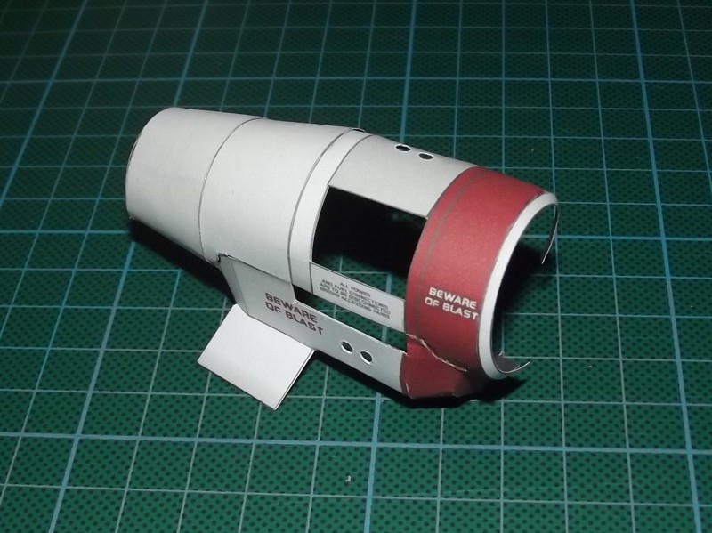

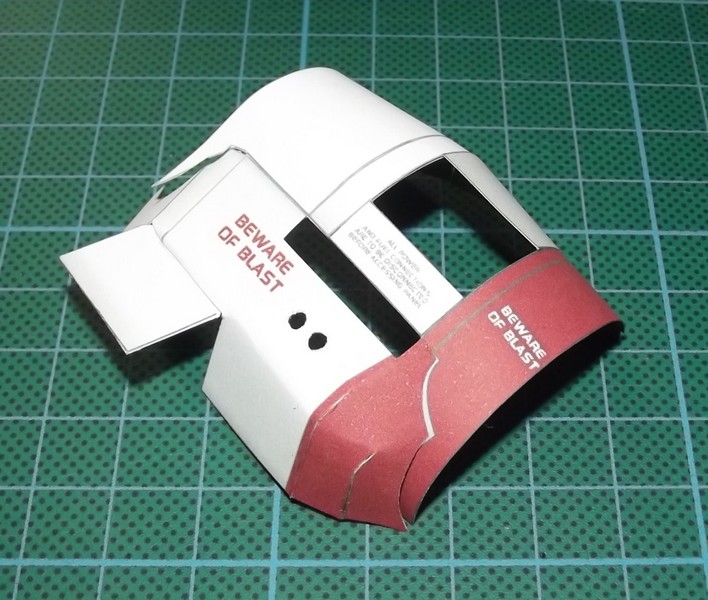

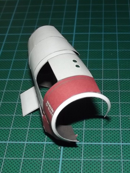

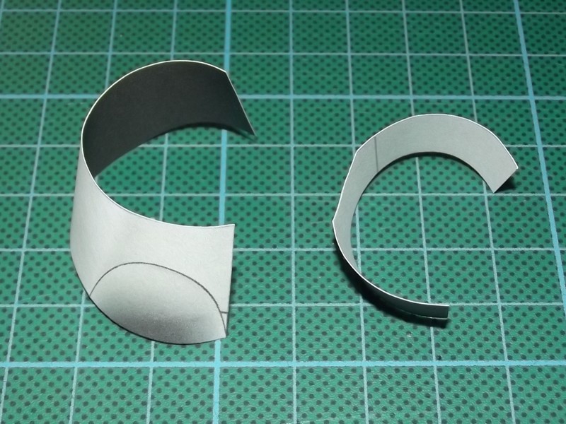

I continue with the right engine cover. It is assembled according to the master's instructions.

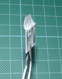

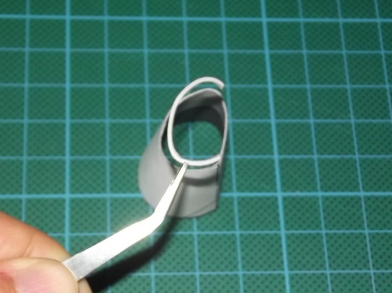

Pre-shaping the intakes was a bit tricky since there are no printed markings for folding / bending. I used part 312 for reference.
When you attach the intake keep in mind that part 313 does not align with the upper edge of the intake; there is a small overlap. Use the small triangular shape on part 315 for alignment.

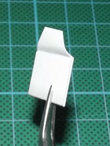

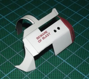

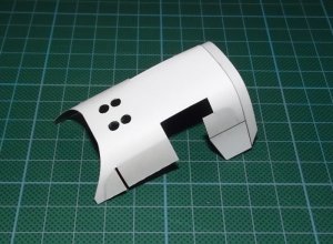

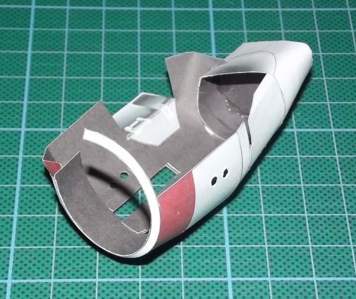

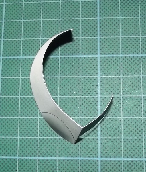

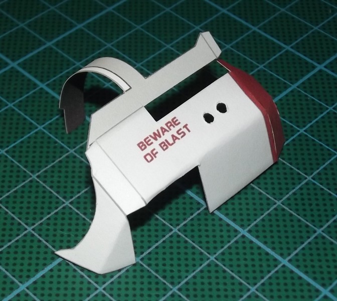

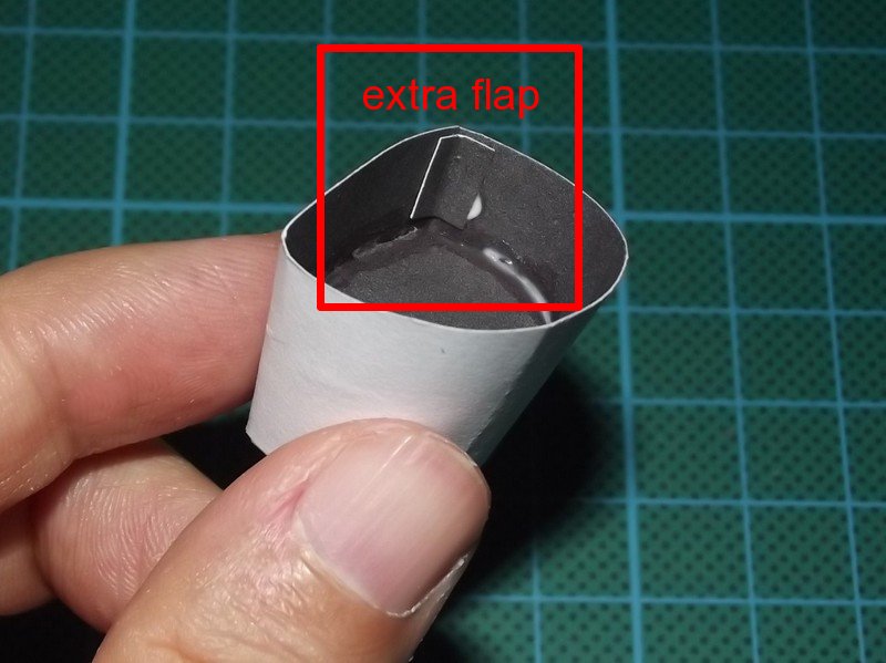

Part 318 has to be shortened.
The skin fits perfectly. I'll have to curve it a little more and proceed with the other one.

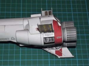

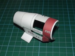

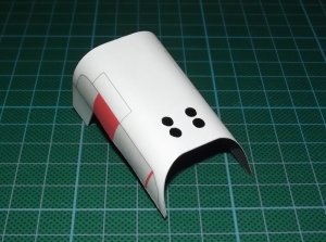

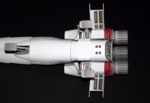

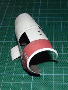

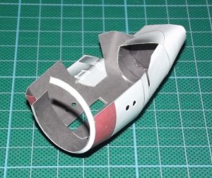

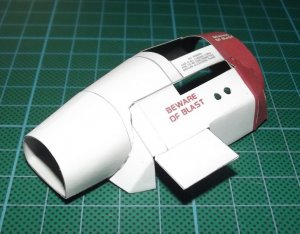

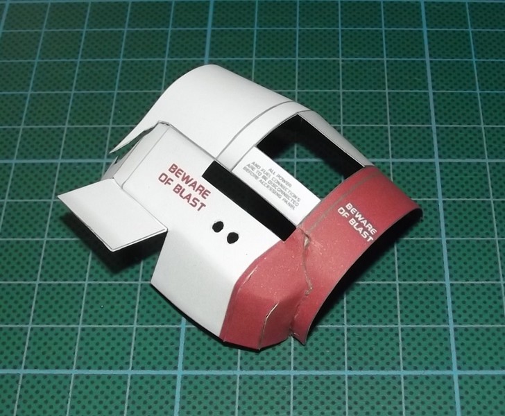

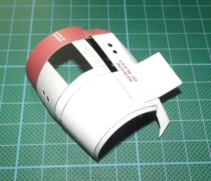

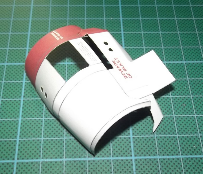

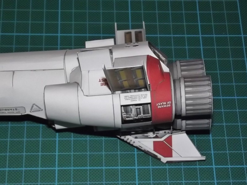

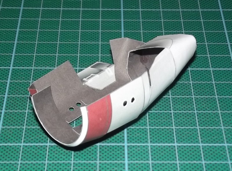

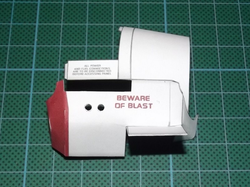

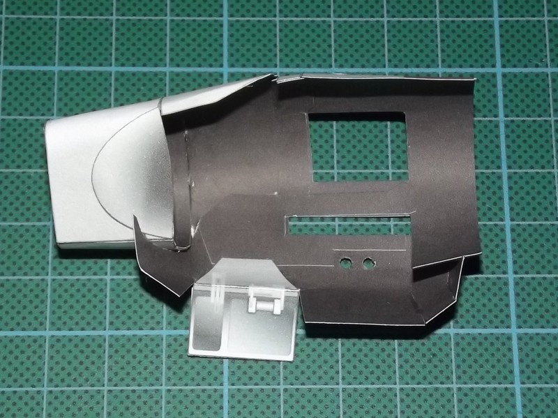

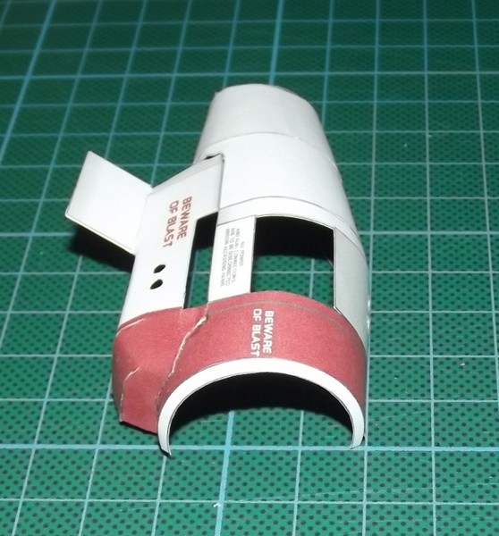

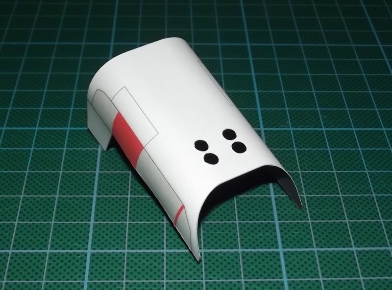

Well then, I have assembled the left engine cover. This one went togetehr very fast mainly because I was familiar with the placement and shaping of the parts. Since the foldings came out a bit cleaner I give you another series of build pics and close-ups.

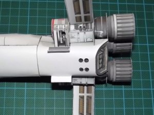

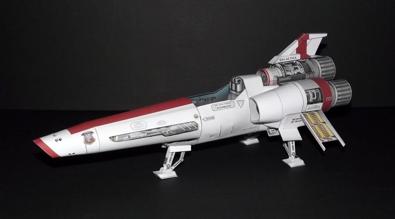

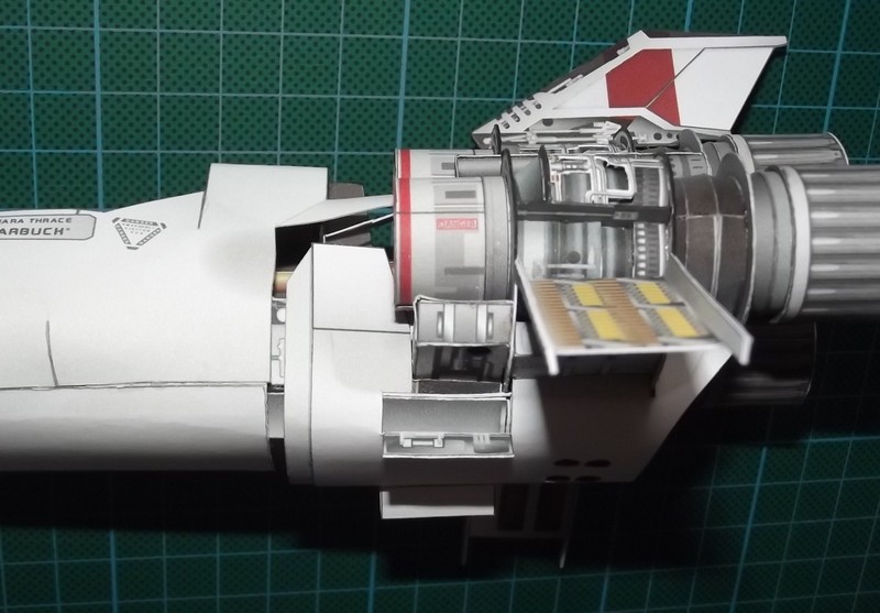

And some views of the mounted skins. CU later with the wings! :thumb:

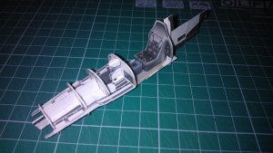

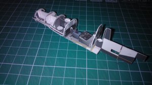

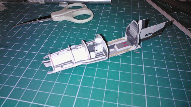

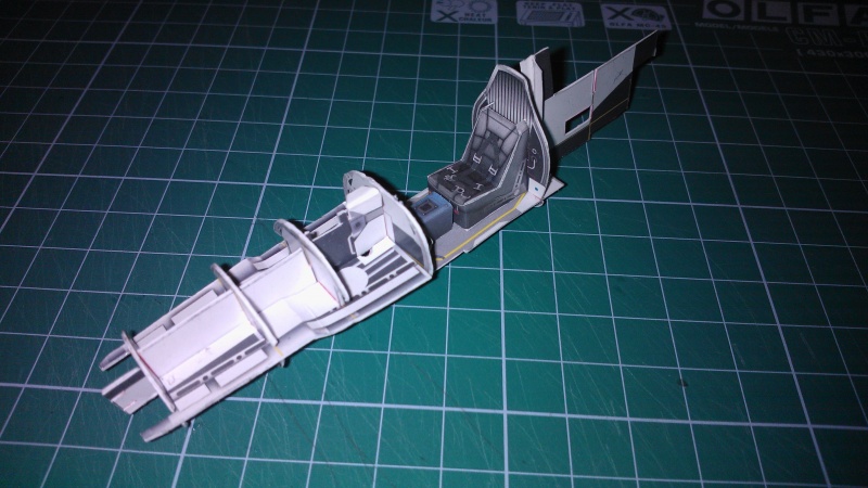

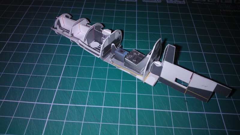

I'm gonna get there, just a lot slower... BTW, I'd like to show my (little) progress. I've started working on the cockpit. Wonderful model, I try not to mess things up... :cry:
