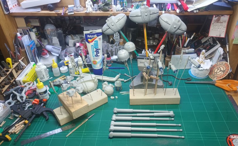

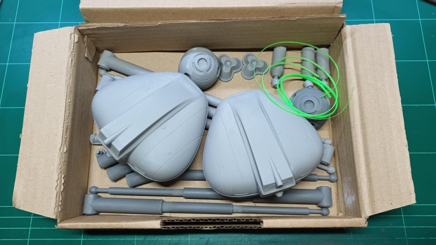

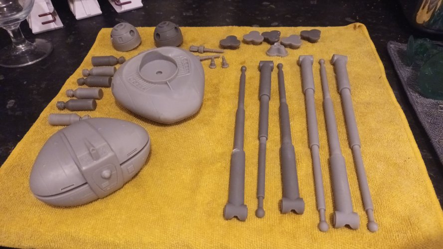

With all the parts laid out - we have two std Tripods and one gun toting (laser doo-dad) variant.
The two on the left are the resin ones, and the other the filament version.

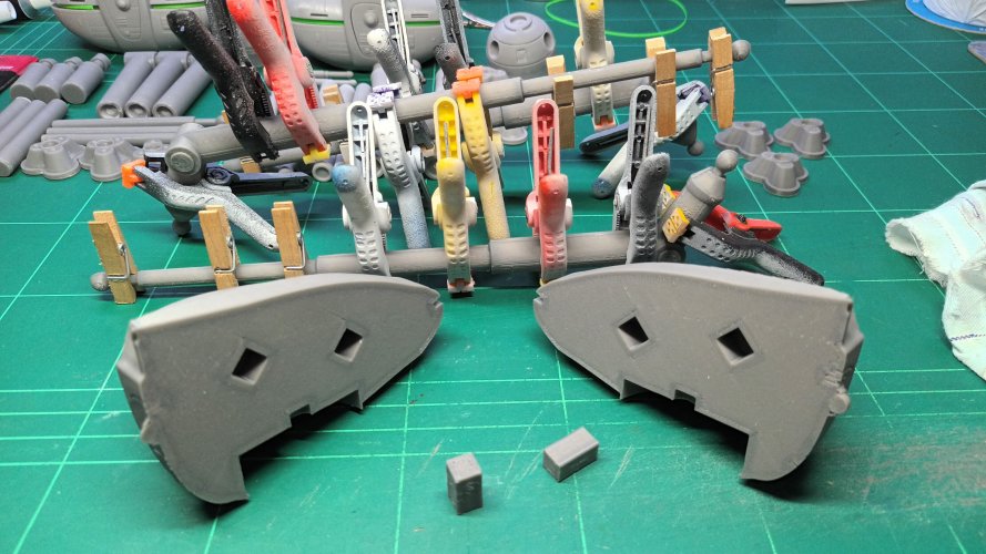

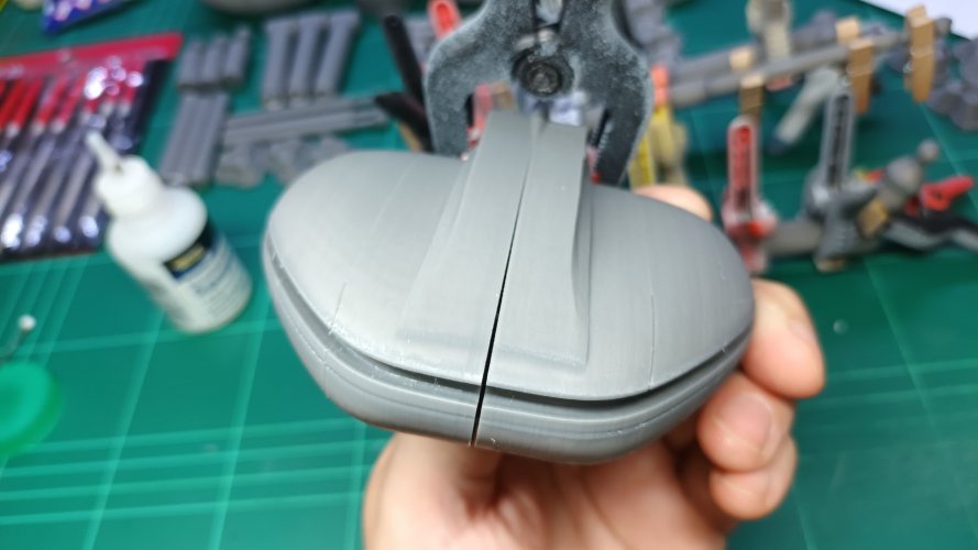

Legs clamped it was time for the head, also split into two pieces.
The centre split will cause a few headaches in the sanding and filling department.
The front lined up, but the back of the head was a different matter.
Torso and leg stubs required minimal prep.
As for that poor join on the back of the head, I soaked the part into very hot water for around 10-15 seconds and made the part close back together.
I couldn't get any clamps on this part so the mark one human hand had to do.
Sub-assembly of the first construction now complete.

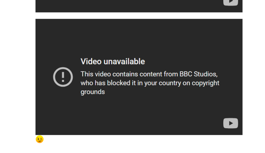

Unfortunately your videos are ironically copyrighted in my country where I have a tv license!!! Glad I have the dvds...

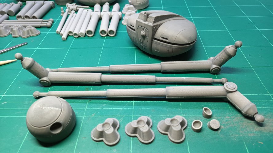

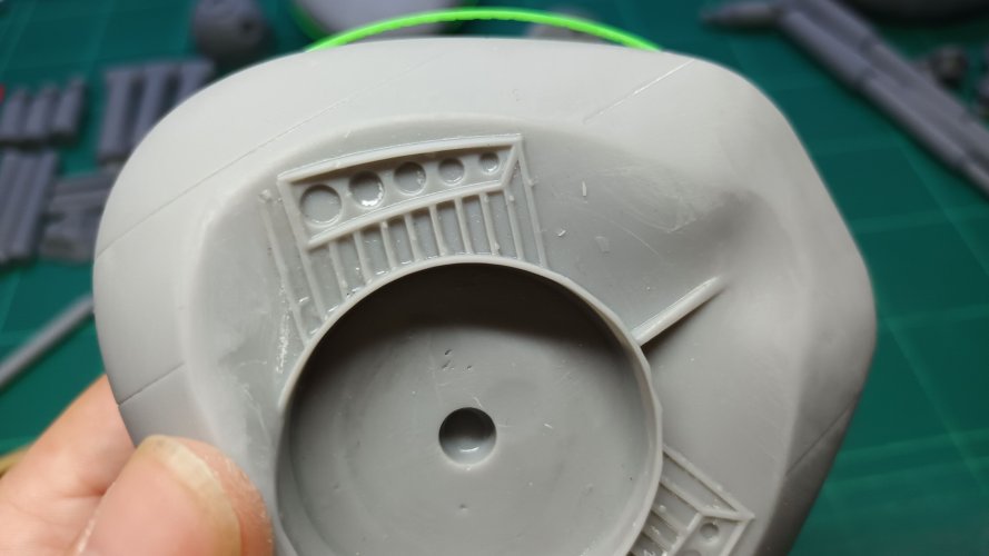

Moving on from the filamented Tripod, it was time to move onto preparing the resin parts, which still had a little clean up needed, tiny support nubs here and there.
A few underneath to take care of too.

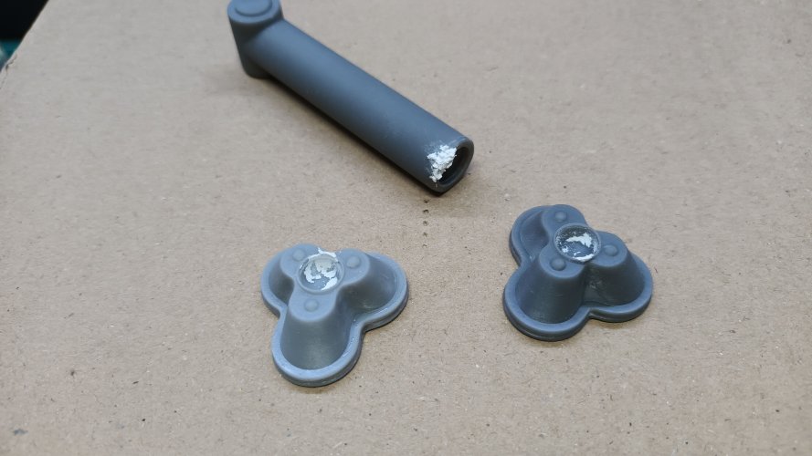

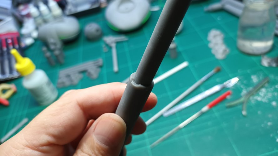

The leg tolerances on the legs joins were incredibly tight, and sadly I snapped a little piece out, no probs, but I did swear!
Filler applied where needed.

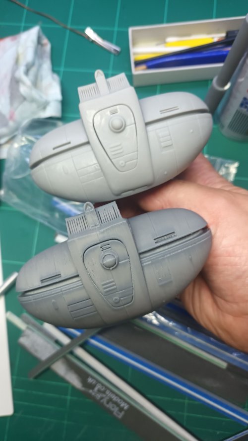

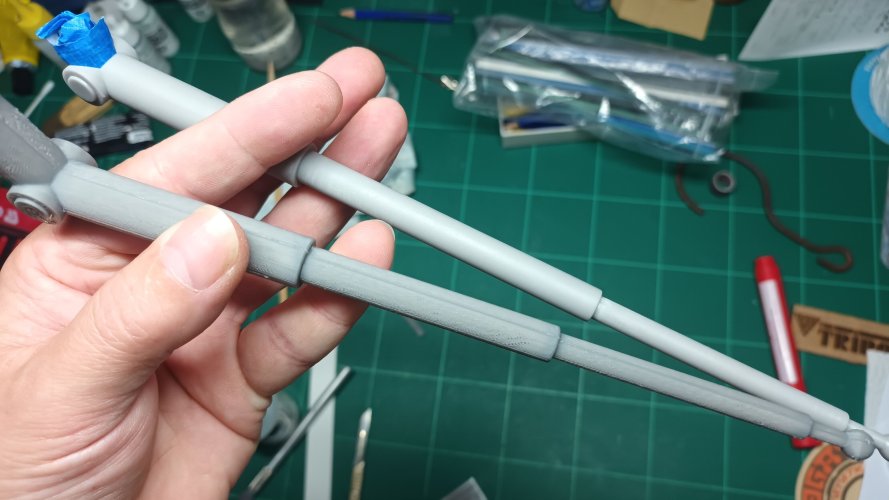

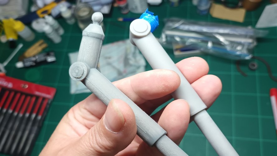

The differences between the filament print vs the resin.
The leg quality between the two.
All resin parts sorted.

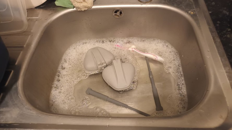

Just in case there was any residue left on the parts, everything was given a good scrub with warm water and a tiny amount of washing up liquid.
Parts drying

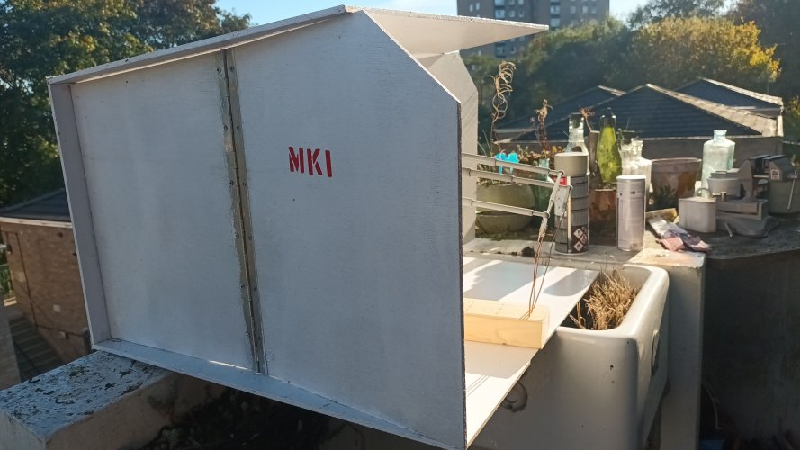

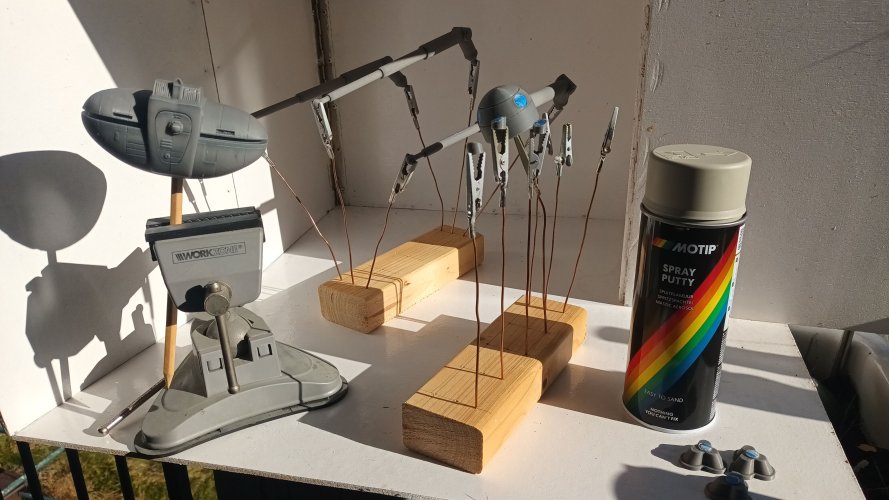

For spray painting I built myself a collapsible booth out of old bits of plywood - can't really spray indoors, so out onto the balcony with it!
Filament print first, and I used this automotive spray putty. Bit of a test bed for me this one, so we'll see how it works.
Kind of halfway between a filler/primer.
Despite having nearly the whole tin on all the parts, four coats wasn't going to be enough. More substantial filler would need to be applied.

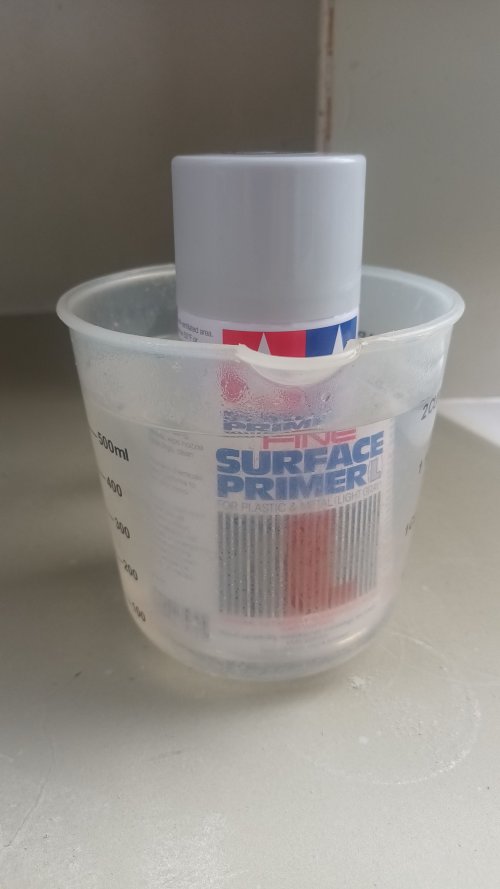

Resin parts were next into the booth, for which I used Tamiya fine surface primer. I've been told putting your can in very warm, not hot water, will improve the flow.
Its getting cold in England, so I thought I'd give it a try...

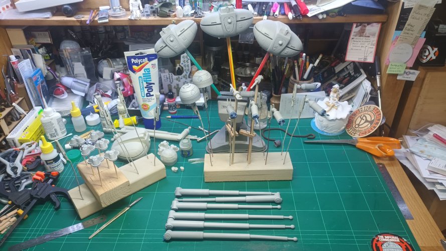

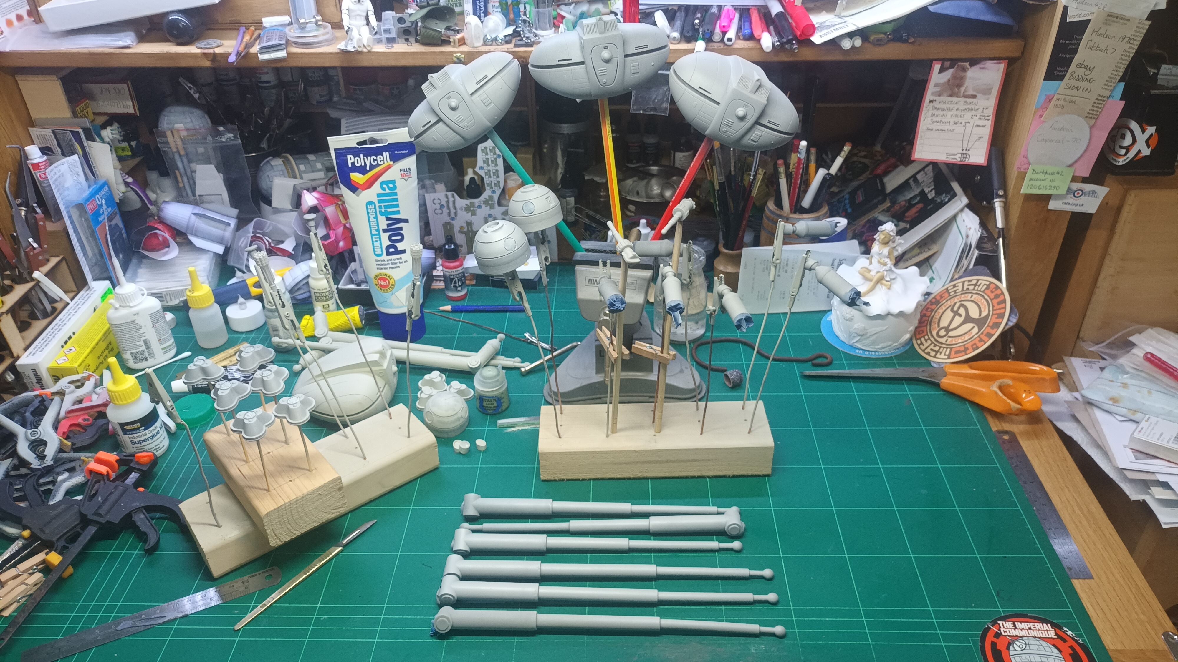

All three were back on the bench for a look over and to see what got missed and what I needed to do next.

The difference between the two materials show but I am sure some sanding and the first layer of primer will take care of it. Just wear a mask while sanding, wet sanding is better, too.
What is interesting to note is that all heads are asymmetrical. Both sides feature different details. Yesterday I found a model of the squatting miniature used in the show:

There were a lot of flying spiders about that day, the parts came back indoors 'webbed' - I do have a airbrush, but its early days for me to get a good spray at low pressure indoors.
Yes, they may look symmetrical, but not as you rightly say all have small differences.

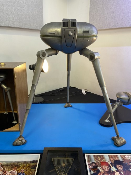

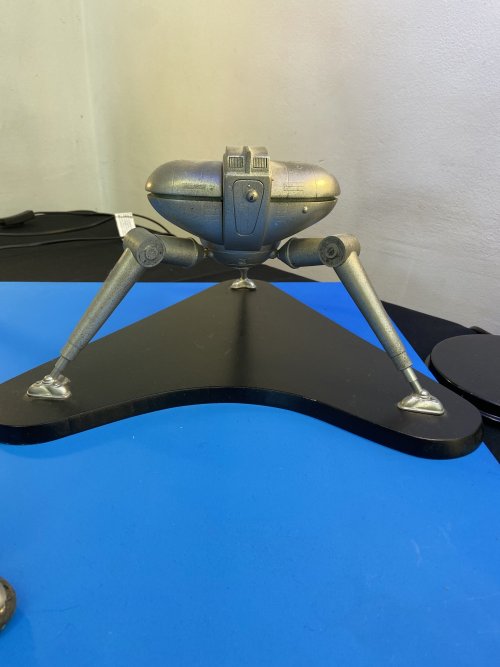

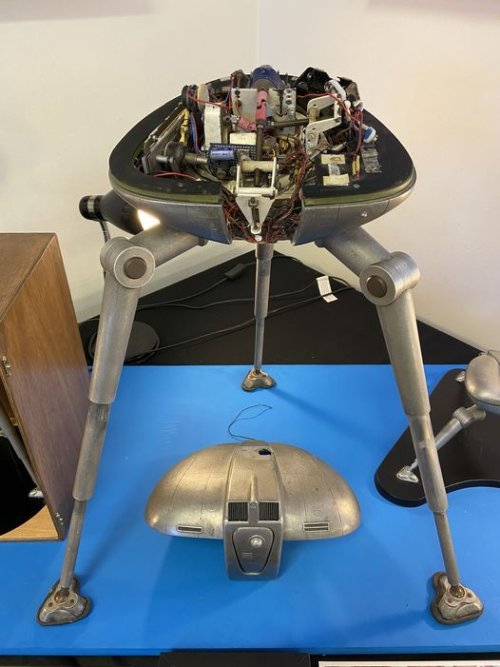

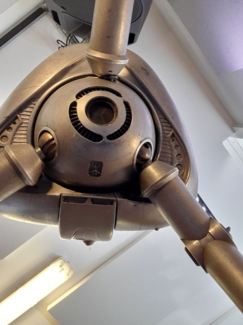

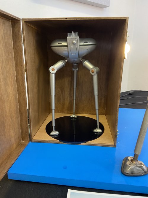

There were some of the originals out for display a few weekends ago, I have included them here for you which some fans took.
No red one... at the moment, whilst it still exists, it now a Police matter due to it being involved in a theft of props from a collector recently.

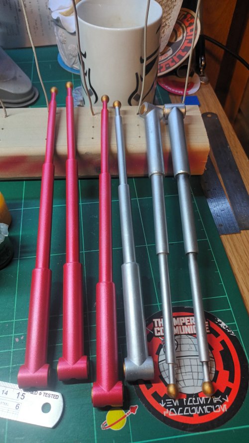

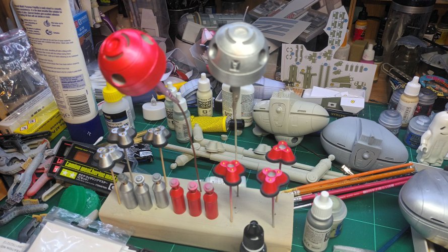

Silver Tripod on the right was not being painted silver, but Rub n Buffed instead - had good results on Twiki, and as the Tripods were not a shiny silver I thought this would look just right.

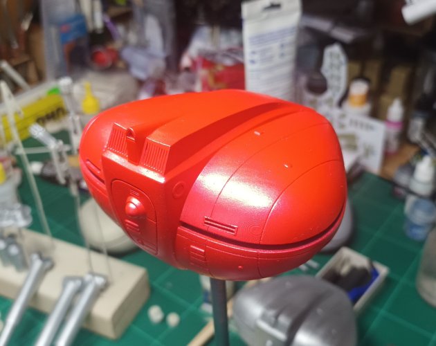

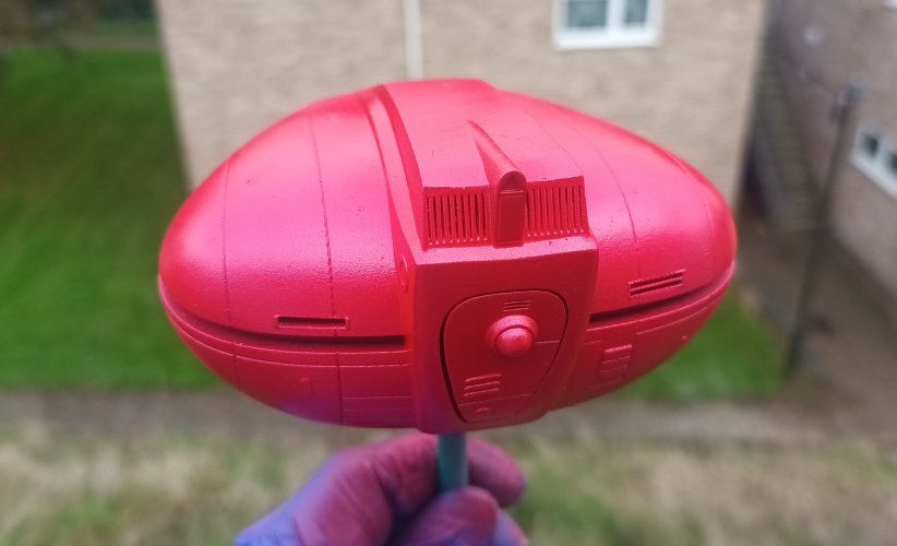

The other Tripod was to be red, so I have given the those parts a pink undercoat, which should give a better red topcoat.
Three coats of metallic red, which in this pic looks very vibrant.
Under my harsh work-light looks very orange. Although vibrant and completely the wrong colour, it did look better to the natural eye.

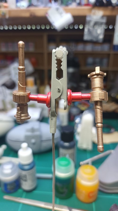

Some small details being picked out on the belly/torso sections and the feet.
Leg in their finished state ready for some weathering.

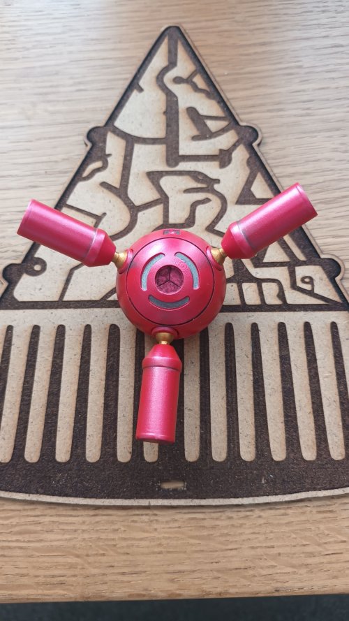

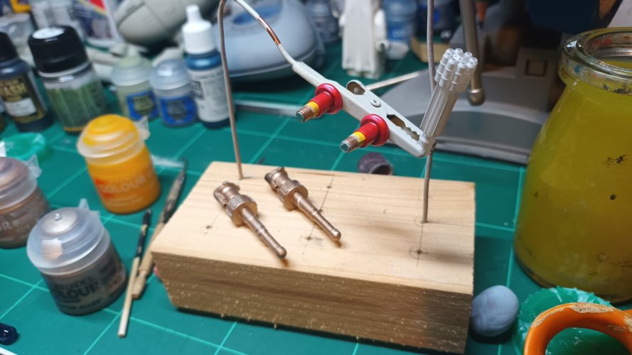

I decided to put magnets into the guns, I just know I was possibly going to catch them sending the model flying, so I made them kind of break away.

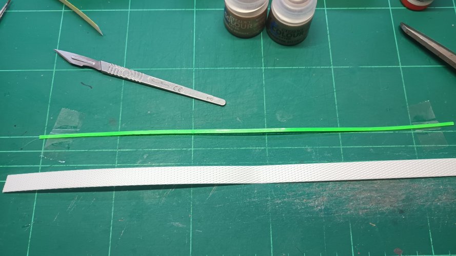

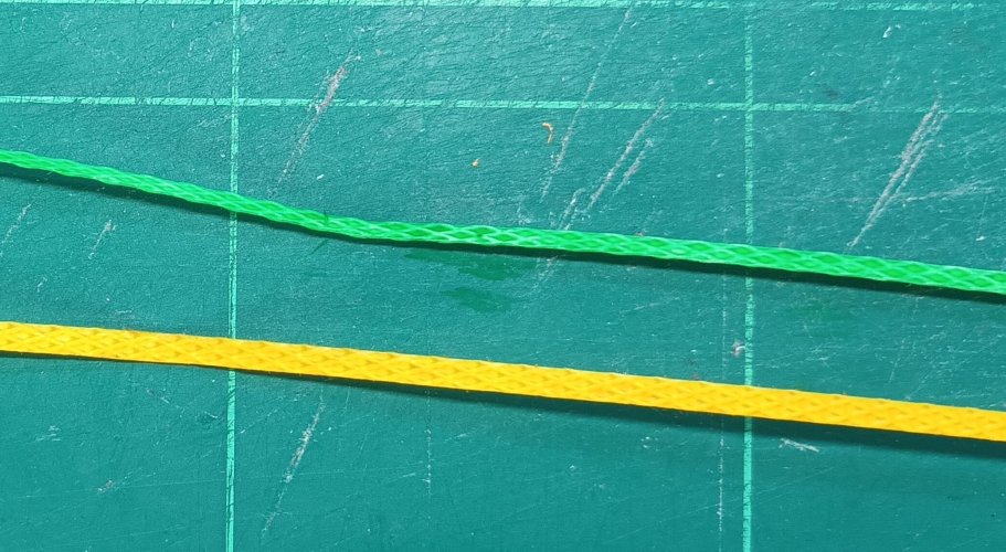

In the tv series the slot around the headpiece was illuminated at certain times.
The kit maker supplies a piece of filament strip to replicate this, but I didn't think it was up to much.
I found some packing strip, the kind which goes around heavy parcels and has a interesting texture to it.
Two small strips were then cut - one painted green and the other yellow.

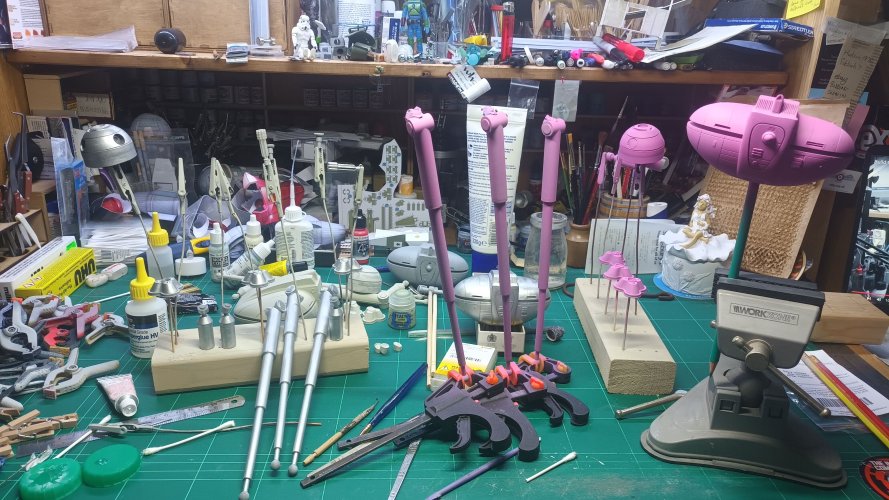

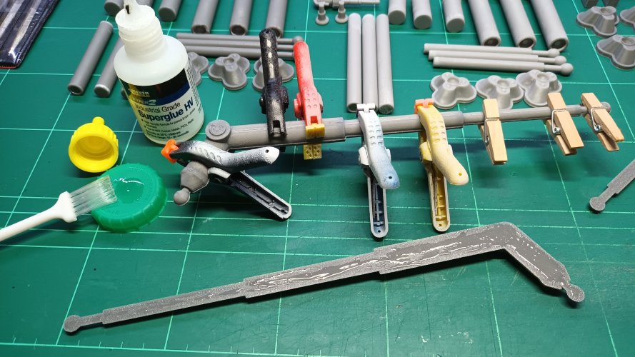

Legs were to assembled with the short stubs put into the torso first
Then when you need three arm to hold everything - I looked downwards to try and get everything glued - super glue really grabbed the resin quickly, so it was very easy to hold two legs, then glue one after the other within a minute.

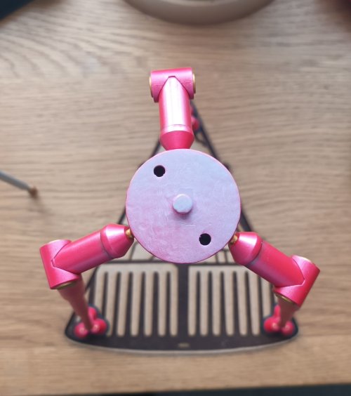

Thankfully the feet and legs all just about fitted onto the base.
Tomorrow the final reveal

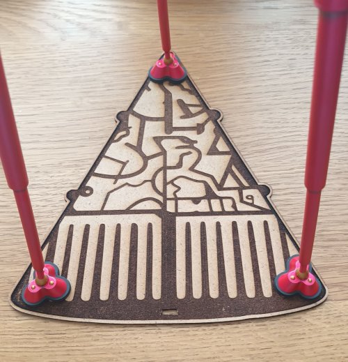

The base is a natural choice. To all who don't know it, this is a rendering of the mind-control plate which is implanted into the top of the head of the humans by the tripods to suppress free will and creativity.
Pure eye candy, especially the red one (pun intended; the idea of a tripod lolly is not too far fetched since it already comes on a stick - three sticks, to be exact, but the head is big enough for that, too! :biggrin: ).
