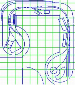

Mason Jar, Russ, here is the revision of my track plan and industries. 1 furniture factory. 2 stock yard. 3 slaughter house. 4 icing platform. 5 freight depot. 6 scrap yard. 7 team track. 8 freight terminal. 9 lumber yard.Thanks again.
Loren

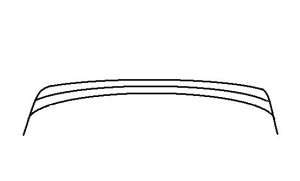

Hi Loren,
Sorry for the confusion. I think that you have enough room to make a staging "yard" rather than spacing out the tracks like individual passing sidings.
Here is another crude MS Paint drawing. I think that the area at the "top" would suffice. You can make these as long or short as you need, and you can even used curved turnouts at the "corners" if desired.
Andrew

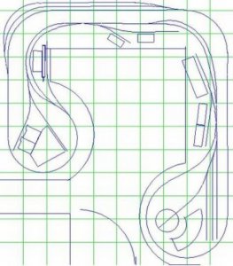

:D Mason Jar, I did some "slicin an dicin" and came up with this. What do you think? I also rearanged the icing platform track to give a little more room. Thanks for looking.
loren

Looks good. I would extend those staging tracks as much as possible. Running 40' to 50' cars, you only have room for a 10-12 car train. If that's ok, then leave it as is. In my experience, you can always use as much staging as you can fit.
The scenic divider can be fairly narrow. Building flats only need a few inches, and even treed hills can be made in as little as 3-4 inches.
If it helps you might consider running the main against the wall, and put the staging "sidings" on the inside.
Andrew

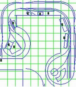

Here you go, Russ. This was a real good trade off. I lost a little bit of scenery space,:cry: But I increased the radius of the three curves, and the track plan operates and looks a lot!!! better, and I gained that run around:D . Wonderful Idea! Please keep the great ideas comin.
Loren

It is a little hard to see, but if you put a second crossover in the middle of the passing siding in the upper right curve of the inside mainline. That will allow a shorter run around track to work the lumber yard & freight house without having to run all the way back to the icing platform to get around the train. By the way, the temptation is to want to run long trains. You want to limit the length of your trains so that you don't have the the locomotive in one town and the caboose in the last town. I think your layout looks to me like 10 car trains would be about right.

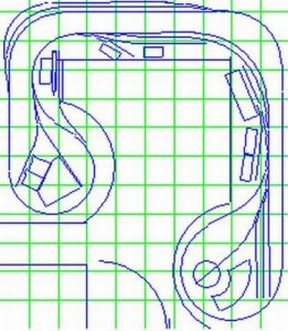

Russ, I sharpened up the image as much as I could and still keep the size down. Maybe this will help.
Loren:)

That is great. It looks really good, I don't think the passing siding/run around needs to be changed at all. It looks shorter when the ends are clear, so it will work for all of the other industries that don't use the run around at the cattle pens/slaughter house/ icing dock complex.
