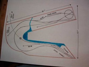

The logging area on my mushroom layout

This section is in one corner on the lower level. I used hi-tech to draw the track plan namely pencil and paper. This as fairly tight radius's and some steep grades but I think that's in order for logging trackage. The track gains height by using switchbacks. Any thoughts. Your ideas and suggestions are always welcome.

So you gonna use z track and equipment or standard gauge Robin? Narrow gauge would be quite cool. Fred
Thanks Will, but it isn't my idea. It's called Nn3 and there is a group of modelers who model in it and they have a yahoo groups and mailing lists and all. If your interested just yahoo search Nn3. Fred
I dunno what's avalible in Nn3 Robin. From what I remember in reading somebody somewhere sells shells to fit z scale chassis. There is a ton of info on the net on Nn3, I I remember NTrack has a manual for sell on their site I think. Fred
Robin, I'm sorry, guess I'm the one who needs to be corrected :oops:
I was looking for a switchback from the main to the small yard, didn't even think of the yard as part of the switch back. Sorry :oops:

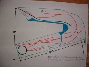

Thanks for all the great ideas here and in the narrow gauge area folks. With all this in mind I have made some changes. The actual logging track will be Z scale which is 3ft narrow gauge in N scale. Locos and rolling stock will be Nn3. The interchange with standard track will be in a section of dual gauge track, now did I really say that. I must have rocks in my head. How on earth will I do it? Will try and see how it turns out

One word comes to mind Robin, handlayed. :D
Solder them up on PC ties. Jon posted on one of the groups some plans how to build the turnout, in Freinds of Dash10 I think is where it is. Fred
Robin, I think I will stay out of Georgetown until the men in white have you carefully wrapped in a straightjacket. :D :D
Dual gauge track in N? Consider cardboard ties. Nails or copper brads through the ties and solder the rail to them.
Peco's Z gauge track is code 60.
Just when I need help, David OH well will be there to bug you at the Platelayers display at the Train Show. I have some of the peco code 60 on order from Whalthers. Will let you know about it when I get it.
An afterthoght: My friend Bill made dual gauge turnouts by adding a standard gauge rail outside a narrow gauge turnout. This was a bit of a kludge, but they generally worked. Even had a few on the main line.
If you try this, remember that a narrow gauge turnout has a sharper radius than a standard gauge of the same frog number, proportional to the ratio of the gauges.
