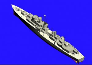

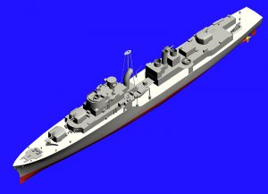

Barry has done such an awesome job continuing on with the 3D model, I am really keen to start knocking the superstructure together but I'm determined to get the whole "underwater" section finished before I get too far ahead of myself.
It's coming along nicely though, with the whole underwater section now ready to assemble in time for the final coat(s) of red paint.
Barry sent me the metasequoia model of the props instead of a PDO, and as much as I tried to get it to unfold into a buildable state, I had no idea what I was doing and kept unfolding the whole boat, which got a bit messy.

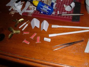

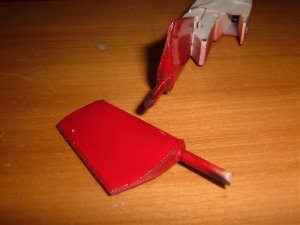

I cut my rudders out using a stencil I drew by eye looking at the plans. The rudders themselves attach to a bit of wooden skewer with a strip of card glued to it, to give the rudders their tapered shape.
I already had a PDO for the shaft hangers, these and the "bits where the shaft exits the hull" were the only two printed parts, the rest I made by hand. I made a couple of tubes for the propshafts to sit in, where the hanger bits attach. For the prop shafts, I used wooden skewers, then wrapped standard copying paper around the shaft till I had the thickness I wanted, then added extra strips for the wider part that sits in the hanger.
I also cut a couple of strips to use as bilge keels.

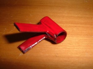

Here's some pics to try and make sense of the rubbish I just typed, unfortunately I still have no camera of my own and this one isn't a big fan of macro / close up shots:

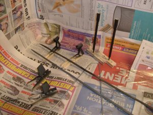

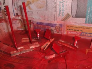

And of course, with the obligatory coat of black paint (hopefully the last time I need it, as I just ran out doing these parts).
Then some red....

Here's some close up shots of a few of the parts, to show the kind of finish I achieved. they look and feel like plastic parts already, without their final cleanup... ignore the fingerprints, that was Mr Impatience again.
Rudders:
Prop shaft:
Shaft Hangers:
The props themselves are done, in brass, but I'm not happy with them, they got a bit stained somehow by the epoxy I used so I think I might do them again at a later date, unless they can be cleaned / polished.

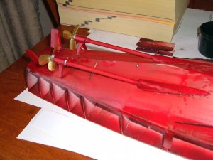

Here's how she looks after attaching most of the underside stuff, there's only one bilge keel left to put on now then I can go for the final coat of paint. There's been a few accidents along the way, but nothing that can't be covered up by the paint. :D

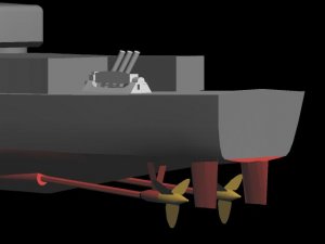

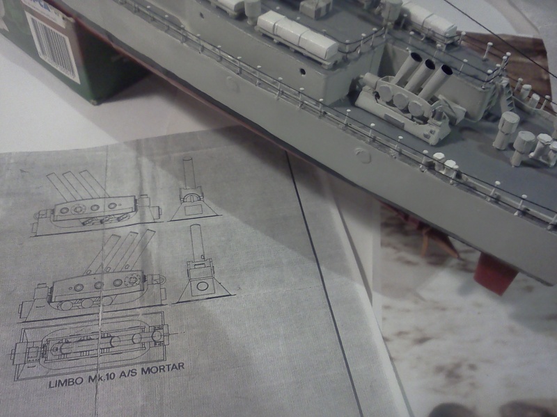

Don't if this will help or not
The props are not small judging by this
I like the real brass idea
barry
Thanks barry, that does help... they don't seem to be as oversized as I thought...
or are you just trying to tease me with that limbo launcher... looking good there... :thumb:

Jaffro the latest version hull and superstructure are the same still

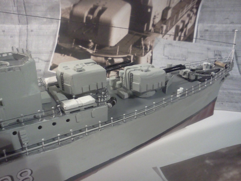

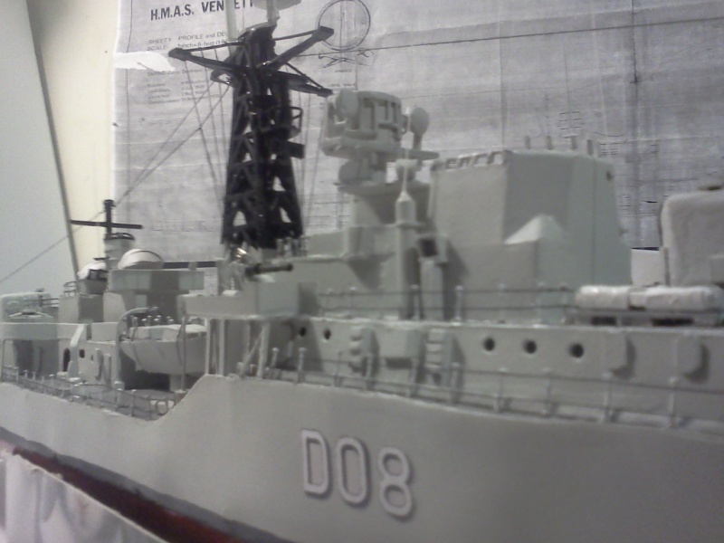

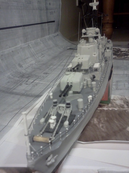

Well it's been a while, but I'm back to finally report this project was completed, almost a year ago now.
I ended up restarting at 1:200 scale to save me having to rescale the parts barry was sending me, and at the request of the eventual recipient who nearly fell over the first time he saw the 1:100 version ("where the hell am I going to put that?")

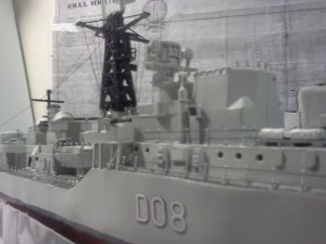

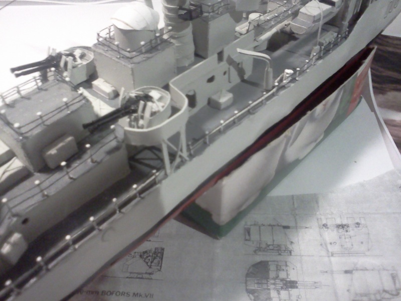

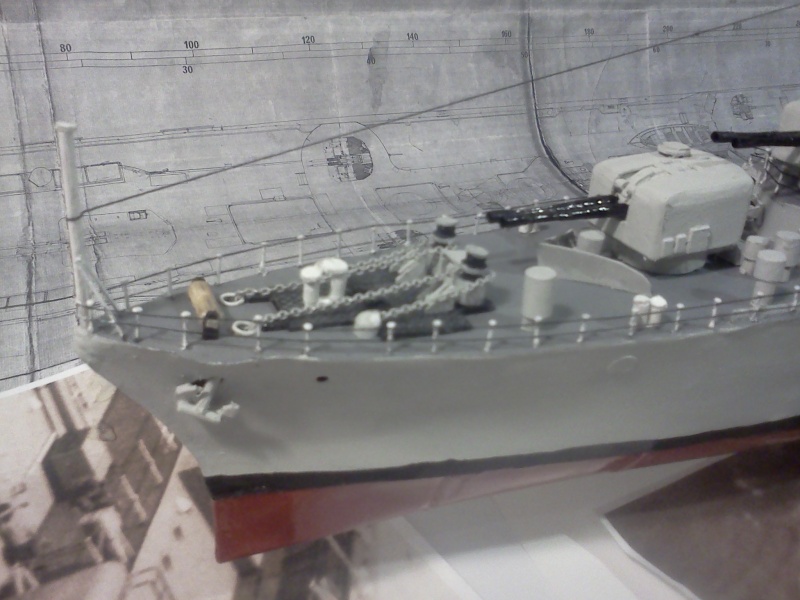

Due to some camera related issues there aren't many pics of the build, but here's a few of the completed model. I built it from barry's parts, added some extra details here and there then the whole thing was eventually painted by airbrush, spraycan and paintbrush.
IMG20110625_002.jpgIMG20110625_003.jpgIMG20110625_014.jpgIMG20110625_011.jpgIMG20110625_012.jpgIMG20110625_008.jpg
The finished model was everything I hoped it could be, thanks to barry's excellent design skills, without his help there is no way I ever could have completed this project. The final motivational factor behing completing it was the deteriorating health of my ex partner's father, who I built the model for. He lost his battle with cancer a few weeks ago after a long and painful battle, he is at peace now and I dedicate this thread and this model to him.
