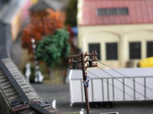

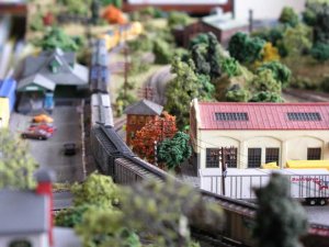

Here's some quick pics of the work in progress...three lines up...so many to go. What do ya think...worth the effort or not?

Yeah, that lineman is not too happy with the crew working for him. He's been complaining about the crew not keeping the right tension on the line as he's installing it. Man, you don't want to be on the receiving end of a LPP's anger. Plus someone turned off the power to the wrong box and left the signal up while a train passes. DOT and NTSB have been contacted...paperwork to follow.
Herc... sorry to hear about all those labor problems. That never happens here on the Montana Western Rwy., as all oy my LPP's are "model citizens" !

Herc Driver, they seem to add a very prototype look to everything. I think it will be worth the trouble (once it's over). I like it.

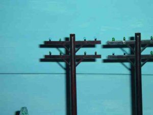

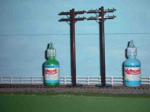

Glass insulators
An NMRA clinic suggested this stuff for insulators. I bought 2 bottles and the irridescent green looks more like glass than the other. I now have a couple of other bottles to try. From the vraft store, possibly for decorating clothes.
It takes a bit of practise to get them looking right.
