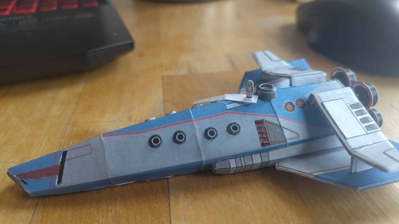

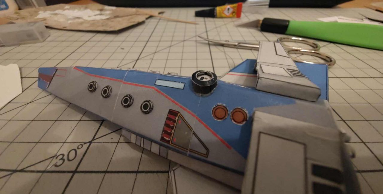

I added more details, few greeblies and started to design the template in such a way that I can actually share it someday.
I also added that round thing on the top which looks like an airlock/dockingport (ingame there is a turret located). It was missing in my first version.
I took my liberties with some parts from the model. For example these two elongated shapes on the sides, where the wings are attached, are atmosphere engines. The details on top of the upper wings are air brakes and control surfaces in my head canon.
Let's see how it will turn out!

Lovely! Does the hull on the CG model have a triangular cross-section just like your model or are the side walls curved?
The cross section of the main hull is a little bit more curved on the original. Looks like a heart upside down.
You can replicate that by dividing the horizontal faces and pulling the edges outwards. Two divisions should suffice for the beginning. ;)
Yes, in later iterations I can draw more faces. The way I did, I chipped away a bit of volume. But I can draw two more egdes along both sides of the hull to restore a little bit more bulkiness. The Teladi in space are known for trade and transport. That ship needs more cargo space :biggrin:
Yes more room for Teladiadium!

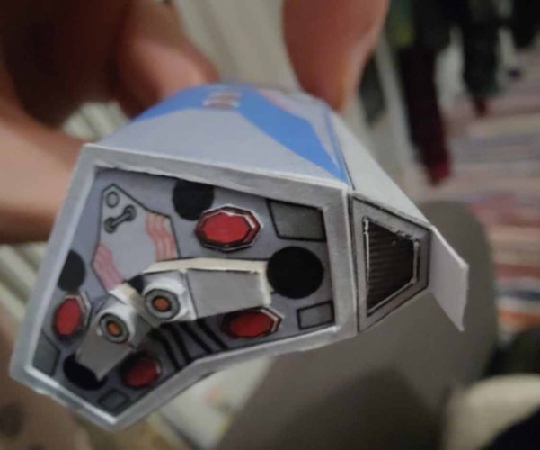

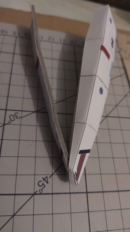

Reinforcing the hull with additional hull parts.

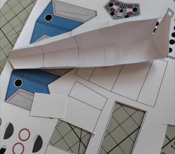

Closing the hull. You have to glue the bow of the ship together carefully and then close the whole thing along the body. Having reinforced the belly section with one or two grey boards helps providing a nice area to apply the glue.

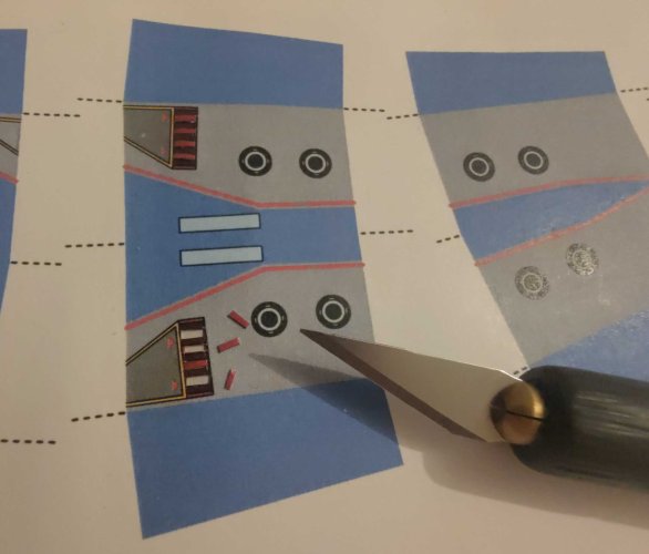

Cutting out the recessed details on the textured outer layer.

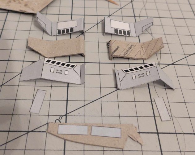

Greebling the new designed aft section. At this scale I just use multiple layers of paper for the really small parts, instead of grey board.

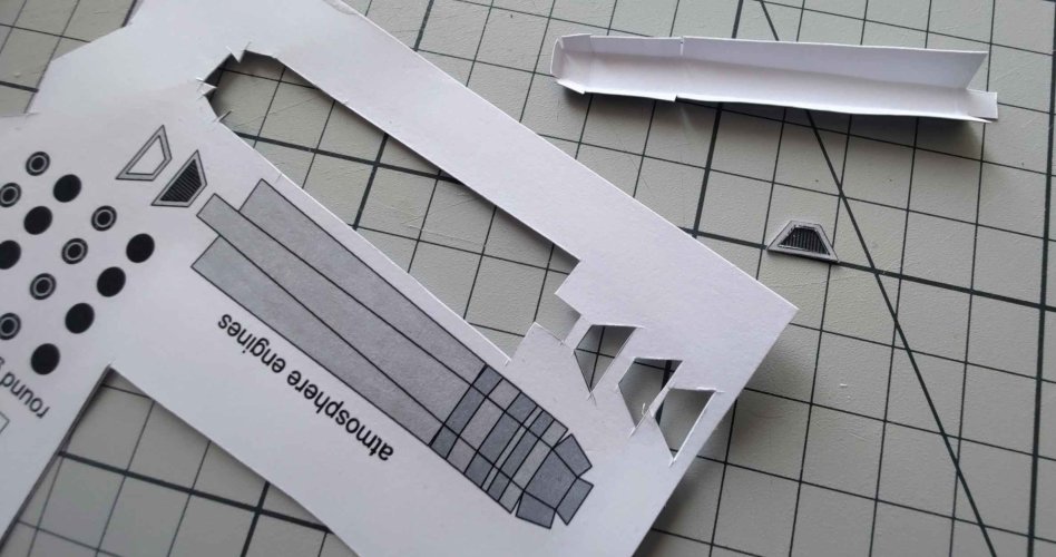

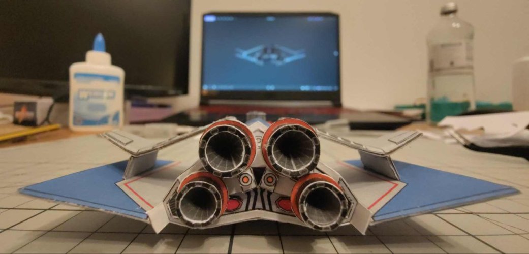

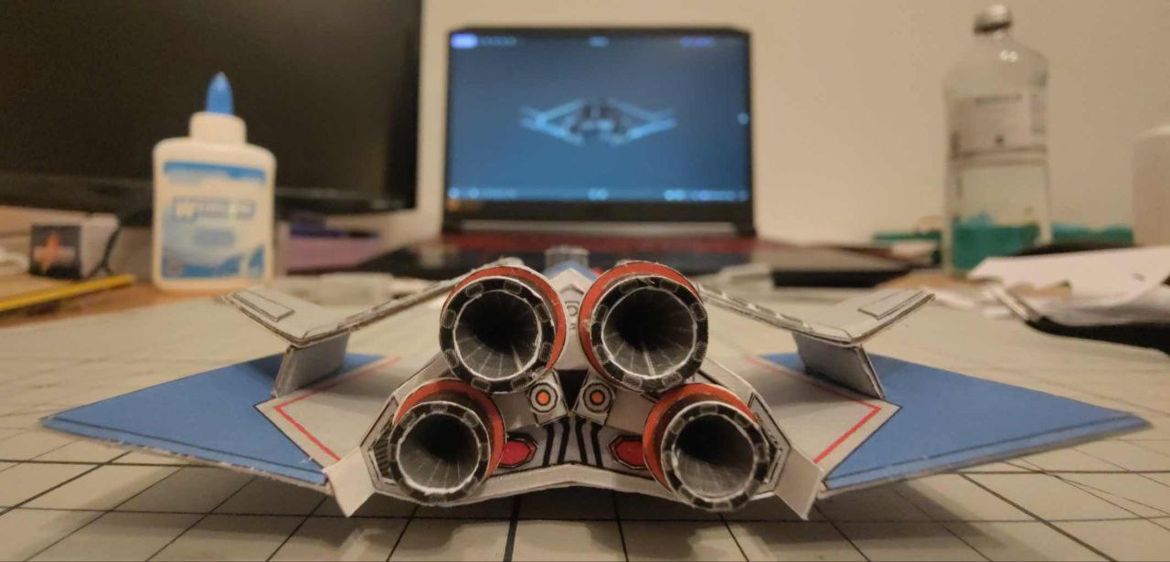

Assembling the atmo engines ...
and attaching them to the side of the hull.

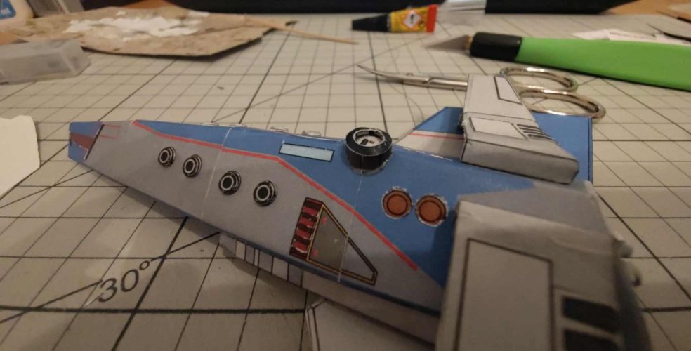

Laminating and adding the round thingies on the hull.
Laminating the upper wings to 1mm grey board. Did the same with the lower wings (forgot picture).

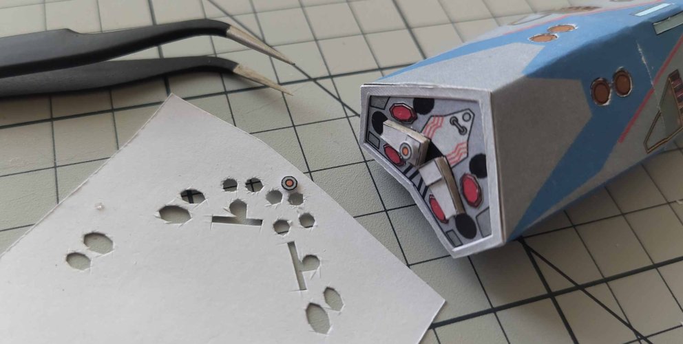

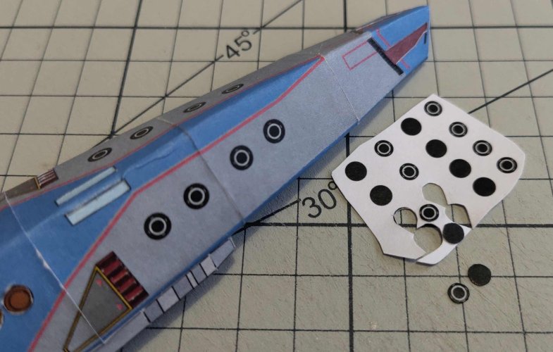

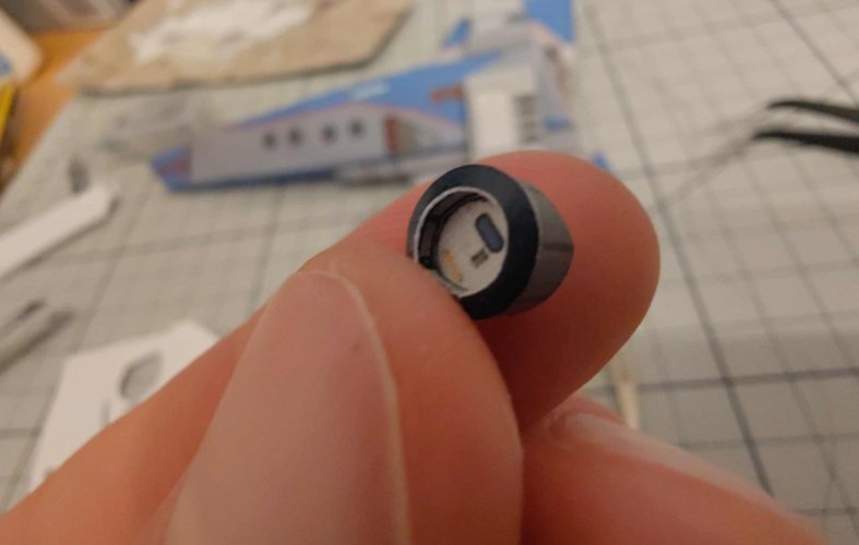

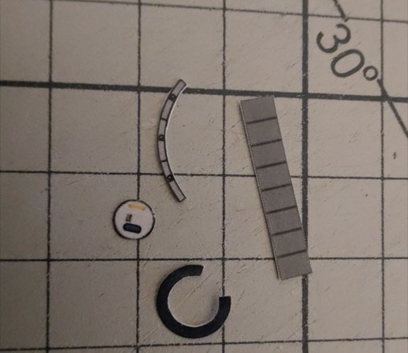

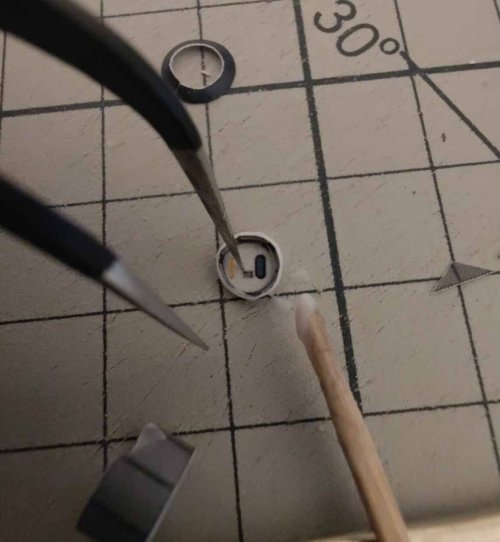

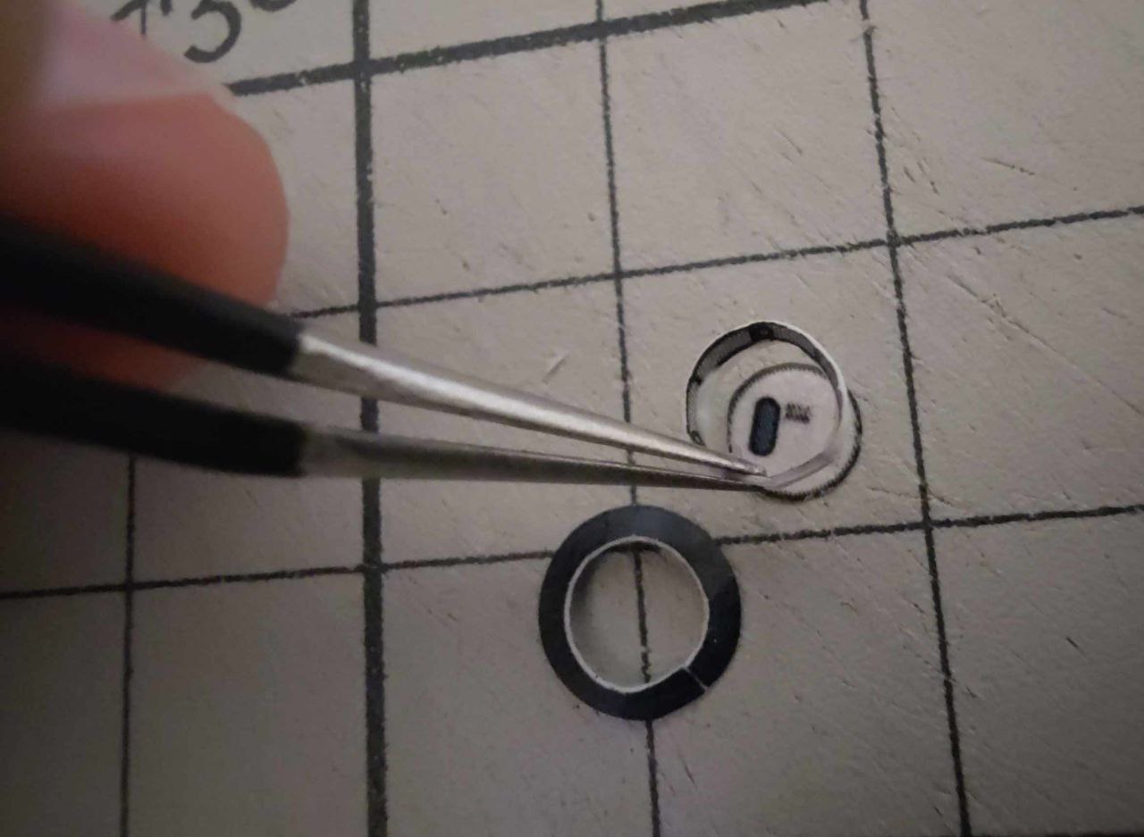

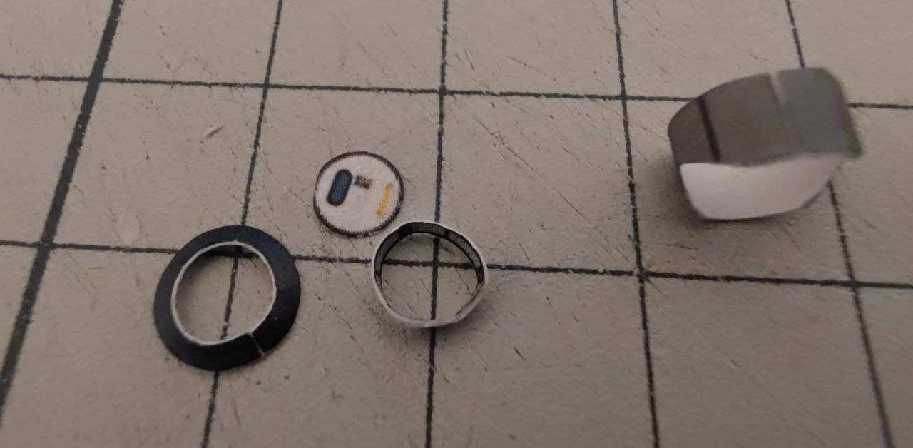

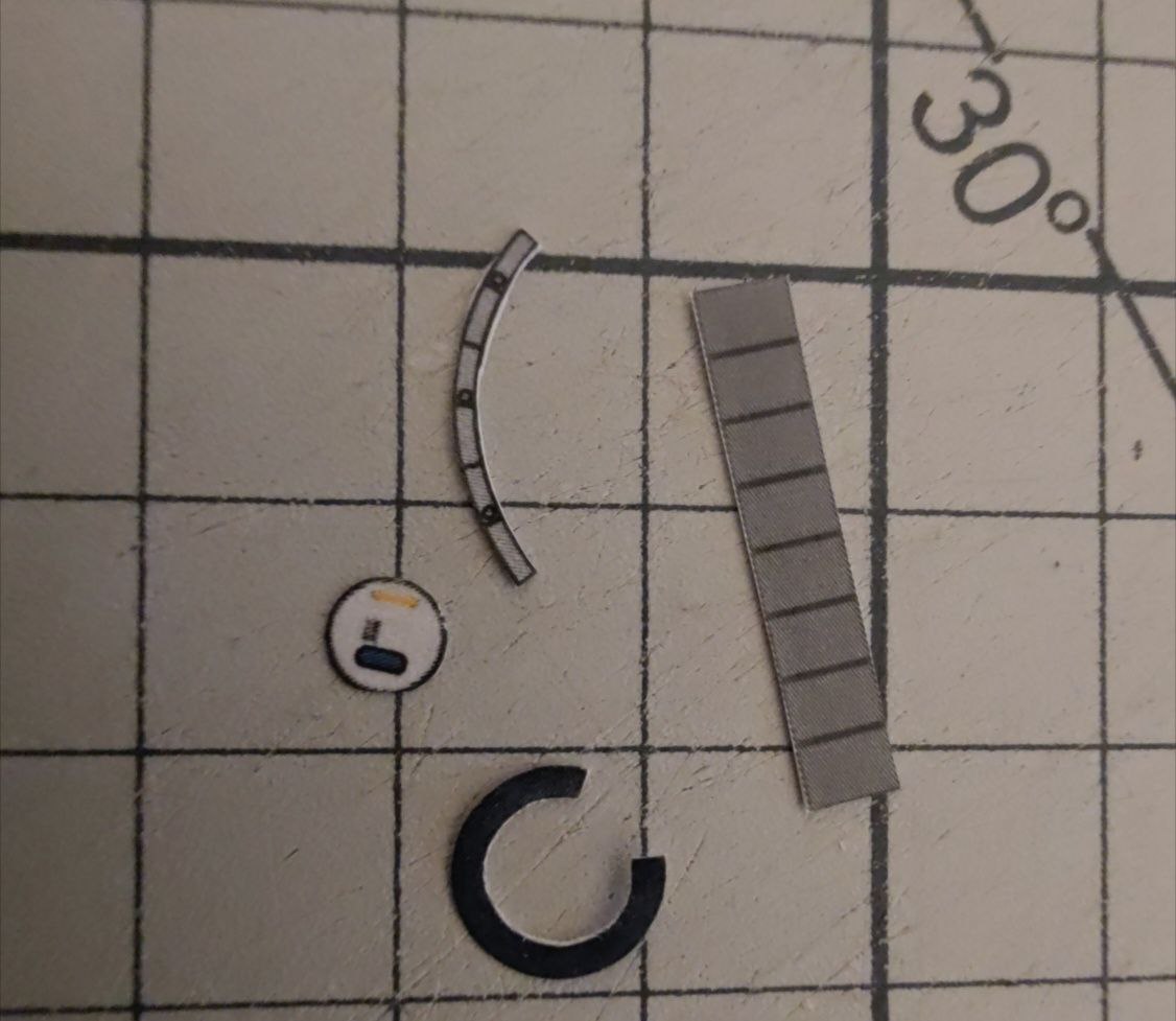

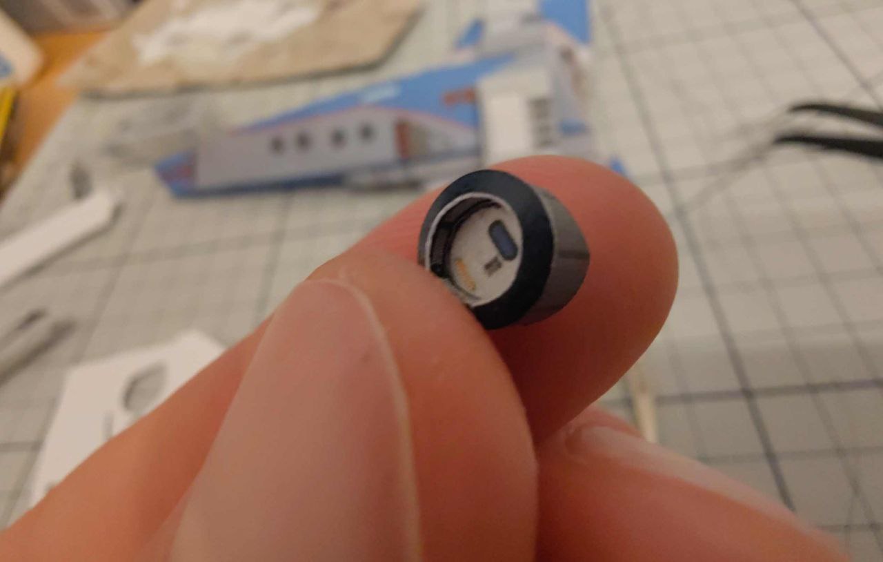

The docking port/air lock I designed (ingame a turret) is really small on this scale. It was a bit challenging but I managed to assemble it.

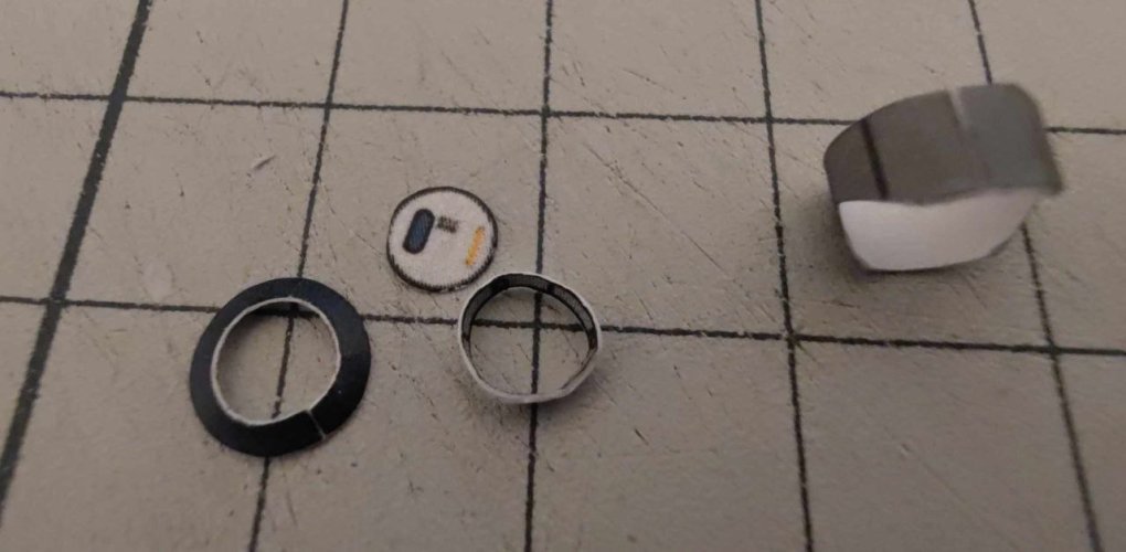

the parts (that "big" grey piece needs cut aways to account for the egde on top of the hull. you will see later what I mean)
preshaped

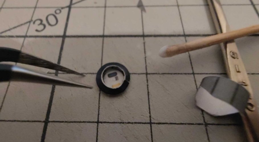

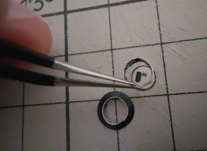

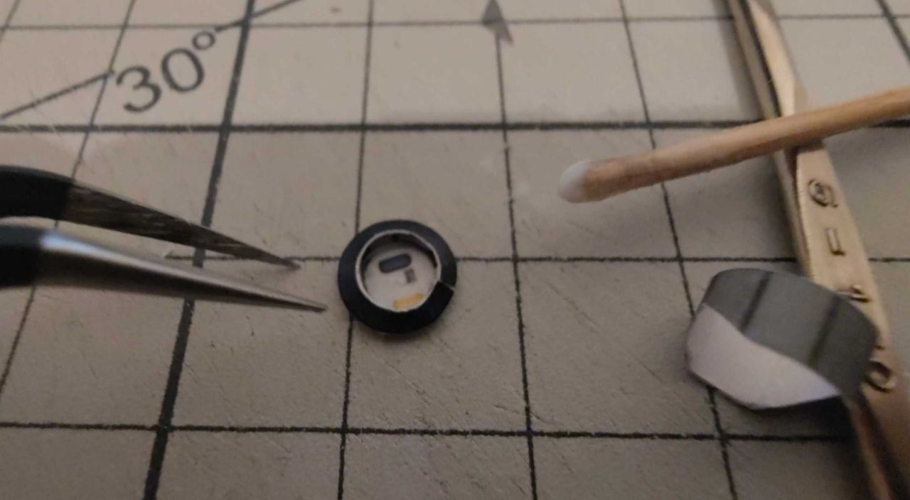

glueing the inner ring on top of the air lock to achieve a recessed door.

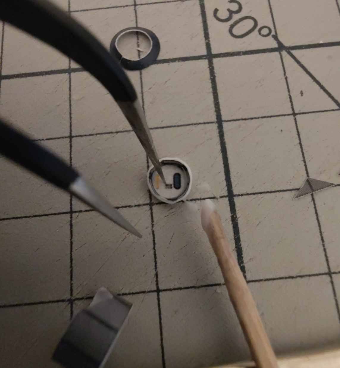

put glue on the upper rim ...
to settle the outer ring on top. after that put all that on the grey sleeve lying to the right of it in the picture. cut-aways nedd to go down to the hull.

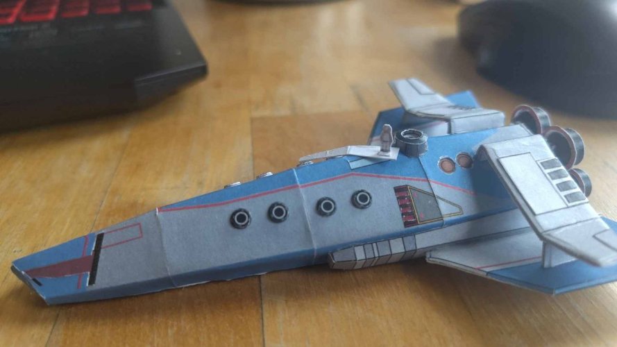

with paper mannequin to scale
proper arrangement of the engines.
preshaped
