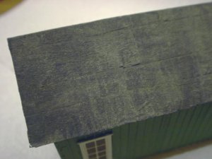

Here is a different technique for tar paper roofs. I must confess that I don't like working with sand paper, for me it is somehow too stiff.
So I use Kleenex tissue handkerchiefs. First I cut away the embossed outside margins, then I take the layers apart. Finally I cut the smooth portion in the center of the hanky into strips like... well... like tarpaper rolls. :D
Now to fix the strips to the roof: I 'glue' them on with PAINT. In this case I used Floquil Grimy Black, which I brushed onto the roof. Then I laid out the paper strips into the wet paint, Afterwards I soaked them with a second application of paint. The Kleenex paper is so thin that you almost always get some wrinkles. You can straighten them out with the paint brush, but I think, for an old roof some warping of the 'tar paper' is just what I want. (Be prepared to have also quite a lot of paint at your fingers - this is a bit messy!)
When the Floquil paint is dry, I apply some washes in lighter colors: Dust, sand, grime, light browns (depending on the general colors of your landscape). And in this case I also added a tiny amount of a brownish green to suggest some algae and moss growing on the roof.
Ron

Hi Ron,
That's a good looking roof-the wrinkles do give the appearance of curling tar-paper! I hadn't thought of that mossy look, although, since I model the sunny Southwest, I don't think moss would survive a hot summer day!
Gus.:thumb:
