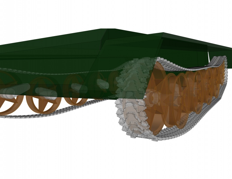

I've always wondered how people do this. I think I have come up with a method. I had to "Array Object along a curve" to get the tracks to line up right. Not having measured anything, I subtracted the tracks till the all bent at the appropriate place. The "Flow along Surface" command distorted the tracks. It may work for this. Probably something I'm doing wrong. I need to research it more. :)

If the track is long enough, I think a method could be to glue it on the upper parts of the wheels.... at least, if the ensemble wheel/track it's not supposed to be "functional". Just an idea.

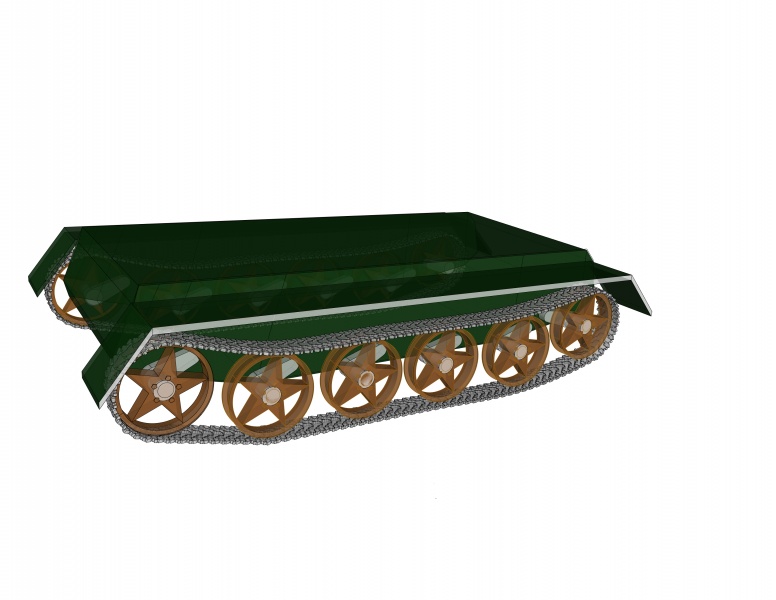

I'm sorry. I should have clarified. The track links are each separate parts. The trick was trying to have the tracks follow a surface and bend according to the parts where they are linked in a virtual C.A.D. Render scene. That is what is demonstrated here. It seems right. Looks can be deceiving! :)

Thanks. This section of the forum is for illustrating and rendering. Poeple who have knowledge of such things are welcome to offer up ideas. I worked primarily with Rhino3D 4.0 and 5.0. By practicing parts it can improve model making. Making a model render nicely really has nothing to do with making a model tat can be made into a paper model. There is a place for nice renders though and by studying renders, one can figure out what compromises have to be made to make a paper model.
Rendering for the sake of rendering is also a lot of fun. :)

It would be, but people do build them link for link, and they look stunning! :)
