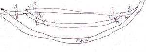

This is what I've got. These 2 switches have metal frogs, all the rest are plastic. I have plastic joiners at C and E. Do I need to insulate ALL joints and run seperate leads to everything? It really loses me. I think it will be easier (spell thet simpler) to just use switches with plastic frogs.
Lynn

Are those tracks stub end or do they go to other switches on the other end and back too the layout? You might have inadvertantly put in a reverse loop. Even with the metal frogs in the Atlas Custom line turnout, you won't get a short unless you wire the frogs for power. As they come from Atlas, the frogs are dead on Custom Line switches.

I haven't done any ballasting as yet. I have insulated joiners at C and E, and at J and L at the other end. If I insulate G and H also, it runs OK as far as I can tell so far. I guess that is it, but I don't understand why that would be necessary because it looks like the south side is completely isolated from the north side.

Yellowlynn, do you have gaps on the mainline tracks which you did not draw? Directly beneath B and H? I can't speak with absolute certainty about Atlas turnouts, I always thought they all had unpowered frogs (some with the ability to easily power the frog) and the rails beyond the frog were not switched in polarity when the turnout was thrown. Having said that, when using turnouts which throw the polarity of rails from the frog, you need to insulate both of the rails leading from the frog. The outside (stock) rails don't need to be gapped. In your drawing, A and G, C and J, F and M don't need gaps. Just below B and H do. If "power routing" turnouts are the cause of your problem, that is the solution.

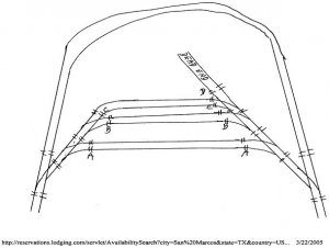

I have hit a complete and absolute block. I am trying to run a block system to set trains on sidings. I used insulated joiners ALWAYS on the same side of the track. If switches reverse polarity when thrown, why? With a simple oval, and 2 switches for an inside siding, no problem. I'm trying to do virtually the same thing but I end up with a dead short. I still can't draw but here's a different one. I double lined all joints, but I have insulated jouners at A-A, B-B, and C-C, plus D. A power lead goes to those 4 tracks. The switches on the left stay dead, or I get a short. I'm ready to give up and just have stub sidings.
Lynn

I know it may be a bit redundant, but have you tried drawing the track plan with two colours - one for each rail? That might help you identify where you are introducing a short??
Just a thought...
Andrew

Everybody has good ideas and I keep trying each one. The 2 colors never conflict, UNLESS one of the switches has a short. No matter what position each switch is in, it is always the same. All switches on the right side work beautifully. When I get past the block on the left, to the switch, it goes dead.Any attempt to make the line live makes it a short. I have never ran into this before and had the same setup. This is the first time using #6 turnouts, so evidently they have got to be the problem.

From looking at your drawing, you have exceeded yourself in the gaps you've placed. You don't need gaps anywhere on the outside rail of your loop. You also don't need them at the points' end of your mainline turnouts. You don't need them on the "outside" rail of your track ladder going to your "dead end" siding and the ones beyond the frog rail coming off the mainline switches on either side of the loop. You have correctly isolated your sidings going across to the other side of the loop. I understand you have these tracks controlled with an on-off switch to be able to "park" trains there. All this leads me to believe that you have done a lot of "jumping" to power all those isolated switches and sections, and you probably have incorrectly "jumped" one or several of these sections. I use two different colors for wiring my track: one color for the "outside" rail, and another for the "inside". This way I can see if I've jumped the track sections correctly (outside to outside; inside to inside). If need be, I follow a rail all the way around with my finger to determine if it's outside or inside.

Gus, you are right in all you say, but I didn't make myself clear. All those crosslines are ONLY where switches are joins to other track. Insulated joiners are at A-A B-B C-C and D, to isolate blocks. I've been running a test loco from right to left. Everything is perfect until it gets to the switches on the left side. they are dead, no matter which direction they are thown. Jumping past the blocked joint is a short. All the problems are on the left, so I'll replace those switches one by one.

I have taken the liberty to modify your drawing to better attempt to show you the way this set-up should be wired.
The small red marks are where you need plastic rail joiners to isolate the sections. The purple "wires" are jumpers from the outside rail to the rails in the yards; the blue "wires" are jumpers from the inside rail to the corresponding yard rails. To turn on & off the yard tracks place an ON-OFF switch between the purple jumper and the yard rail.
Hope this helps.
Gus.
