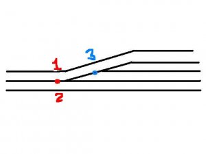

Okay, revisited, with a diagram:
russ, yes, I am speaking of the apparatus that a switchman would use to manually throw a switch on the prototype.
Looking at the following diagram, the red dot and blue dot are the turnout points. Where might the switch stands be located? The rods would be routed under the adjacent tracks? The red points may be controlled from location 1 or 2, and the blue from 3?
Gary: I've never seen a setup just like that one with sidings in the middle.
I would expect the railroad to put both switchstands on the north (upper) side of the tracks but to swing the single north track around them.
You don't really want Brakie dropping off his car and running across a set of rails to throw the switch. And both stands should be positioned so that noone has to cross the tracks to go from one stand to the other. (an exception would be if the was another siding coming on the south side.)

I just noticed in the "Canadian or Canadien" thread.... photos of the prototype boxcar... the switchstand is in between the tracks which are on relatively close centers. So I could do that too. HO scale, track on 2" centers, switchstand between tracks?
I don't have the issue in front of me, but the November '07 (most recent) issue of Model Railroader has part one of an article by Paul Dolkos on detailing the right of way, and there is a chart with standard distances for lineside items, from the centerline of track, for the B&O. Due to equipment clearance diagrams, the distance for tall or high switch stands is further from the CL than for low-mount stands. In the diagram you have drawn, Gary, I would say that low stands mounted to the top (in the drawing) of each switch, between the switch and the adjacent track, would be the logical placement.

Thanks for the input! I'm still not quite certain they would be there, but evidence is mounting that they would be okay there.
Here's the info from MR, which should be applicable for whichever location you decide on: this is a B&M (not B&O) standard from 1960; on tangent track, low switch stands would be mounted 6'-9" from track centerline, and high stands 9'-3" from centerline. Since you are looking at a curved situation, these distances can be increased to accomodate equipment overhang.
Gary in the case of the small U.P. (ex SP) yard that I mentioned earlier, the yard ladder had an embankment with an access road adjacent to the tracks. The manual switch controls were mounted between the access road and the first track,and those controls would operate about 10-12 switches if memory serves. Also when doing research on railroad practices, remember that federal safety laws are updated regularly. That means that something that was done on the B & M in 1950 may well be different in 2007. Also the BNSF as railroad policy views the federal "blue flag" laws as a minimum standard, and they will not hesitate to go beyond the federal law if they find a safety improvement. In the final analysis, you need to research the practices of your railroad in the era that you are modeling. If you are modeling 1980s-1990s Santa Fe, and you are freelancing an industrial area, you might be able to locate a similar track layout nearby and see how the prototype does it today.
I agree with Russ - if you really want to be prototypical, try to find a similar instance on the prototype you're modelling. The UP / former SP that I model around Colton & Fontana, CA has plenty of examples of the switch stands located between the tracks, as you have drawn, though I've noticed that they sometimes have a wider area between the tracks in that type of situation, probably providing a safe amount of clearance for someone to stand in the space with moving trains on either side. I've attached a slightly revised version of your track plan showing this.
