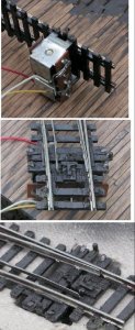

No need for those long pins just attach as per photo, much easier.

Them's is Peco ones in the pics! Yep....
I've done my elevated turnouts like that (in the pics). Those that sit on track above the baseboard. They are buried in ballast and scenery now, and I'd have to dig the whole lot up if I blew a turnout motor. The ones for track directly on the baseboard, I have mounted, using the long pins, under the baseboard.
With the ones I've buried, I just figured that I'm more likely to break the turnout, than have the motor blow, and I'd have to dig the turnout up as well.
