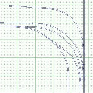

Here's a rough preliminary sketch of my idea for a free-mo module -- "Susquehanna Junction", can be used as a corner, straight, or both:
This was sketched with general-purpose drawing tools; I gather I'll do better using a dedicated track layout CAD application. No easements are yet shown. Track 4 is drawn straight; only optical illusion makes it appear to bend away from the double main.
The benchwork fits inside a 63" (5-1/4') square. Tracks 1, 2, and 3 are all through mainline. The radius on 1 and 2 is 48"; all other curves are radius 24" -- if your equipment can't negotiate, you don't need to go down those tracks, eh? All track is level, no grades. No track is closer to the benchwork edge than 4"; the mains are all 12" from an edge.
Track 4 might be modelled as a passenger terminal except that pax cars are just the sort that might have trouble getting around the tight curves -- and long trains will foul the main. Perhaps it will be better as an industrial siding. I see Track 5 as a heavy industrial spur -- literally on the wrong side of the tracks from town inside the corner. Track 6 might be fairly dilapidated, even abandoned. The area to the side of Track 3 might be agricultural.
I like a road leading out of town to the farms, at the bottom, crossing Track 6 and the double main. Another road connecting the heavy industry to town seems wise. That gives me opportunity for two grade crossings, with attendant annoyance to town drivers.
I don't think I have enough patience or skill to hand lay track. So, I'm thinking flextrack and bought turnouts.
Questions, questions:
* Who likes which manufacturers of track and turnouts? This will be all code 83.
* How should I handle the easements? Free-mo standards mandate 2" spacing of the double mains at module end but around the big curve, that needs to go up to about 2-1/2".
* This is a pretty big module. Does it make sense either to (a) shrink it a little for better portability or (b) enlarge it a bit for better operations?
* Should I account for the optical illusion when planning Track 4? That is, should I build it with a slight curve throughout its length? I don't want to foul the inside main any more than I must; as it is, the siding will only accommodate a few cars.
* Recall that free-mo has no "front" or preferred viewing angle. Still, the probability seems high that at least at times, the junction will be used simply as a corner and shoved into a room corner. Therefore, the town area will be towards the viewer. Does this work for me or against me?
When operating this module by myself, I won't have much ability to do anything at all as it stands. This is actually my plan for my *second* module, the first being a long, straight double main with a couple of crossovers. (Maybe in two sections). That will allow me to run a train, say, from Track 5 onto the "first" module, change mains at a crossover, and back on Track 1 or Track 4, perhaps setting out a car on Track 6.
* Would I be totally insane to consider a curved crossover between Tracks 1 and 2?
As always, general comments of any nature are not only welcomed but practically demanded.

OK, beyond operational questions, first, the question of reality must be addressed.
The bad news is, your specs aren't going to work. There's no way you can squeeze in a 48" radius curve and get the rest of it to fit.
Now, the good news... you can kinda do it. Here's your plan with a 32" radius on track 1, 34-ish" radius on track 2. The mainline turnouts are #8, the secondary tracks have 24" min radius and #6 turnouts.
I've included the plan file for XtrkCad. It's got a bit of a learning curve, but it's free, and quite powerful. Play around a bit, you'll have a better idea of what you can and can't do in that space.

Please confirm that Free-mo (as you plan to use it) requires a double main centred on a two foot wide interface?
If that is the case, I would say you can approach the 48" radius on a 63" square. We (Ottawa HOTrak modular group - trouble with web site currently) use a 42.5" radius on corner modules that have a footprint of 53" x 53".
With a quick glance, 63" appears to support a 48" radius:
63" - 13" offset for inside track = 50" This should allow 2" of straight track at either end of the curve at the interface. I do not know if this is enough for joiner track length. Also if you plan to use easements for the curve, it may be advisable to reduce the overall 48" radius to 44" or 42" to all for this.

The issue is that the plan
shows turnouts as continuous-curve-meets-straight. Real commmercial turnouts appropriate for these curves are much longer. The turnouts for track 4 are curved on both legs, and would have to be hand-laid.
The issue is that the plan shows turnouts as continuous-curve-meets-straight. Real commmercial turnouts appropriate for these curves are much longer. The turnouts for track 4 are curved on both legs, and would have to be hand-laid.
What he said. :)
You might be able to get away with Walthers curved turnouts, but with straight turnouts (even #6's) you're not going to get a 48" radius in that space. Easements make the radius even tighter.
So, if it was just the curve, you might get away with it. BUT...
- Standard commercial turnouts (one straight leg, one diverging) will reduce the radius
- Easements will reduce the radius
- Setbacks required for Free-mo "spec" joiner track will reduce the radius
My example above of a 42.5" radius on a 53" square is indeed based on an uninterrupted curve - no limitations as above... wall1
Squid - in your XTrkCAD plan, the tracks leading out the the left do not seem to have the same relative spacing as the ones at the bottom. Although Xiong has not confirmed yet, I believe the double main Free-mo standards call for the track to be 2" apart, centred on a two foot end (i.e. each track is one inch to the left or right of the module centreline). I also think that track 3 will need a slight wiggle, in order to be on the centre to meet with a single main Free-mo module. This is probably less critical, since the entire module can be shifted slightly (as long as alignment pins or bolts are not used).
Andrew
Andrew,
It's an optical illusion... they're both 2 1/4" apart. I was less concerned with the finer points of Freemo standards than with a proof-of-concept plan demonstrating that the original specs ( like 48" radii) weren't going to work.

To be exact, any radius between 40" and 53" requires 2-3/8" centers. This radius is measured at the inside track centerline. So, in the simple case, one could build a conforming layout consisting of a perfect 40" circle with a concentric 44-3/4" circle. The more cautious 2-1/2" centers are my choice.
Both tracks certainly can be 48"; if so, though, they won't be concentric. Since they must, as a free-mo requirement, exit the module on 2" centers and increase spacing through the curve, the tracks can't be completely concentric anyhow. At least at this stage of design, it's easier for me to sketch both radii equal.
The major issue for me is how to figure the easements that make it all work. Precise plans depend on exact measurements of included turnouts -- and that's why I want to get recommendations on those.

If you want 48" curves, you're going to have to handlay your turnouts. The Walthers #8 curved is the largest RTR turnout out there (that I"m aware of). The outside radius is 36".
Also, 48" is the preferred radius for mainline track - the minimum is 42". Both are incredibly generous by modeling standards.
