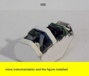

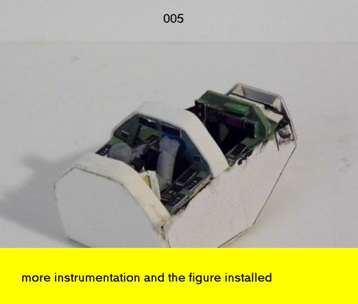

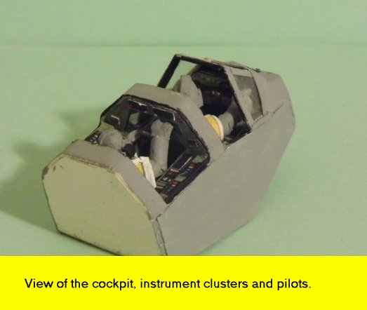

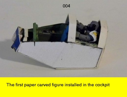

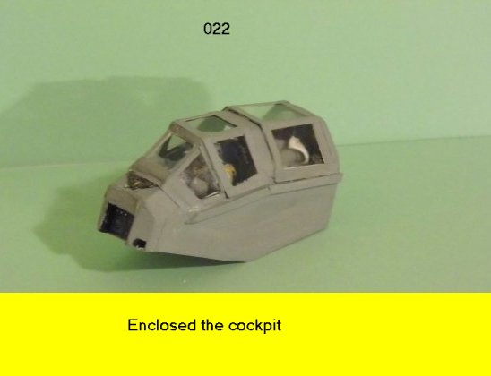

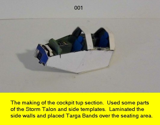

I have been having some problems with my camera in that it keeps shutting off and killing the batteries too fast. I hope that it will hold out for this build, or I will have to revert to my old 3 megapixel camera. The photos of the cockpit build start up, for some reason, disappeared so I will have to start from the built tub forward. In one of the photos, you will see one of he carved Space marine and the last photo is the start of the building of the figure. Enjoy and see you all soon with more updates.

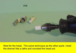

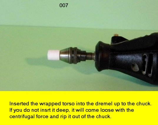

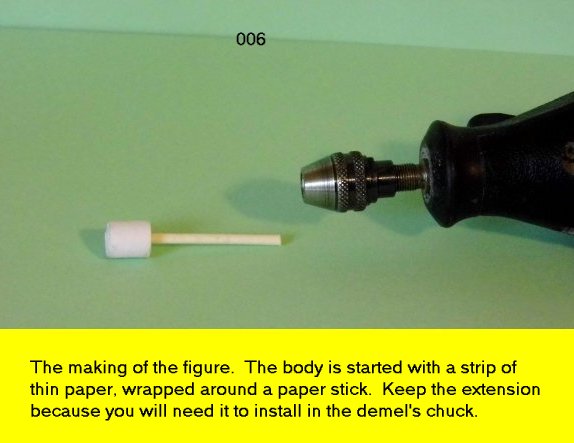

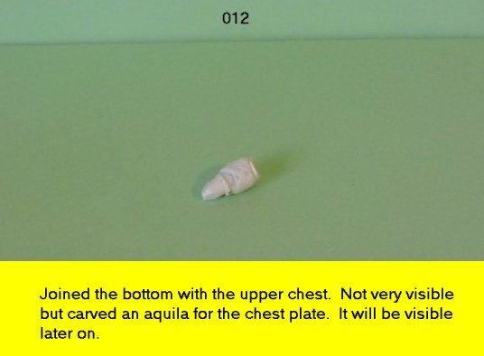

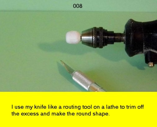

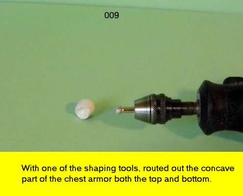

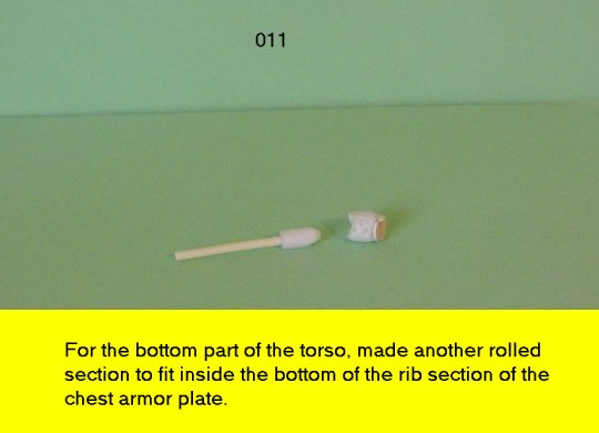

Since I cannot proceed until the figures are done, here is my attempt at making the Space Marines out of paper. The dremel comes in handy for this part of the carving process. As usual, the size of the picture pixels determine the sequence, so they are numbered because of this discrepancy. Enjoy and see you all next posting.

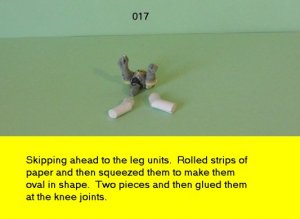

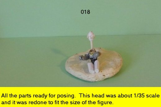

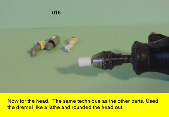

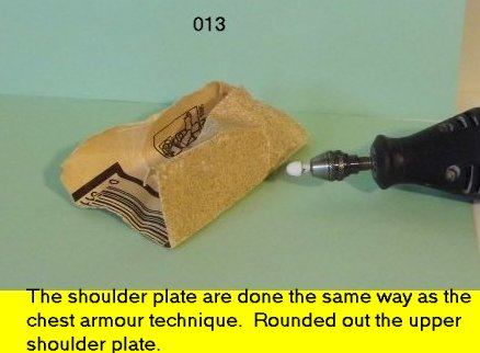

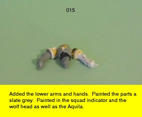

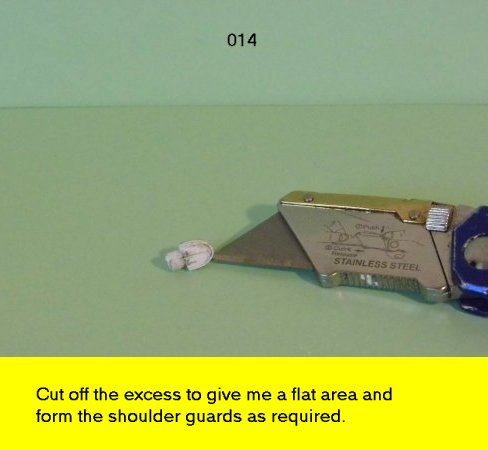

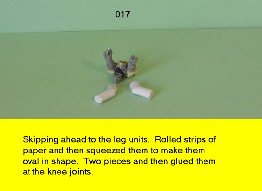

On with the updates in the making of the Space Marine. Follow the number sequence. Again, the sequence is off due to the image size.

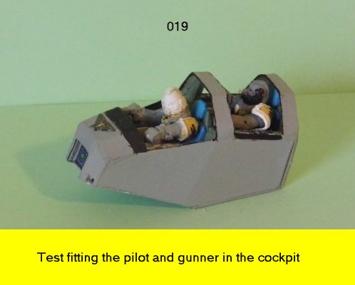

Attack Support Chopper

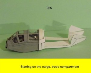

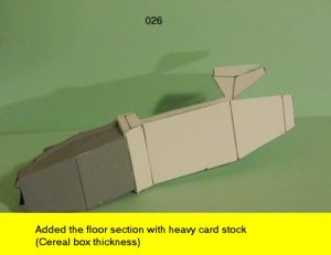

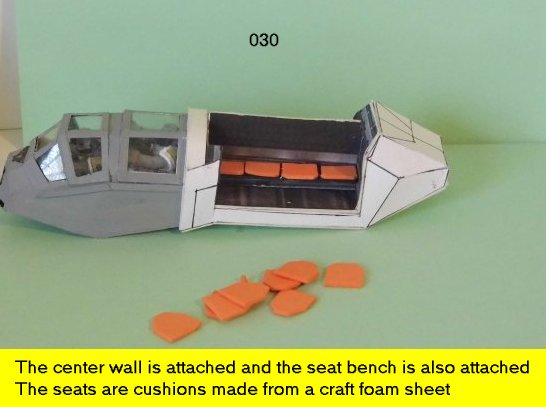

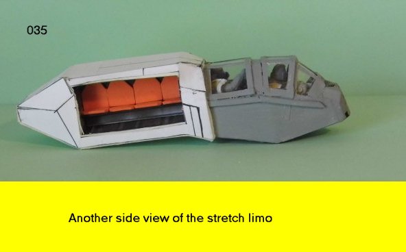

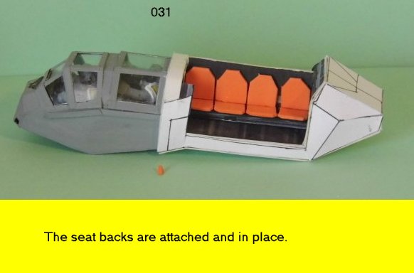

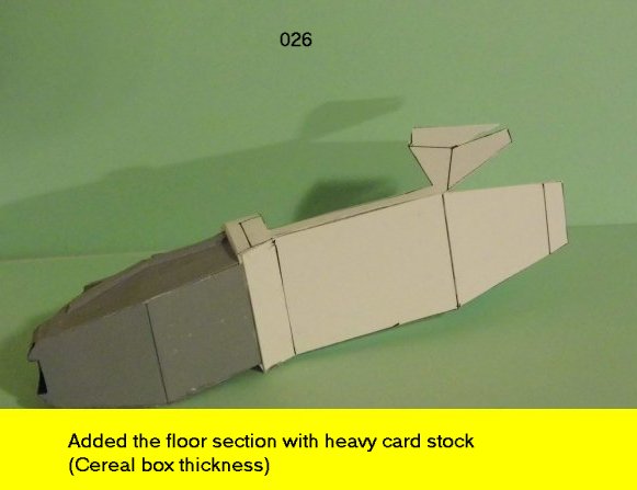

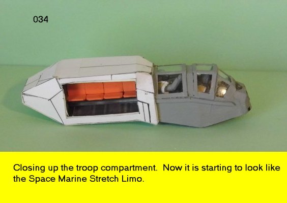

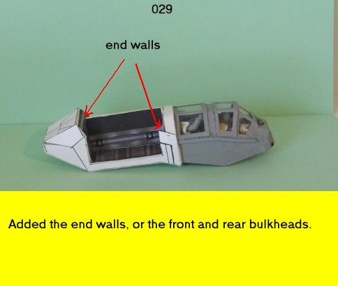

The figures are finished and now I can dedicate the rest of the build to the Helicopter version. The troop compartment is coming along nicely and after scrutinizing more closely, it looks like a Space Marine stretch Limousine.

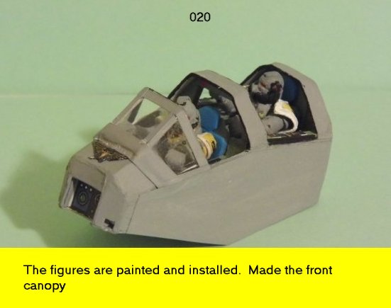

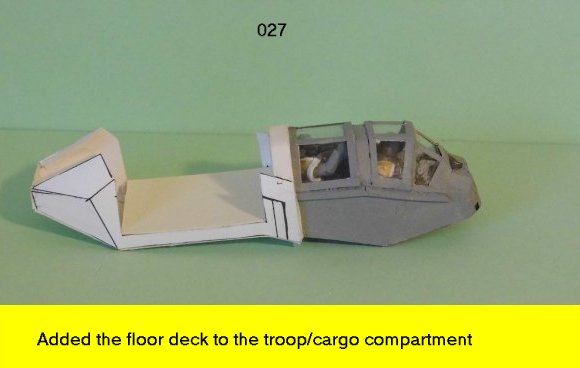

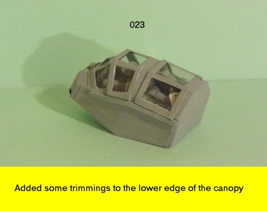

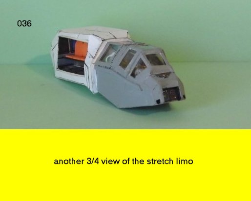

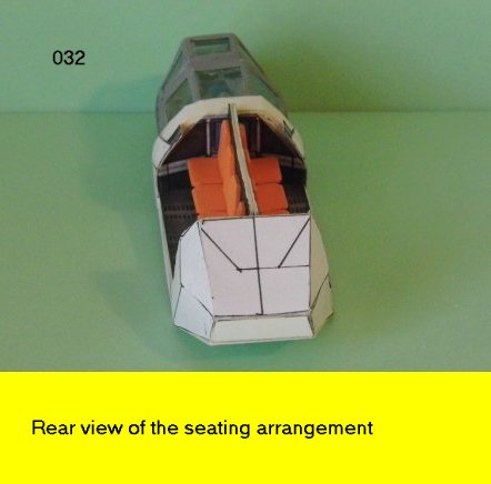

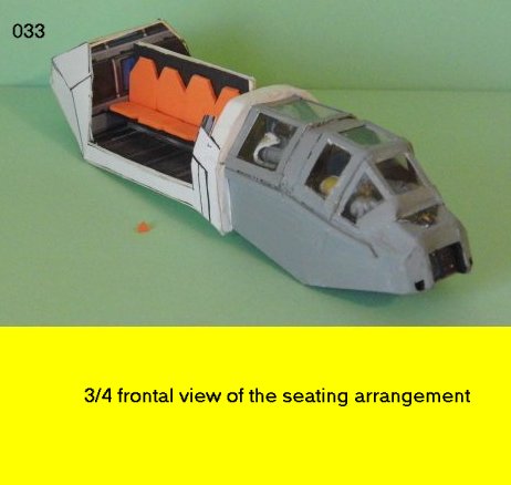

And the build continues with more updates on the 40K Marine Helicopter.
The space marines look FANTASTIC!!!
If you had not shown that (and how) you made then, I (and most everyone else) would not have believed that you had made them.
The troop transport is coming together nicely as well.

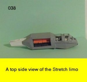

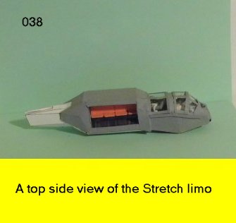

Her are some more photo updates of the build

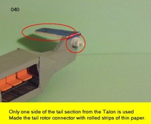

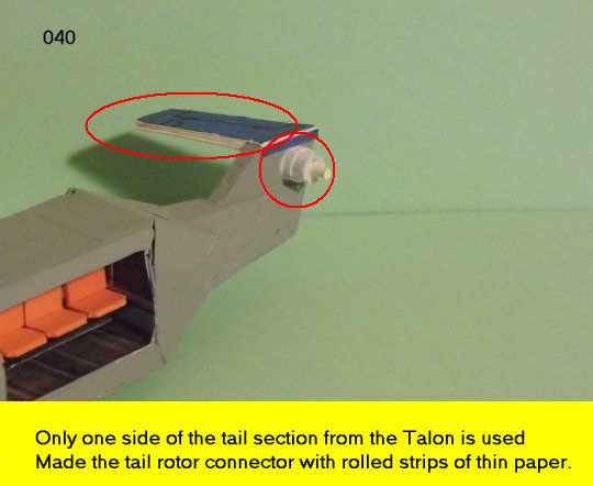

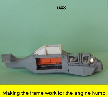

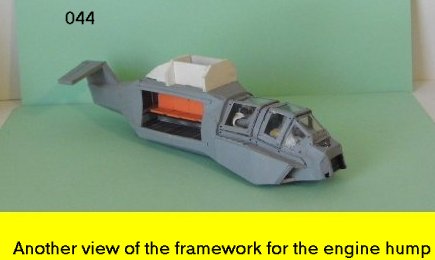

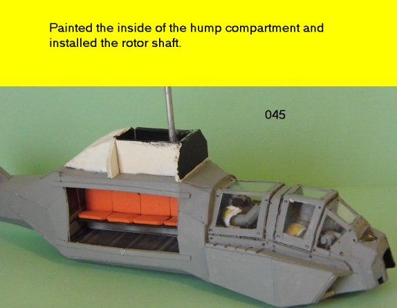

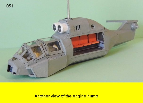

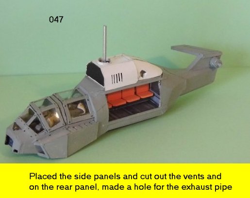

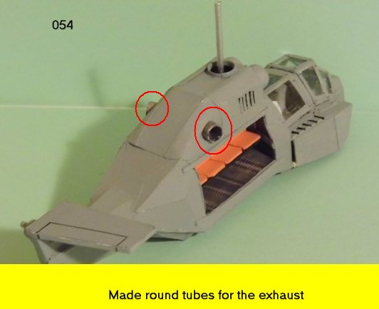

Continuing with the Marine Chopper. It is coming along better than I expected. Again as usual, the site sequence is off so follow the numerical photo sequence.

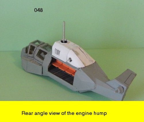

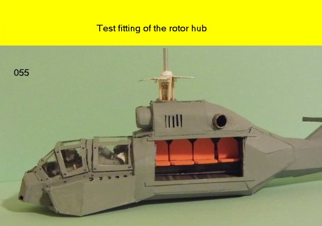

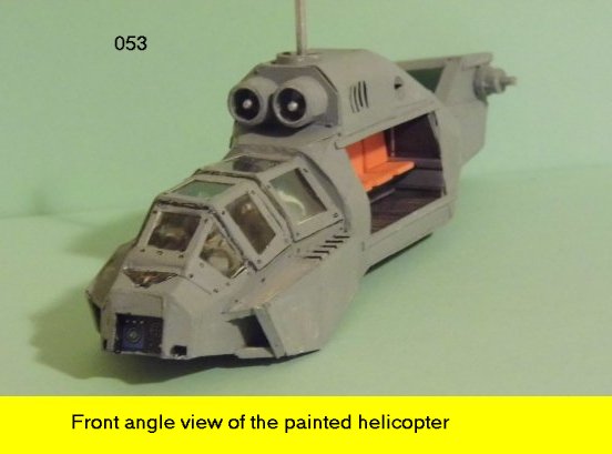

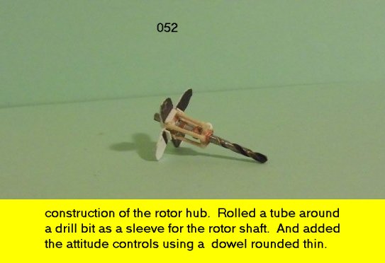

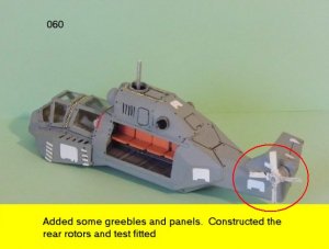

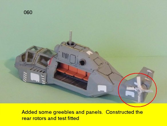

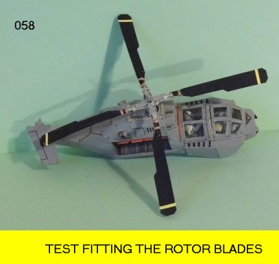

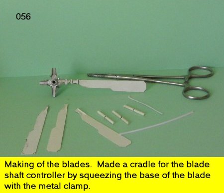

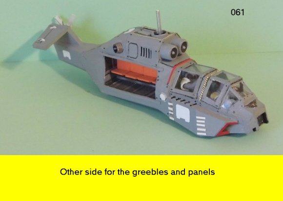

So the work continues with more updates on the Chopper.

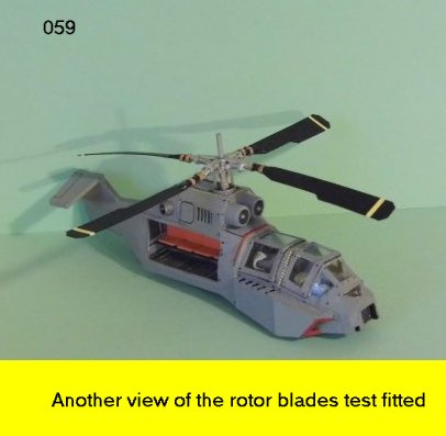

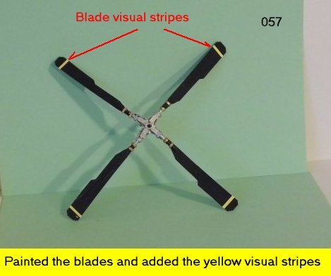

Blades are too short from a physics point of view. To lift such a load would require that they spin rather fast and would reach supersonic very quickly. Now, if that is how it looks in the WarHammer40K, then so be it. I only say this because after working for Sikorsky for 10 yeas, I tell you that looks like a real viable helicopter. I love it!! :)
Yes I know, But I have seen some medevac choppers for city/urban use that very short blades but by increasing the blades to 5, they are able achieve lift. I my case, if I had done away with the backseater and moved the engine hump forward, The blades would have been viable. I f I had made them longer, they would have extended past the tail section and interfered with the rear blade assembly. I used artistic license and shortened them. Anyways, Helicopters and c-119s like bees are not supposed to fly, they just beat the air and gravity into submission:twisted:
Oh yeah, they fly for a very good reason. I don't like to go into stuff like this too much because I get called a know it all. The five bladed rotors are to generate more lift, that's for certain. That was why we upgraded all (well most) of the Sea Kings to the 5 blade elastomeric hub and added an extra engine. A CH53E with a 79 ft. rotor diameter will reach near supersonic at the wing tips doing 373 r.p.m.. There is not lift at this point and that is why craft like the Carver Copter with a slowed rotary wing are being eyeballed.In translational flight, the center of lift on a counter clockwise rotating rotary wing moves towards the front and right of the aircraft. This is because the wing is advancing into the on coming air while the other blade is retreating. The tail rotors main job is to prevent the helicopter from corkscrewing and thus terminating fight in an unwanted manner. Now, if you look at the trailing edge of each wing, and you could still do this to our model, it looks like a long sideways "S" shape. This is because as you approach the center of rotation the speed relative to the air slows, so as the blade makes it's way inwards towards the main shaft from the tip, the trailing edge starts to drop, changing the angle of incidence of the wing cutting more steeply into the wind and securing lift at all speeds, while the leading edge looks pretty much the same. this is very pronounced on Blackhawk helicopters.

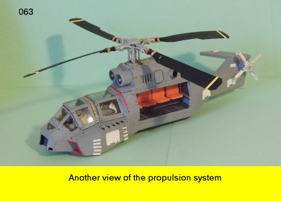

If you have a good eye, and know what you are looking for, you can see it quite clearly in this picture.

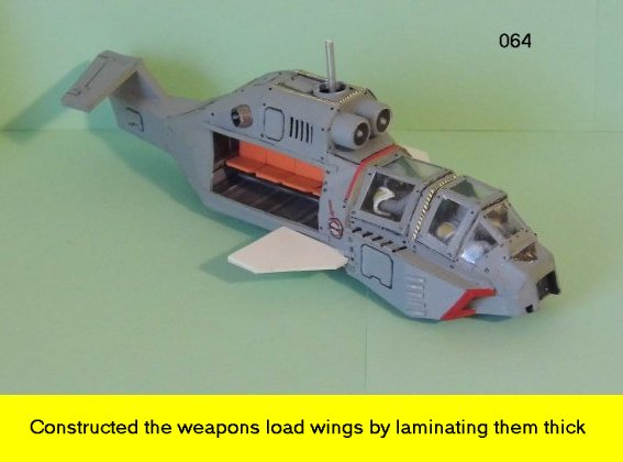

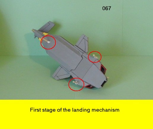

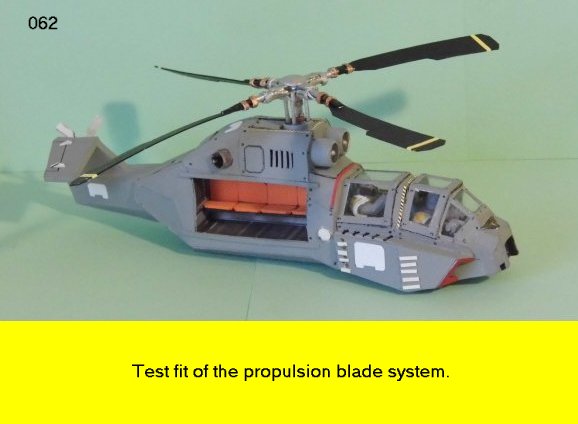

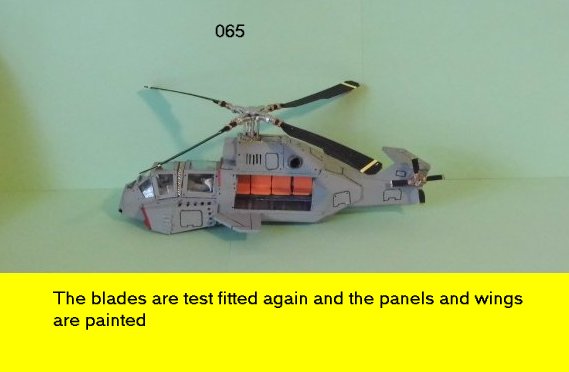

Here are some more updates on the 40K chopper. Postings may be sporadic from here on. I will be working on the Virginia Swift boat soon. The model is taking shape and the weapons are not done yet. Still considering the weapons components for it. Enjoy and see you all soon with more updates.
