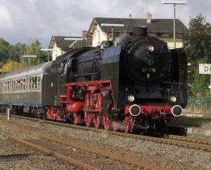

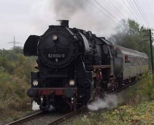

They were very common in European locomotives. Here are two types which were used often on German steam engines: The 'Elephant ears' on a fast Pacific (type BR01) and the 'Witte' type (named after their inventor) on a 2-10-0 (BR52).

I've never seen a pair of those close up but I agree... they don't look like they would be very effective. Still I would have to see what it looks ike in behind to see how they are trying to direct the air flow. Seems like there could be a much better design to accomplish the same task.

Those Witte-type smoke lifters (bottom photo?) don't look particularly effective in that shot...!
It's amazing, but these things worked really. Look again at the (lower) picture, and you see that the somoke is clearly lifted above the CAB. That's what it's all about. Ok, a little bit farther back the sooty cloud is rolling down again on the train, but the aim was to get a clear vision for the loco crew. (And the fans riding on the train just LOVE to have cinders in their eyes, don't they?) :D:D:D

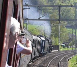

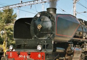

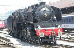

Here's another type, sort of mixture between elephant ears and the witte type. It's on a French 4-8-2 engine, the 241A - a real race horse for passenger trains, doing 100mph. In the last pic you clearly see the desired effect of the smoke lifters, pushing up the smoke not more than about 1.5 - 3 meters (5-10 ft). That's enough for the engine crew. :thumb:
