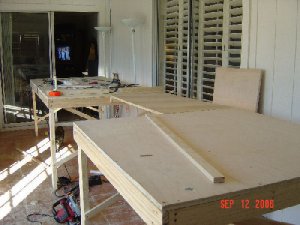

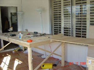

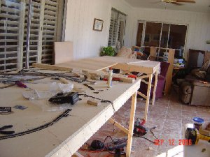

the room is a mess, but here is what I came up with for bench work...now the fun begins!! I hope it works, again, I have not ever built bench work...the American Flyer system long ago was just on a piece of plywood sitting on a picnic table. I appreciate everyones help!!!!!!!!
