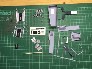

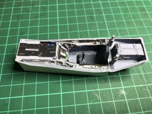

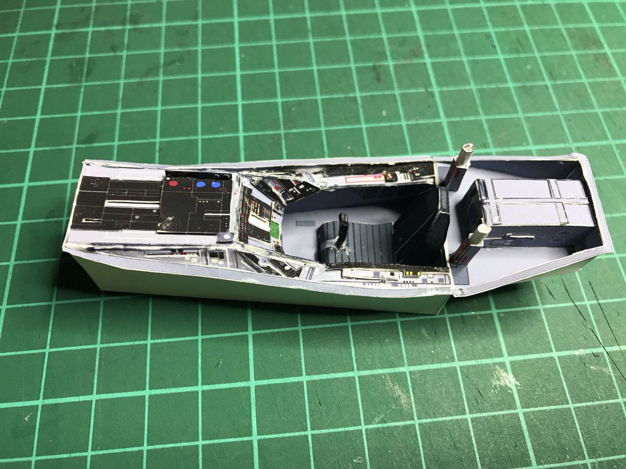

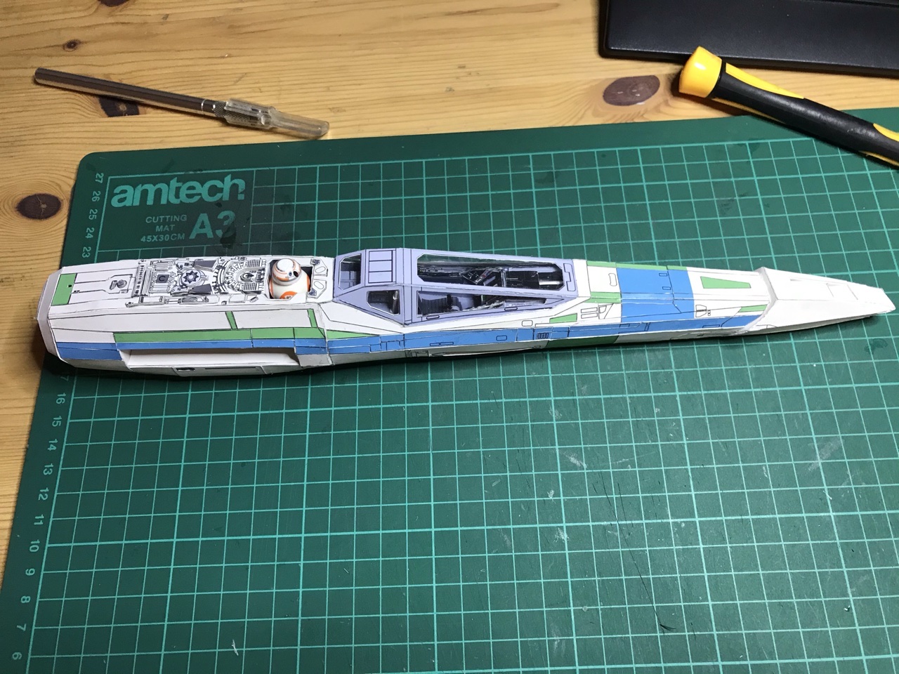

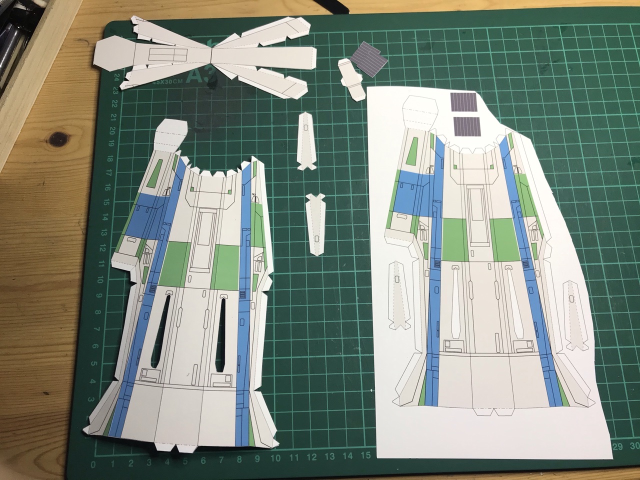

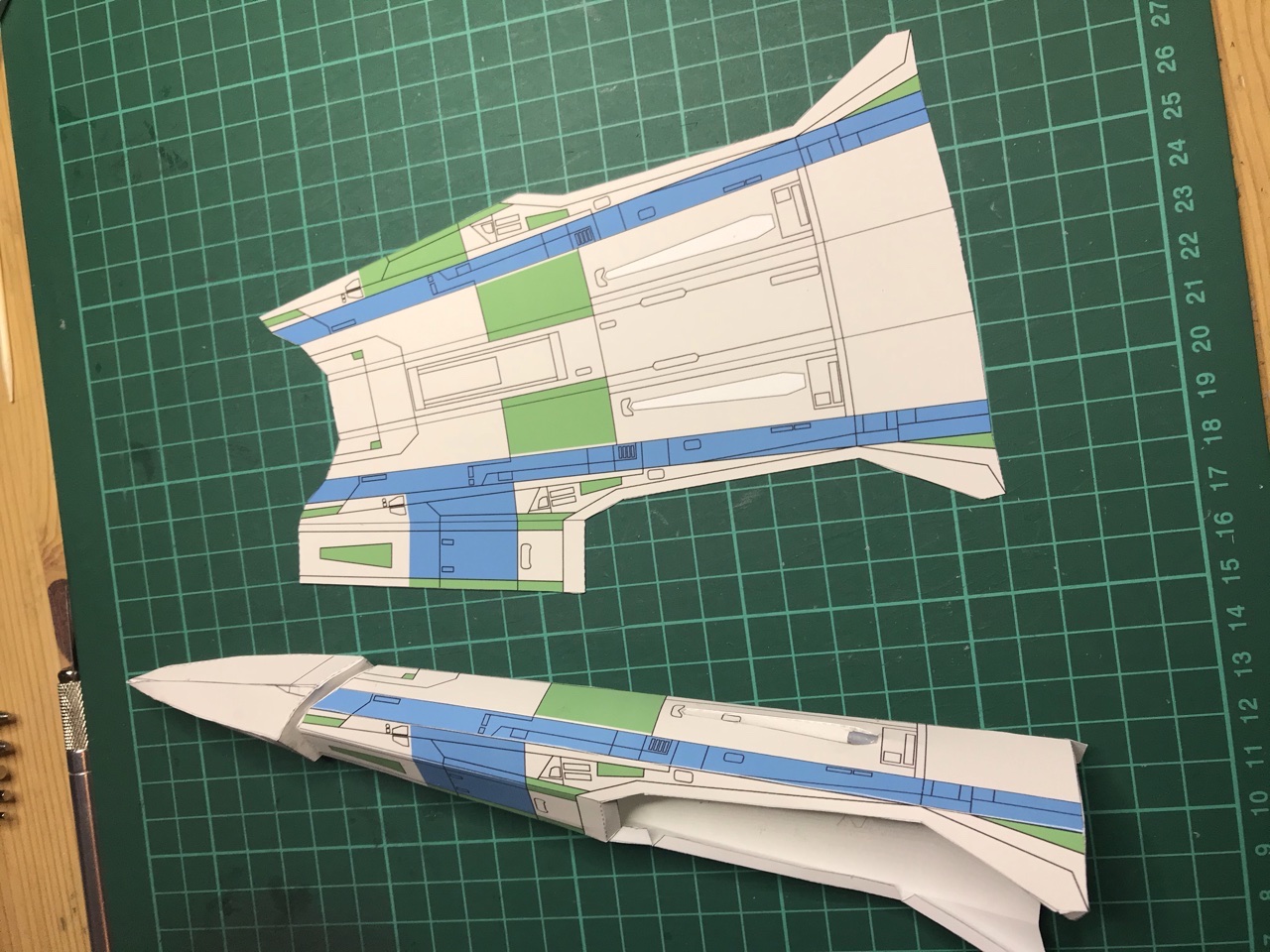

I have done the hull parts and the nose - and now comes the cockpit. I am very exited.

WOW! Thank you very much, @bigpetr ! thumbsup thumbsup thumbsup That was very fast.
@starbuck , please test it carefully. We may upload it to the Resources later.
This enhancement is really important for this model to "pop". :)
If was not as easy as I thought, this new cokpit is much longer, so it was not just rescale. That is why there can be some mistakes moreso becaususe I have to reverseengeneer shape of the fuselage and I had to do some queswork here, but I tried my best.
Starbuck please, let me know if something do not fit and how to change it, so I can correct it in the template
That is what I found out too. I will test it very soon - latest tomorrow - and will give feedback as soon as I have results.

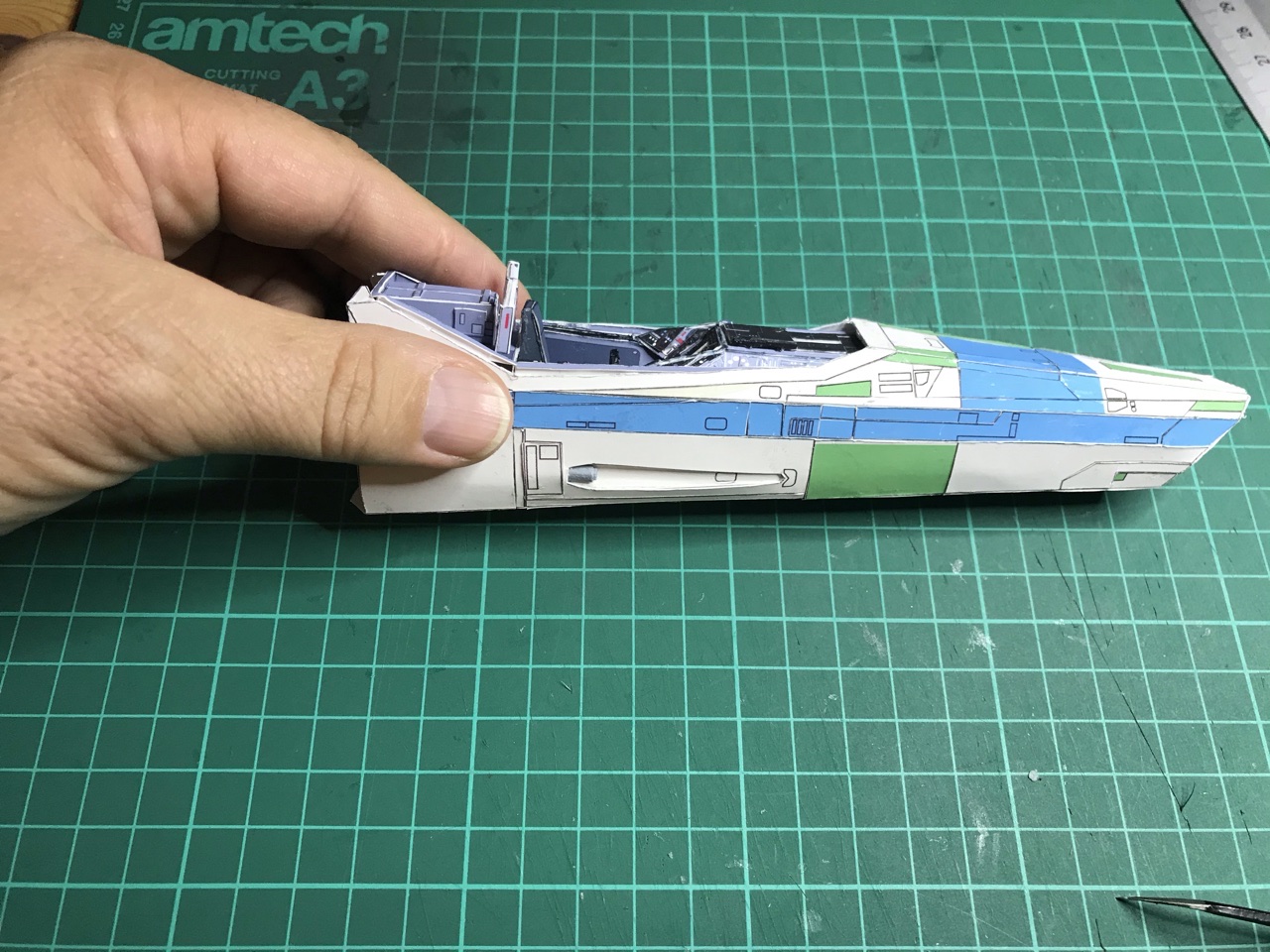

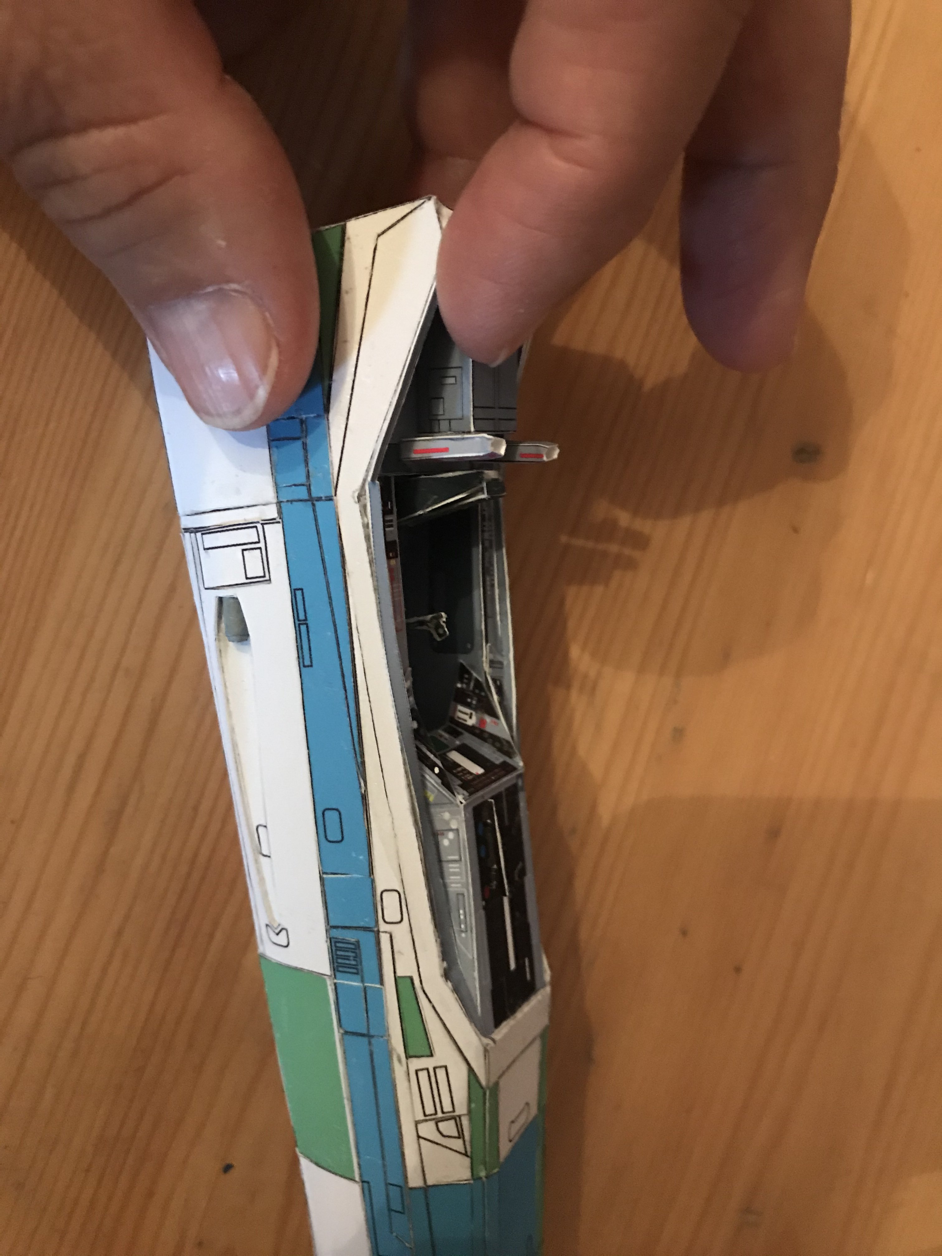

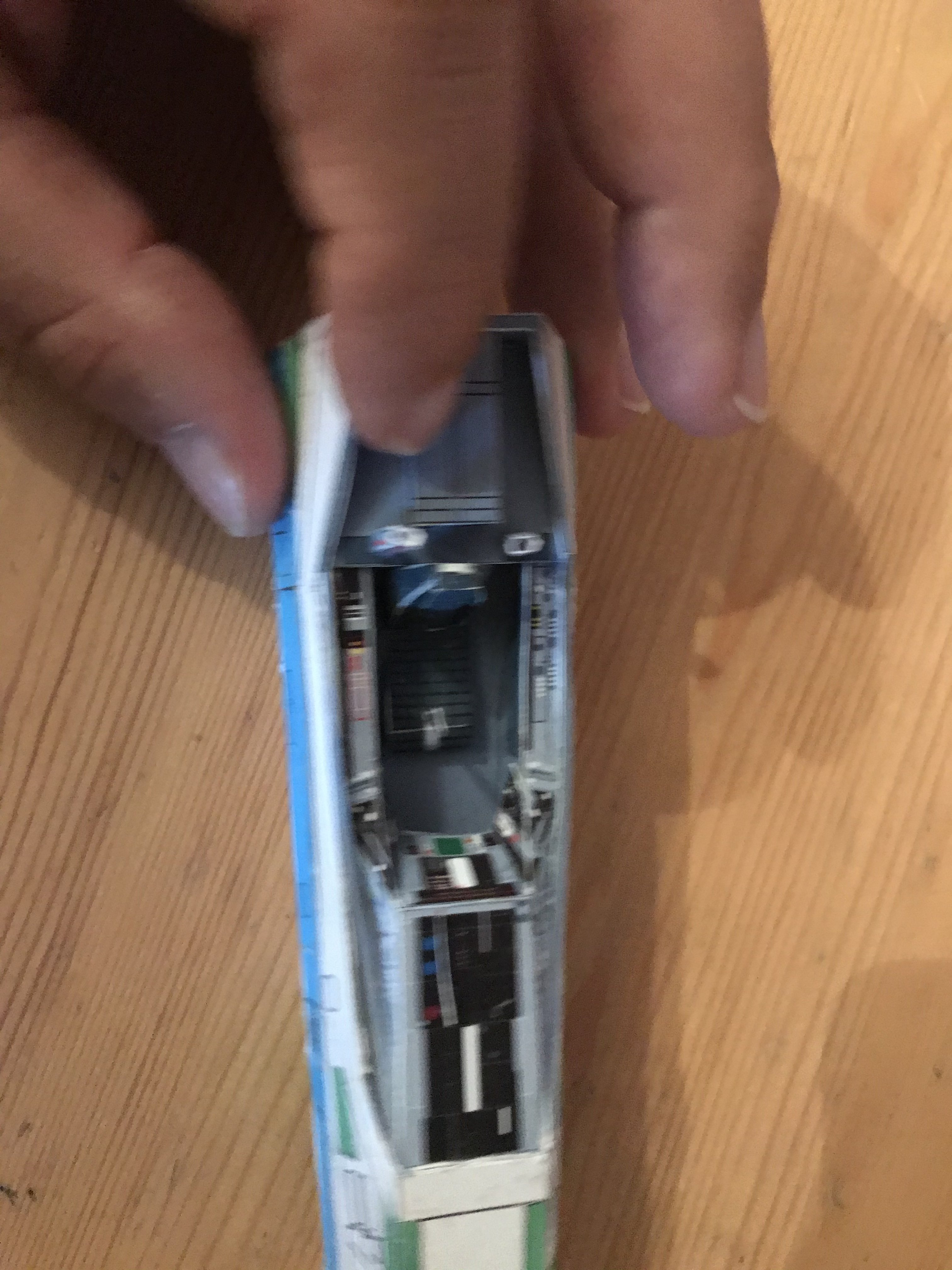

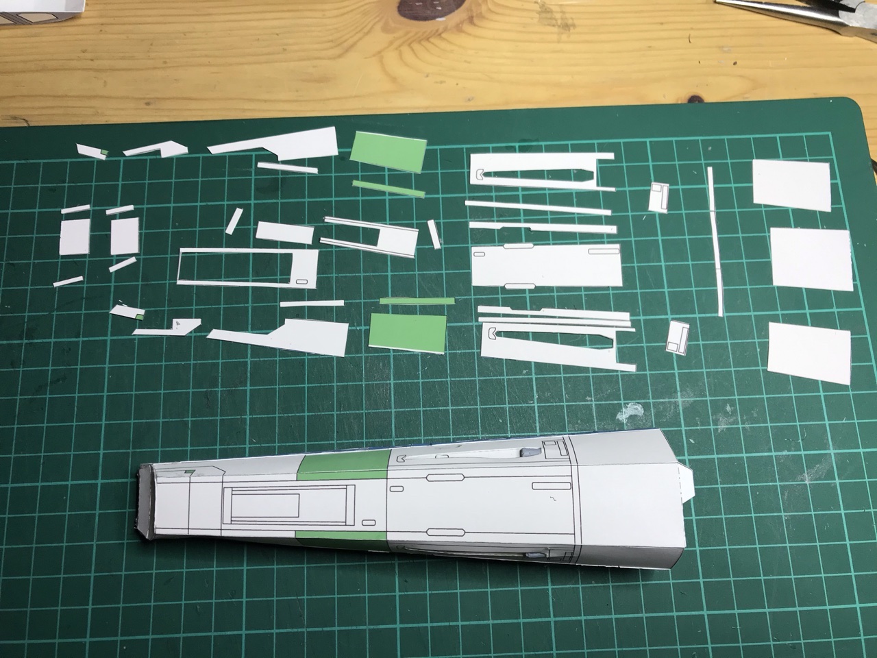

First test finalized.
First thing to mention - I removed the tabs from the body to be able to place the cockpit correctly.
In my eyes the templet is perfect, except for 2 things:
parts C12 and C13 are too long to be placed in the cockpit and
parts C19 and C20 are a little bit too long in my eyes.
What you can see is the first fast build and I hope you can see that it fits perfectly into the body and to the cockpit.
Now I will rebuild it and I hope I can give you the exact measurements of the before mentioned parts.

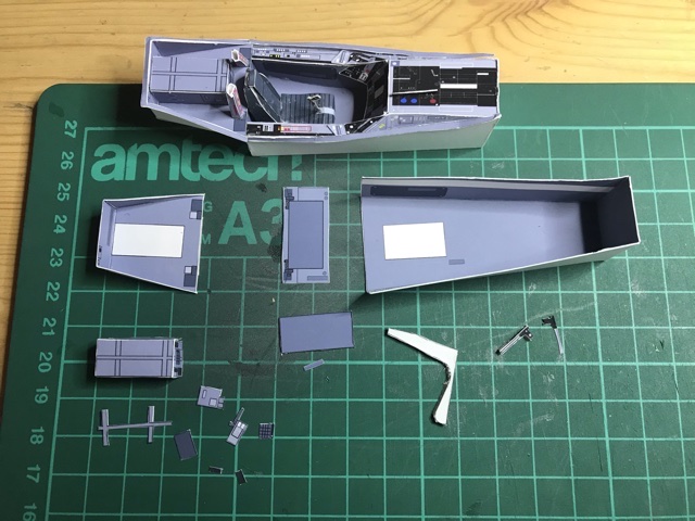

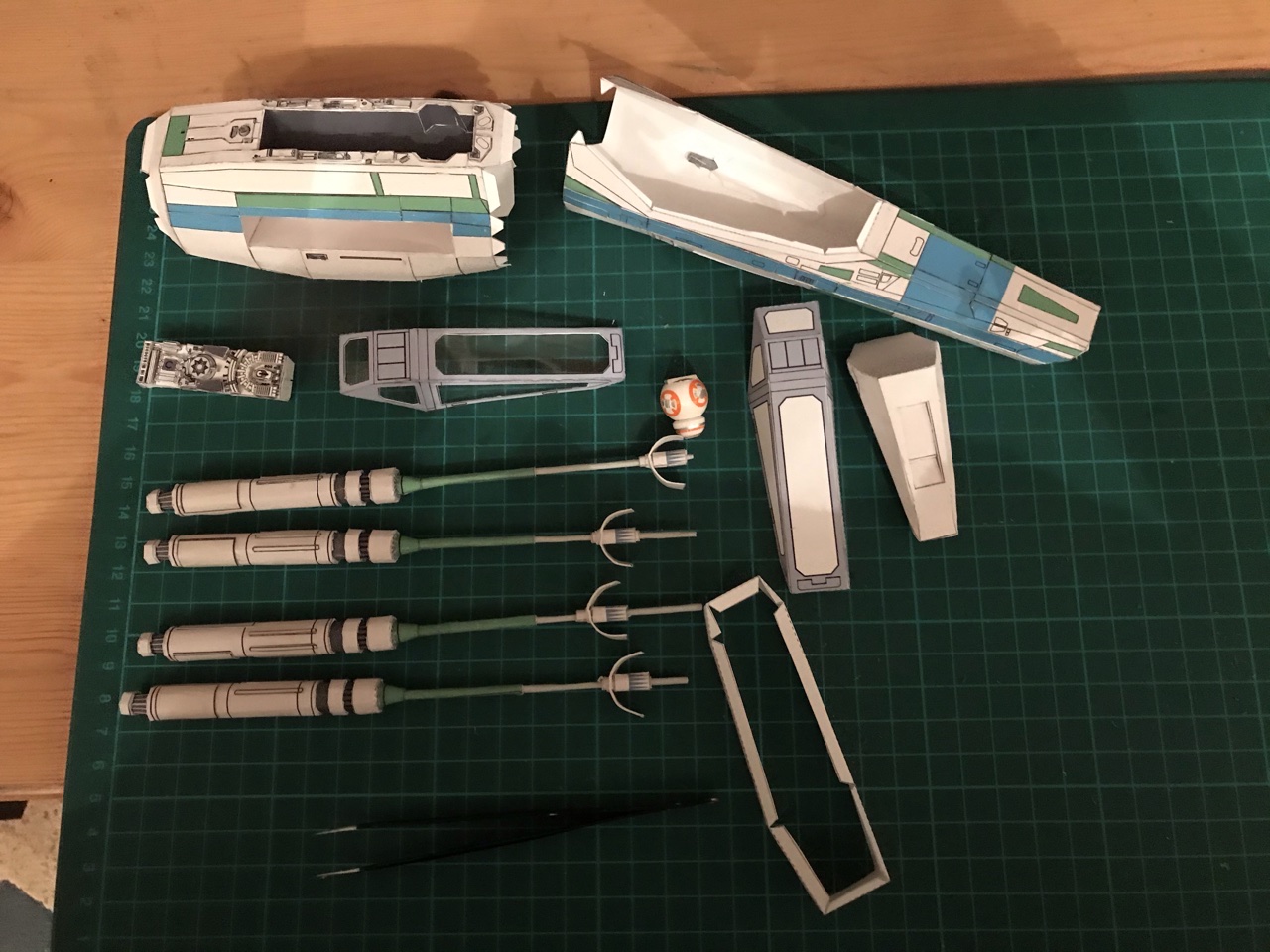

Now the first parts in the (hopefully) final version, with some additional details.
Oh forgot to mention: the joystick and the seat former is glued to thicker cardboard to stabilize the parts. Furthermore i added an additional layer on the bottom of the last part (left) to make it more easy to glue to the seat section.
Dimentions of parts:
C19 and C20: in my opinion they should be 6,8cm (bottom line)
C12 and C13: thats rather hard to say, (1,5 or 1,6cm): I would do as follows: Fold parts 12 and then insert Parts 13 (should be shorter than parts 12) - being in sum 1,8cm - without glueing and the adjustment to the final hight will be done by adding the cockpit which moves the parts 13 to the final overlay. (I hope I described understandable.)
Reactions: Rhaven Blaack

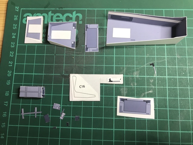

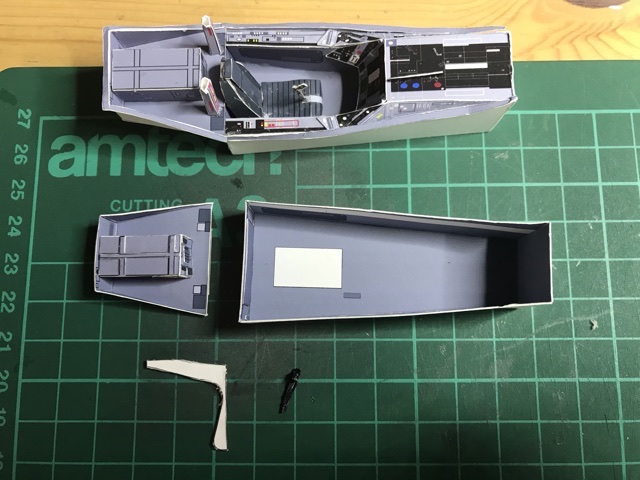

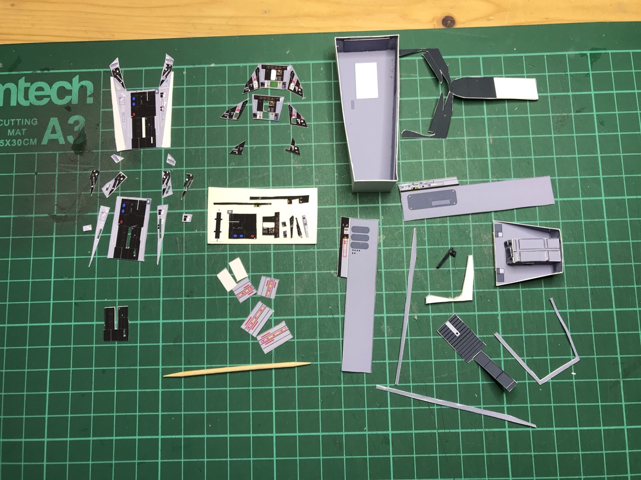

Here are the prepared parts for the cockpit. The front of the cockpit will be done with 3 layers and some part are glued to additional cardboard to make them pop up or to stabilize it.

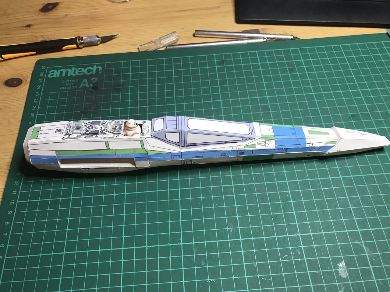

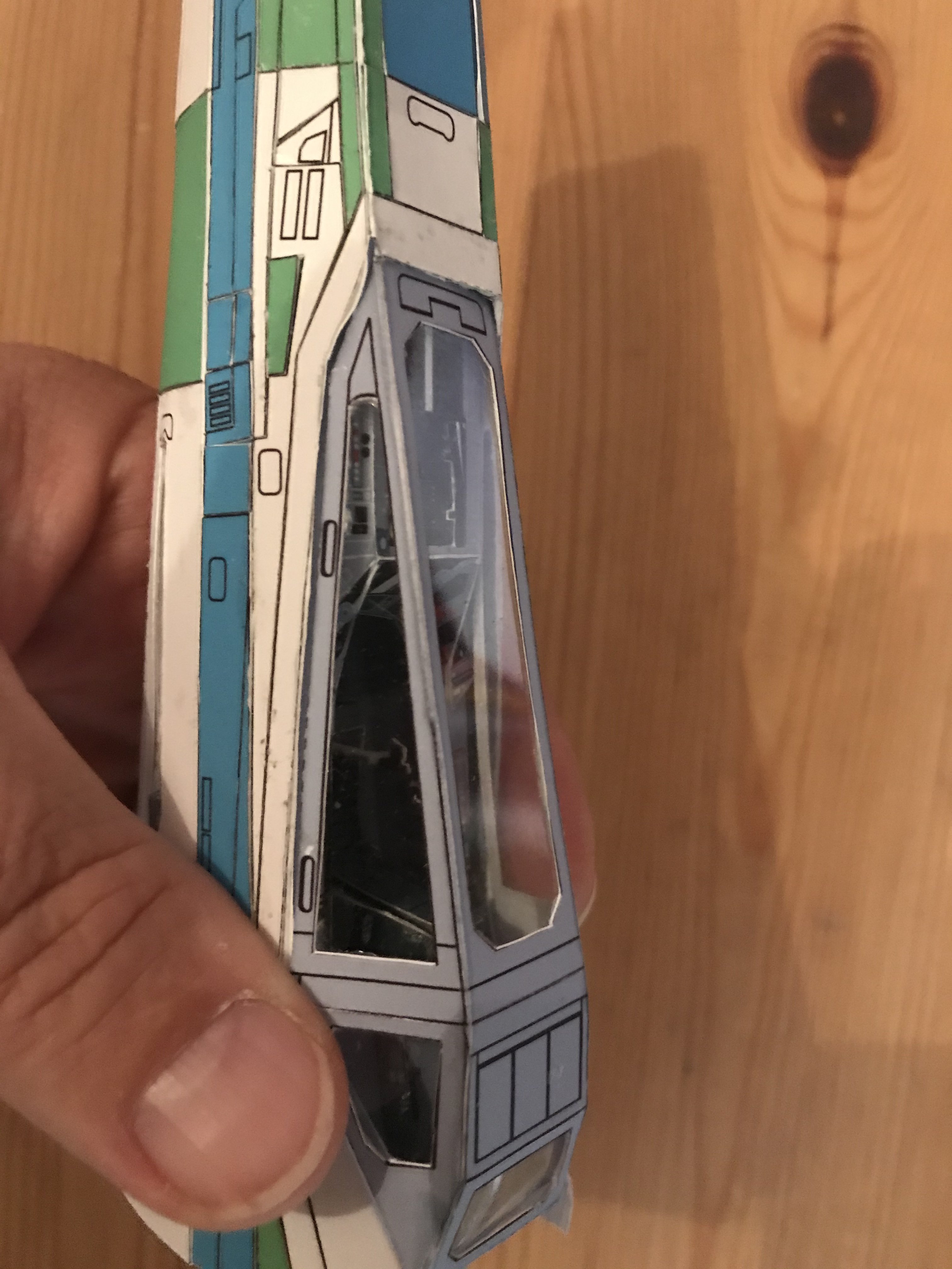

And here it is.It is a big difference whether you have a cockpit or not. But without wings it really looks strange. Next back plate - pictures to follow.
