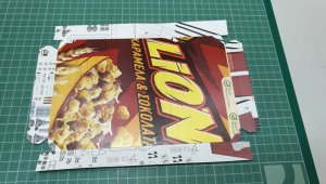

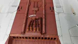

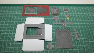

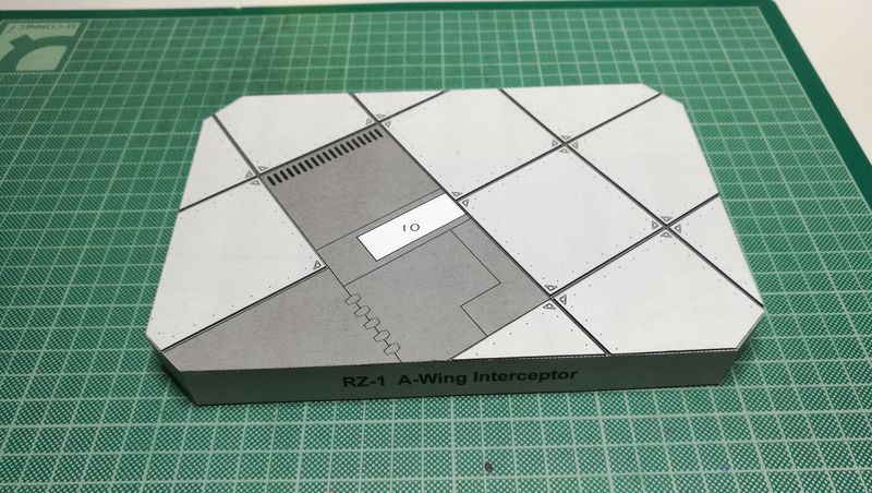

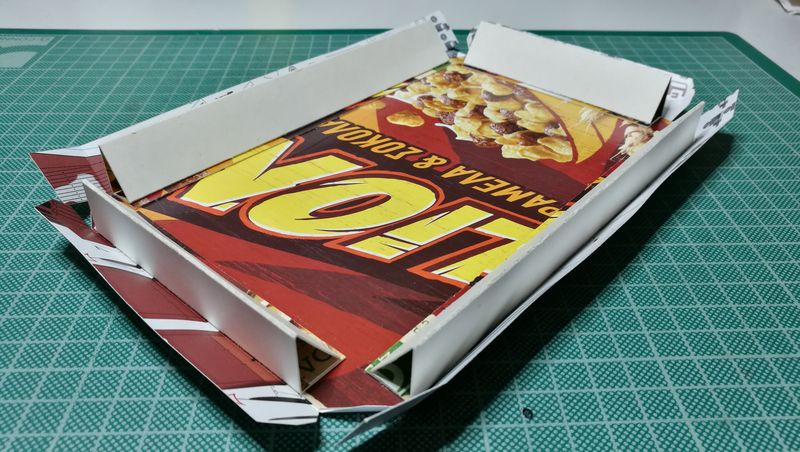

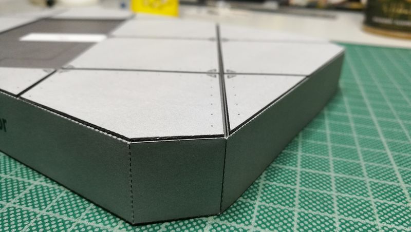

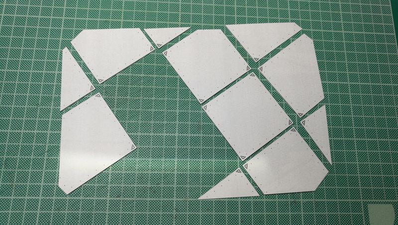

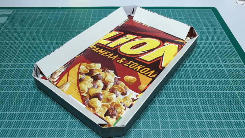

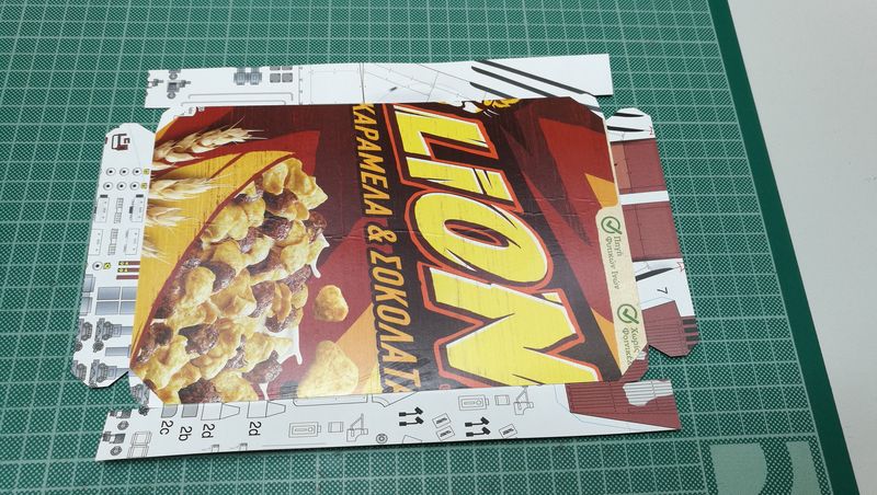

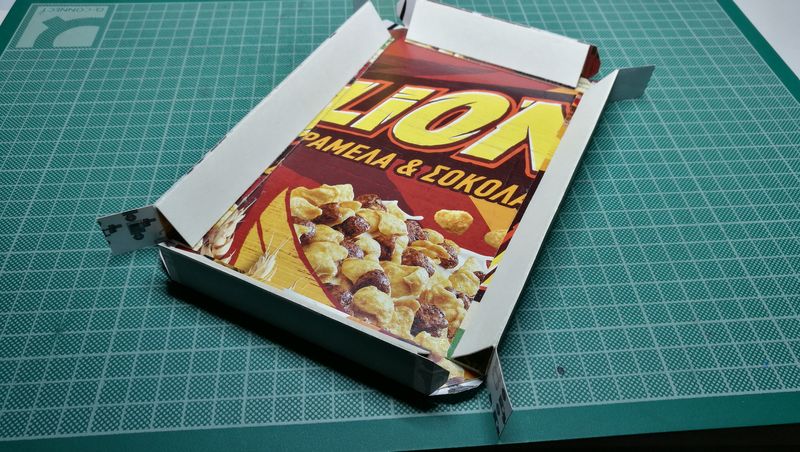

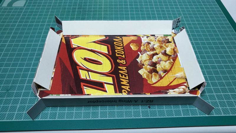

First, I built the base.
I made two prints, one for the basic box and the second to add another layer on the surface. I reinforced it with card from cereal boxes.

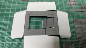

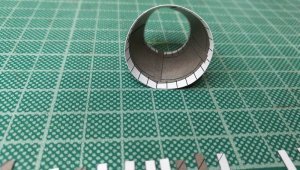

To keep the box stable and in shape I built some right-angled tubes with three surfaces and placed them on each edge.
Then I glued the sides one by one on the card and closed the corners

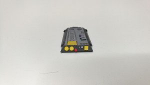

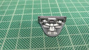

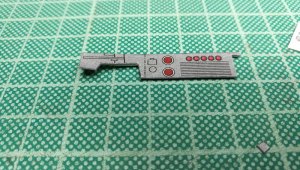

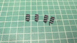

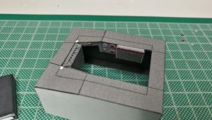

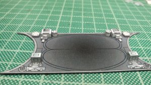

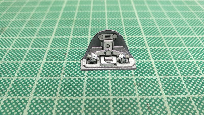

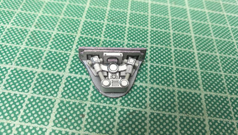

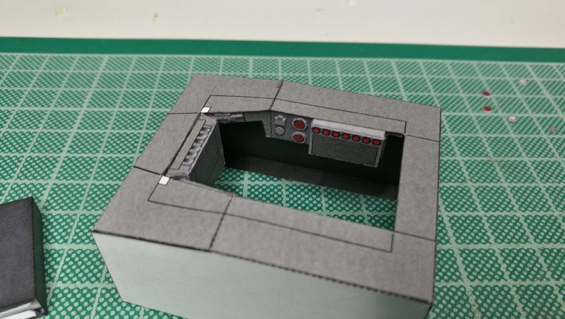

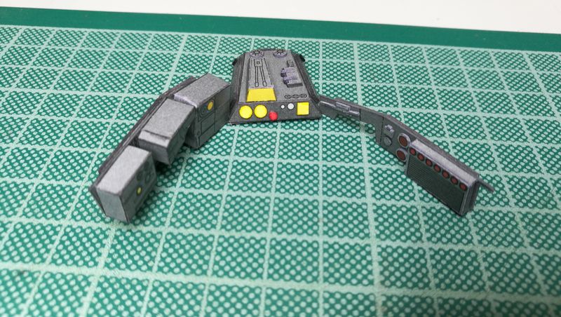

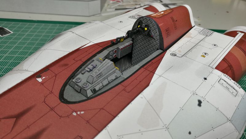

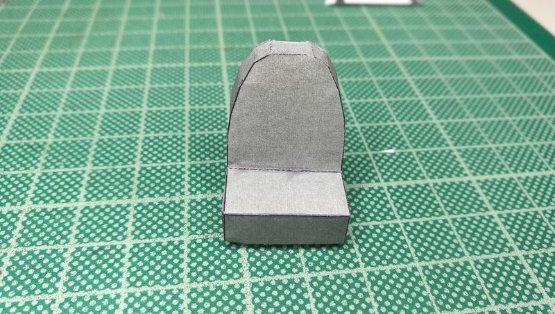

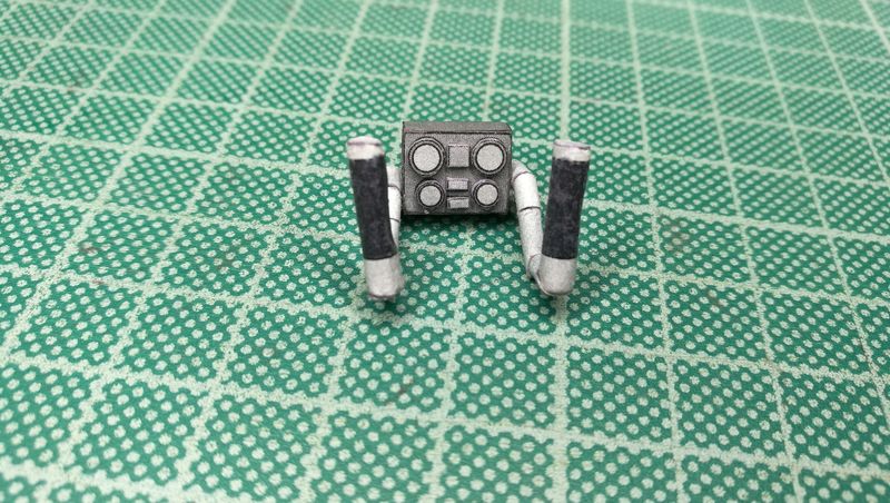

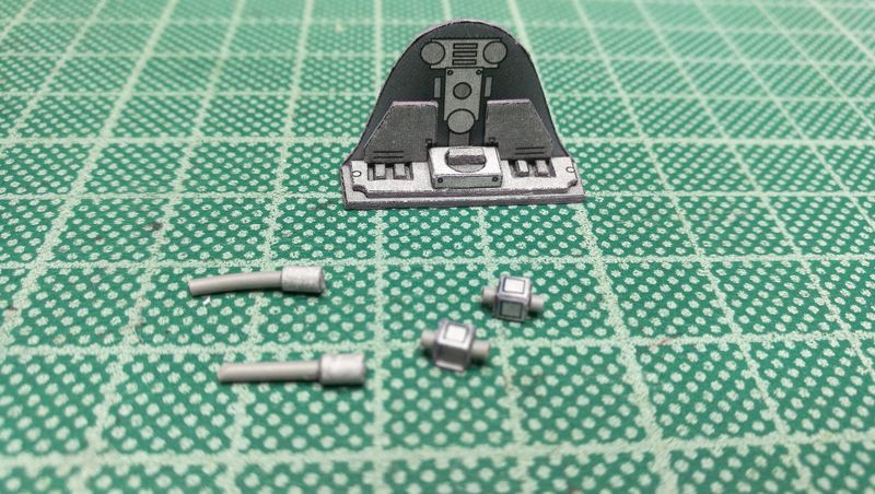

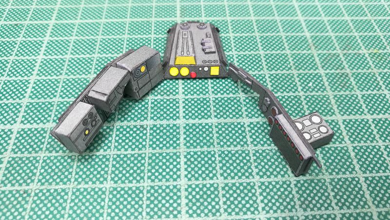

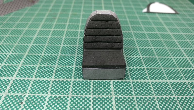

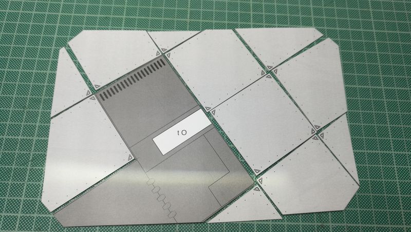

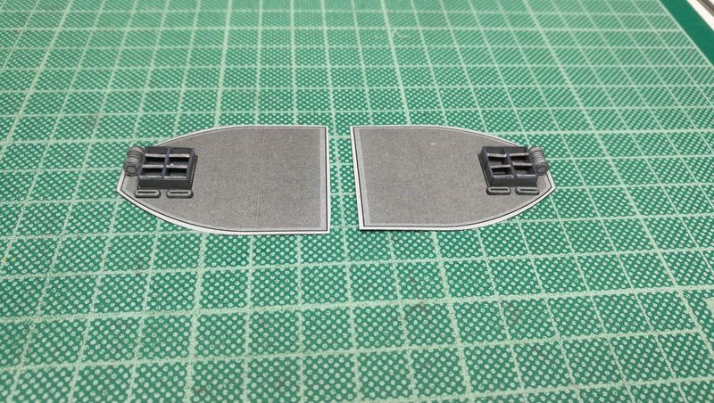

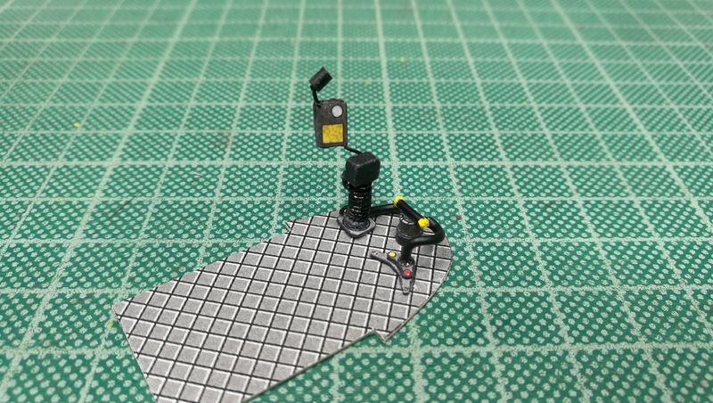

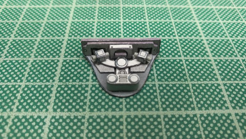

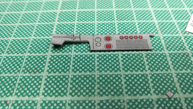

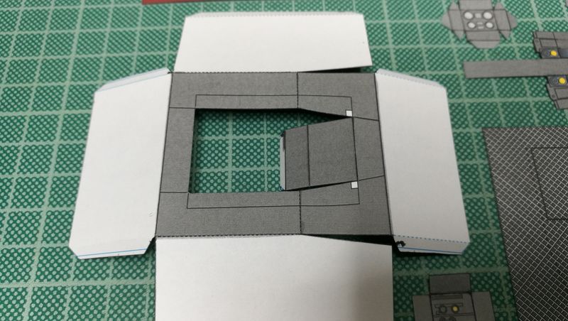

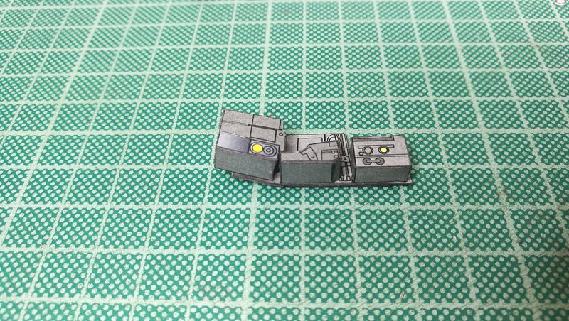

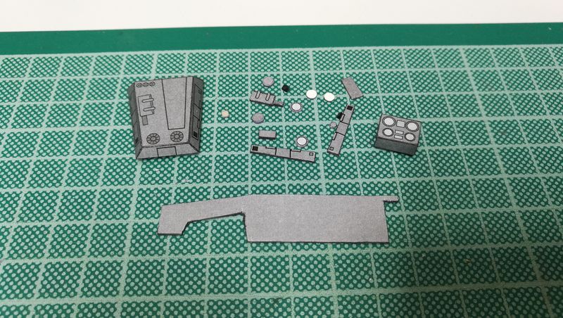

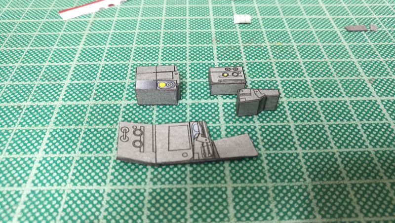

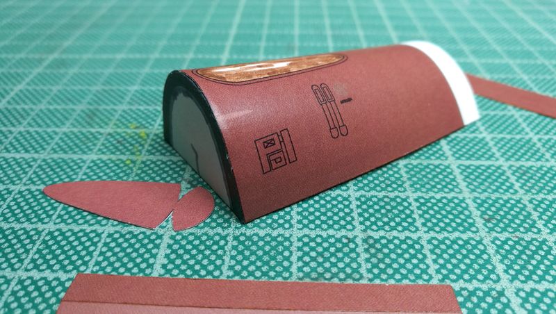

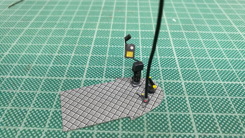

After the base I started with the cockpit.

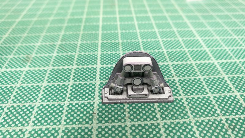

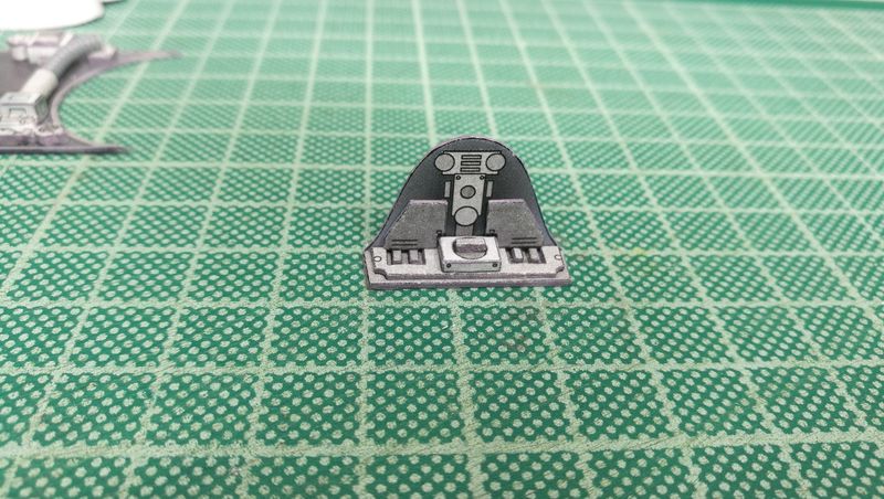

I combined Shunichi’s parts 24,25,26,27 to one single box and turned all the graphical elements on the sides to 3D objects.

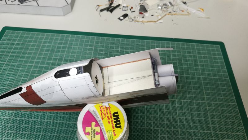

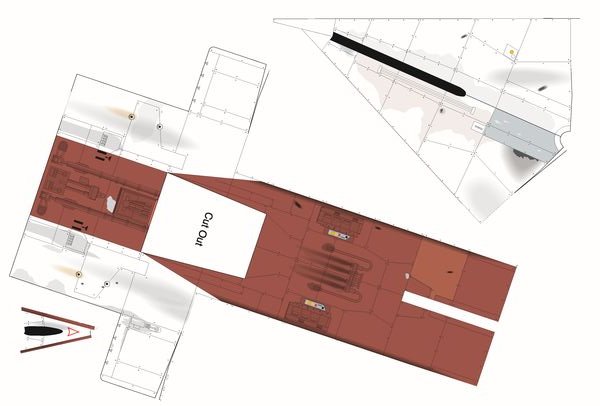

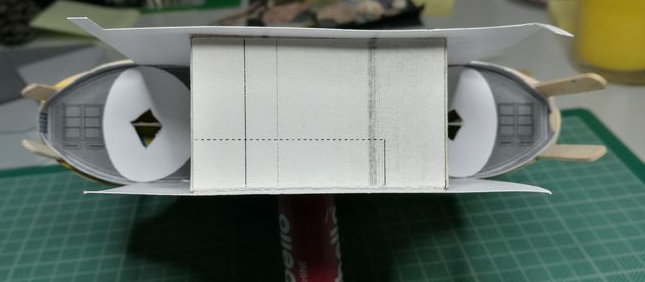

Next I started on the main body
I devided the hull to wings and mainbody, reinforced the mainbody with card from cerealboxes. I changed the templates in that way so I had the wings as one peace.
Unfortunately, I can not show any pictures of that stage. They were lost during transfer :( .

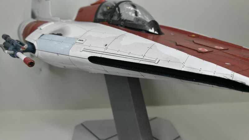

I went a similar way like bigpetr with his build
https://www.zealotmodels.com/threads/star-wars-a-wing-shunichi-makino-heavy-mods-1-48.180415/page-2

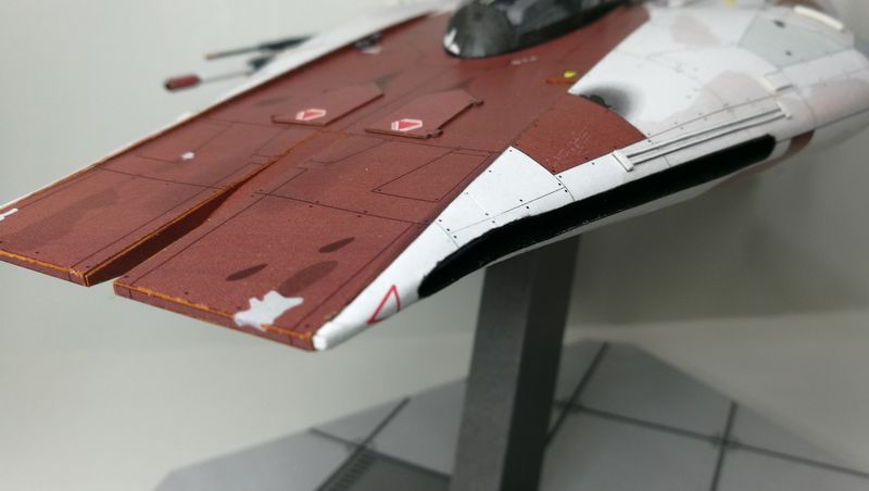

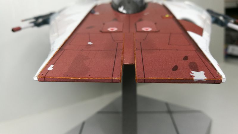

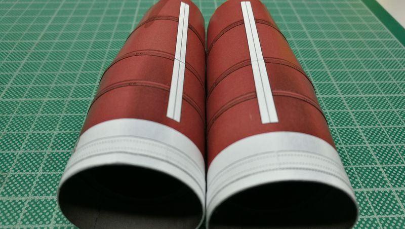

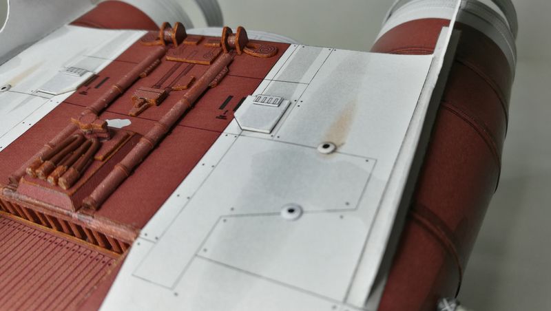

First i bent the wings into shape making them a bit wet from the inside so they keep the form. After they where dry i put some cereal card inside with the same form to cut out the black slits. I used some black card shaped in U-form to cover the slits from the inside. After some try's i finally found the right shape and glued it into place.
Then i connected the top and bottomparts at the front and wrapped them over the main body which i made out of cereal card. When everything was ok i finally connected the wings.

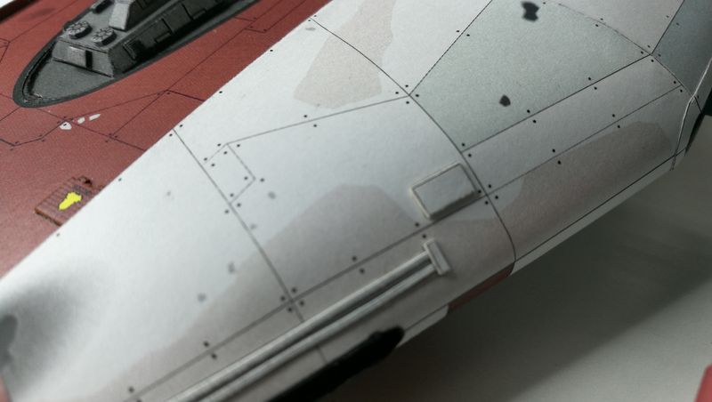

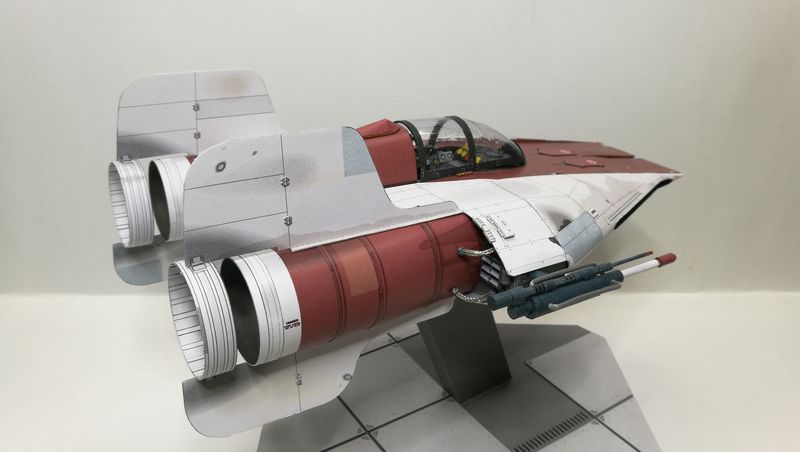

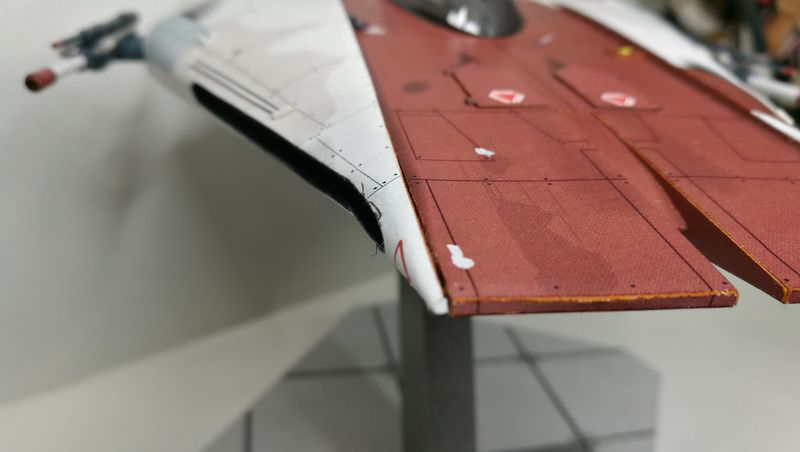

This Picture is the only one I could recover. The wings are already finished and atached to the mainbody

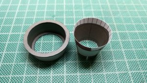

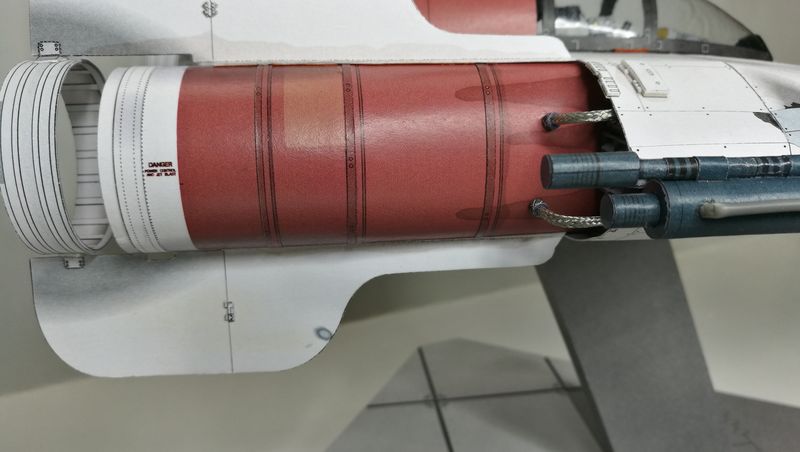

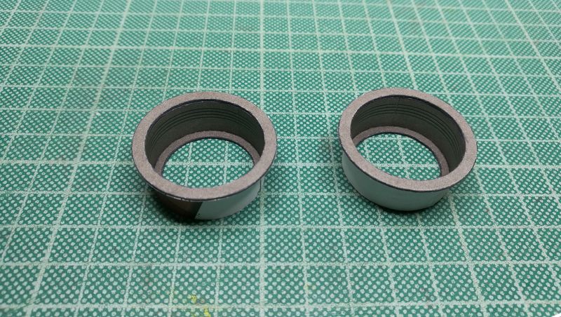

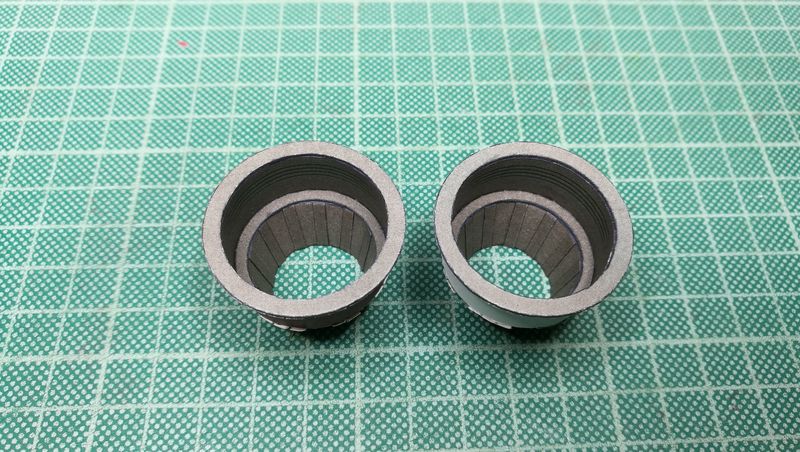

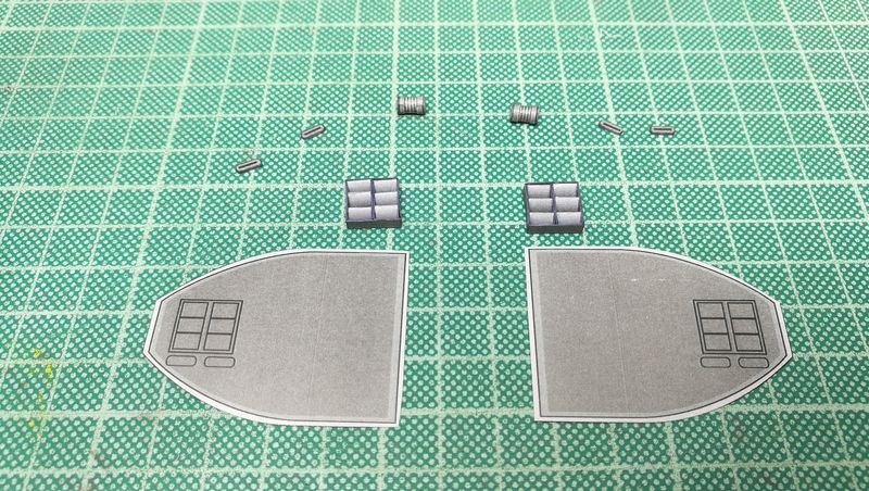

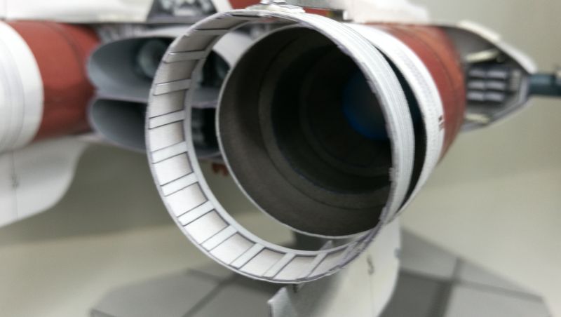

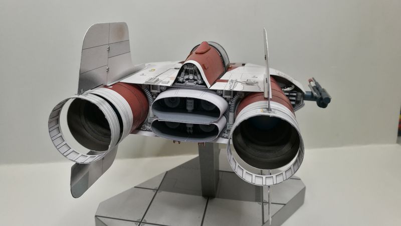

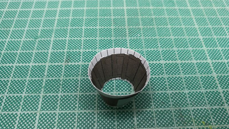

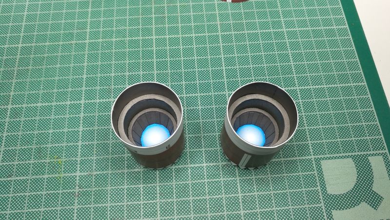

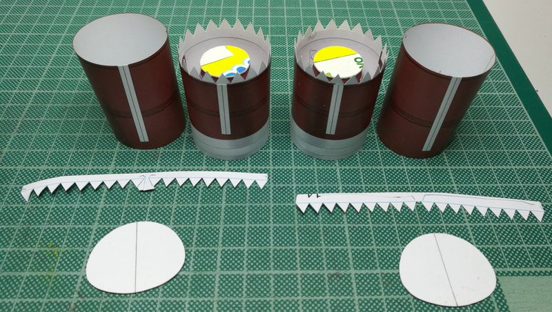

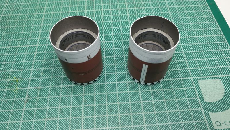

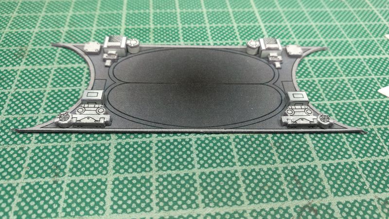

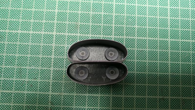

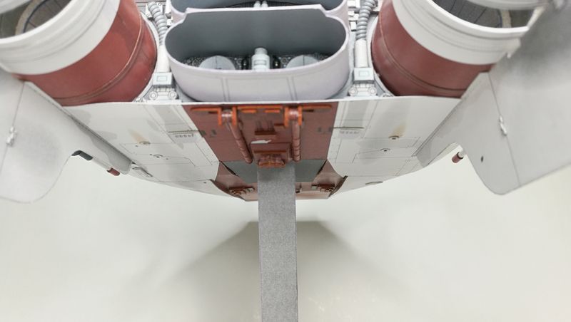

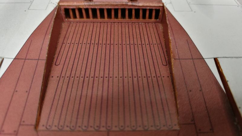

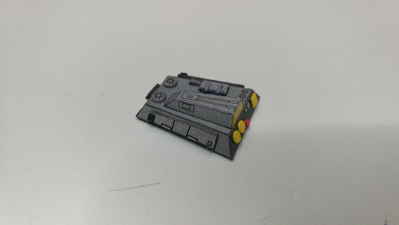

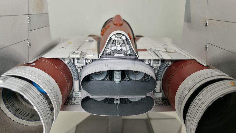

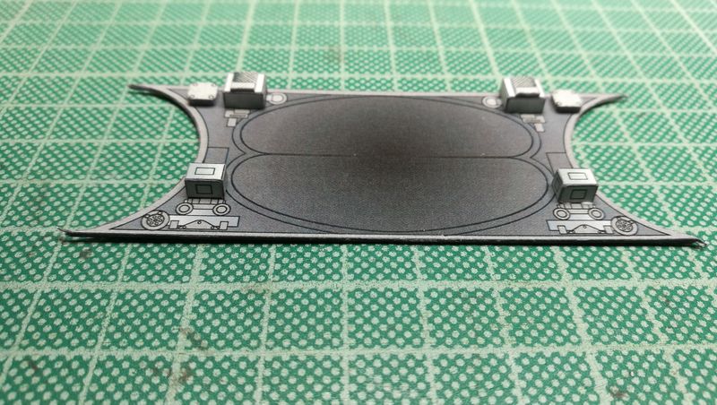

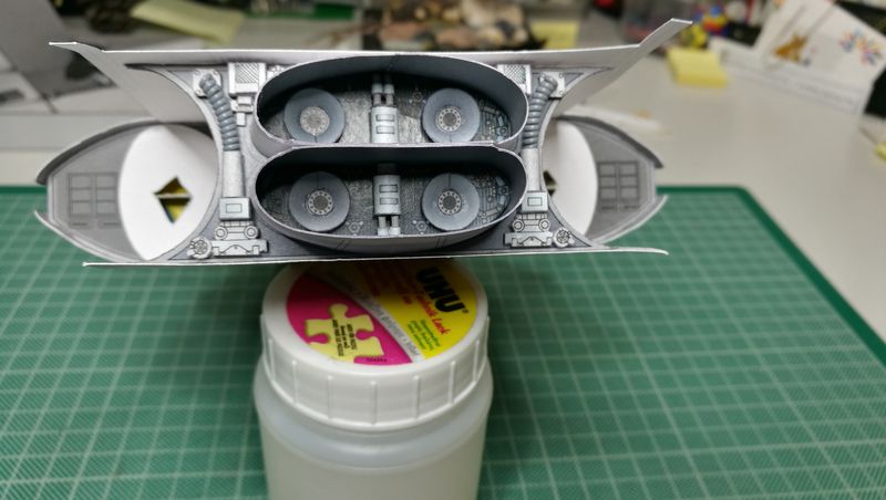

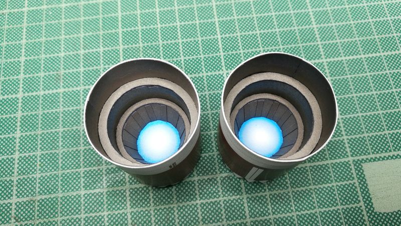

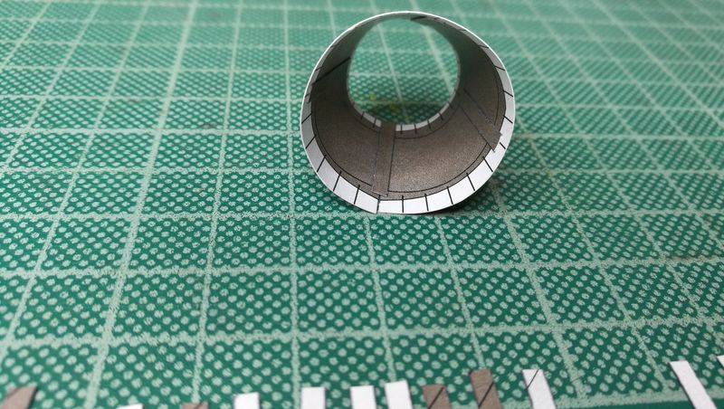

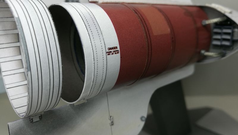

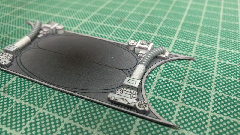

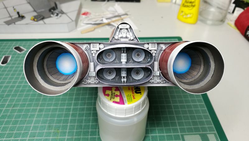

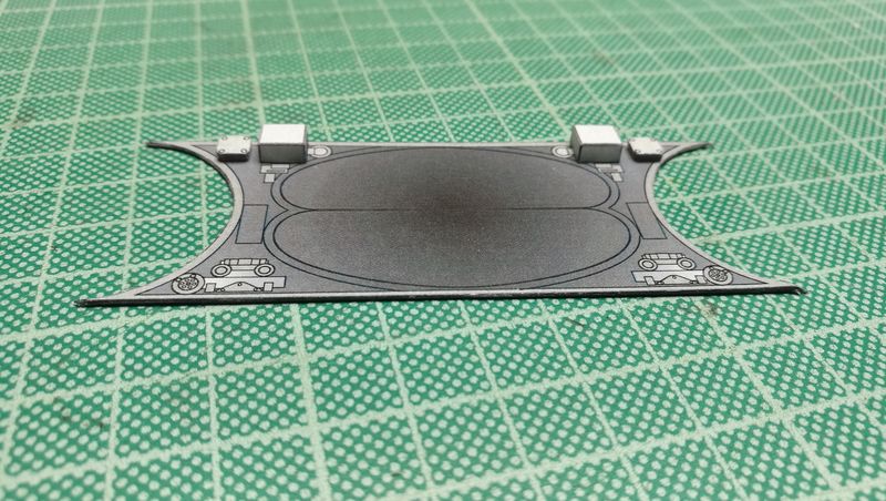

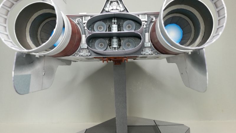

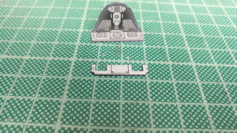

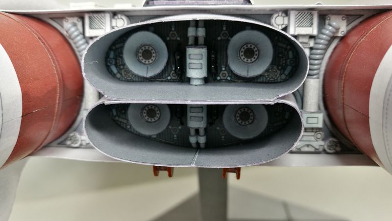

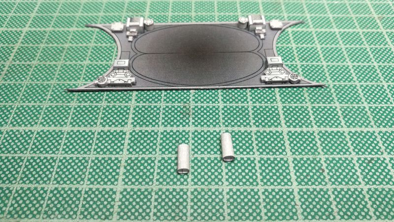

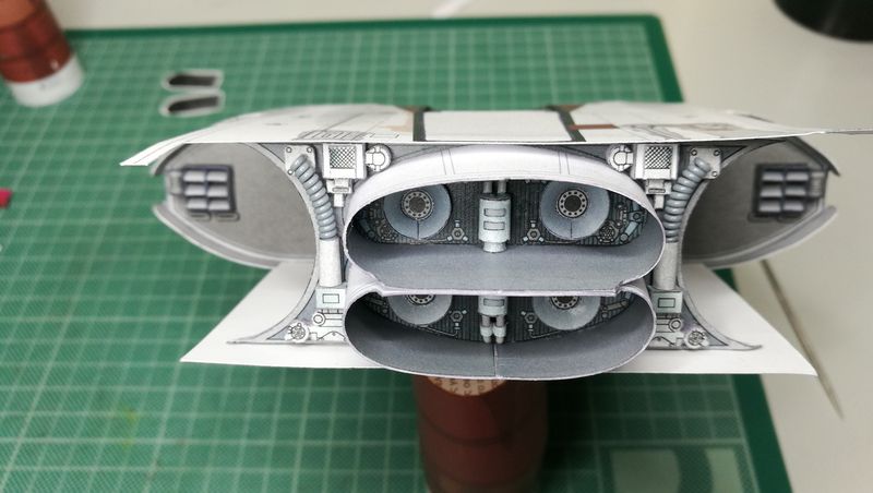

Then I build the Engineplate

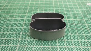

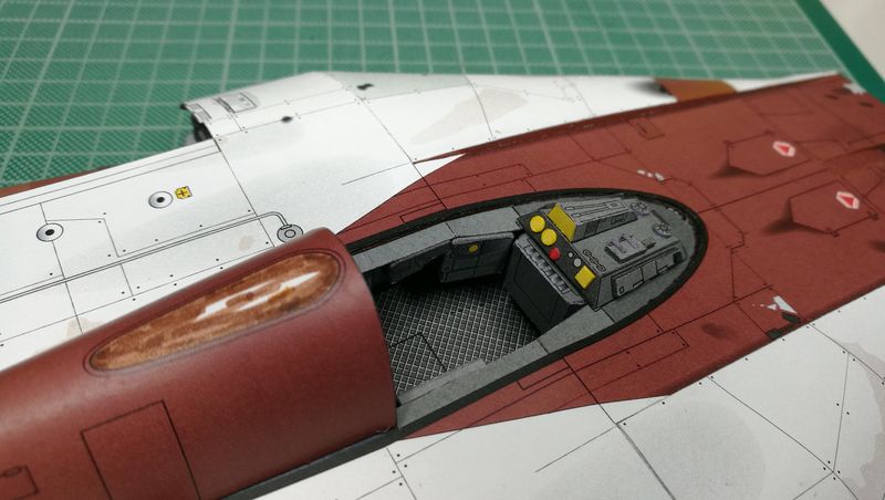

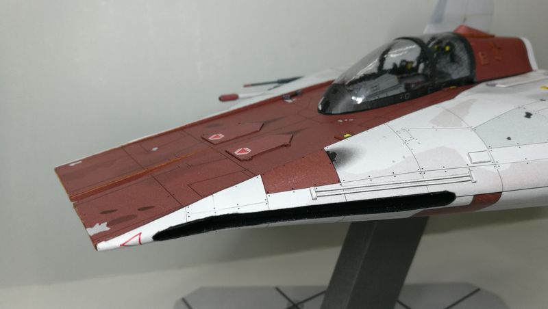

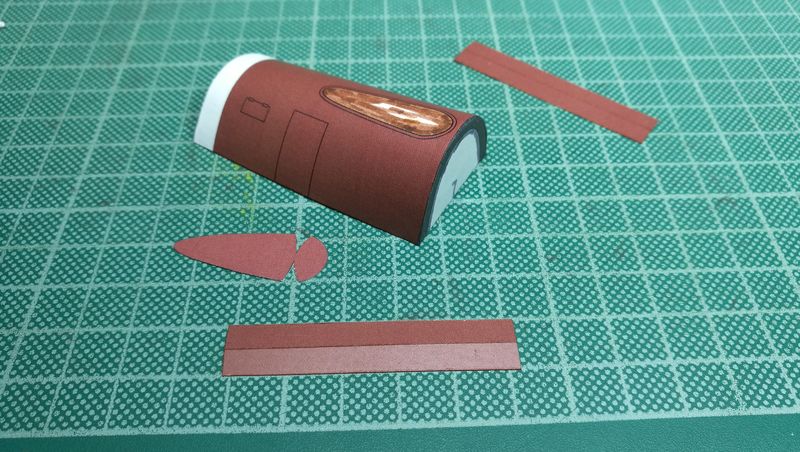

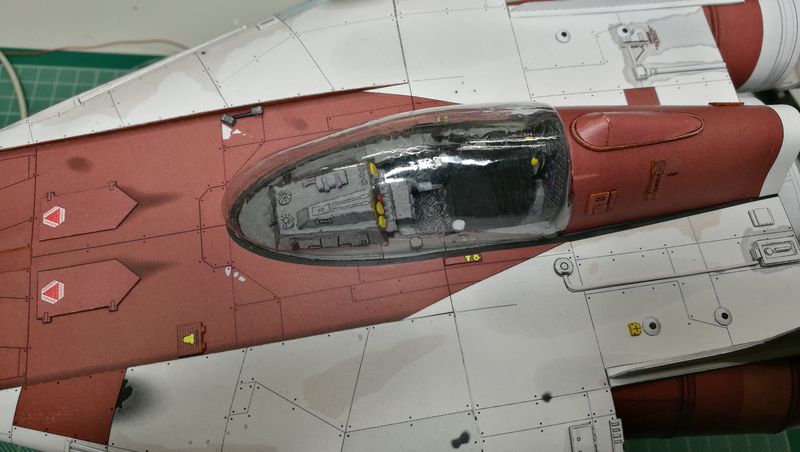

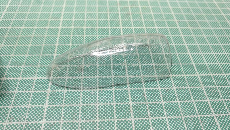

The canopy

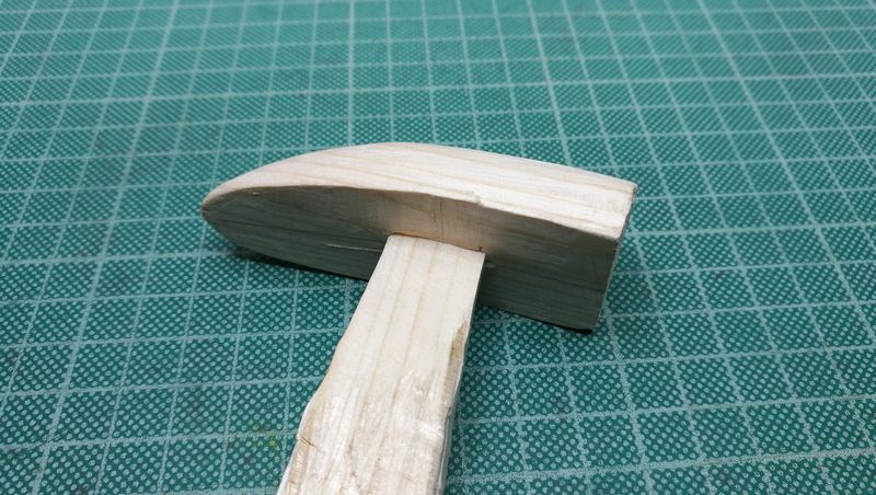

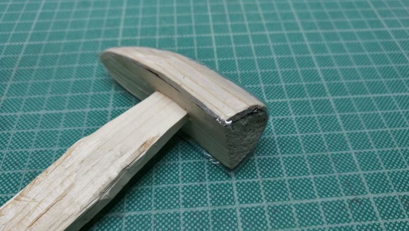

Look, I built myself a hammer :)
For the form I built Sunichi's original canopy and then I formed it using a grinder and sandpaper until the desired shape. After
A quick test
Then I printed out the black canopy parts twice, one normal a bit bigger and one inverted and a bit smaller. I placed the bigger one on the outside and the smaller one on the inside exactly on the same position so now glue is visible.

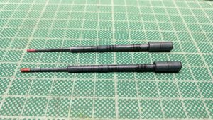

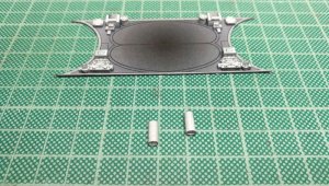

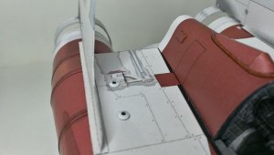

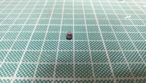

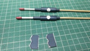

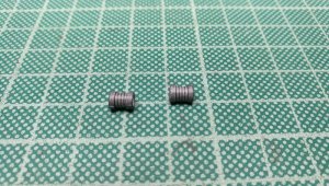

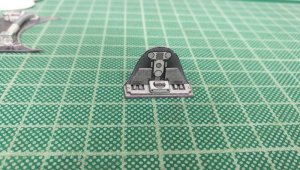

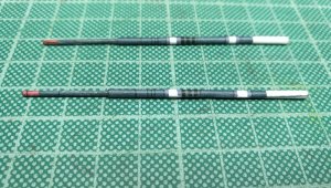

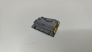

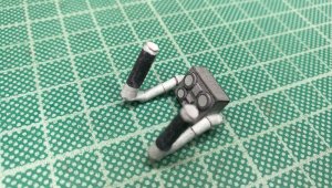

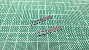

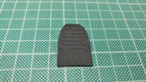

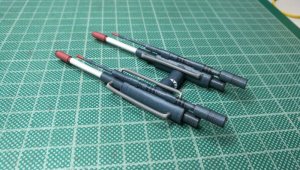

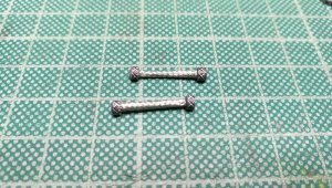

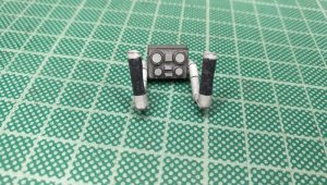

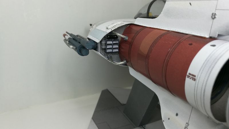

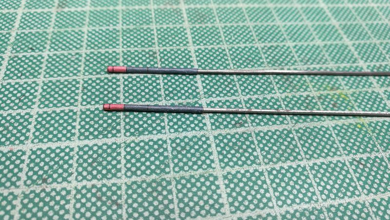

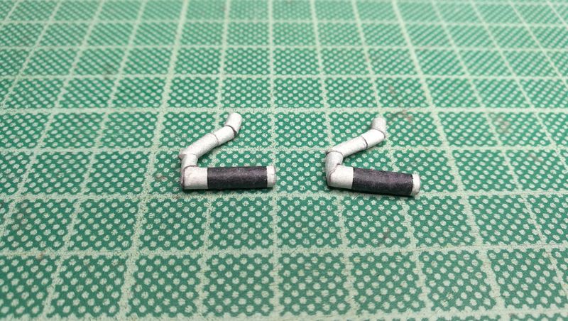

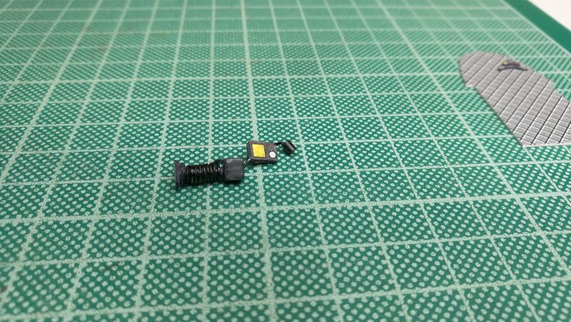

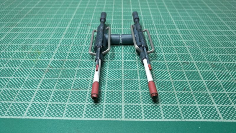

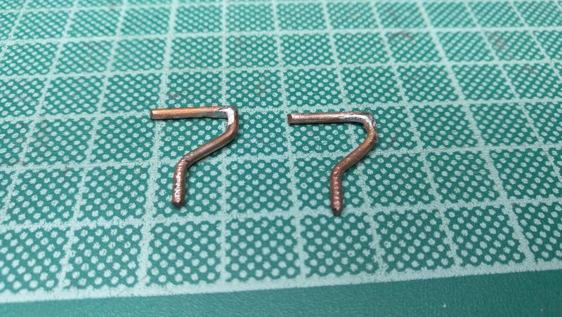

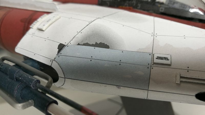

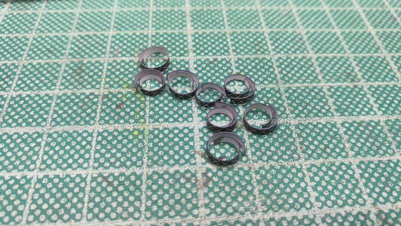

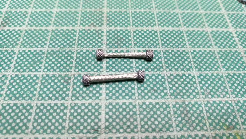

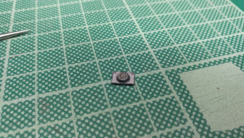

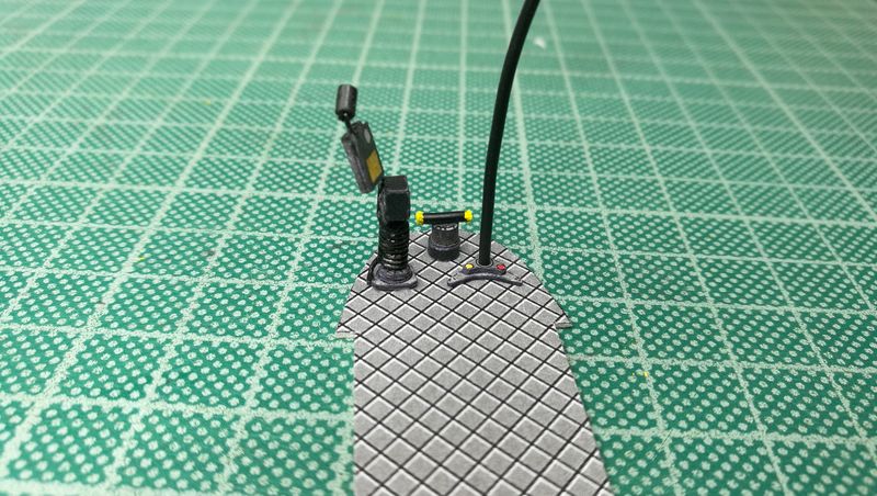

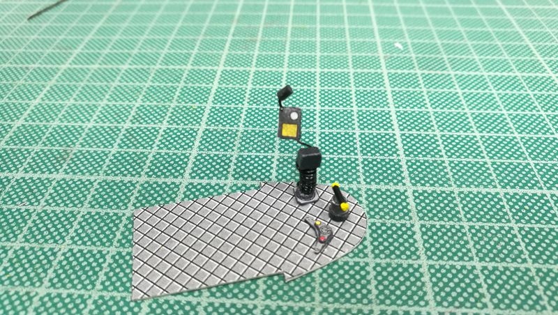

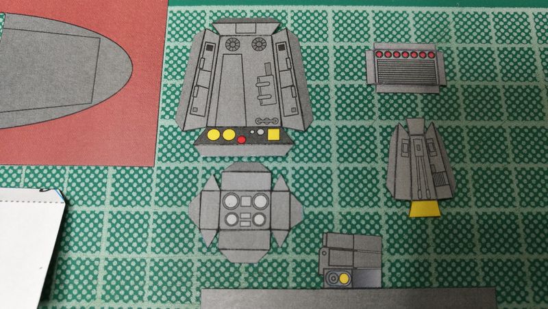

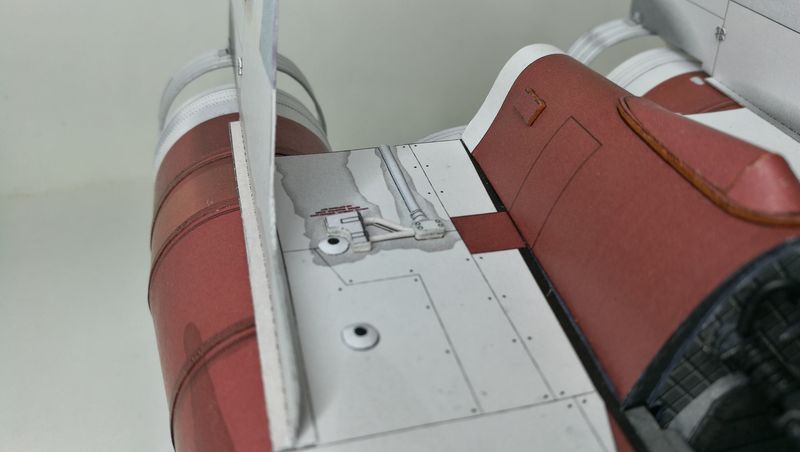

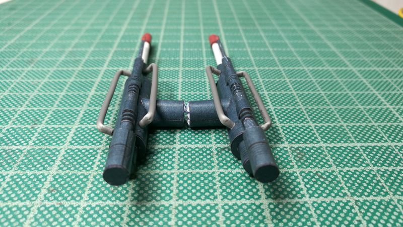

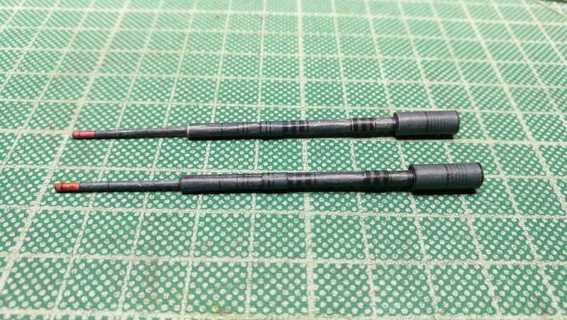

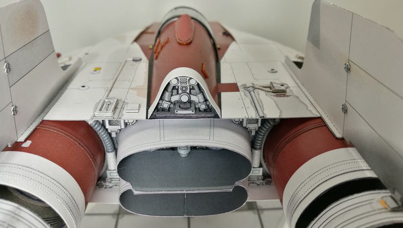

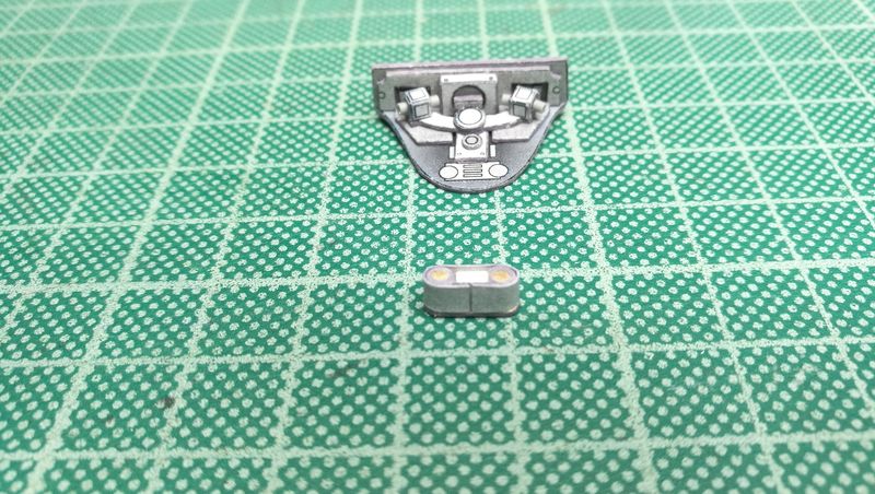

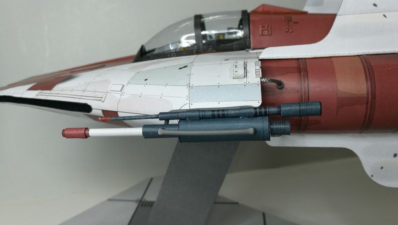

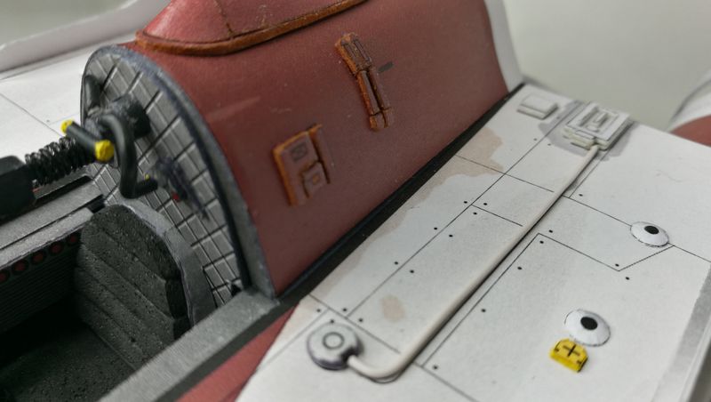

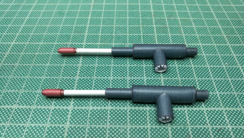

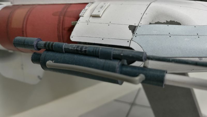

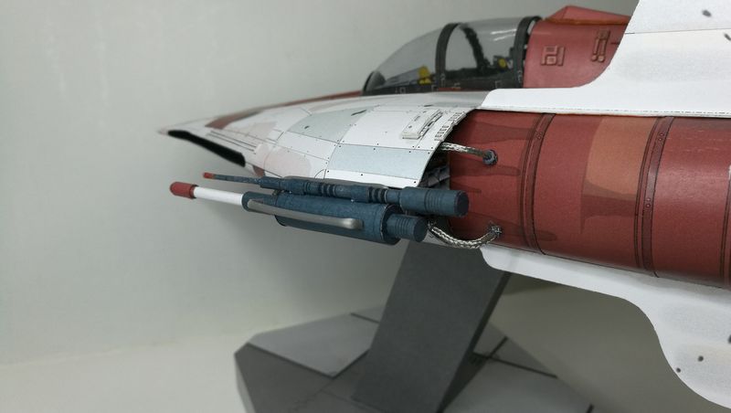

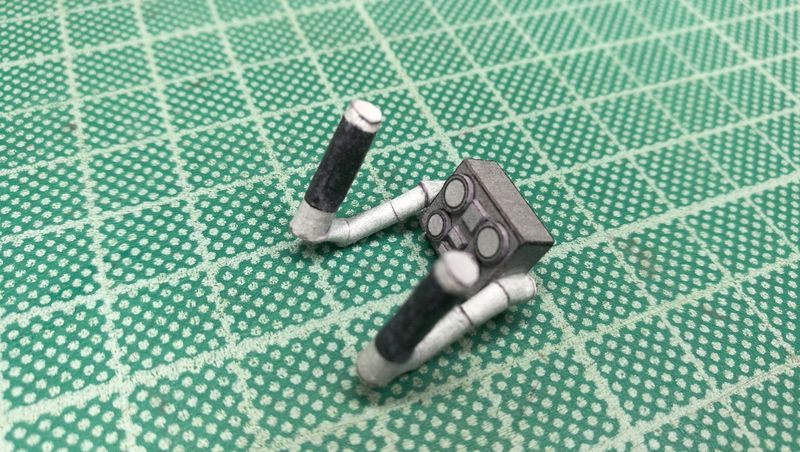

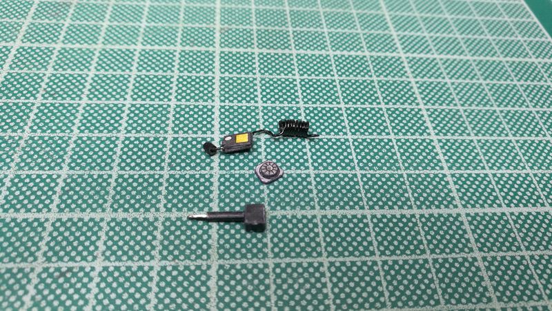

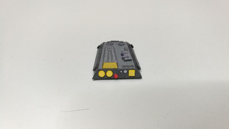

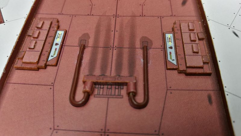

Some additional greebles
