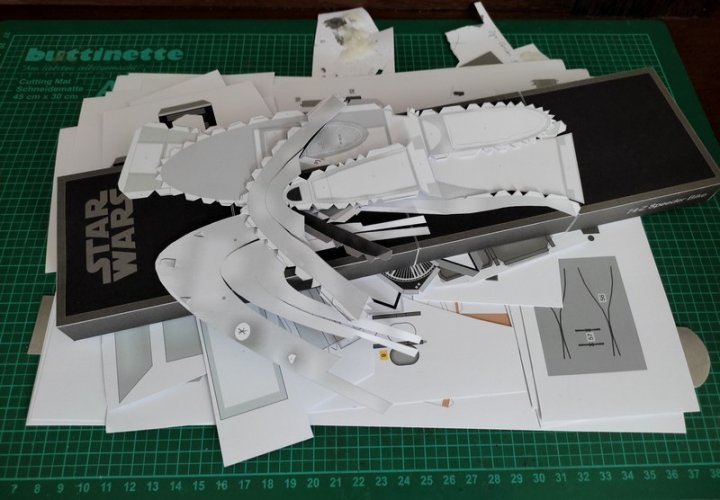

Everything begins with the printing.
Then comes the cutting.
Many parts are easily identifiable, so I swang into action and spent one complete afternoon with cutting and scoring.

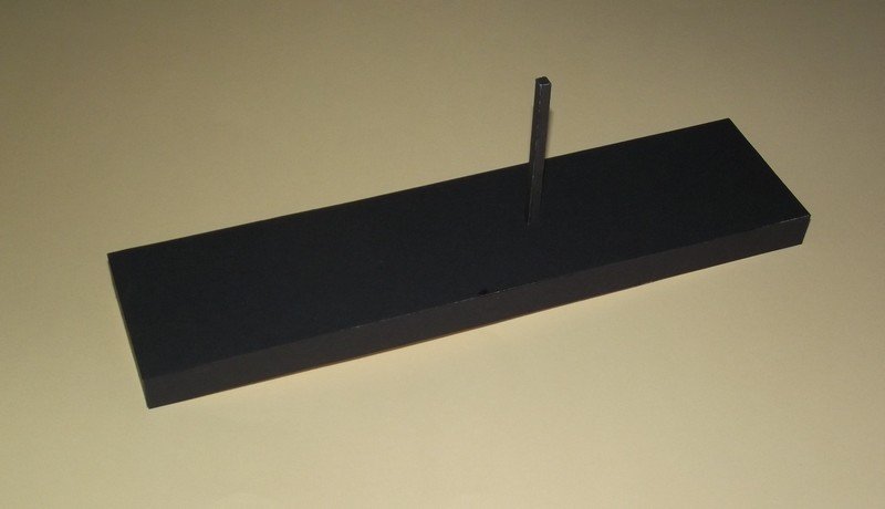

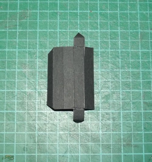

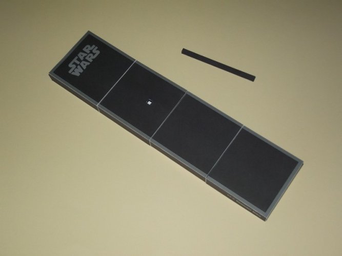

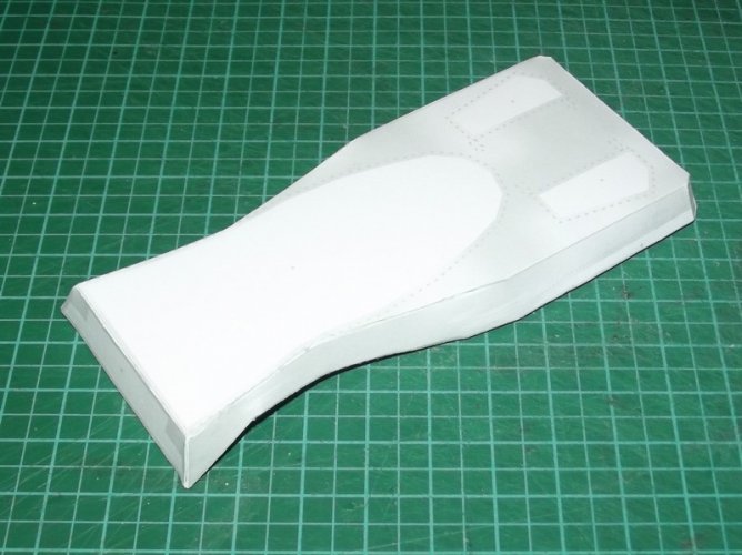

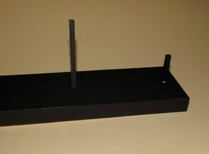

The first big piece I assembled was the display stand.
I did not like the segmented look, so I laminated some pieces of black card to the surface.
This looks much nicer and much more elegant now.

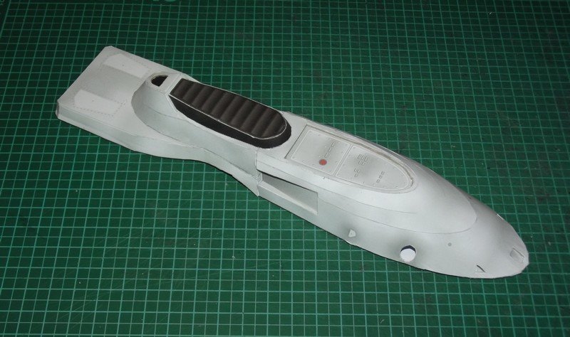

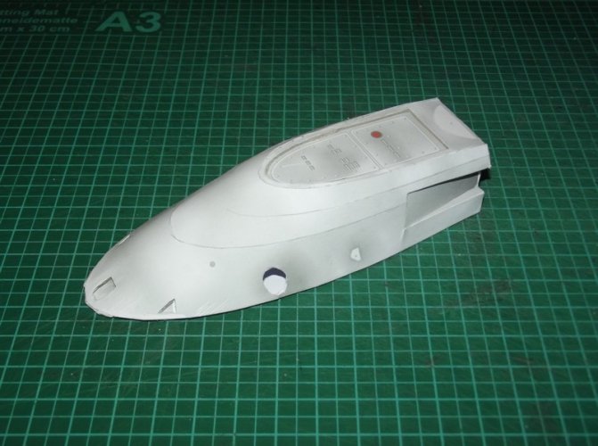

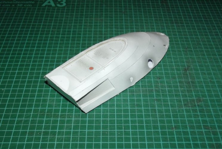

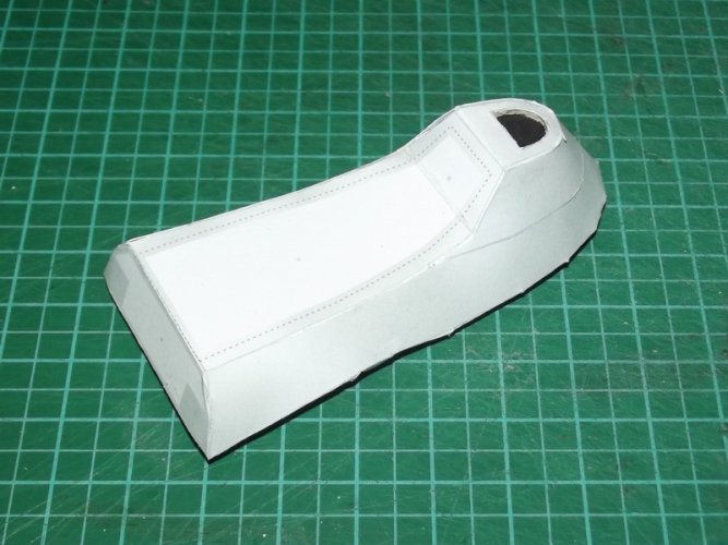

The first thing I changed on the bike was to recess the three small inserts at the front of the main body.
The control panel was recessed using a piece of leftover card. Unfortunately the kit does not provide a spacer but it is not difficult to make one.

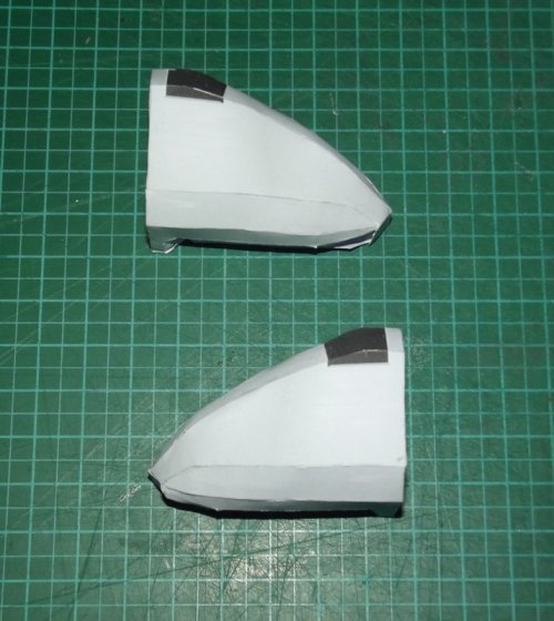

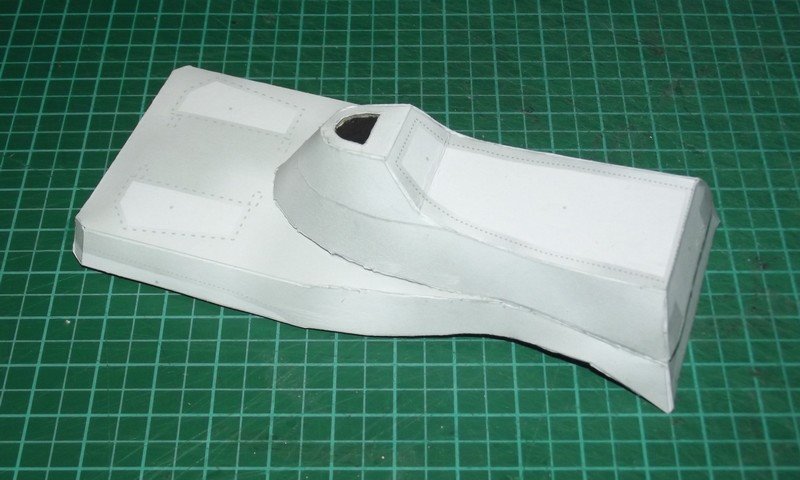

Whenever necessary I cut off the flaps on the curved parts and glued them together with paper strips on the back.
Even at this early stage you can see that Julius met the proportions extraordinarily well and it is a testiment of masterful craftmanship to achieve such a complex shape with so few cuts.

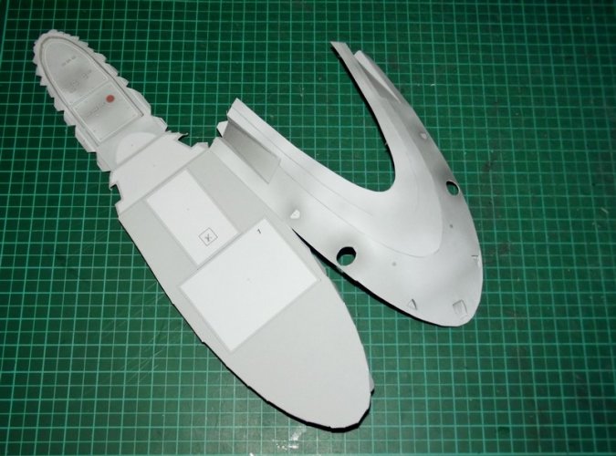

I too recessed the black area behind the seat. Easy job. :)
Both halves are glued together.

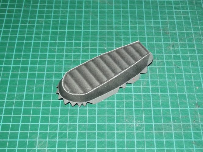

The seat is attached. This piece could be improved since the real one follows the curvature of the bike. However, I guess Julius chose this simplified shape to make the build easier and to effectively hold the Scout Trooper in place later. In order not to mess up the design I left it as is.

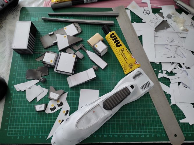

Thank you all for your comments! Let's continue with the next steps - and I indeed took some pictures with everyday items beside the model parts as requested by @Chuffy70 . :)
The metal ruler is 30 cm long.

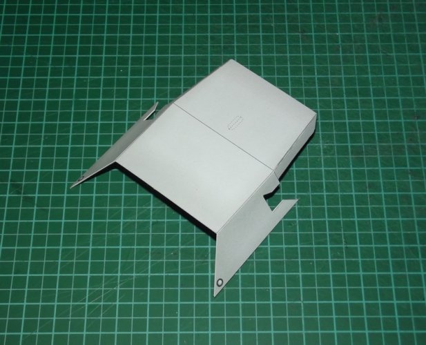

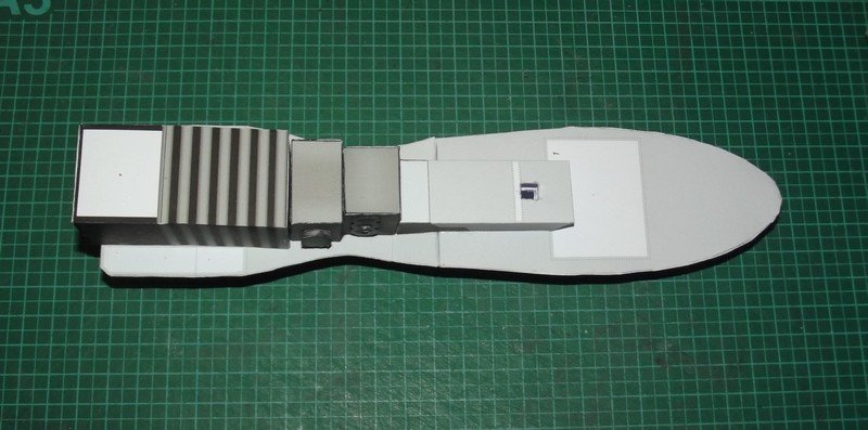

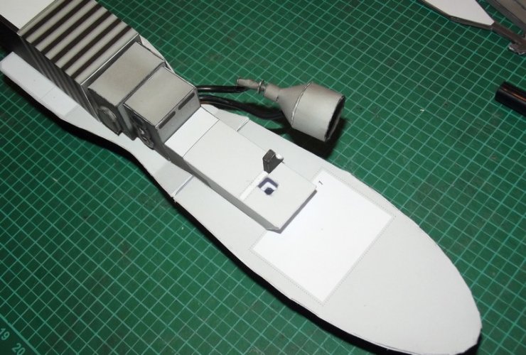

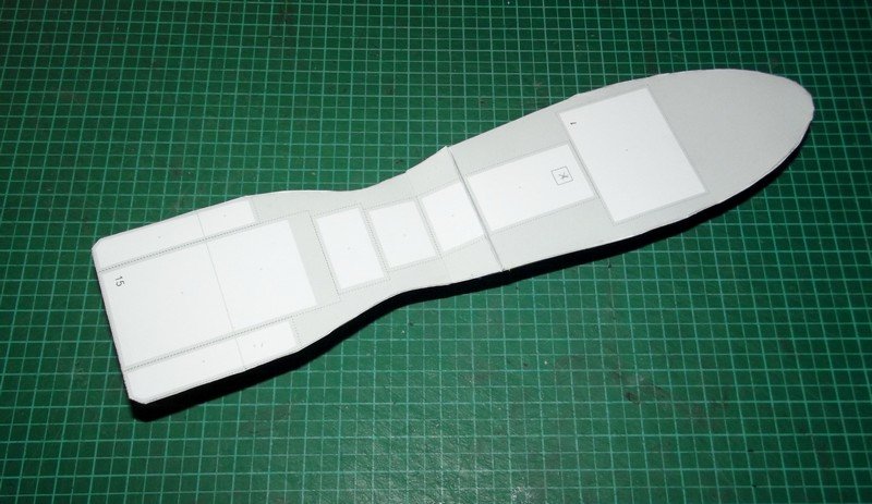

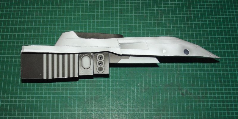

Detailing the underside was very straight-forward because most of the structures consist of simple boxes.
I thought the exhaust plate could be improved a bit. Checking various images of the Bandai model revealed that the shape is pretty spot-on, so I left the exhaust area as is.
I did not glue the final piece in place yet because it is necessary to insert the front fork into it which was not ready yet at this stage of the build.
Please note the hole for the rod of the stand.

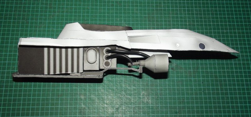

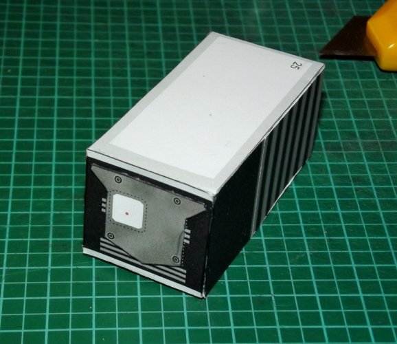

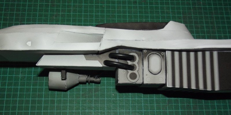

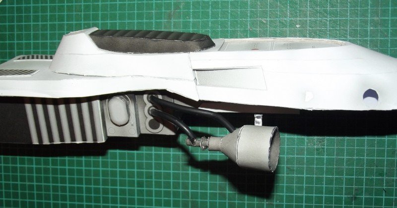

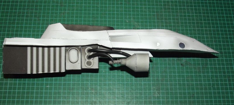

Now it was time for one major change. The original Speederbike features only one turbine whereas the kit provides two. I speculated that Julius did that to make the model symmetrical. Well, that could have been one reason but a more important aspect was that the bar connecting both turbines is crucial to keep the model on the stand. Unfortunately I found that out AFTER I cut the bar in half. :hammerhead:
However, one step at a time. :)

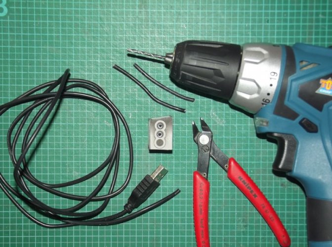

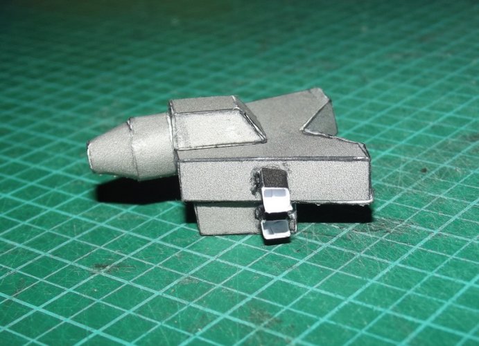

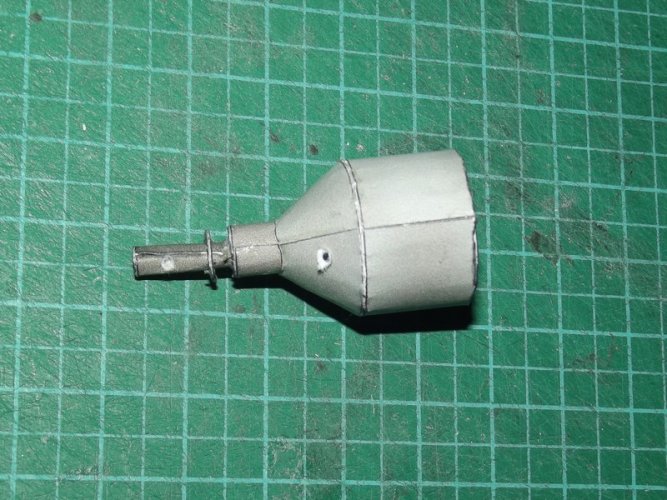

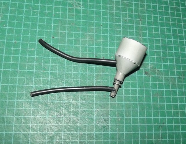

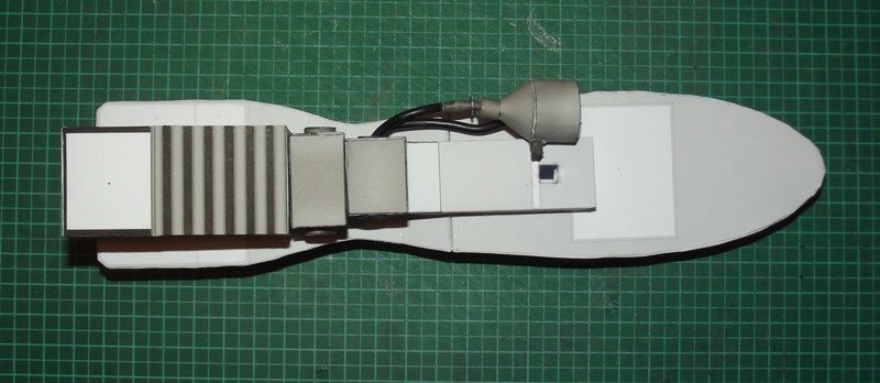

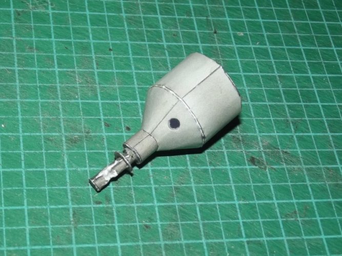

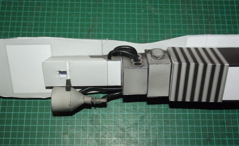

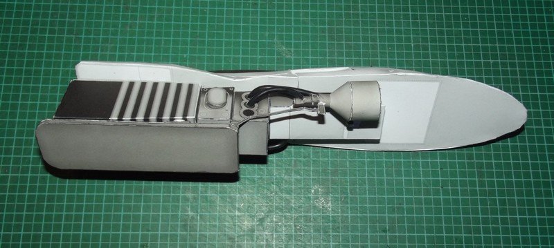

First I assembled one turbine and skipped the other. Then I pulled out my drill and drilled two holes into the turbine and its corresponding tube.
The holes was widened with a wooden rod
till it was able to hold a piece of cable in position. And yes, it is the same cable I used on my Wall-E build. ;)
I secured the cable to the tube with a drop of glue, the other cable going into the turbine fits by friction.
Attaching the turbine to the bike was a bit tricky. The part is very fragile and does not like constant bending and pulling. But with some patience you get this:
Here you can see the shortened turbine bar.
And done! :)
I drilled some holes into the other side and attached two more cables there. I did not follow any pattern, it just had to look good.

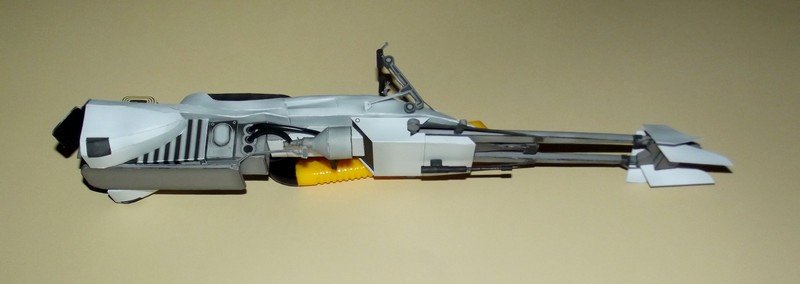

When I test-fitted the bike on the stand I noticed that it was VERY tail heavy which made me rethink the shortened turbine bar idea. I build a simple block from leftover paper and attached it at the bar's position.
To my surprise the bike continued to be tail heavy but the new bar extension gave it some stability. I would address this problem later.

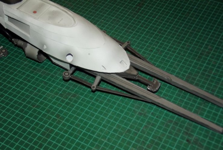

Adding the next components to the front were very easy. The instructions are very precise. It is only the order in which the parts are attached that matters.
A view from the top:

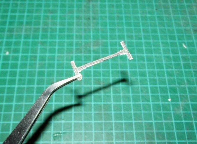

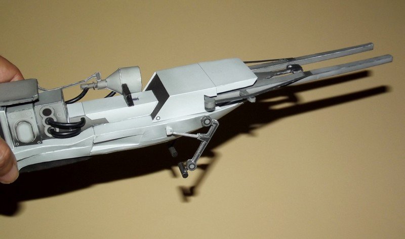

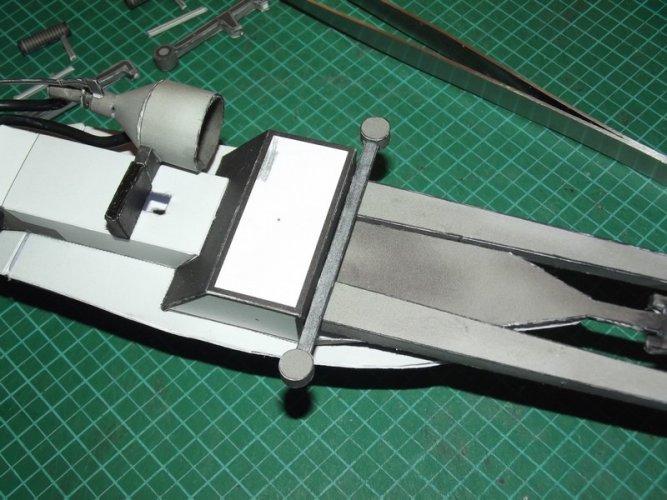

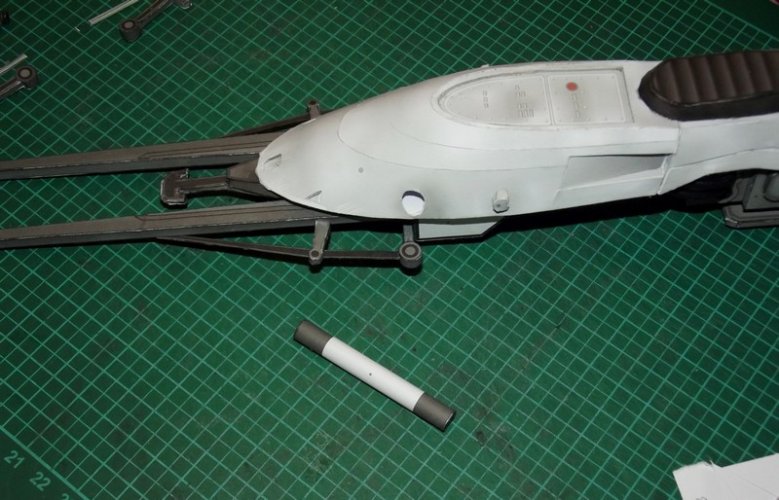

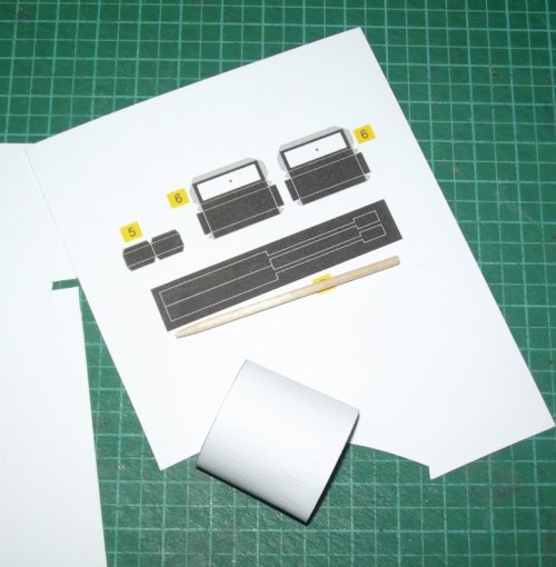

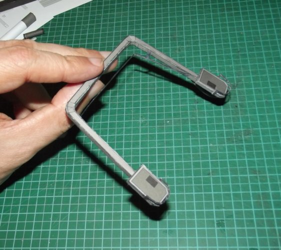

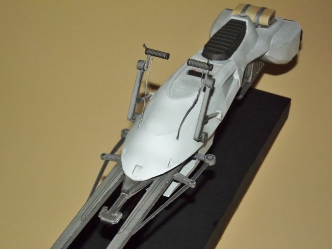

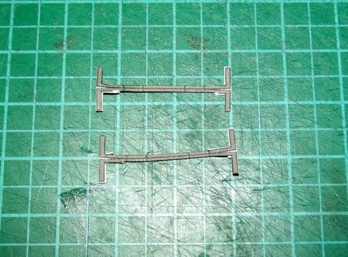

The handle bars are very easy to make but they are fairly fragile and have to be handled with care. It was mind-boggling to see that they both rest on a tube that runs across the main body. This may become handy for someone who would like to make an articulated bike. :)
Since the little struts are so thin it is a bit difficult to see where the angled end is orientated. Test-fit the parts carefully before gluing. Only one position fits.

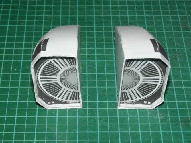

The space shuttle cockpit halves which were used on the filming models are simplified but fairly nicely representated:
For a moment I thought about cutting out the black area but decided against it in order not to spoil stability and to give the finished model some additional colour.

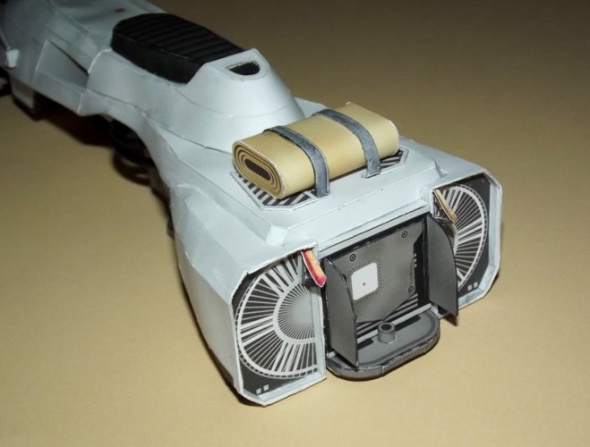

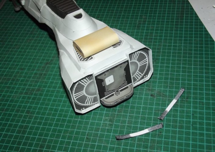

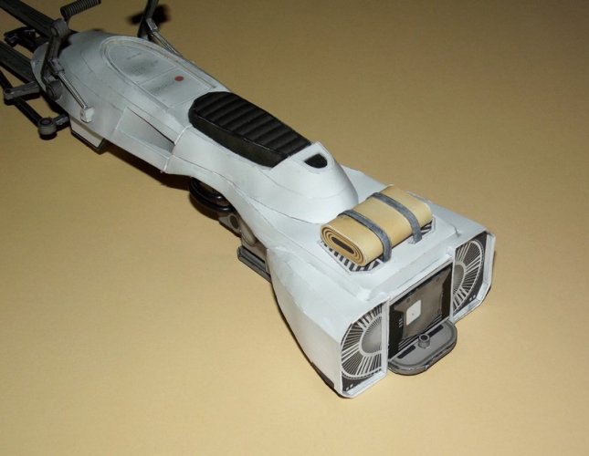

The "piece of luggage" adds some flair to the model. It is nice to see that the straps are seprate parts. You could add some buckles for more authenticity.

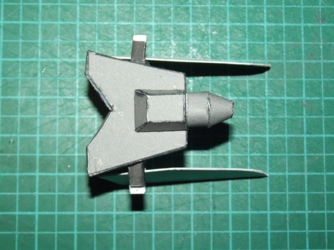

One important note: Parts 70 fold into two triangles. They are in the instructions but they are hard to spot because Julius forgot to add their numbers in the assembly pictures. They go at the rear and hold the exhaust flaps into place.
It is important to align all parts very carefully. Make use of the provided straight-on views that come with the kit.

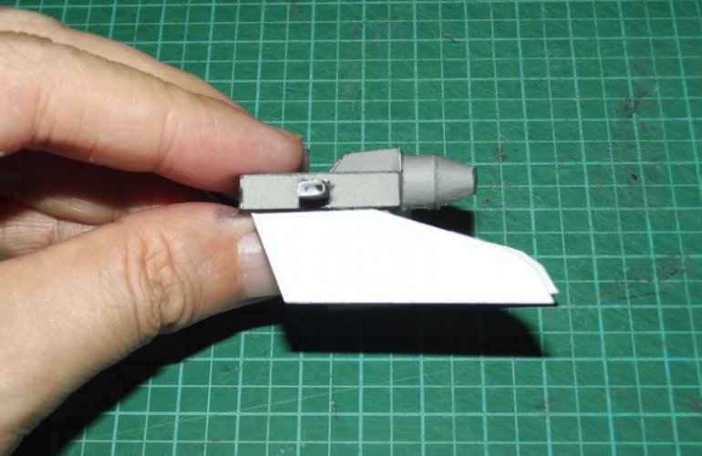

Now I had a problem: With all these delicate parts attached I had extreme difficulty keeping the bike somewhere. There is no area available which could rest flat on a table. So I stuck it onto the stand for the time being or used an open box, again similar to my Wall-E build. :)

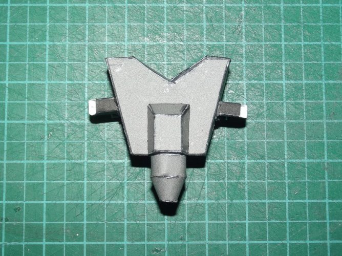

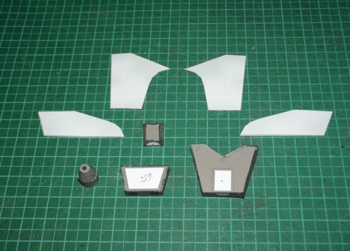

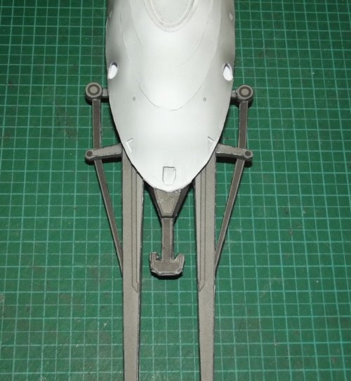

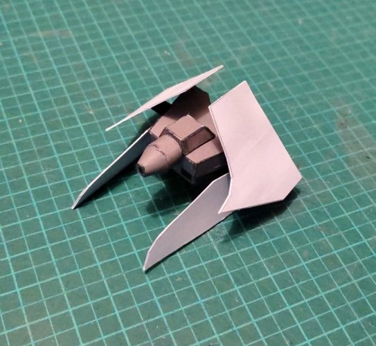

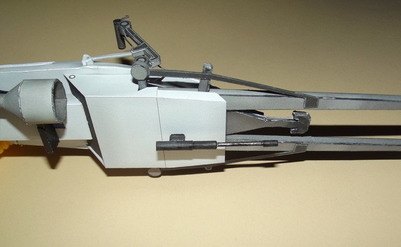

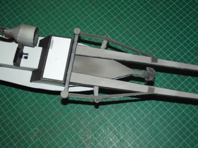

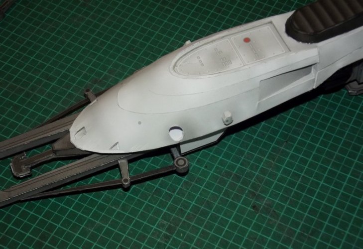

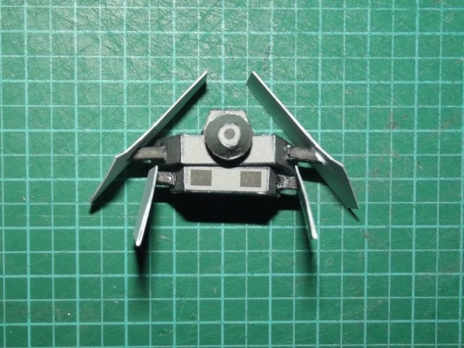

One of the most complex steps is the assembly of the front stabilizers. There are no alignment marks and you have to rely solely on the top, bottom and side views Julius provide with the kit.
To give you a better idea of how to attach the parts I have taken a lot of pictures from different angles. Study them well if you want to build a bike, too.
The black struts are supposed to go straight to the sides. I corrected that on-the-fly and pushed them into place.
(No, I did not hurt my thumb; the spot came from the marker I used to paint the edges. ;) )

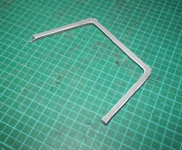

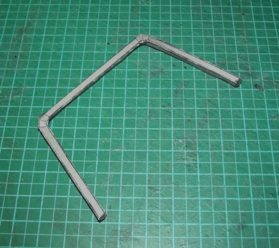

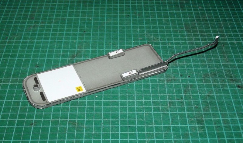

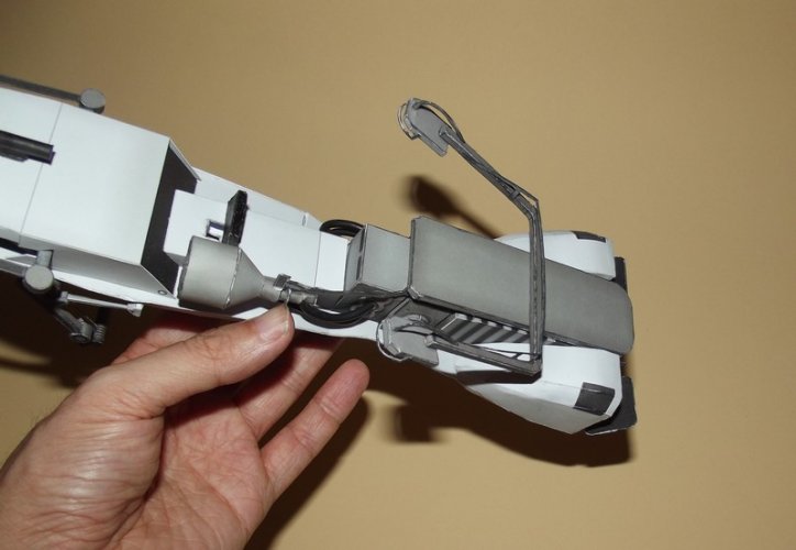

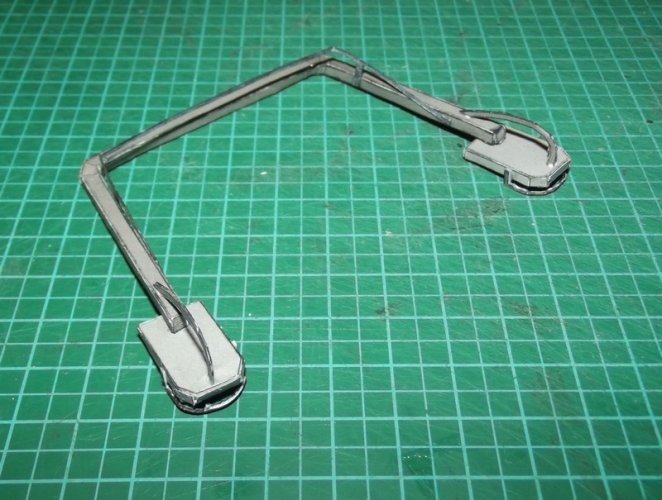

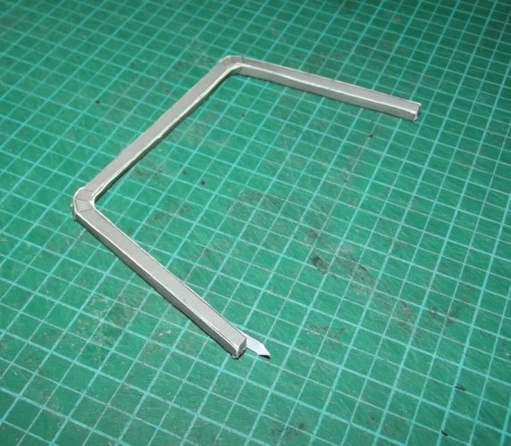

The foot bar was next. The main piece consists of two parts, one outer shell and a strip which is glued to the inner perimeter.
The strip was a bit too long and had to be shortened.
Part 77 should have been doubled to colour the back side. Since there was no second version of the part I used my marker to paint the back side.
The foot straps:

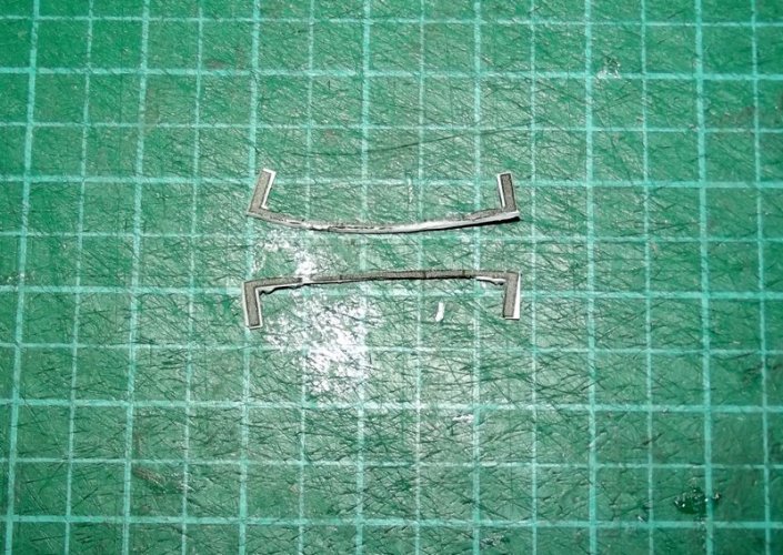

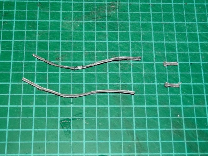

I found it easier to laminate both parts back to back and cut them apaprt in the middle instead of folding each piece in the middle.
Everything attached:

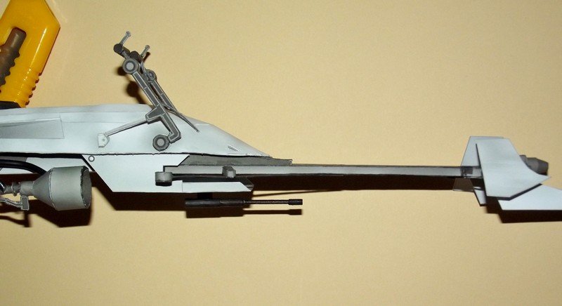

Some detail pieces were added to the handle bars:

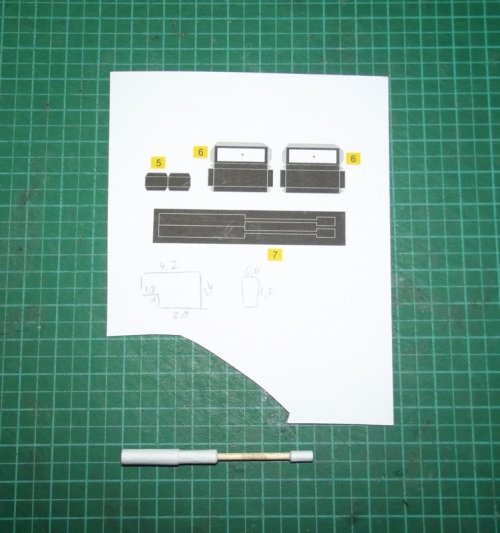

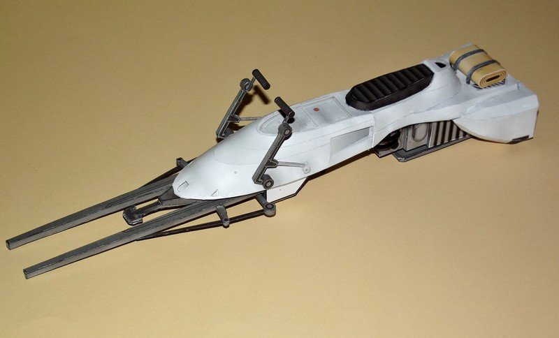

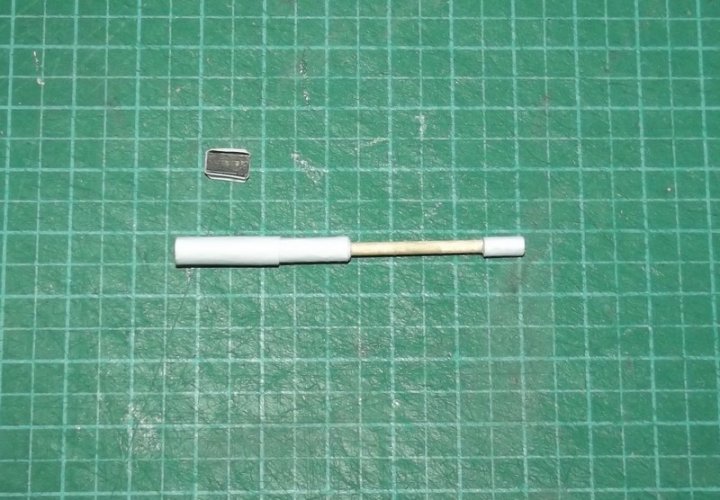

The main gun is supplied as a flat piece. I chose a toothpick and some scrap paper to flesh it out a bit:
The gun was painted black and attached.

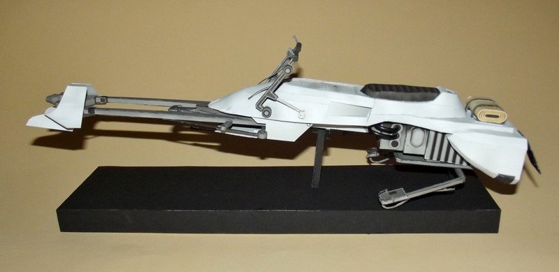

The bike was held in place nicely with the help of the added block. However, this was going to change very soon...

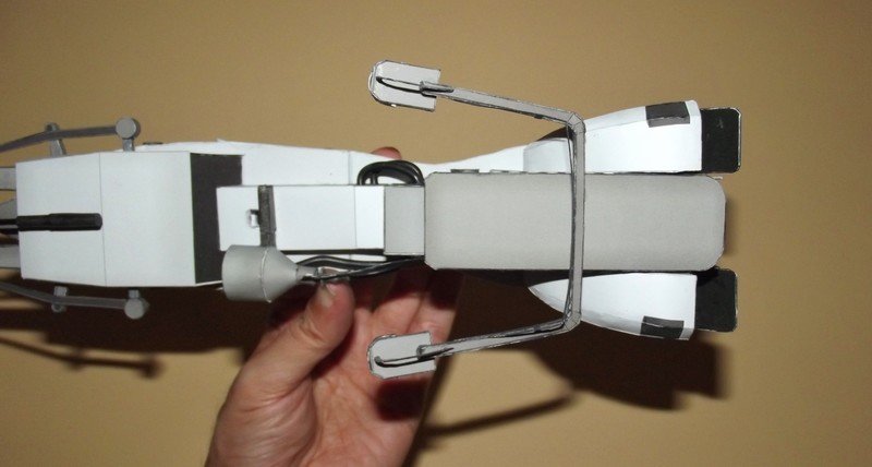

Because when the foot bar was attached -
it began to sag!

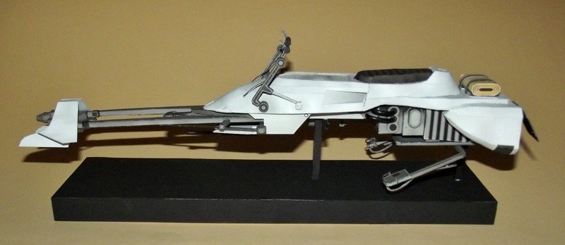

The added weight of the foot bar sealed the fate of this construction. There were two solutions: First, move the mount an inch closer to the tail of the model. This was not possible without the risk of damaging it. So I went with solution no 2: Adding another support.
Much better! :)
