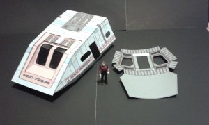

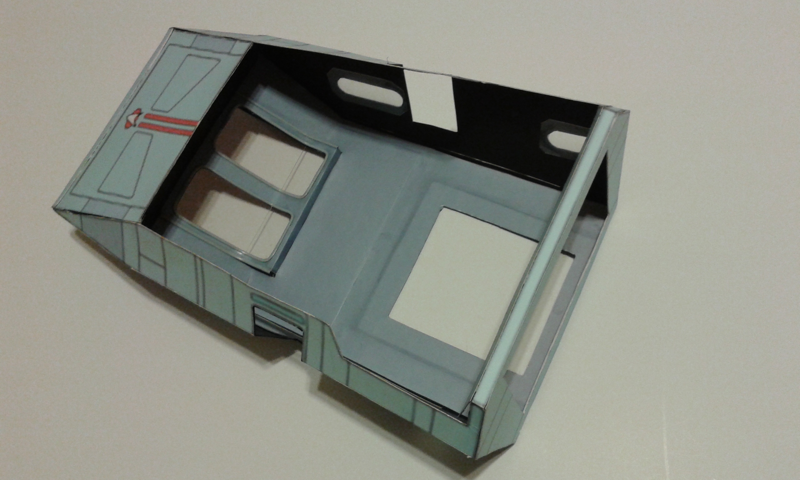

So, my first build thread.. Please bare with me. Have decided to do the Rubicon Runabout from Paragon. (Paragon is awesome) Everything I have done so far has been as close to 1:18 scale as I can get without getting ridiculously big. This appears to have overstepped that somewhat. Just now realizing how big this is going to get.20141118_171414.jpg

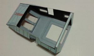

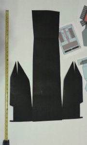

This may be a little ambitious. Any way, I am going to try and do interiors and lighting as well. I like to use black poster board to reinforce the card stock and also stop bleed through of the interior lighting.20141118_171515.jpg More to come soon.

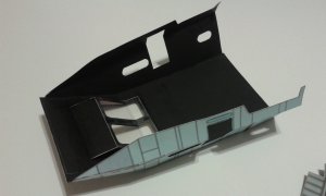

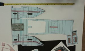

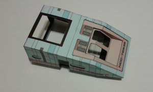

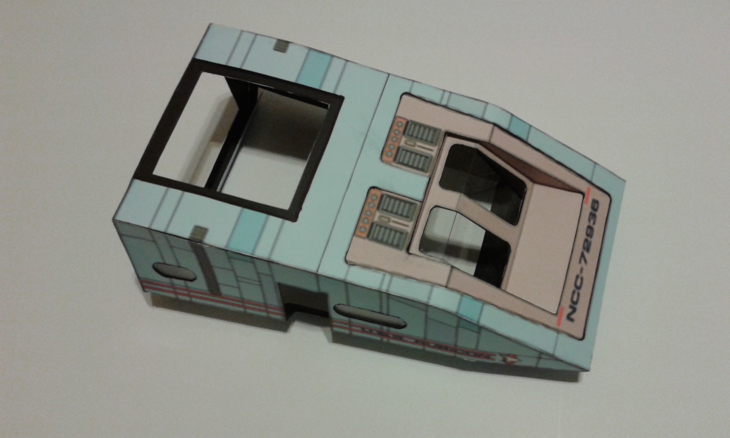

Haven't had much chance to work on it. I try to put access panels in so the interior can be viewed. I use magnetic printer paper around the edges to hold the panels in place. Since it is very thin it barely raises the panel out of the model at all.
Looks like your off to a fine start. Looking forward to more. So how does that magnetic paper workout, cause I've never heard of it, magnetic ink sure, but not paper.

Thank you. The magnetic paper is just sheets of paper with a thin magnetic back. It comes in gloss or matte and can be used in a laser jet or ink jet printer to print photos on. If you notice in the picture I have cut an opening in the top of the ship. the black around the inside of the opening is the magnetic paper with the paper side down. The panel will have a matching piece of the magnetic paper on its underside, so when placed in the opening, the magnets will hold the panel in place. It also creates a nice seal that does not let light bleed out.
