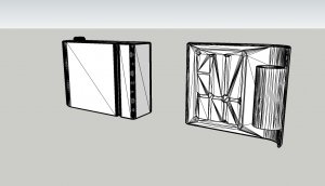

Good idea - with one issue:

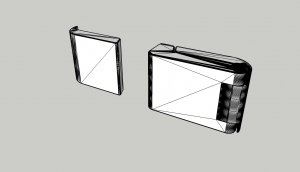

These *.stl files are designed for 3D printing and require LOTS of work to be turned into paper models. The renders always look fine but if you look at the mesh you see this:
Each model part consists of a series of triangles. Imported in SketchUp they appear as lines, even on the faces which are on the same level. These lines must be deleted first before you can start unfolding.
That should not be a big task but there is something else which I encounter every time I look at an *.stl file:
To avoid sharp edges after printing all edges are rounded off. In papercrafting we don't need those round edges and corners. So these must be turned into straight faces. Depending on the complexity of the model this can be a daunting task.

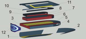

So I recommend to start from scratch, using the overall dimensions of the *.stl file for reference.
Reactions: zathros
In Rhino3D, I just peel those useless lines away one by one, making an original copy in case I screw up, and after many house, you end up with a set of lines which you then convert into "Curves', as there is no such thing as a line in Rhino. It's possible. Having a file is half the battle. ;)

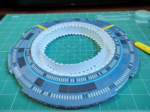

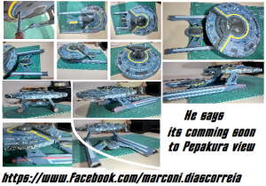

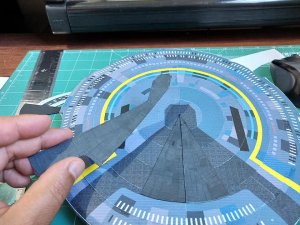

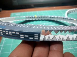

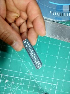

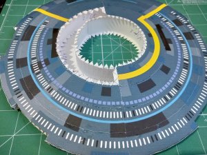

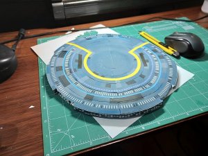

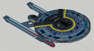

Great to see the fleet growing! Please keep us updated on the model, Jim. :)
It looks like it was made in SketchUp and it builds up very nicely.
He is Portuguese and doesn't speak English. I didn't mean to come off sounding offended, I was in the middle of a delivery at the door and just spent about an hour correcting sizing errors on one of my starships that printed out differently than I expected. i get a little short sometimes.
