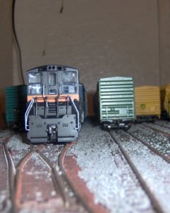

I use 14' scale centers in my yards..Here is what 14' scale centers look like.
