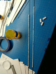

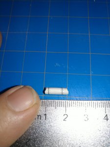

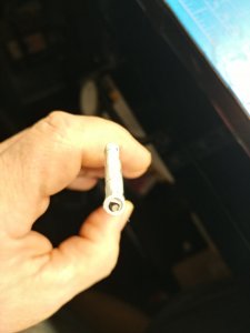

yup, the one with ALL the tubes.. i'm at it again. am i crazy?? yes.. but i enjoy it so much . so, all printed out on 11x17 67lb paper as always. i'm starting with the backbone first to get the drift on how rolling the tubes and putting it togther.20200101_103729.jpgfirst tube .. i trimmed off some of the extra paper so that i could get it to roll tight

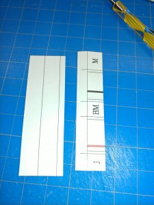

20200102_142427.jpgbefore
20200102_142507.jpgafter
it helped to wet the paper to make rolling easier. using different size wood and metal rods to get it so the ends would meet

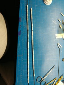

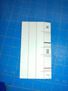

they are marked on how they are to be joined end to end.notice the longer one has some colored rings. that comes to be important later.

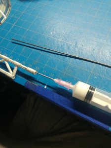

i found old marker flags that have a thin metal rod.. perfect for helping to assemble the parts togther

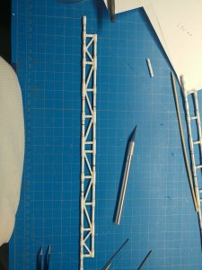

so you have a total of 2 short uppers and 2 long lowers.

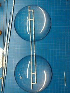

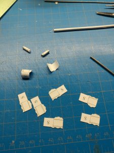

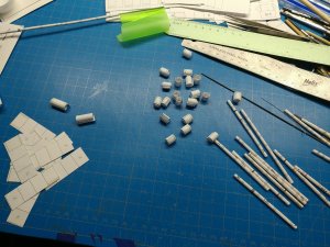

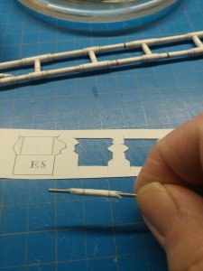

now some more fun stuff. attaching the beams together.. i cut out and rolled the connectors ..10 per side. 20200111_201422.jpg
the thin metal worked great for getting them tight to the marks. the directions say to use a tooth pick but its just a little too big. the rod is smaller but after you roll it tight and then release pressure a little you can get the lines to come together.20200111_224338.jpg

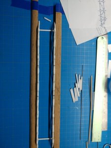

here i attached only 2 at either end and used these "weights" to hold them flat..

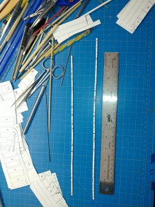

lastly all the connectors in place and dried. old ruler shows on how "small" its gonna be. and this is only the back bone. other side is done the same way BUT ( remember the colored lines) , you want to make sure they are opposite of the other side so they match. next will be the cross bracing, which looks to be really fun on fitting into place. yes , MORE tubes to roll.. oh why do i keep doing this to myself??? i guess it's fun?? hahaha.. anyhow , thanks for looking and i'll keep building.

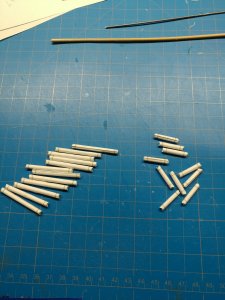

10 pieces and at different lengths, plus 2 end pieces

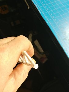

i did not like the ends open and you could see the rod inside.. 20200116_204503_HDR.jpg
so.. grabbed one of my " professional leather tools" ( and i am in NO way a professional ) and cut some end caps..20200116_204746_HDR.jpg

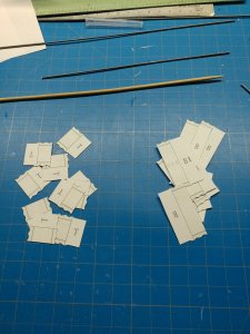

much better.. now, on to all the top and bottom cross braces. 10 small top and 12 larger bottoms

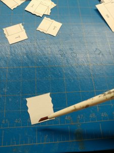

i found out..by some great people here.. that wetting the paper a little makes it easier to start rolling the tubes. 20200116_210924.jpg
all rolled and ready to glue into place

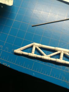

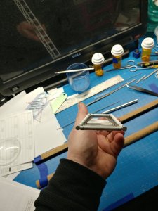

the plans call for using book edges to make a straight edge for this part. i started looking around my room and spied 2 pieces of 1/4 round laying on the floor..( no, i don't know why or where i used them before..) taped 1 down, put 1 rib along it, using 2 of the bottom tubes at the ends found where to tape the other piece at.20200116_220128.jpg

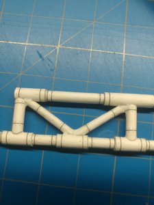

the real fun part of this was trying to get the correct angle of both sides. starting at one end and using one of the smaller tubes, just angle in till it holds it in place and glue. then do the same for the second upper tube, the gluing 2 lower tubes. you Have to let them dry in place first or mishaps happen. trust me, they will happen. also it helps to "place a large and small tube...not glued.. at the other end to keep every thing in line.once dried you can work your way down the spine gluing a bottom then the upper tubes, checking as you go along that it's square..mine came out tweaked a little. some slight twisting..and i mean slight.. got it straight. add a little extra glue to the joints and its done..20200118_100858_HDR.jpg

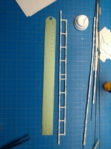

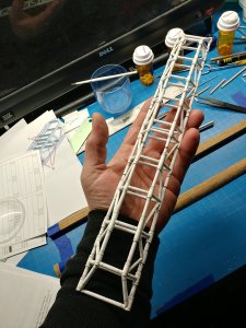

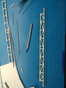

here is the finished back bone and its just a "little" big
14 1/2 inches long and almost 2 inches wide.. kind of gives you a idea on how "small" its gonna be.
