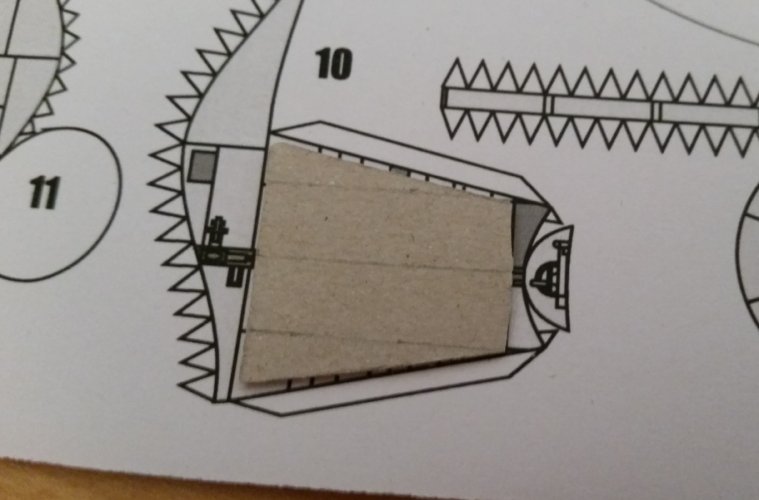

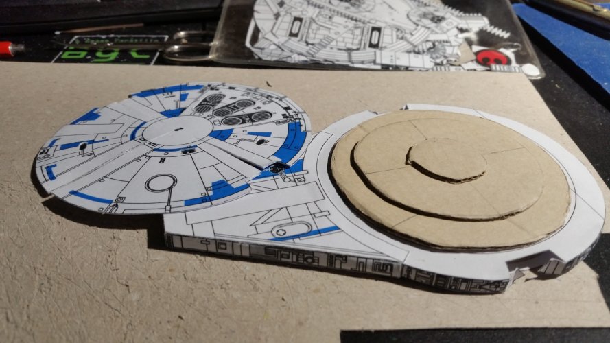

I started out with stabilizing cardboard sheets for the saucer part and the bow. Just improvised and guessing how to put them. trusting my heart and little bit reasoning:
I then added a second top saucer part where I cut out the places of the six black radiators. Did not take picture but will be seen later. It is the same what @starbuck did here: https://www.zealotmodels.com/thread...ion-of-the-movie-solo-building-thread.180808/

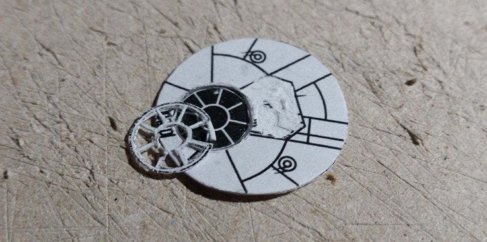

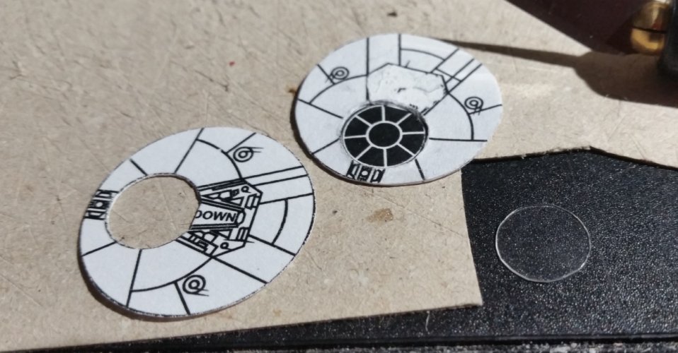

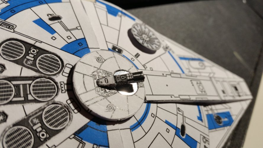

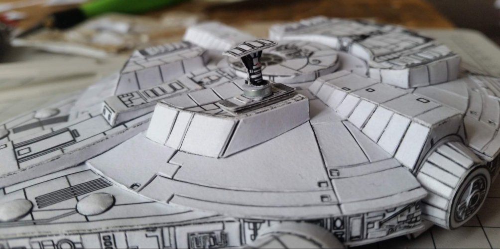

Next the upper turret. Here I wanted to use a small plastic lens, cut out from some stiff packaging, as a glass window.
Then I was thinking, why not cut out the white frame of it from another print, to glue it on top for a really nice 3d greeble look. But the cut out piece was to ragged and destroyed to use. Perhabs later I will try to paint the frame with not thinned white acrylic paint to achieve that effect.
And that leads to the foto which I posted a few days ago in the discussion thread of that model resource. That reflection on the window really shines
With all the cardboard in it, that thing turned out quite stable with much structural integrity. And it is very fun to build.

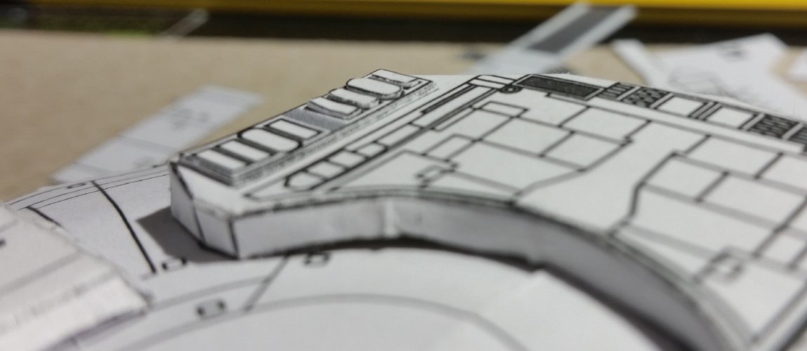

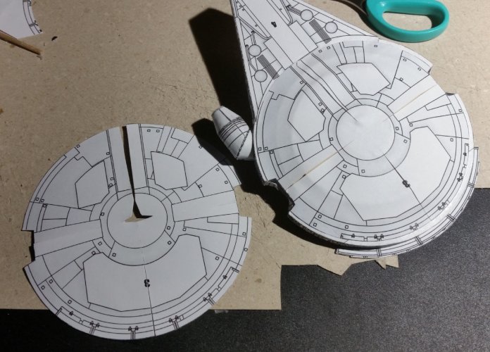

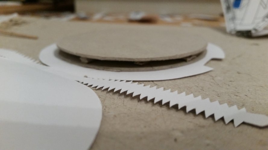

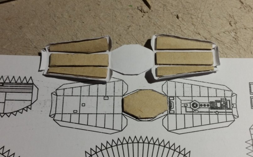

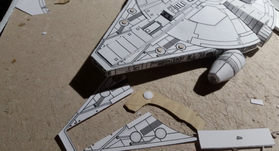

Used two layers for the bottom saucer part. One to close it and then a thicker (190g paper) to smooth out the terrace-like steps from the cardboard inside. Also had to cut out creative gaps in the middle of the saucer parts to get the curving of the flat paper right without major folds and bumps. Also had to cut in at the back part (where the 3 is indicated) and hope that the cut will be covered up and hidden later with the other parts from the underside of the model

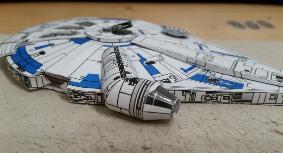

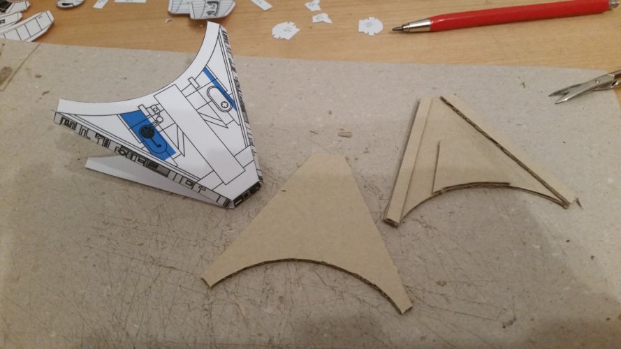

Then I got to the point, where the side parts had to be assembled. These corridor hulls with the escape pods at the ends. The first I reinforced with corrugated board. I think with that model I am all for stabilizing (cause I mostly used 120g paper, quite thin). But in the end I had to leave out the 8 edged board in the middle, it was to thick.
And then I realized that with two saucer sheets each at top and bottom plus the board sheets inside the hull was to thick for the escape pod side corridor. I had to cut the corridor parts in the middle and glue one half on top saucer the other half on bottom saucer.
But it worked out in the end:

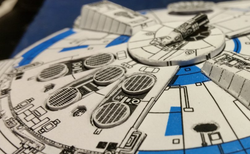

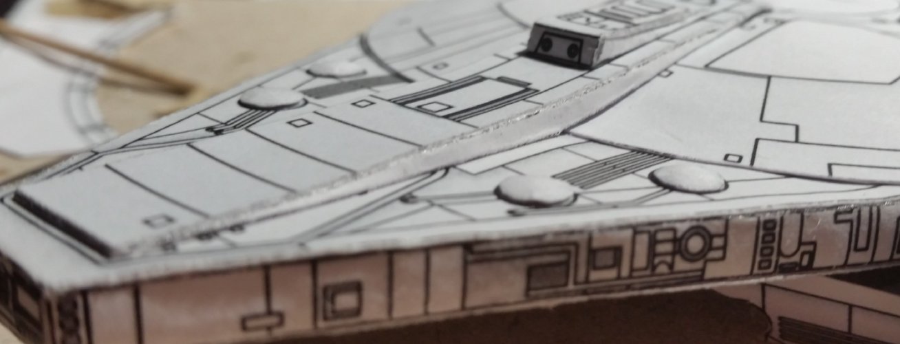

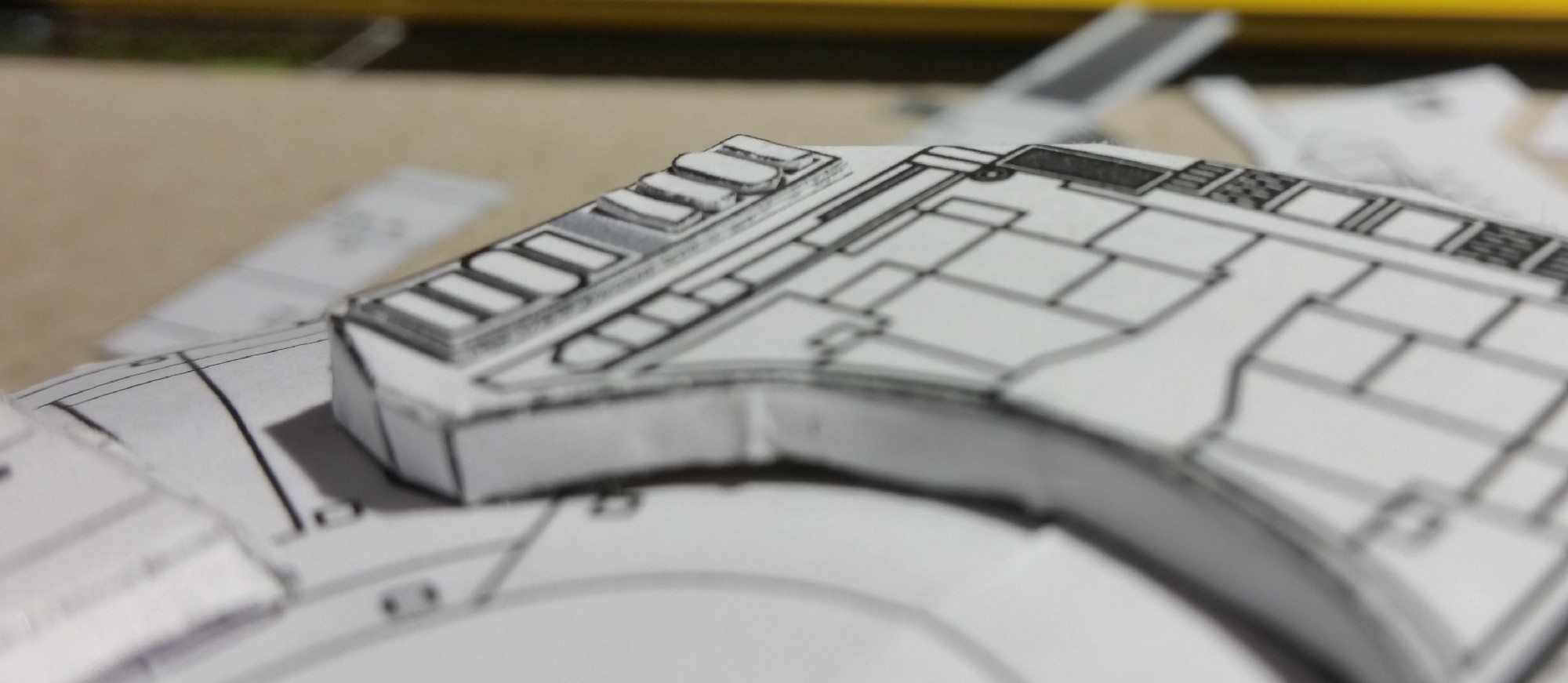

I added an additional thick back region of the top saucer and laminated the 6 round radiators to let them pop out.
After that the small round things on the underside of the bow. Don't know if they have to be concave or convex. Mine are convex now.

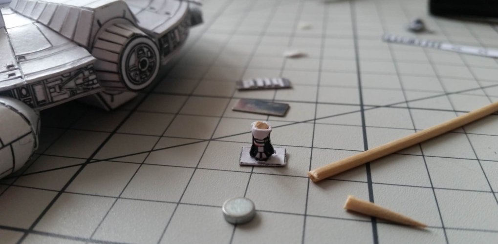

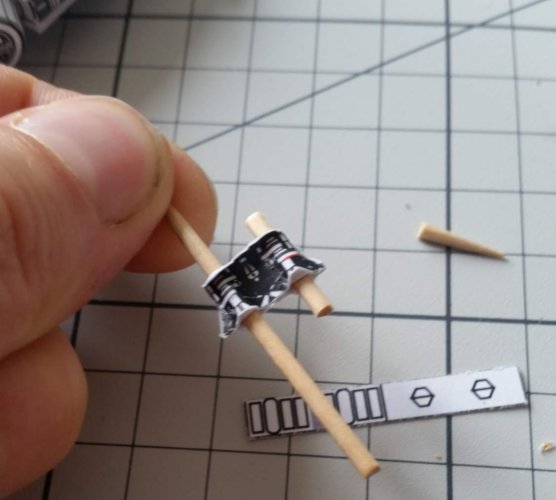

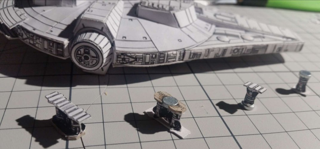

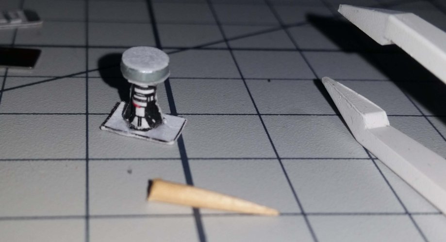

And then the stowed landing legs. Gave the feet a bit profile.

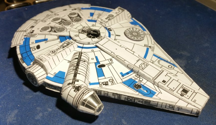

The in-flight model is almost done. Now I will mostly add smaller details and new cannons. In the @starbuck thread was the idea of adding cut out pieces of the hull plates. I want to try it, but fear to ruin all the work
