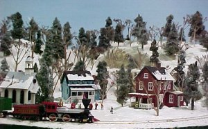

I used Dave Frary's "recipe" for "acrylic snow" from his book, How To Build Realistic Model RR Scenery.
It calls for:
1 part Titanium White artists' acrylic paint
1part acrylic gel medium
1 part acrylic modeling paste
(all of these can be purchased at a art supply, or craft store)
This is for modeling a permanent snow scene, & can be brushed on over the scenic base, on structures, trees, etc...
It has a "glisteny" look like real snow, & stays nice & white!
(this is a little Christmas layout I built for the kids several years ago)
