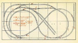

Welcome Devon. I had to give up on a home layout for my passenger fleet as it consumed way too much real estate. That is my number one reason for joining a modular club---I can run all my big stuff on 36" radius curves were it just looks better. As for a home layout, I have my sights set on this one from the book, "HO Railroad that Grows" by Linn Westcott. I'll just do it complete from the start and use the latest in foam construction techniques. If you're ever out on the Panhandle, drop in to the clubhouse...
http://www.geocities.com/miraclestriprrclub/
