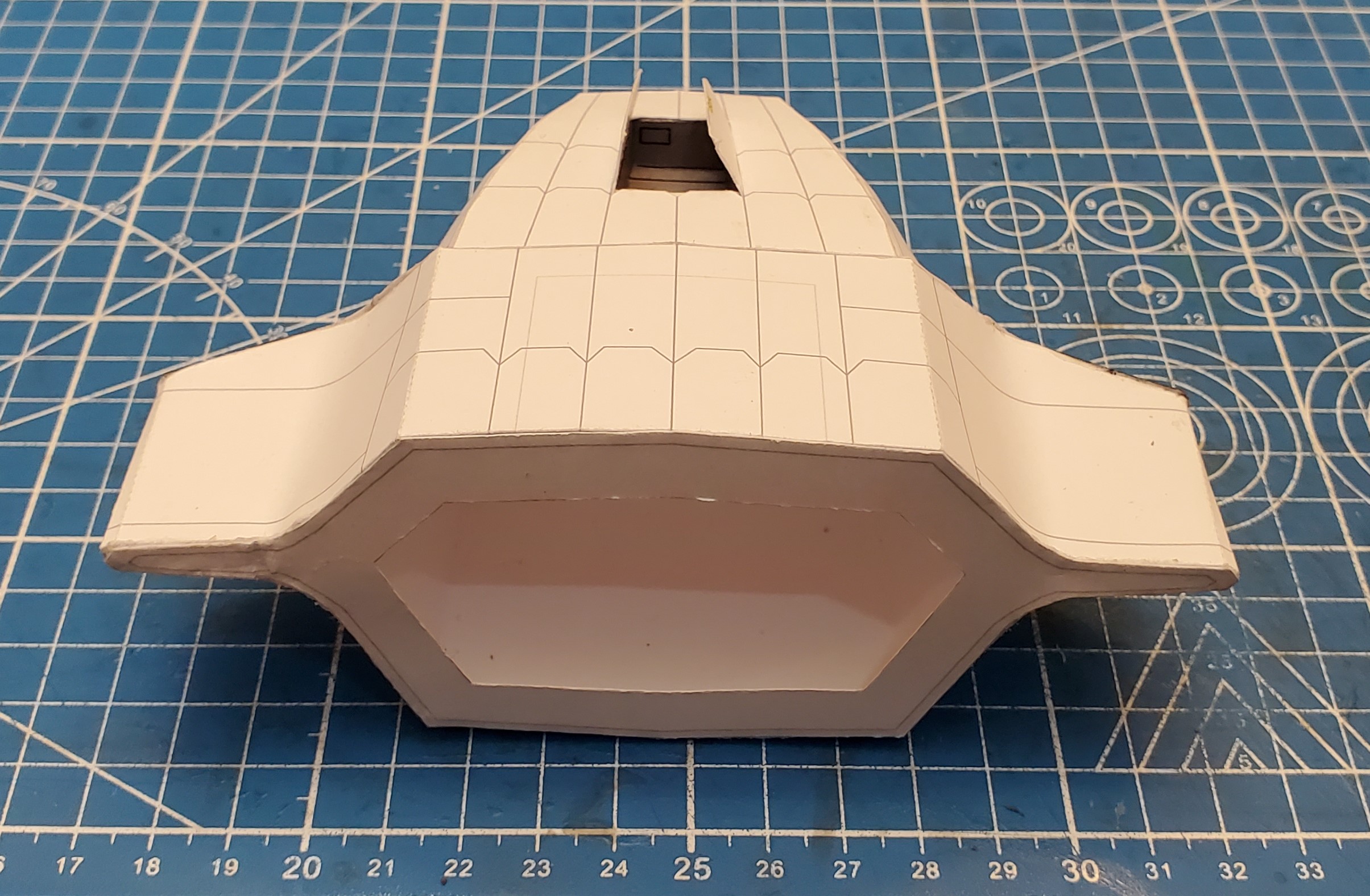

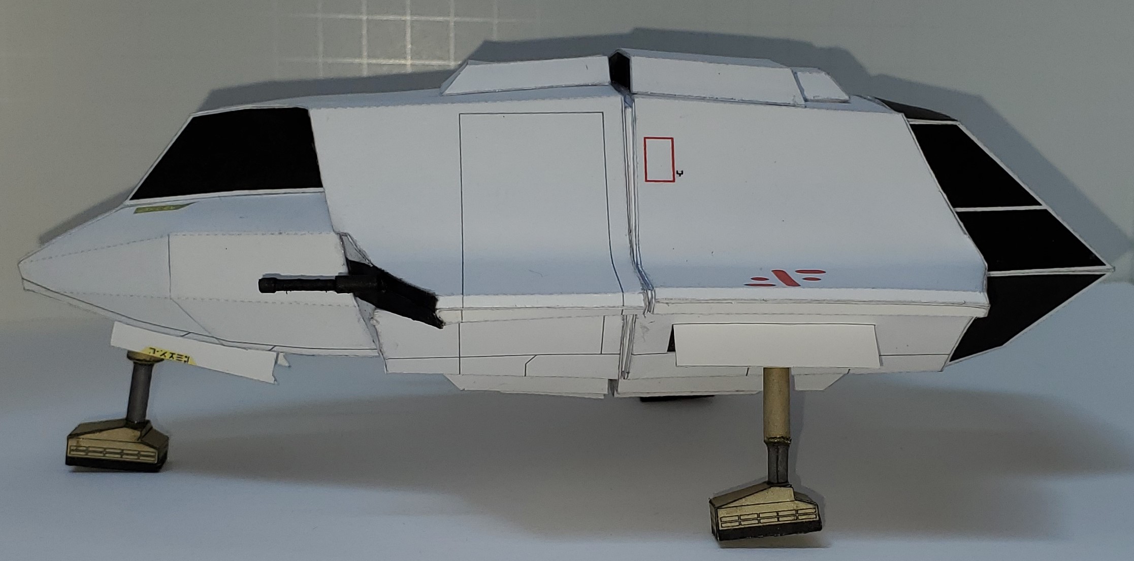

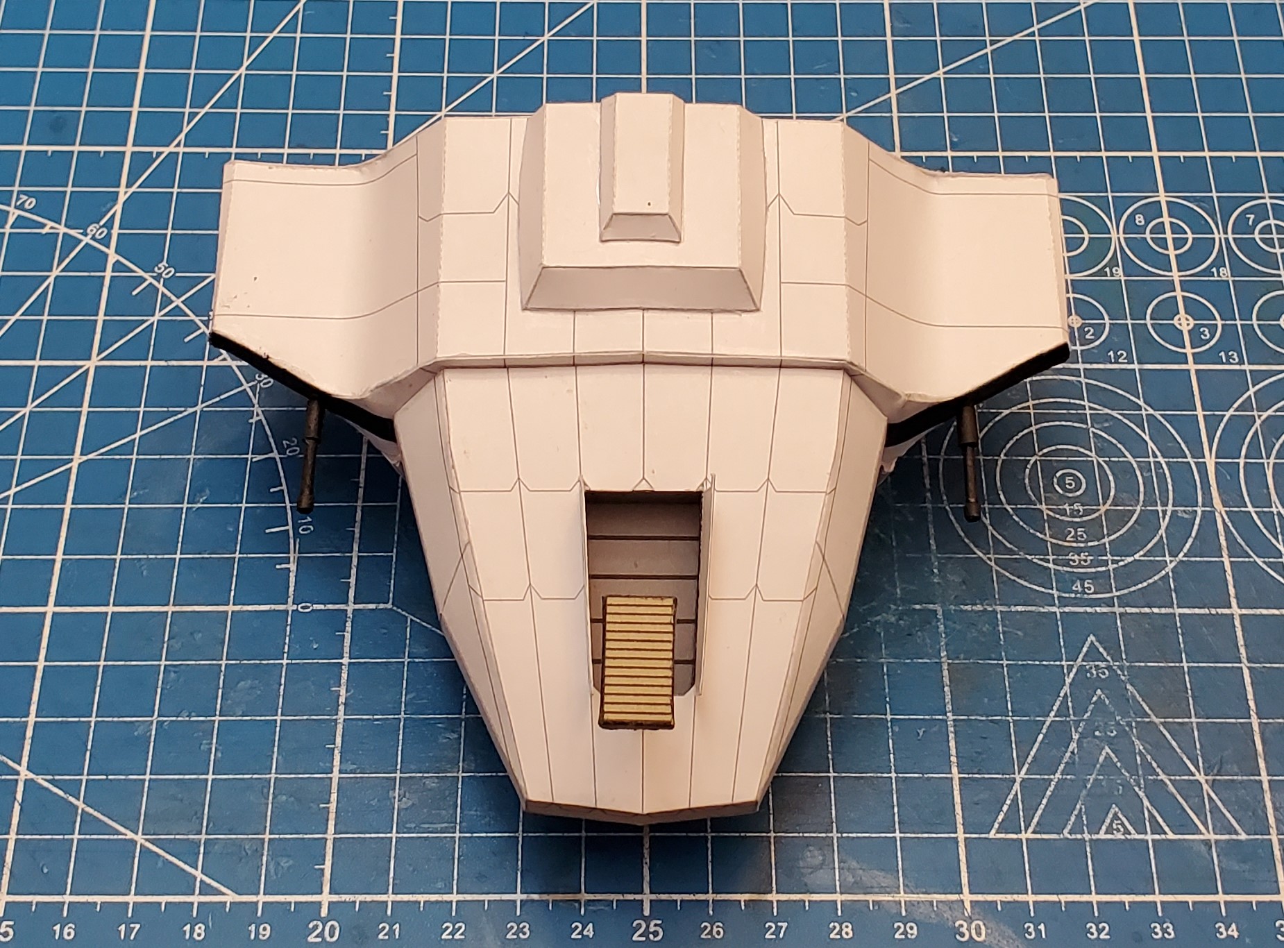

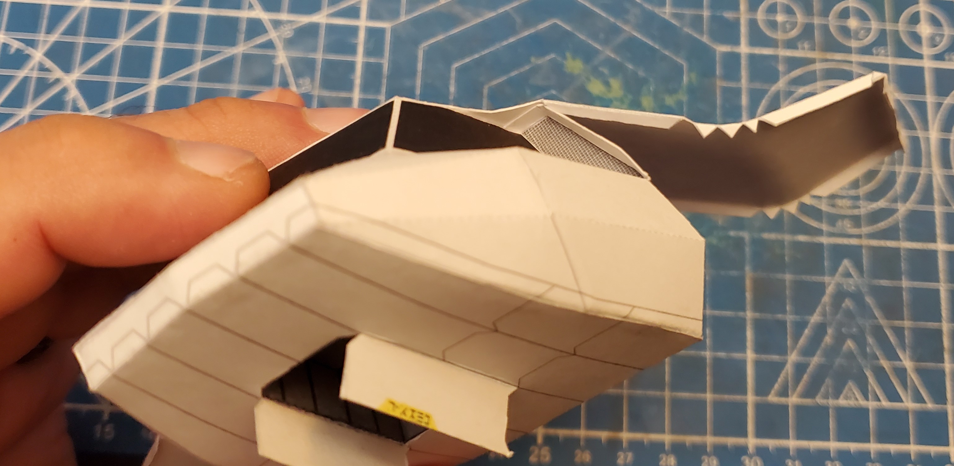

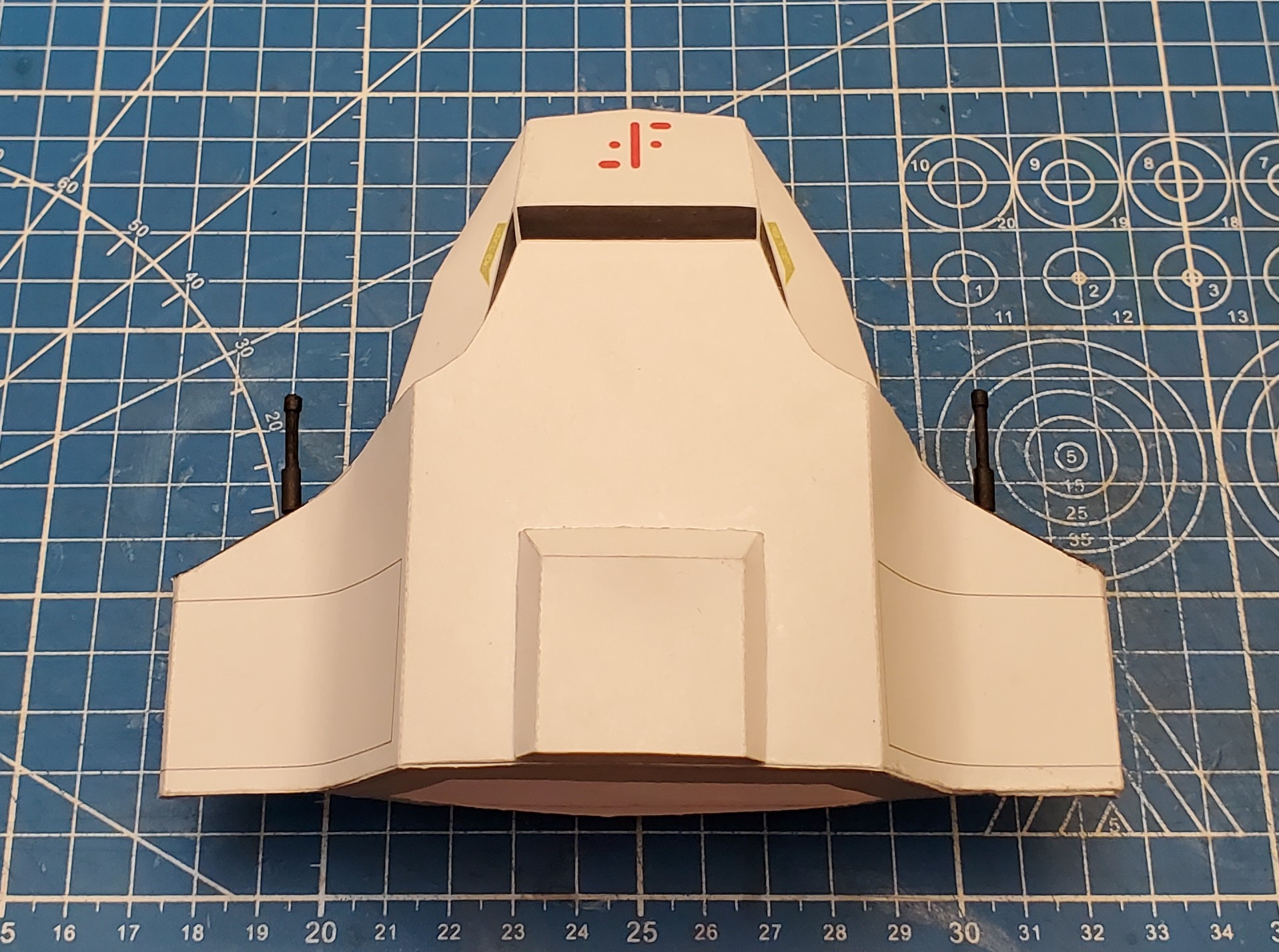

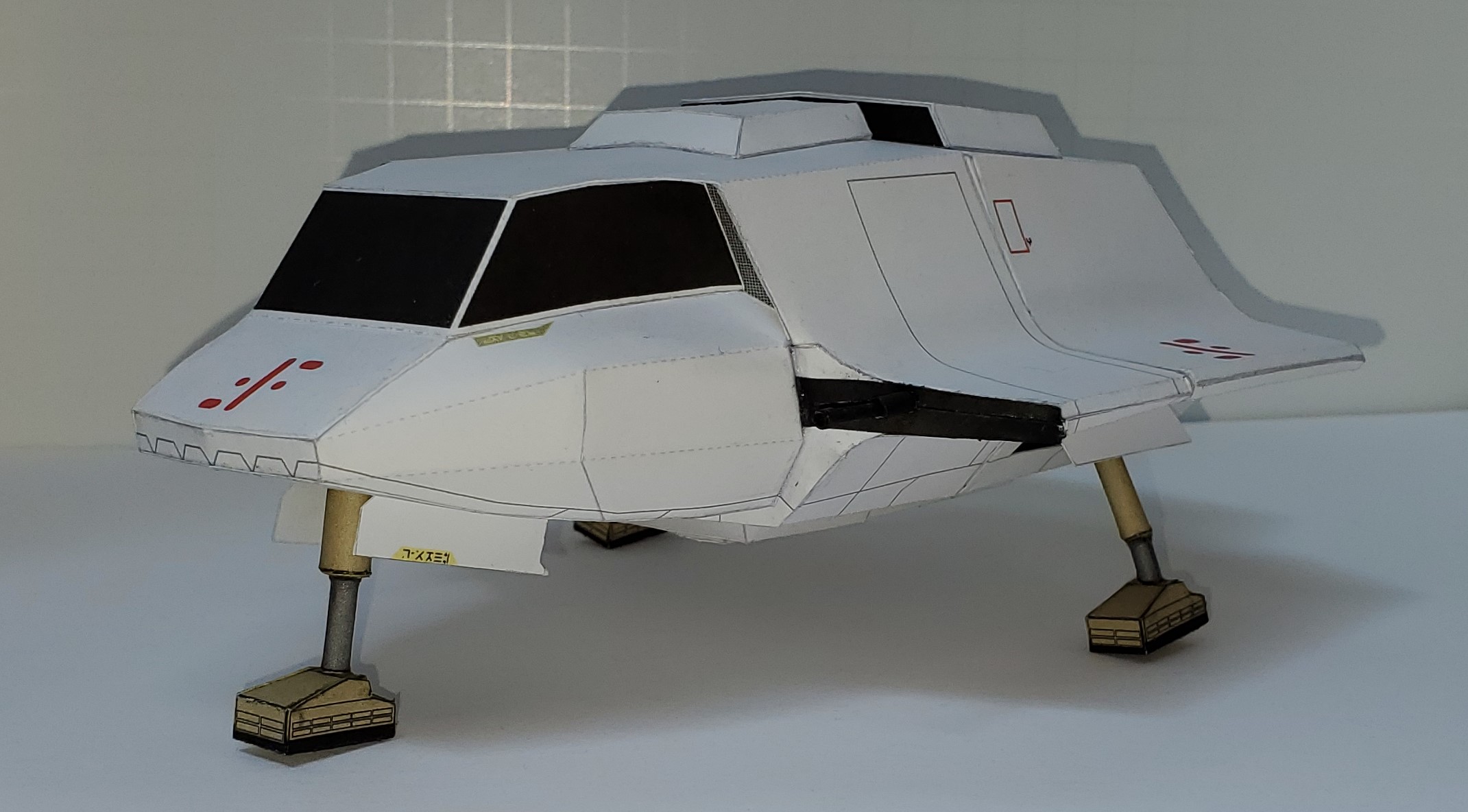

Recently (as many as you know), I uploaded template of the Skyfighter designed by Mike Hungerford and the Landing Gear from the template that was designed by ThunderChild. Since there are no build threads, that I can find (not only that, but this template only has written instruction and no photo instructions), I have decided to post a build thread and show how everything goes together.

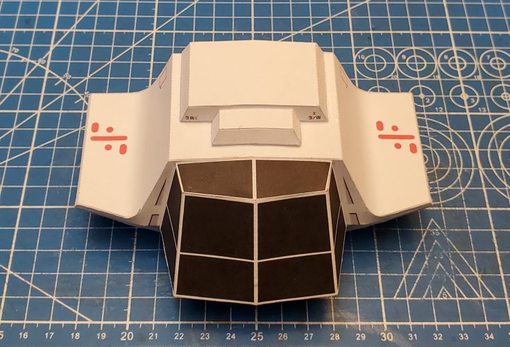

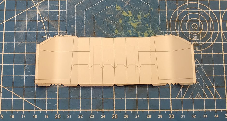

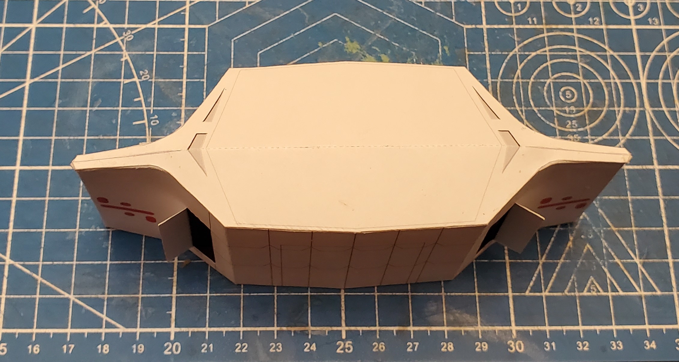

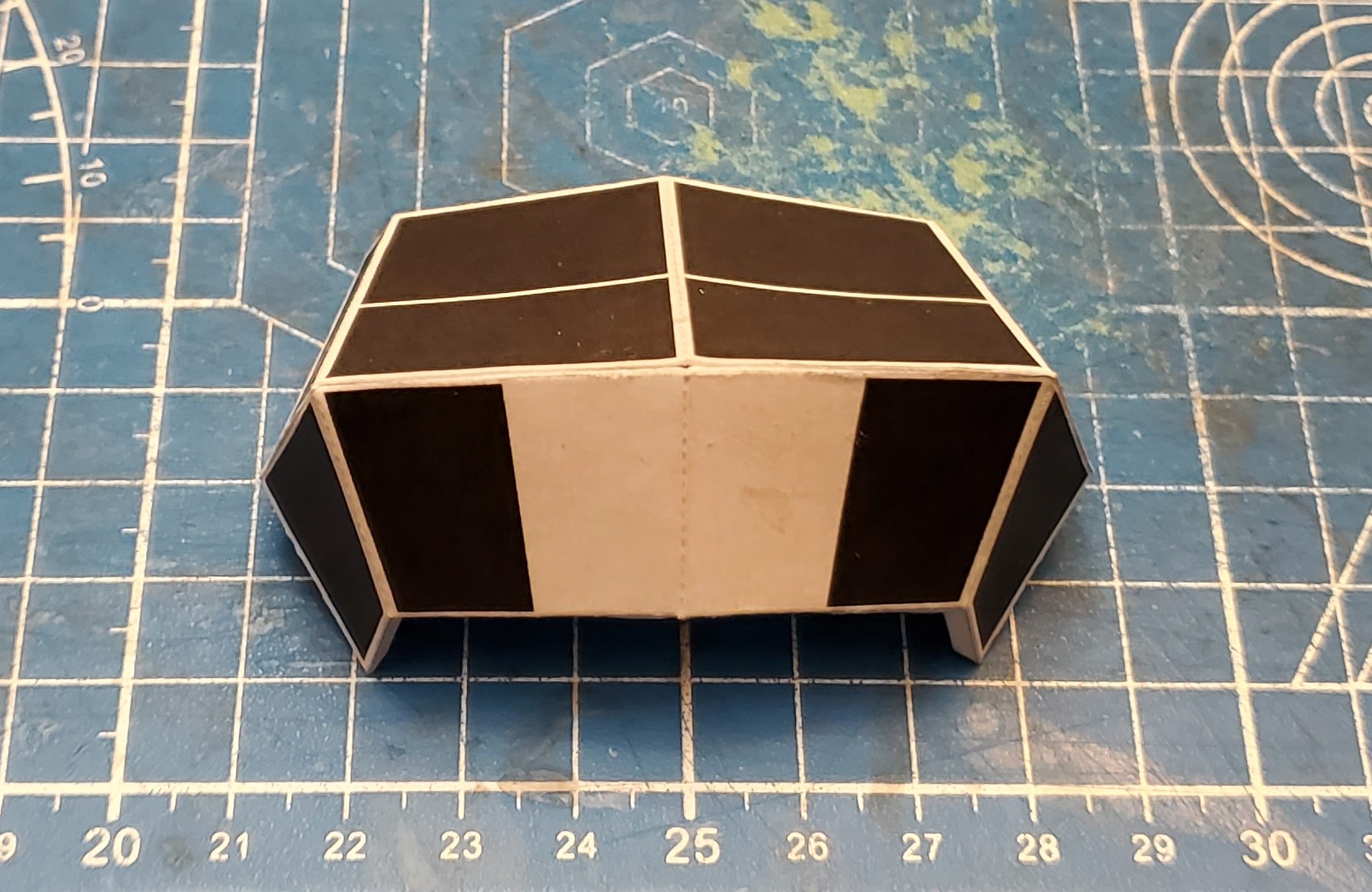

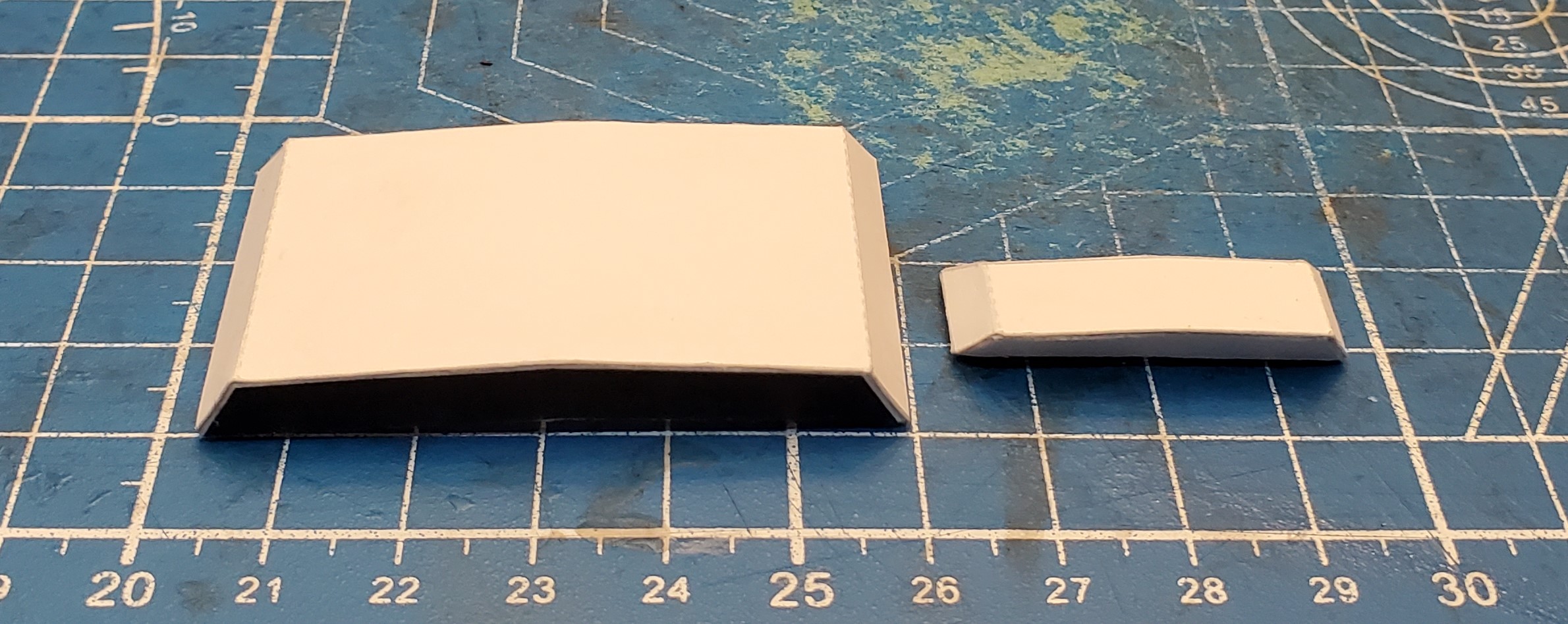

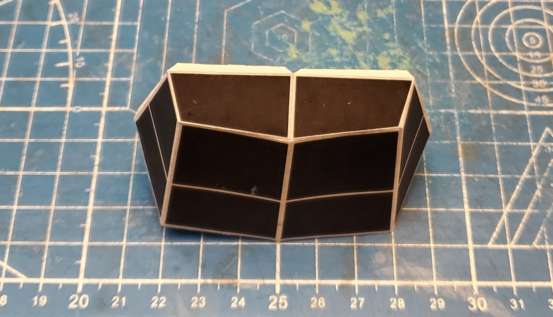

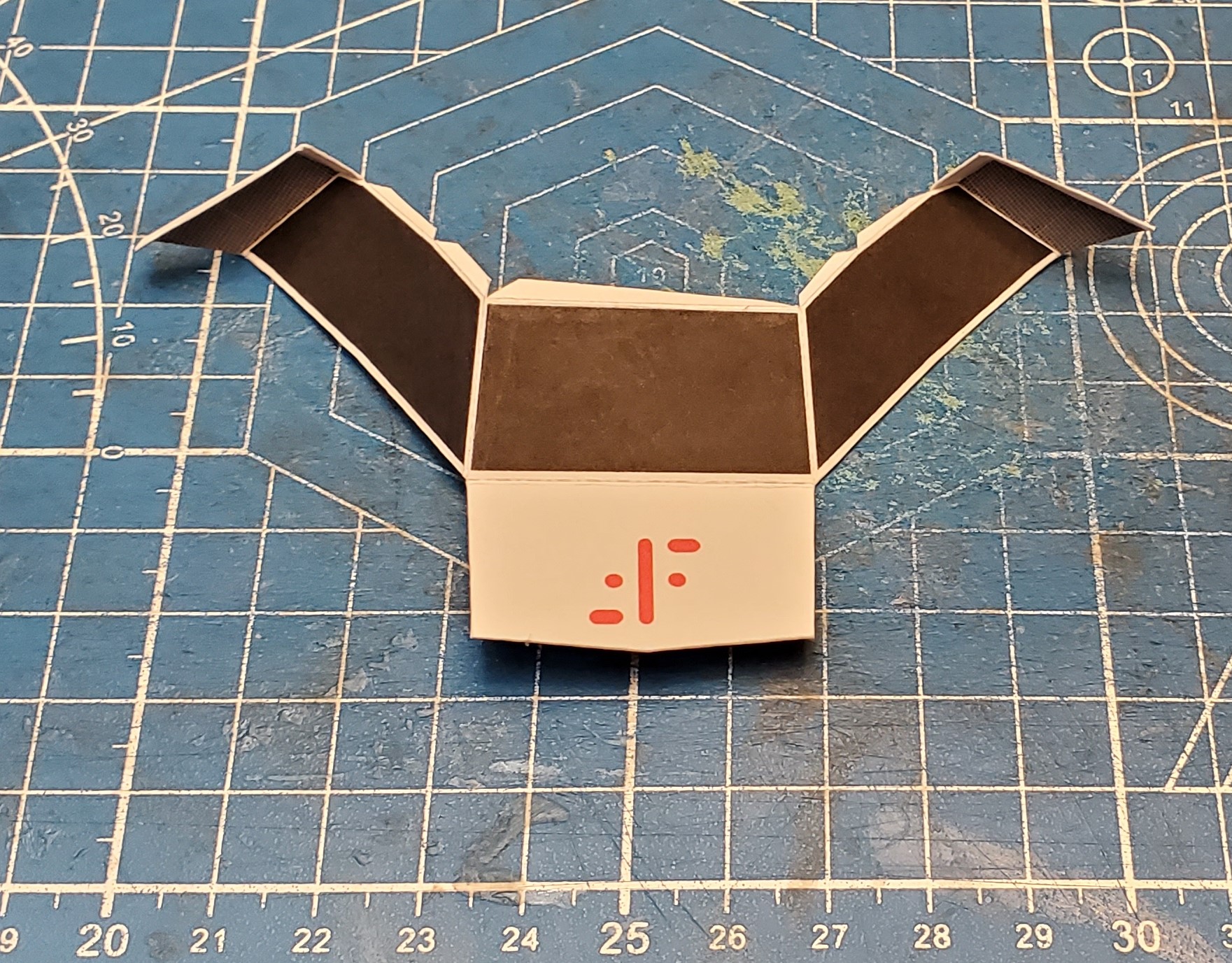

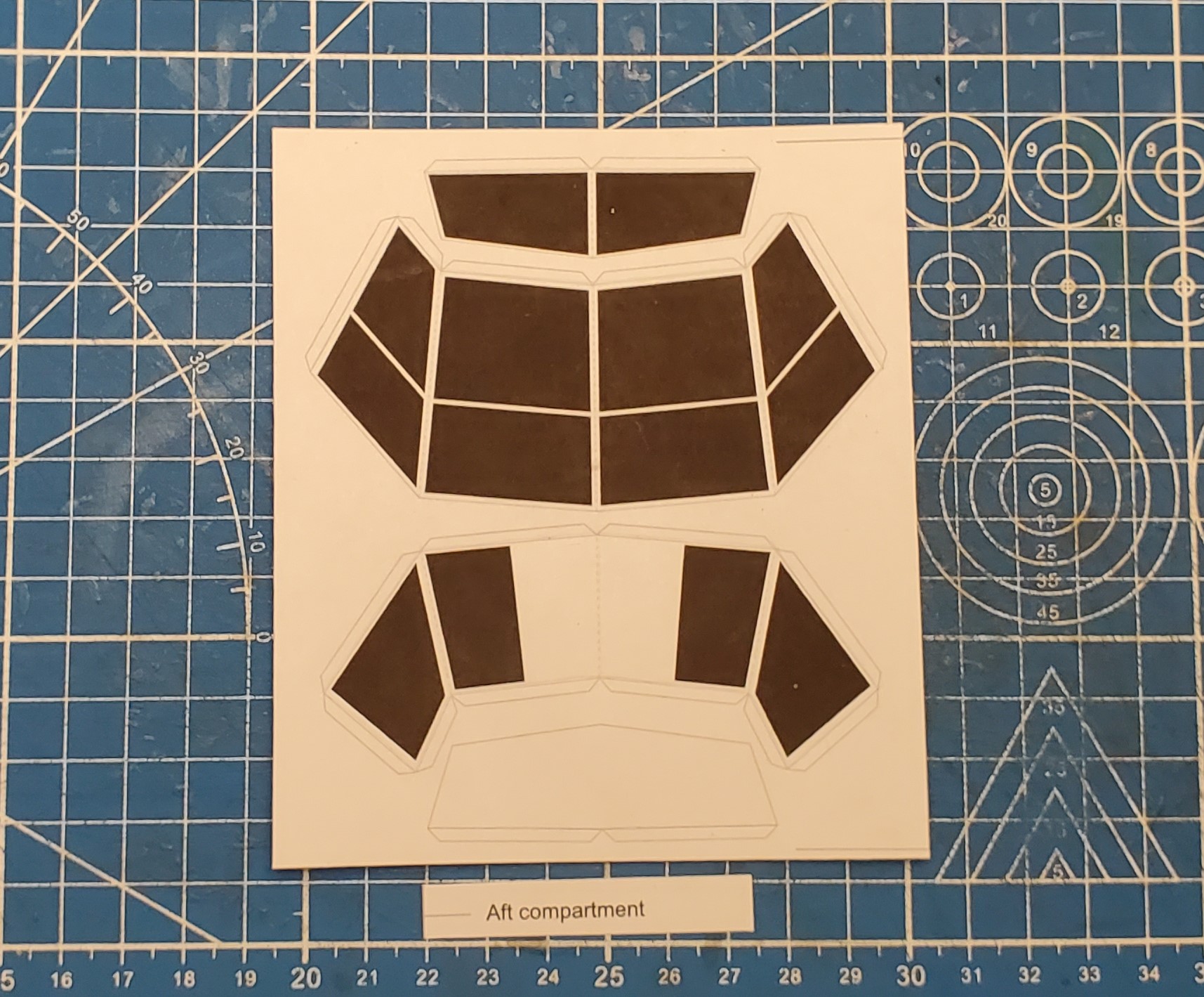

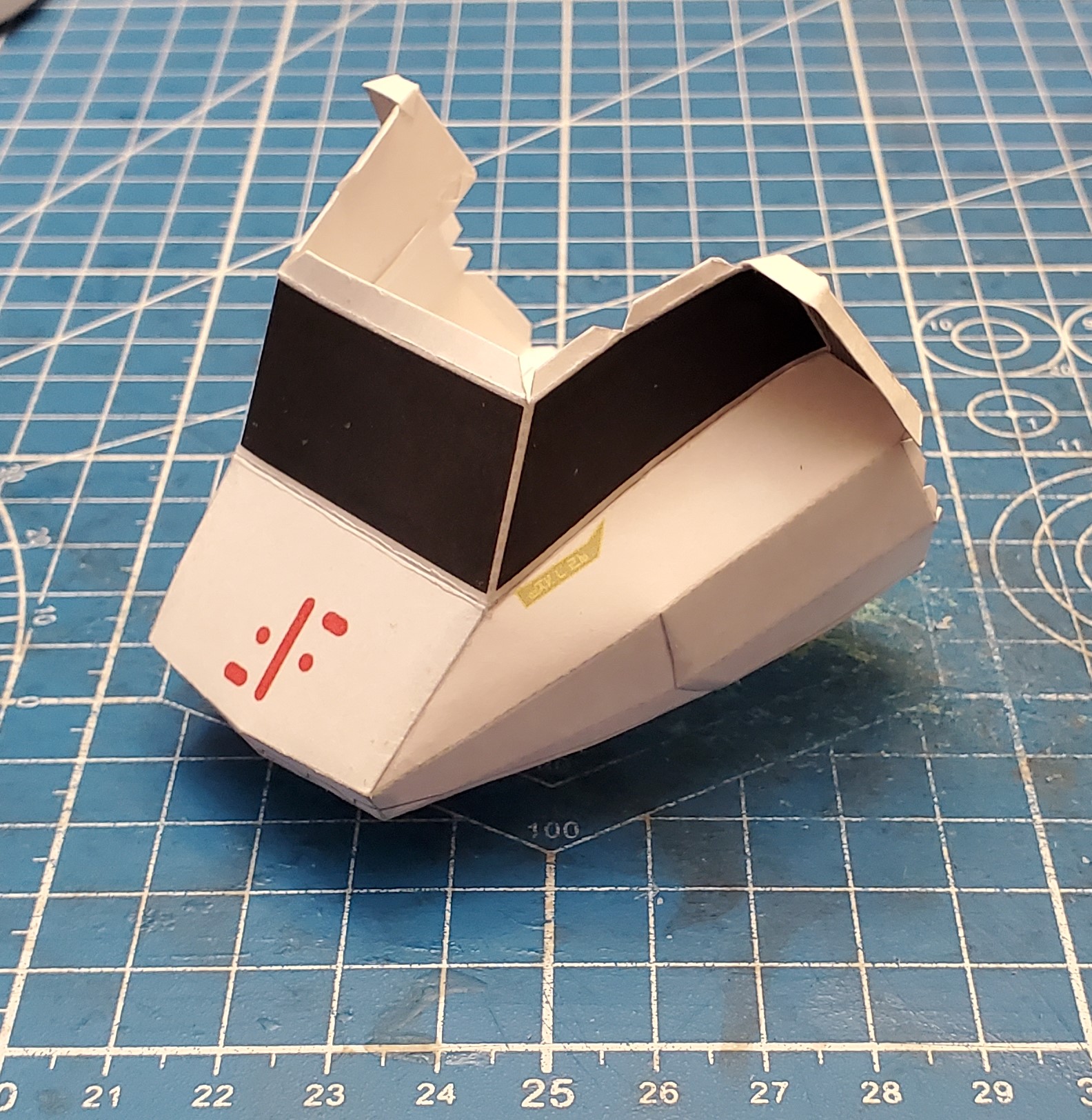

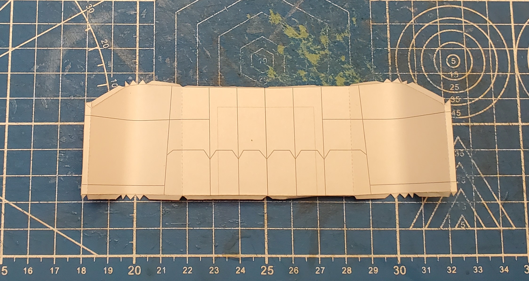

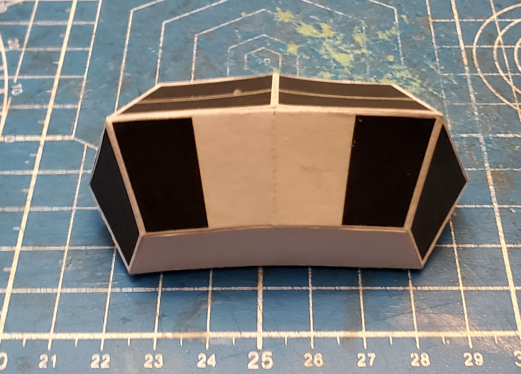

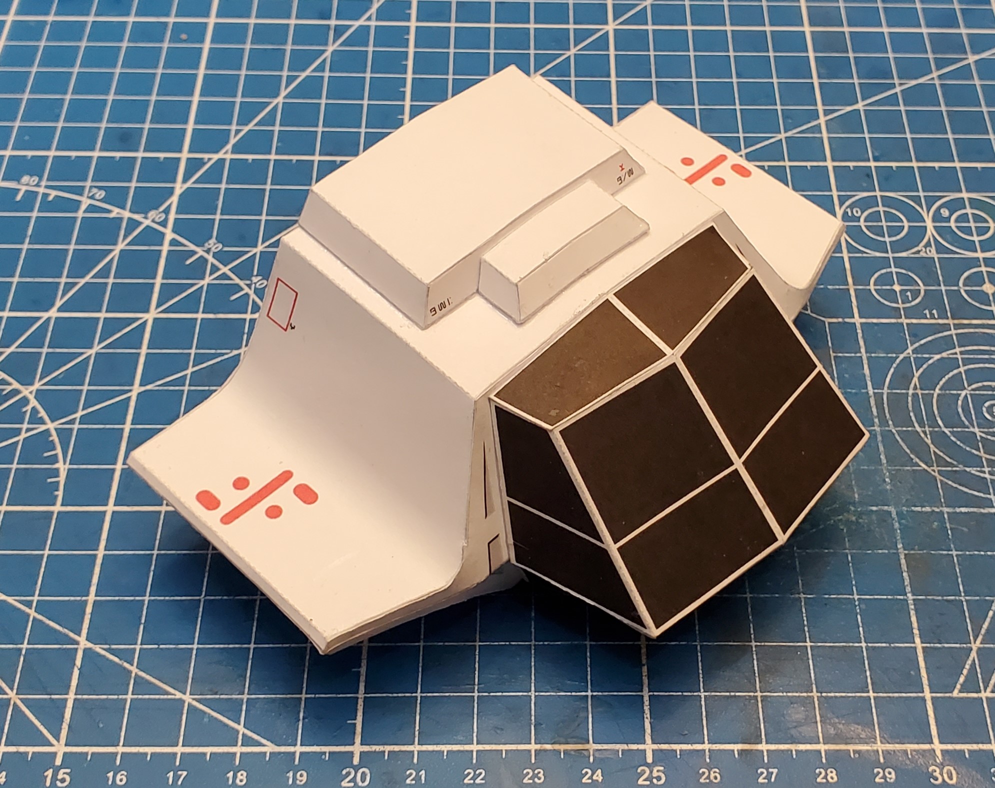

I started with the front window section, intakes, and top of the nose and formed it out.

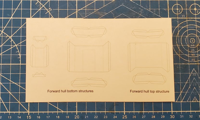

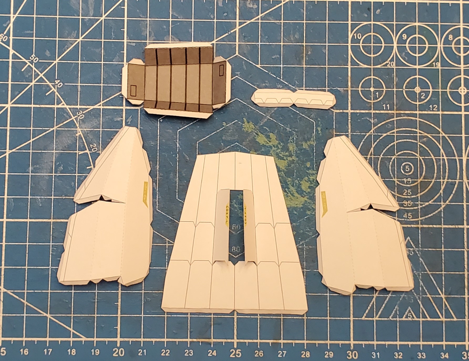

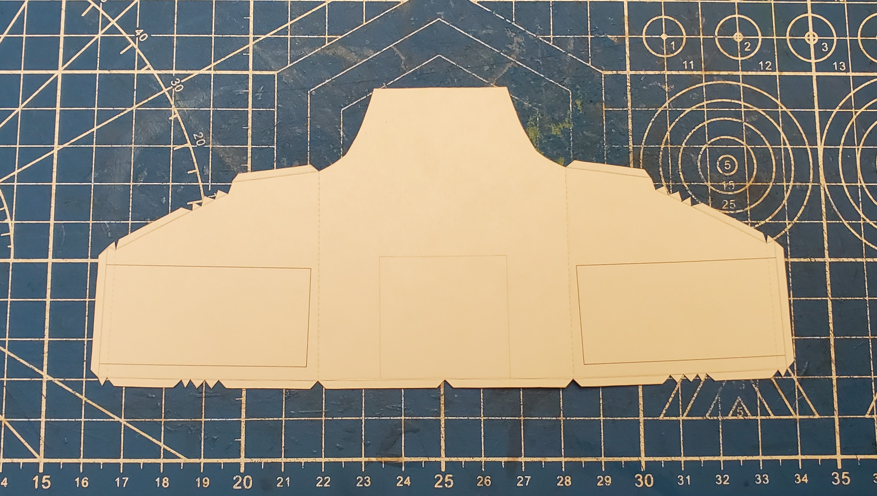

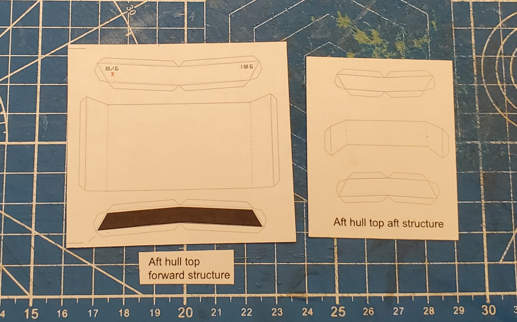

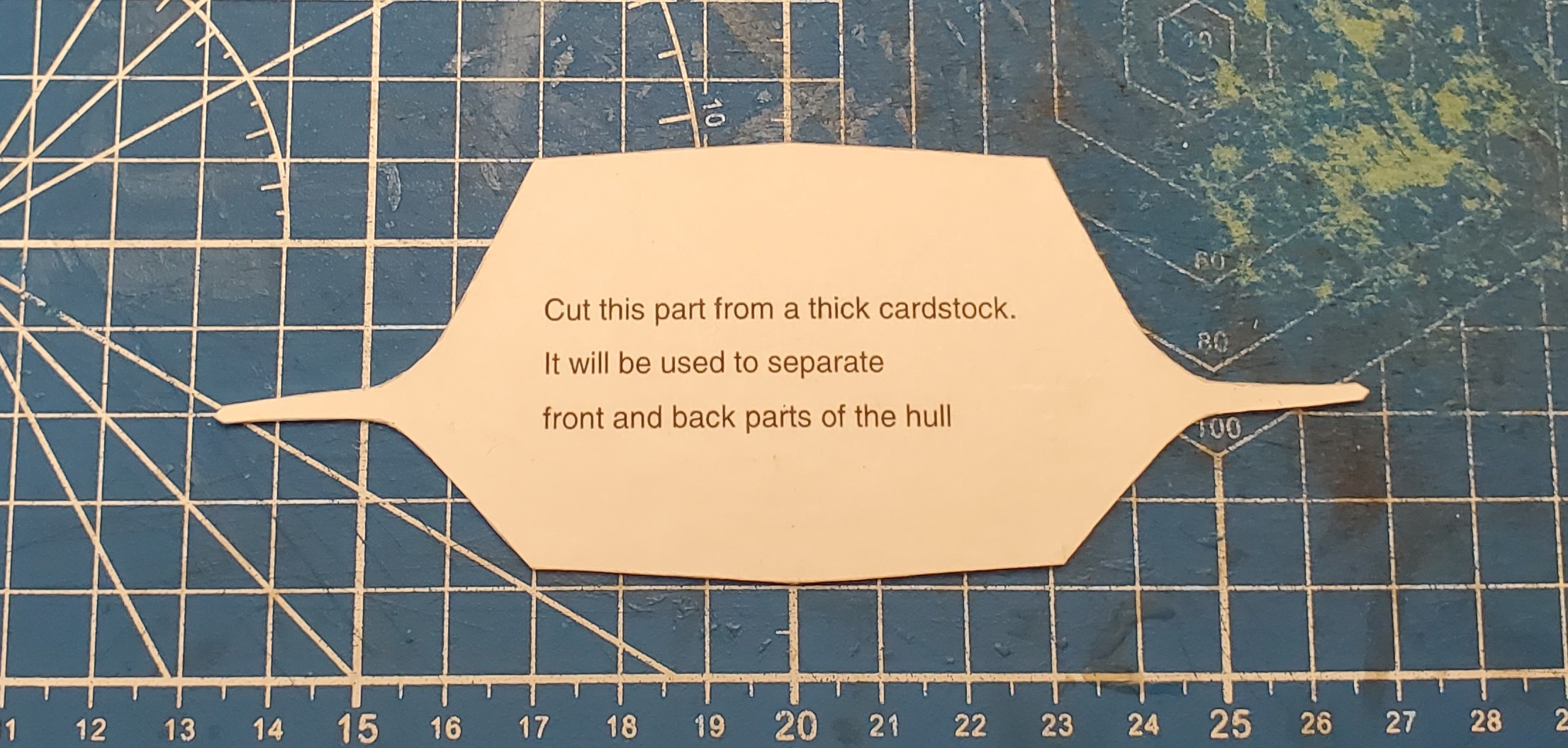

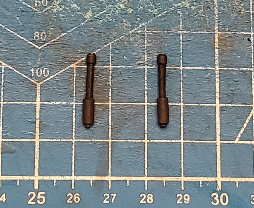

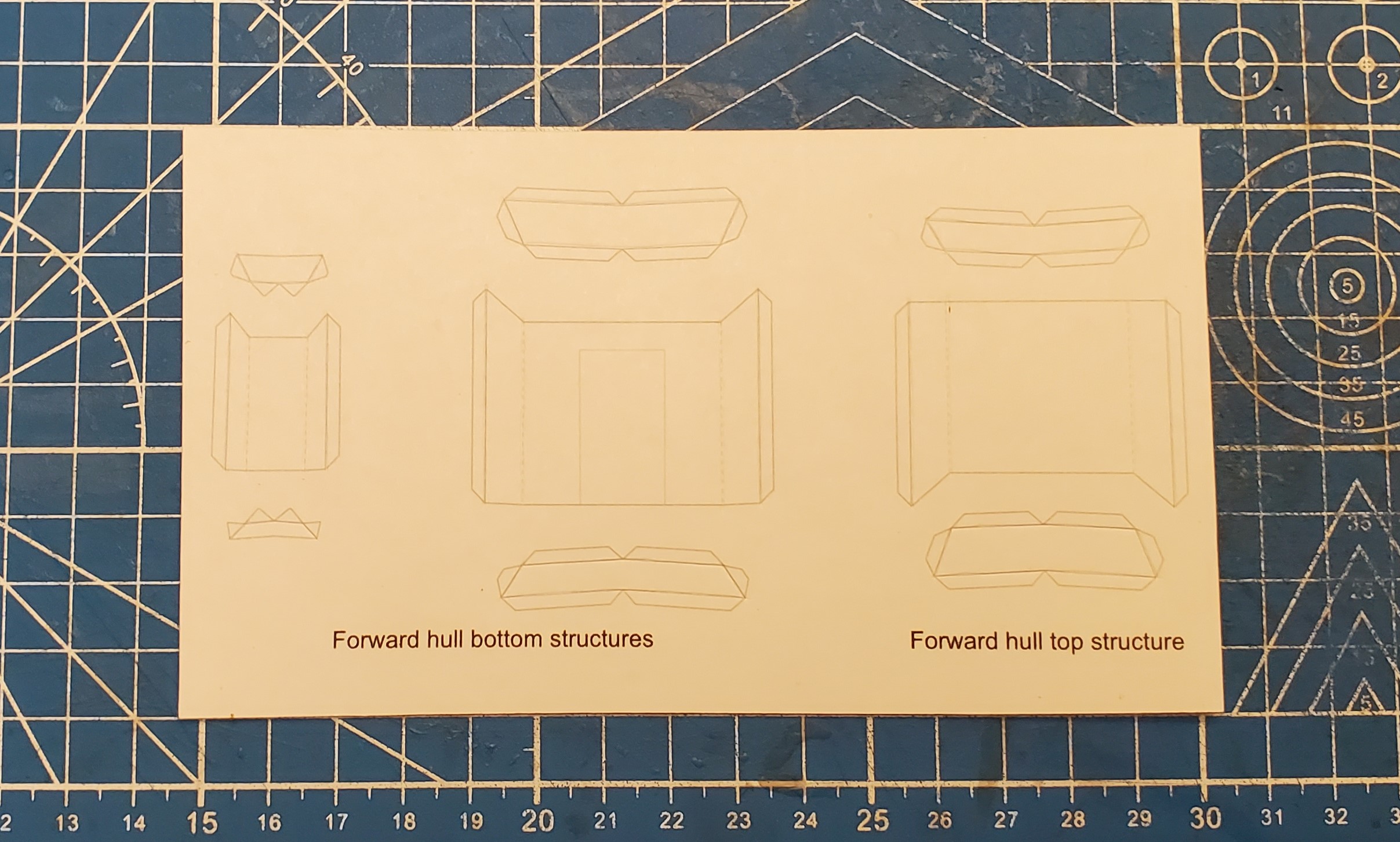

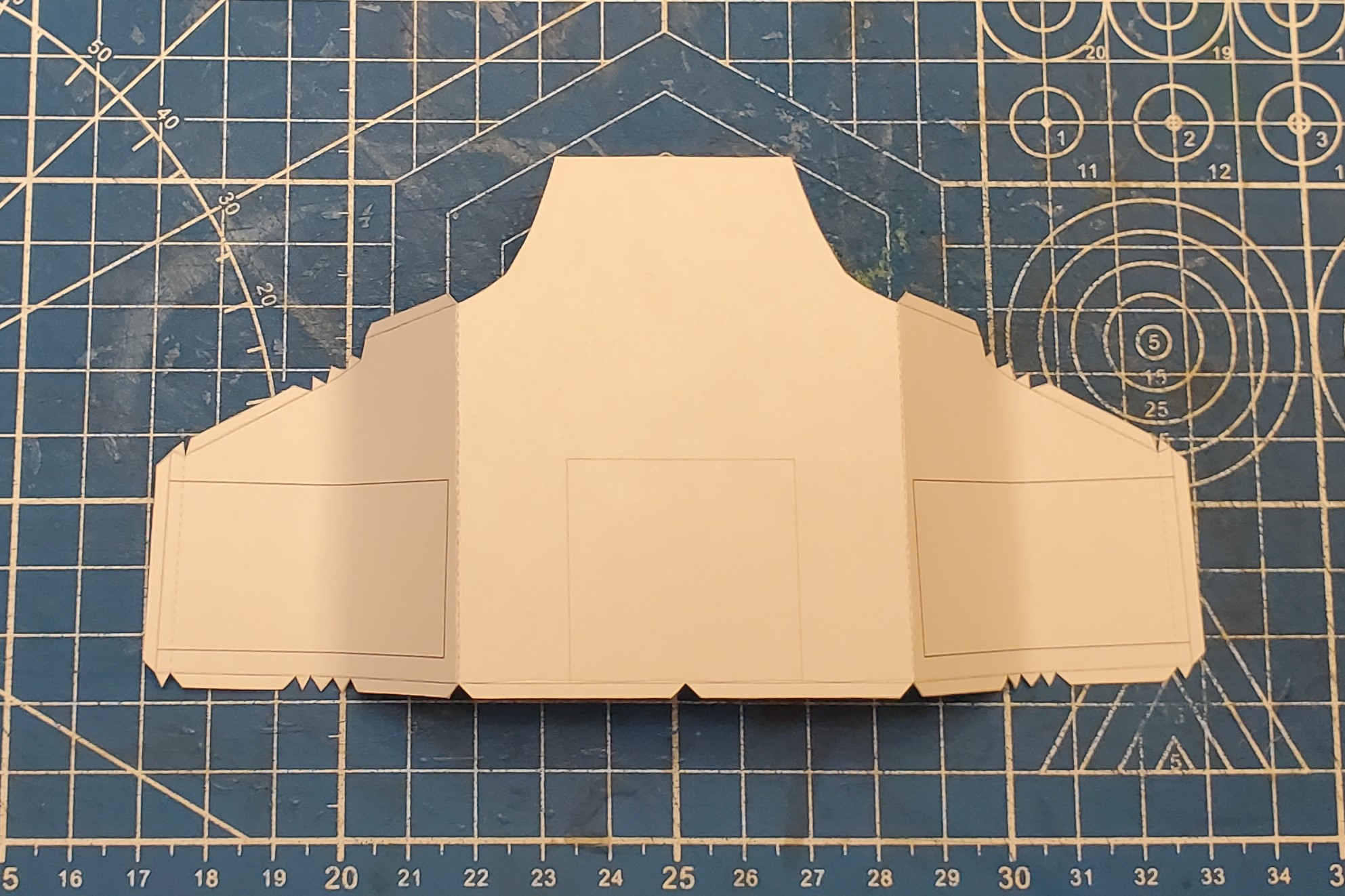

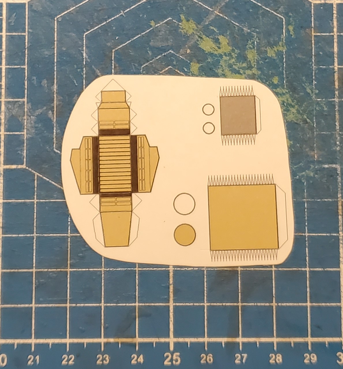

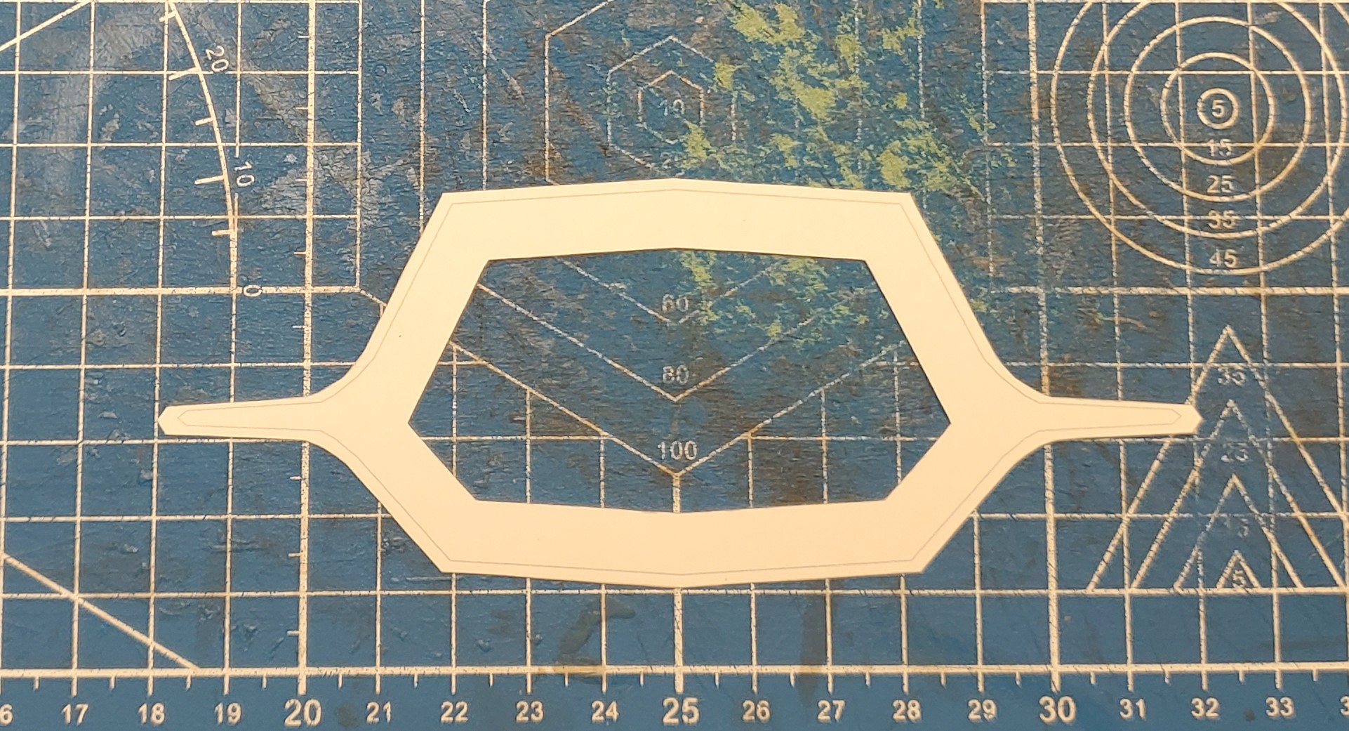

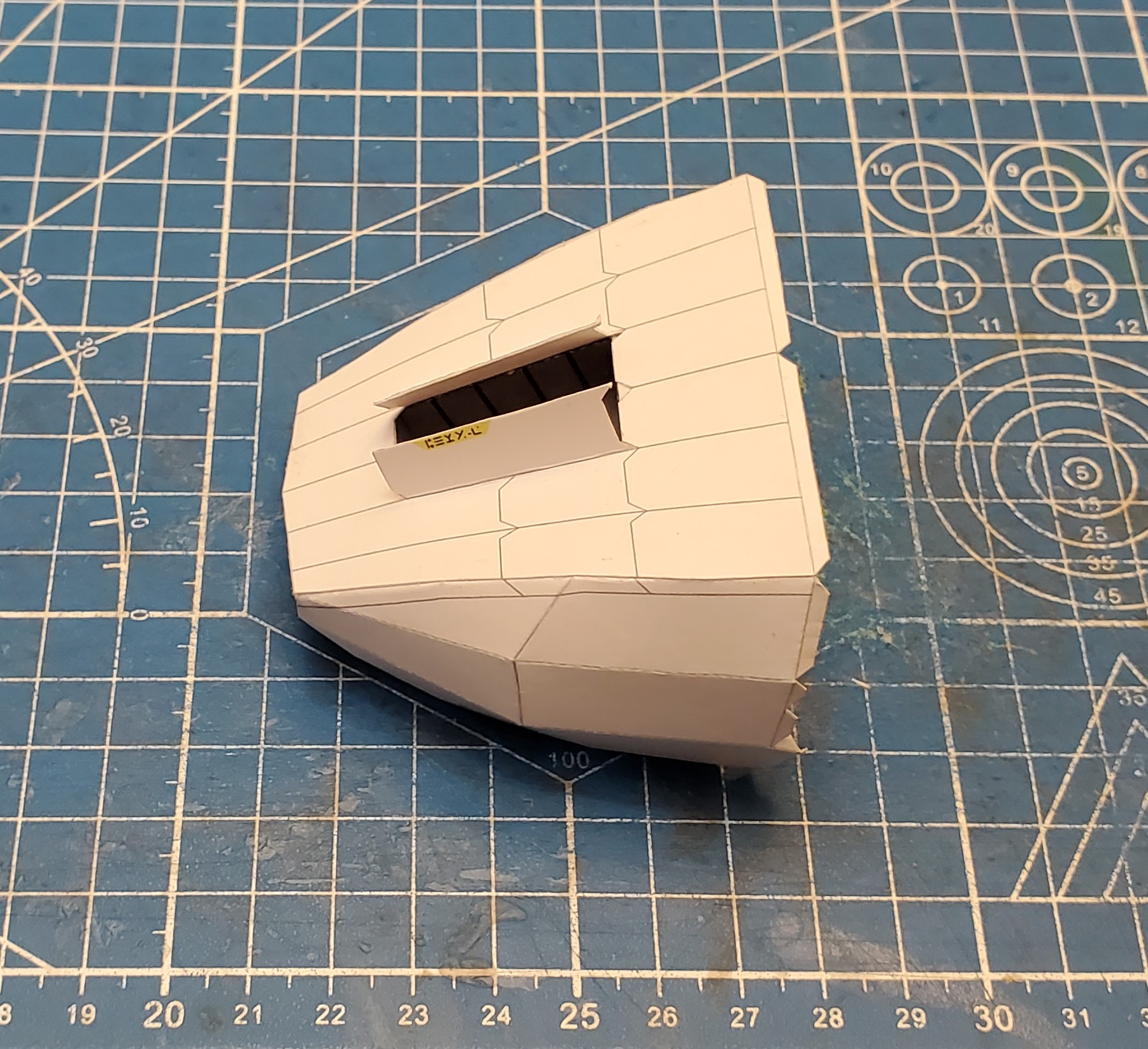

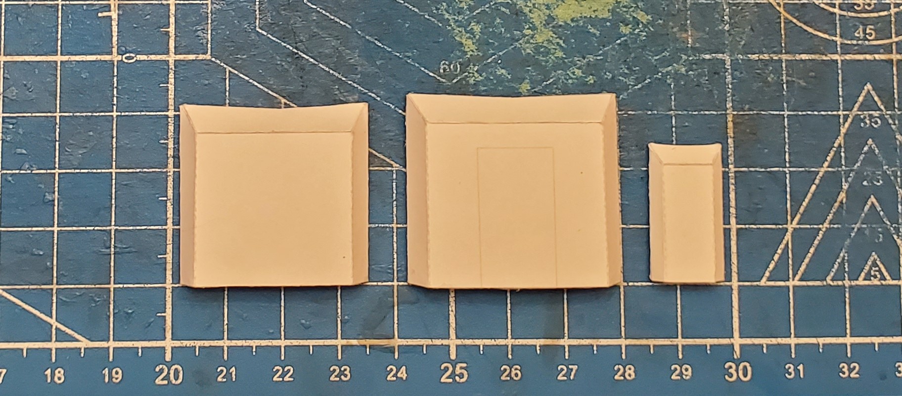

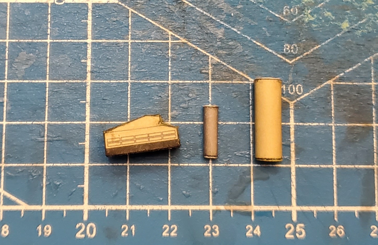

Here are the parts for the front underside and front landing gear.

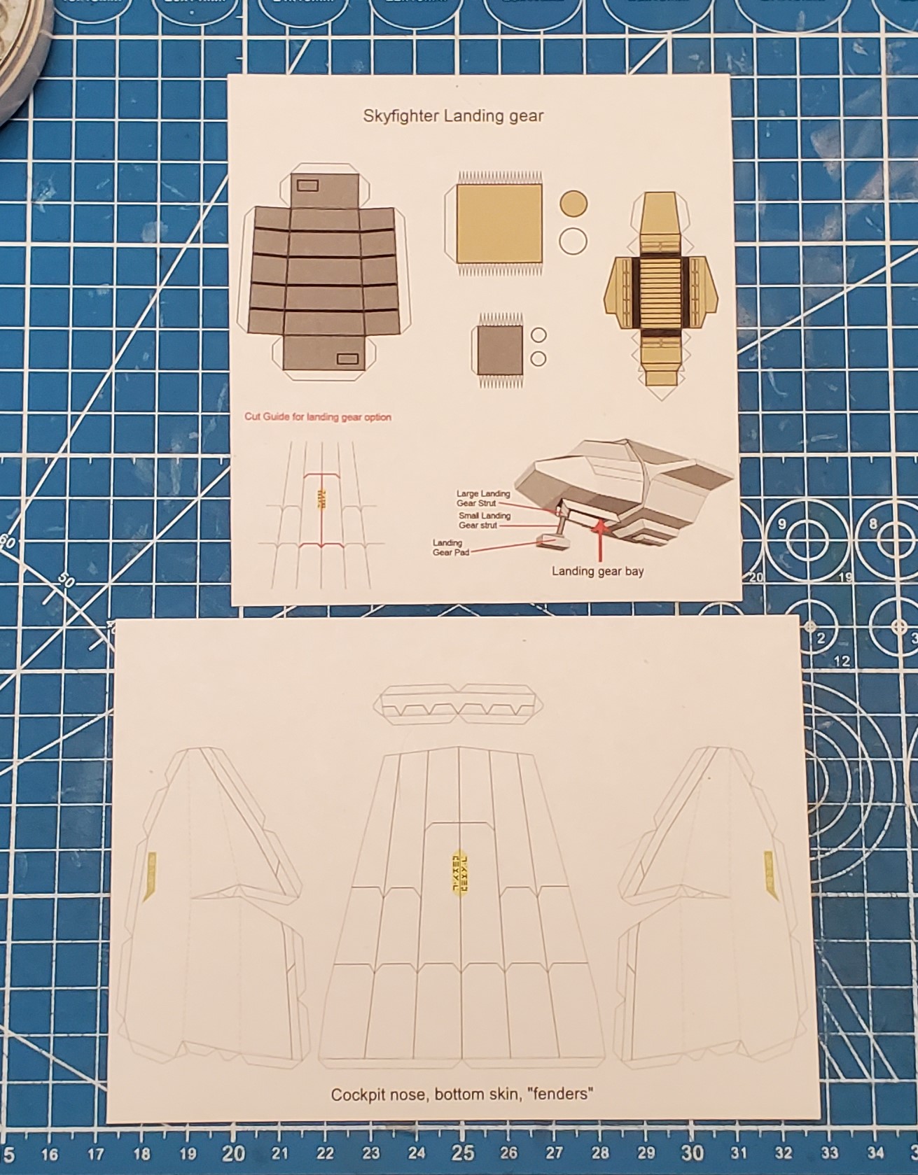

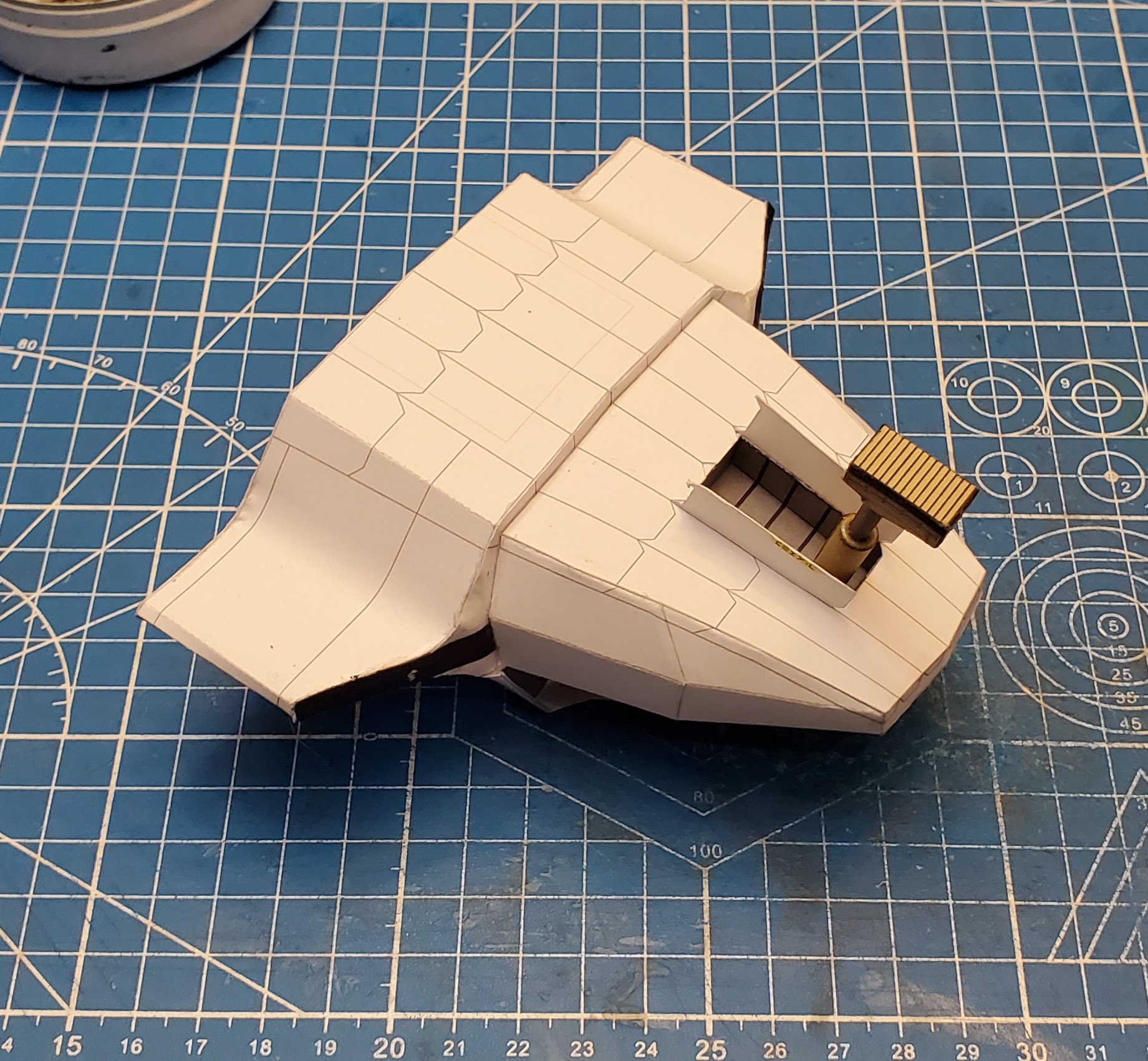

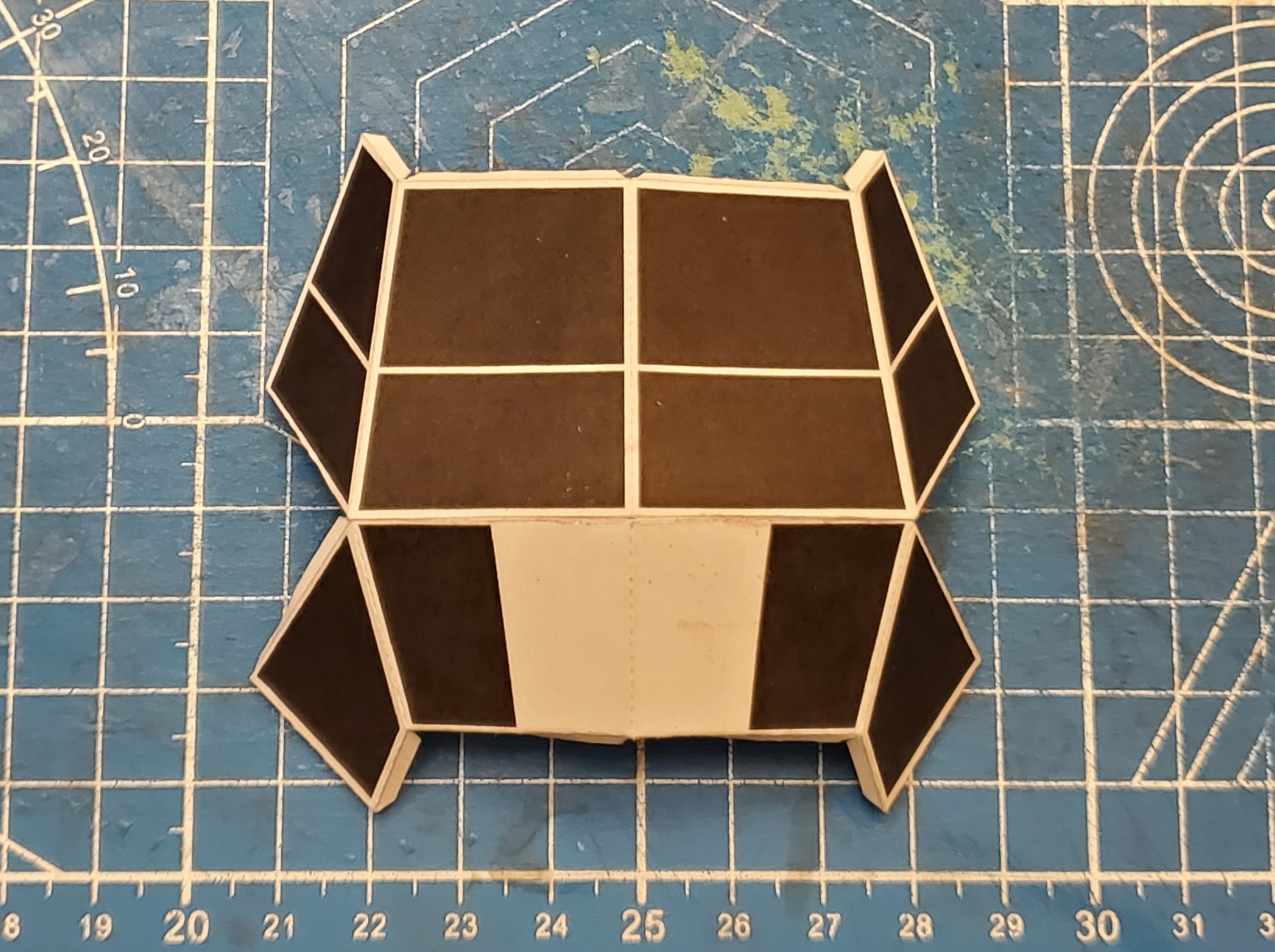

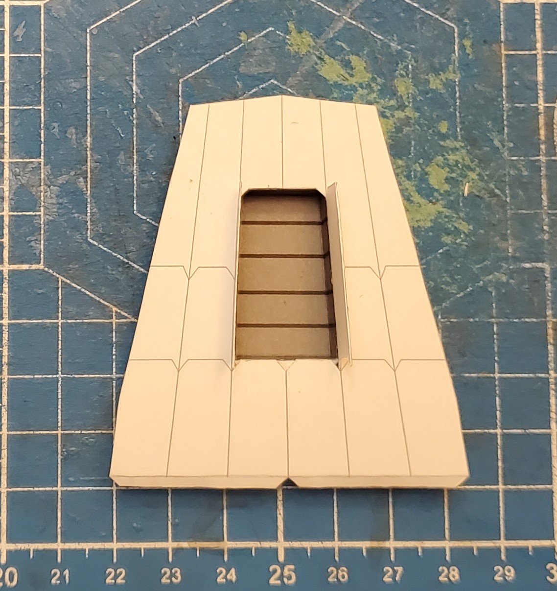

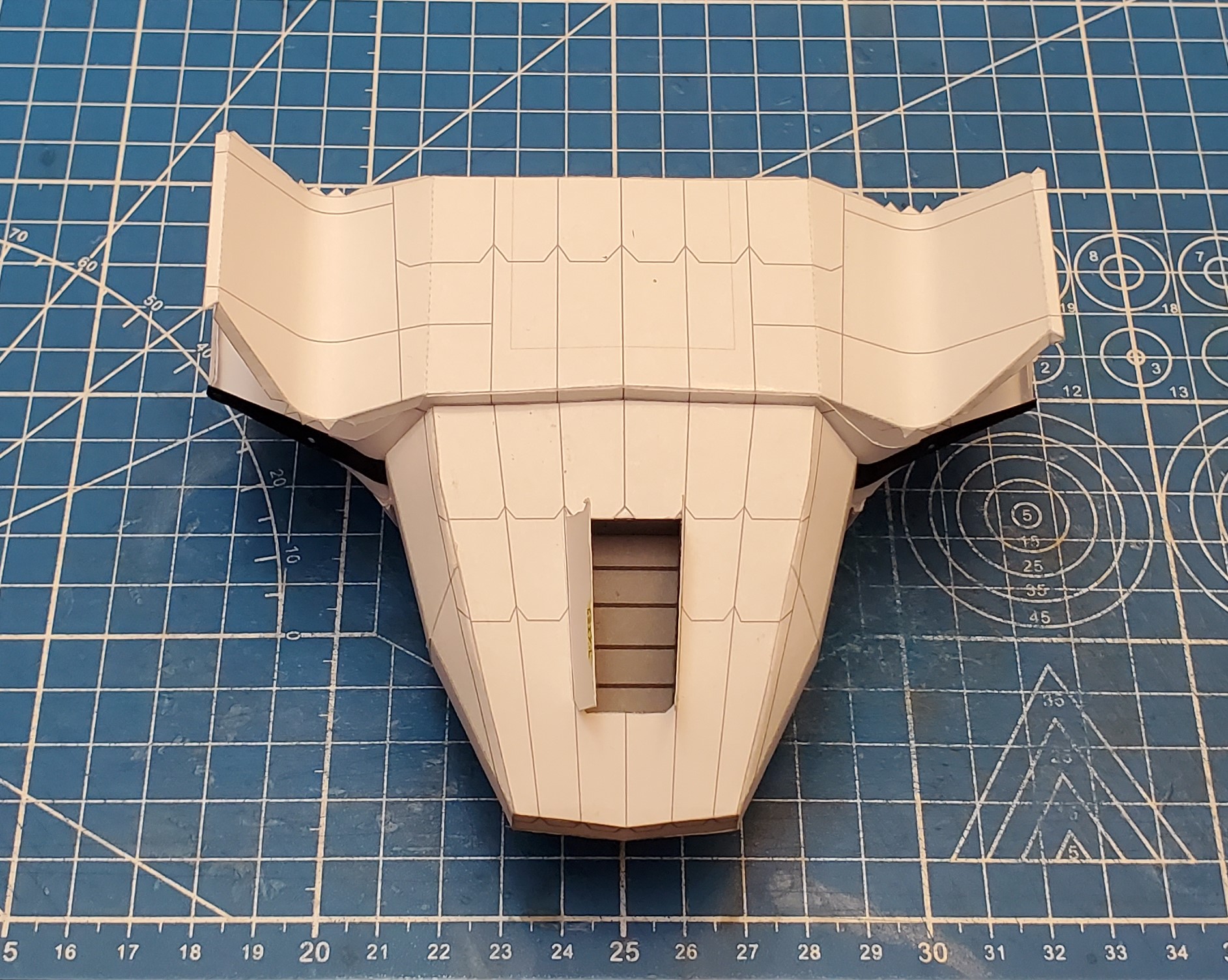

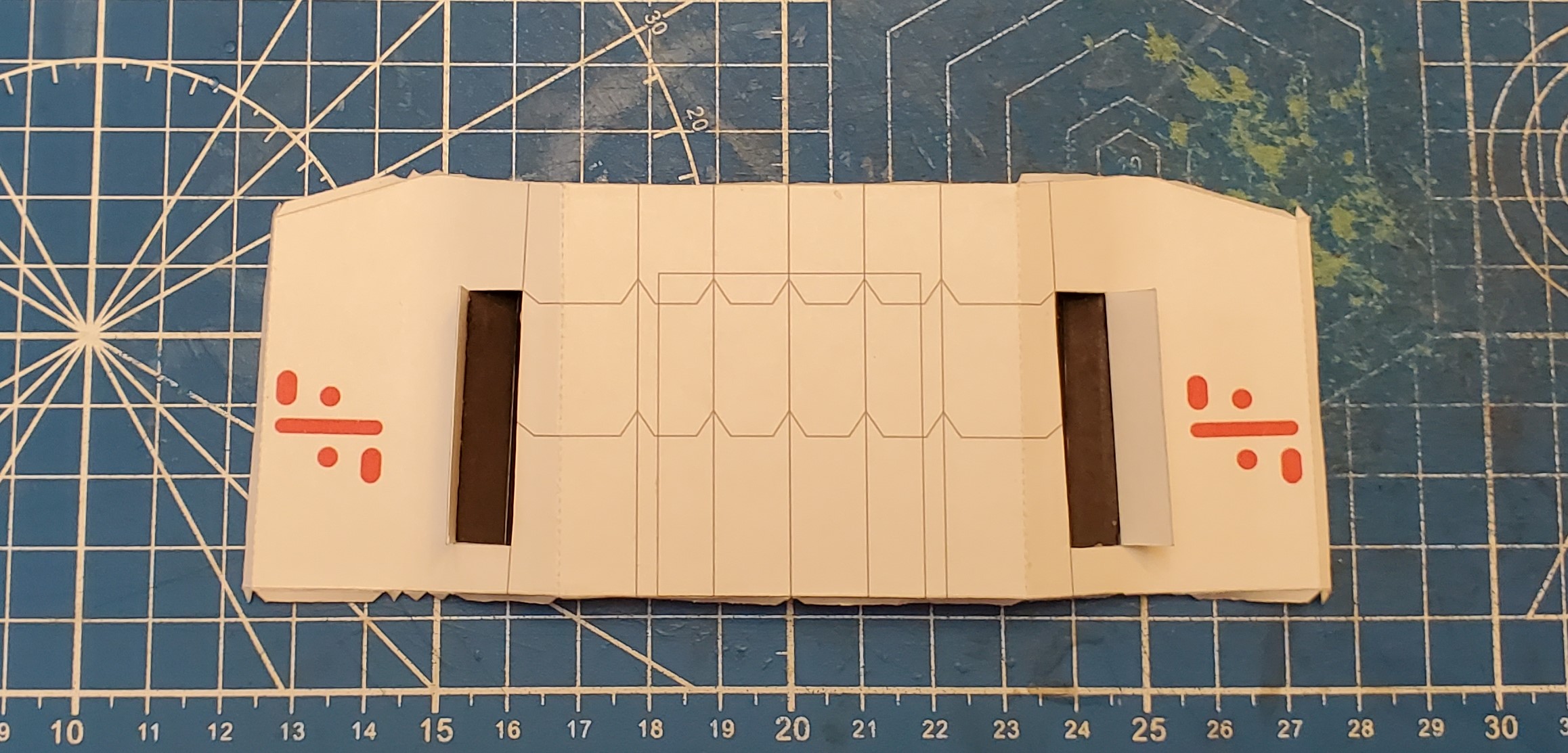

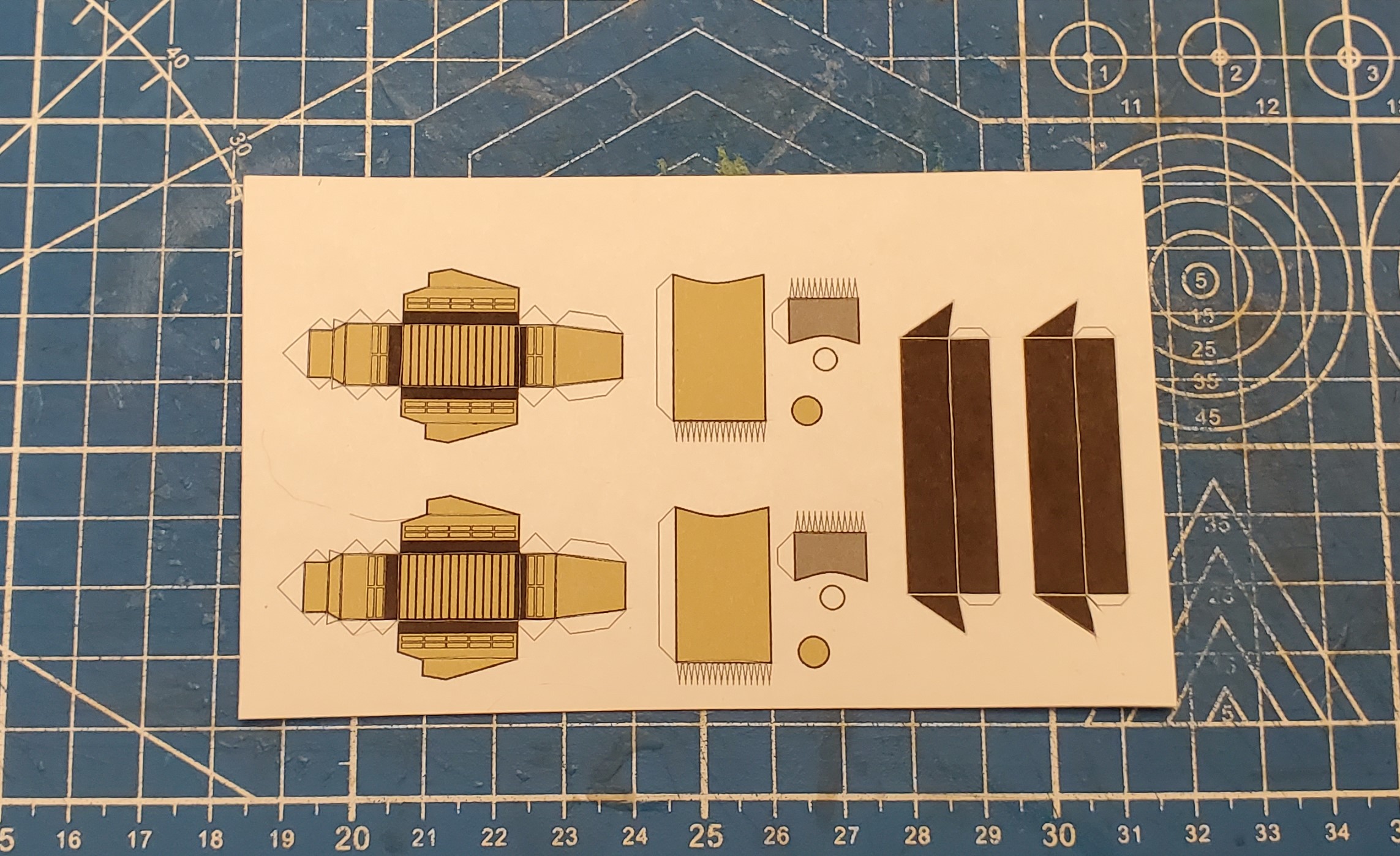

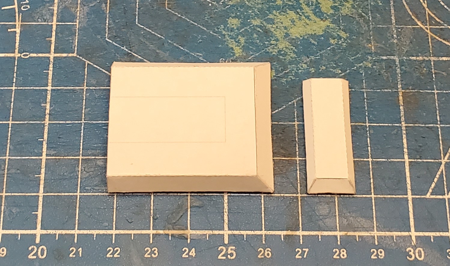

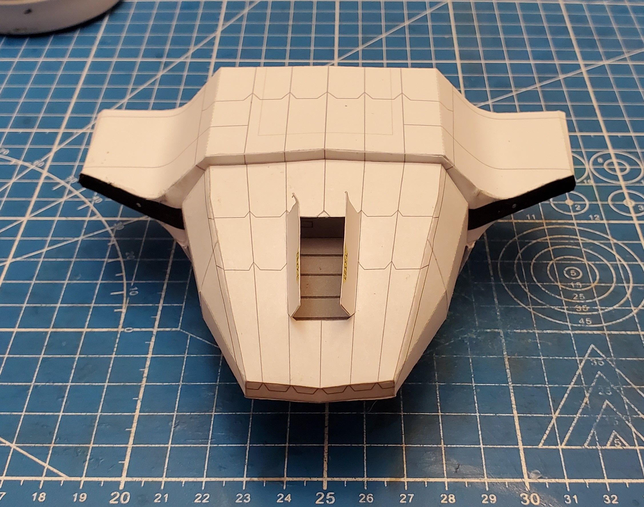

Starting with the underside and front landing gear bay. When cutting the parts out, be certain to follow the cutting guide to open the front section of the hull for the landing gear bay.

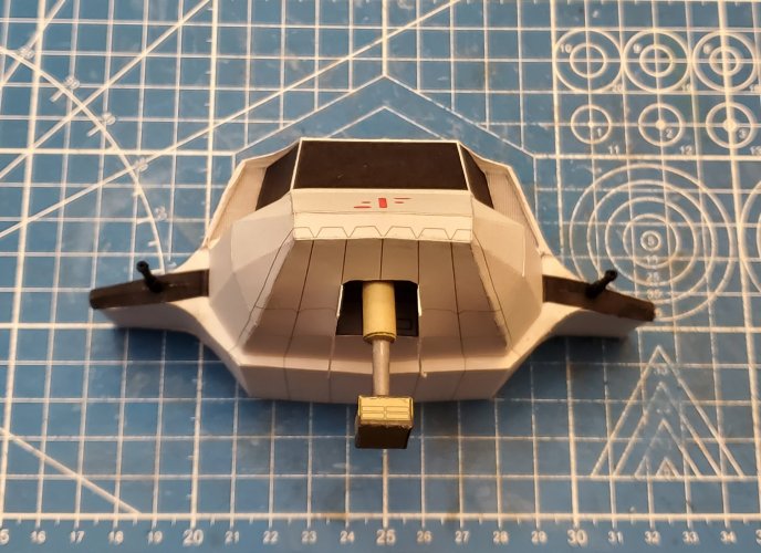

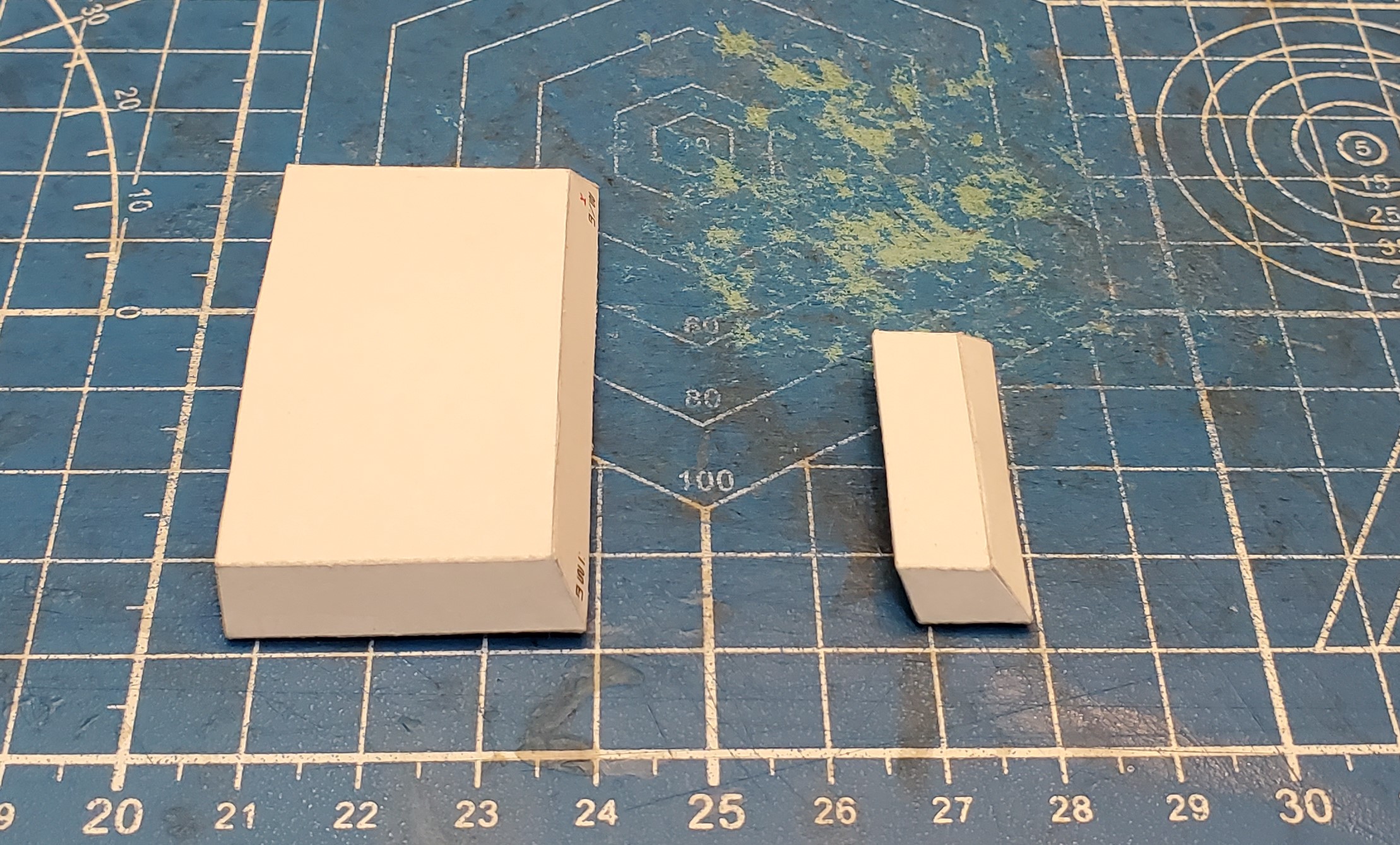

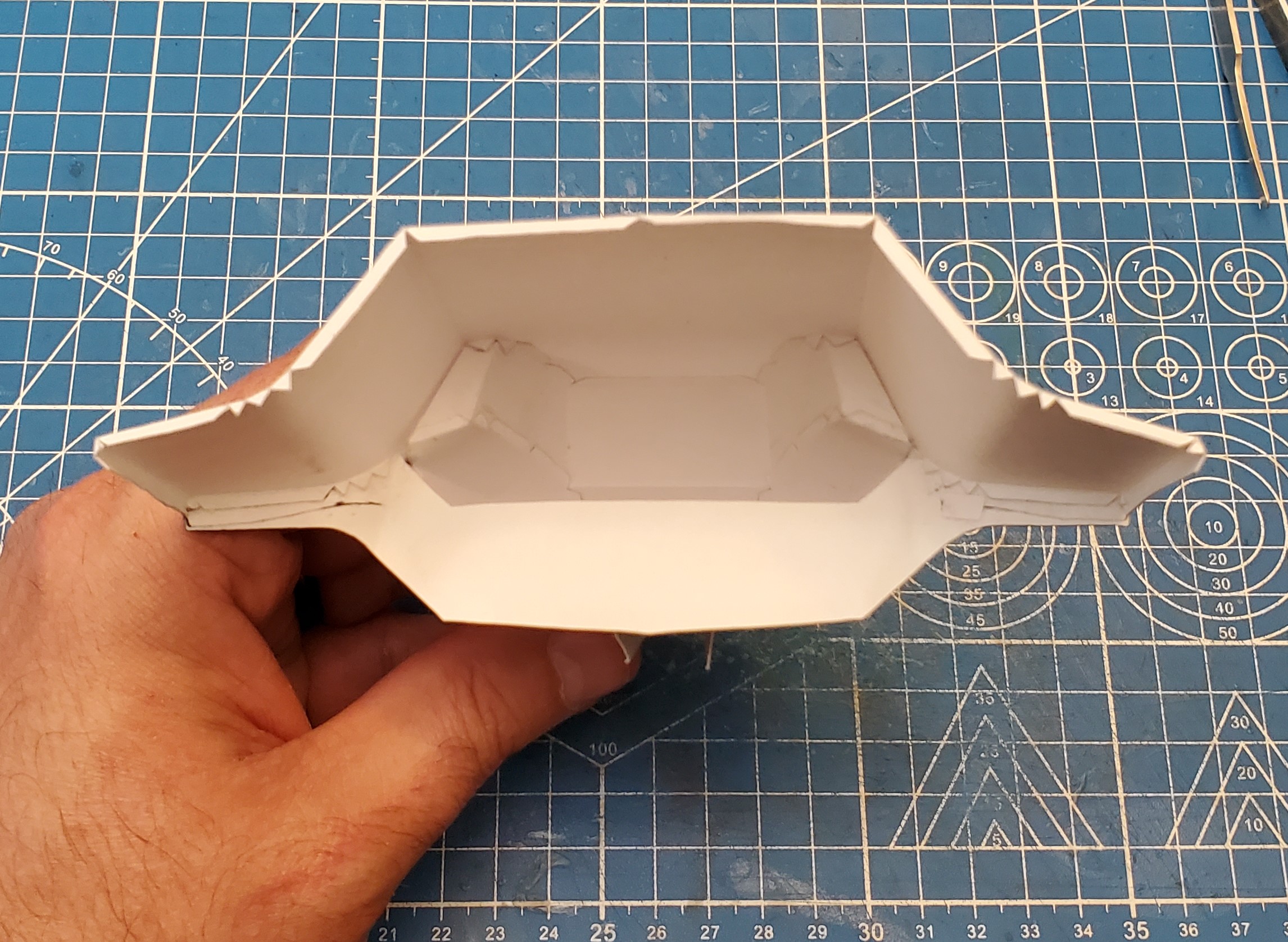

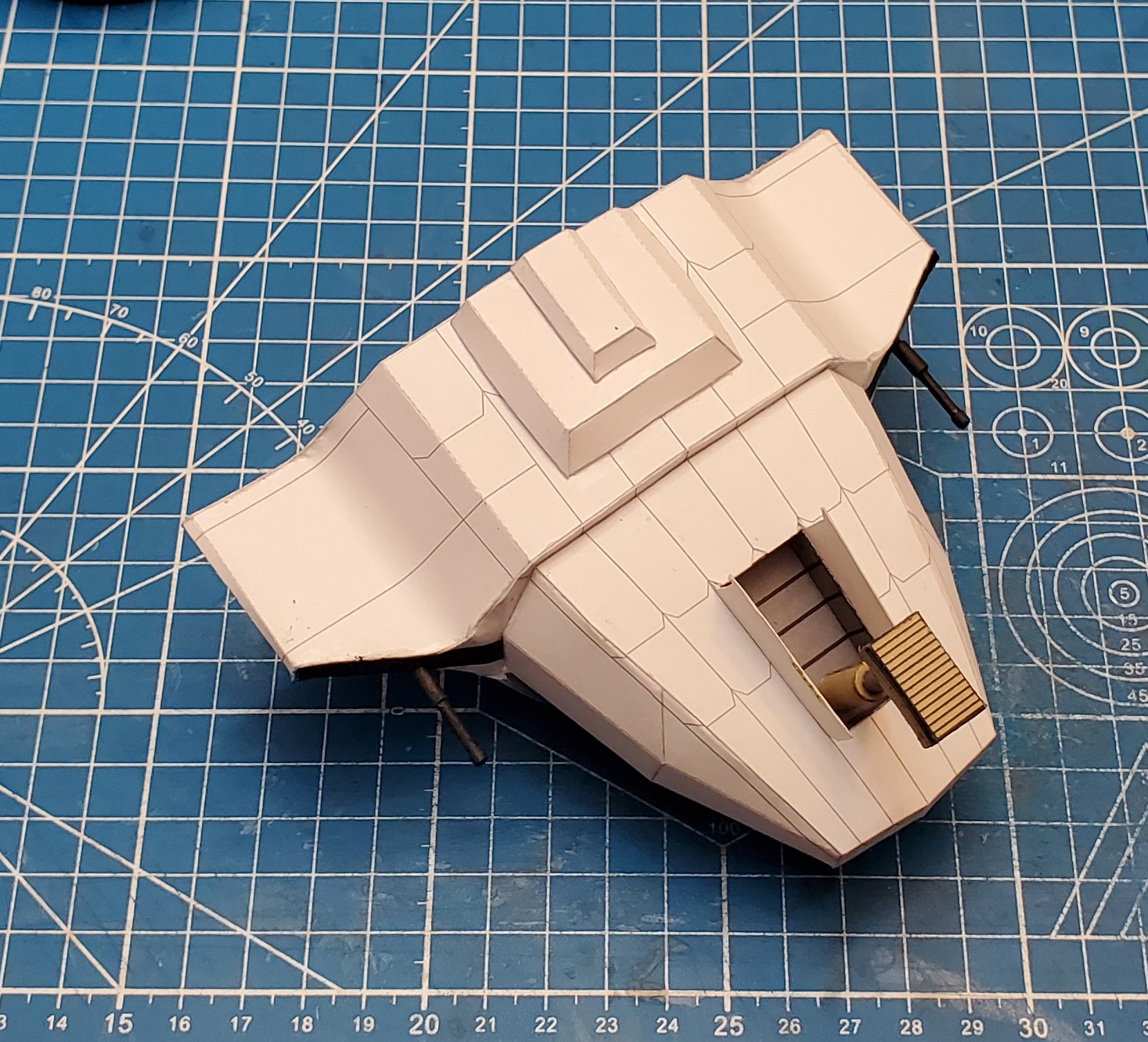

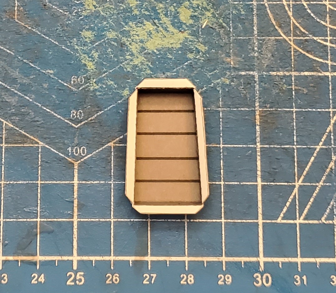

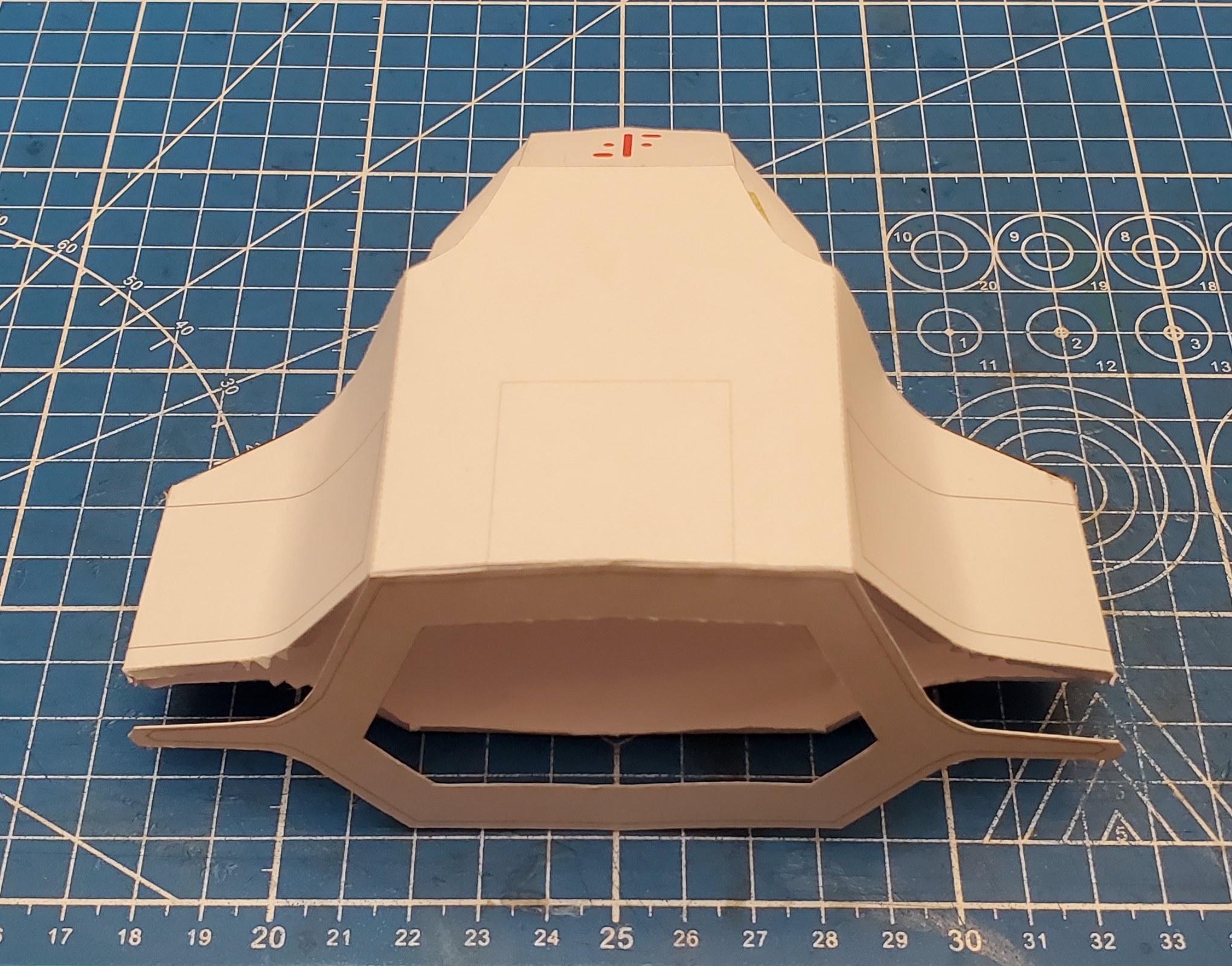

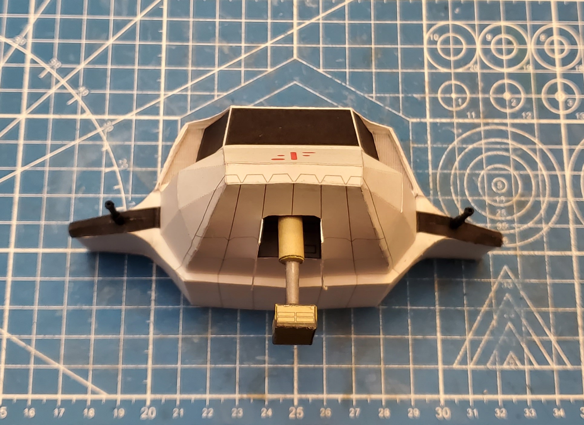

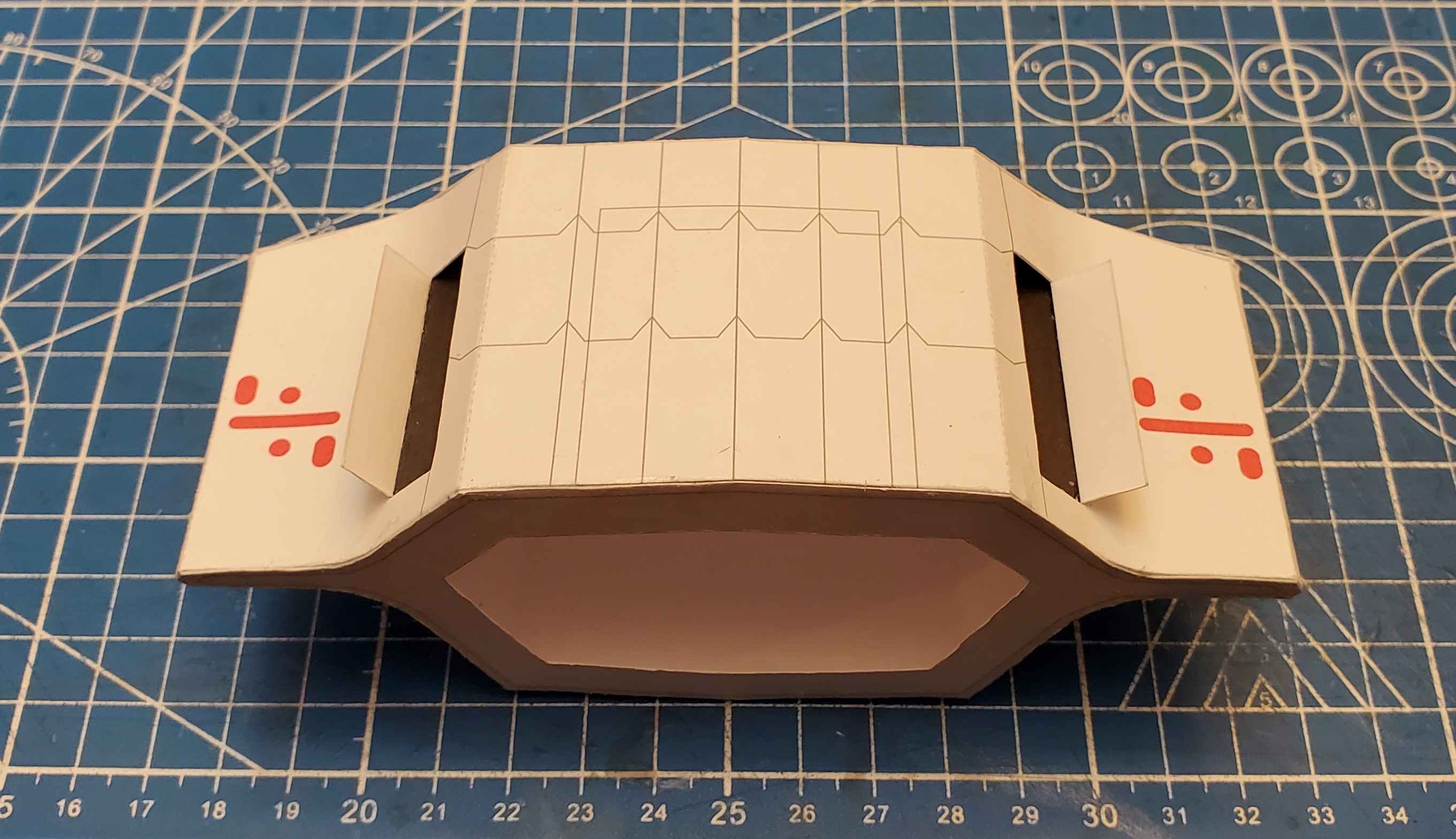

I assembled the landing gear bay.

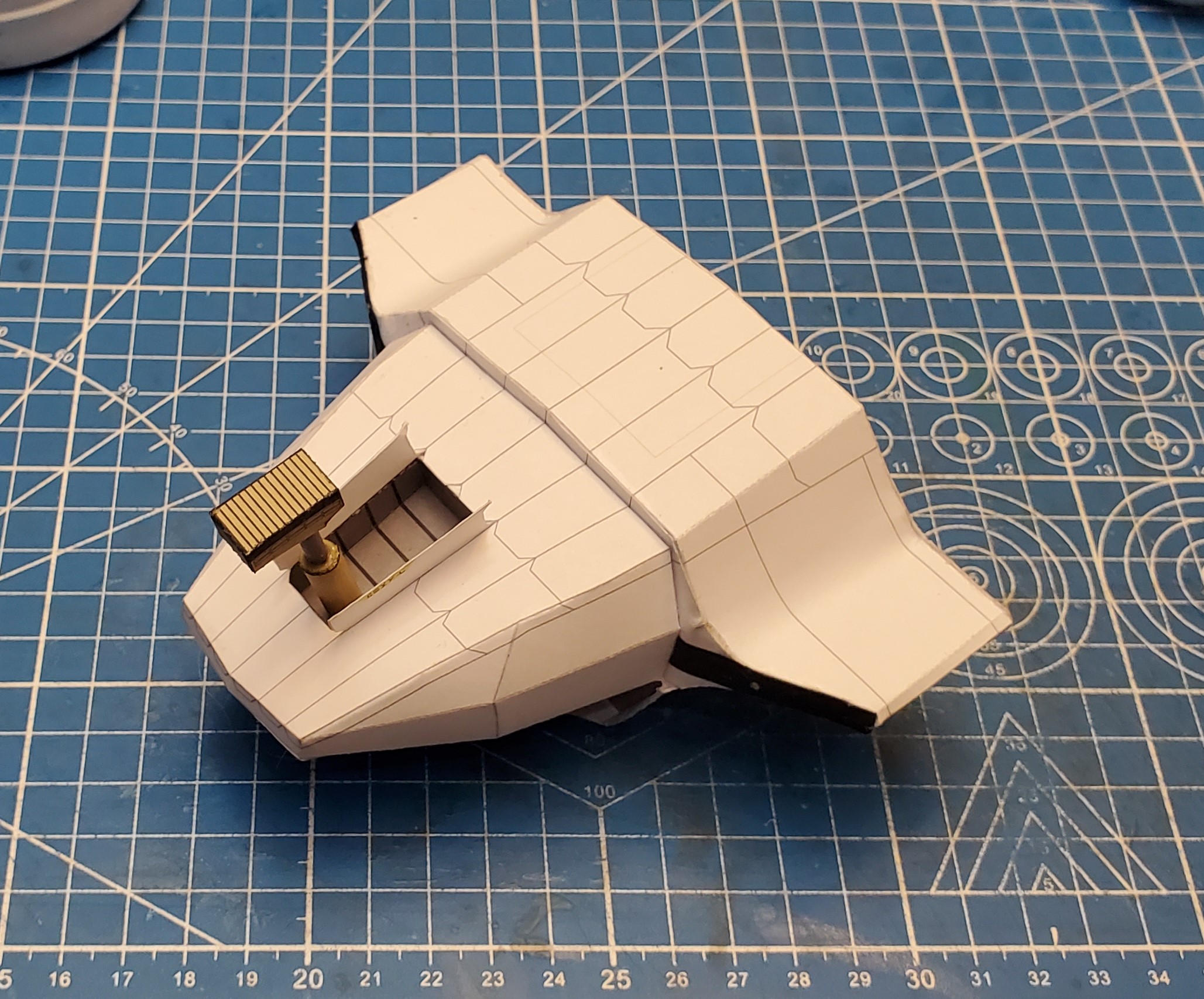

The landing gear bay is attached in place.

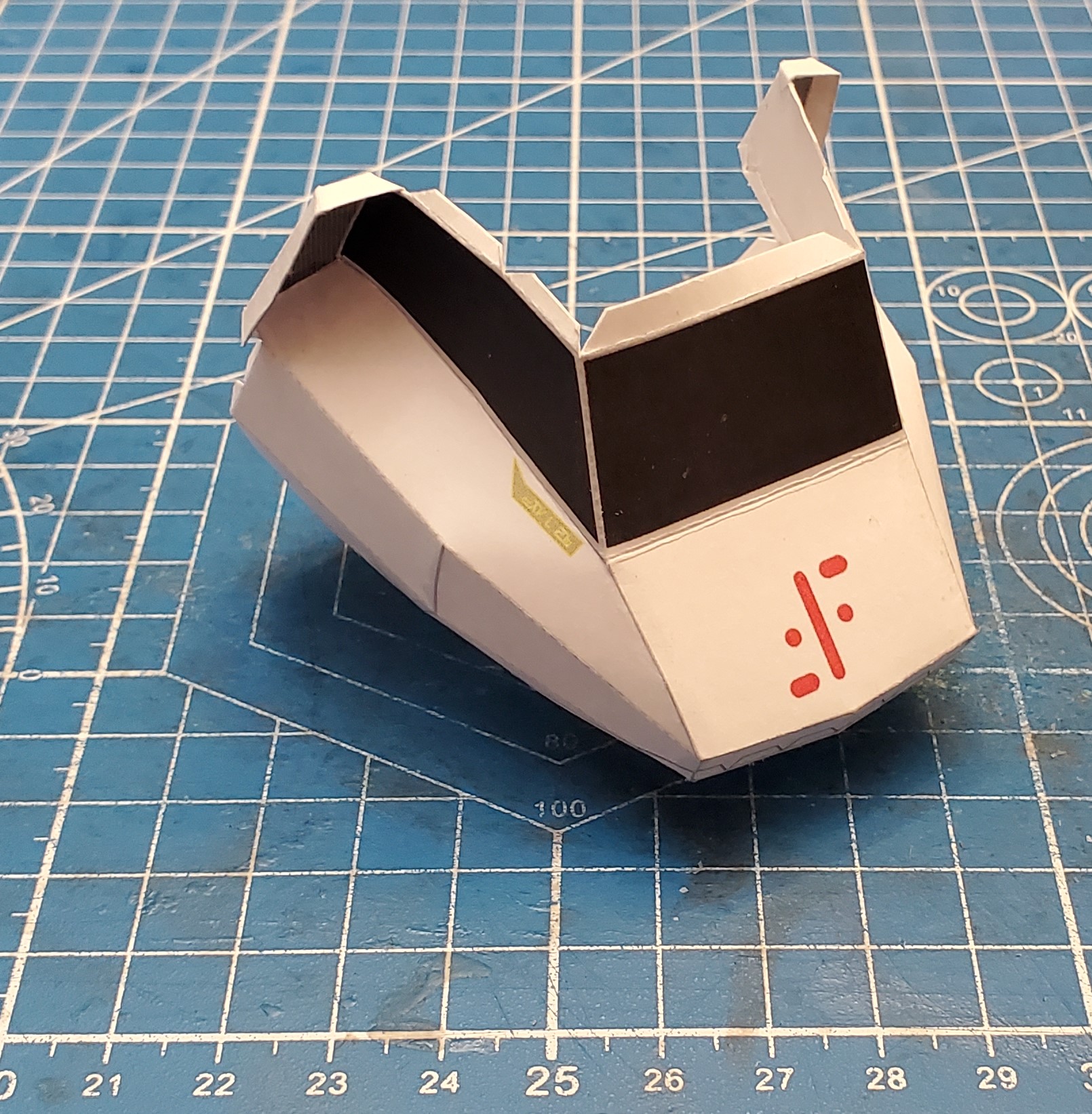

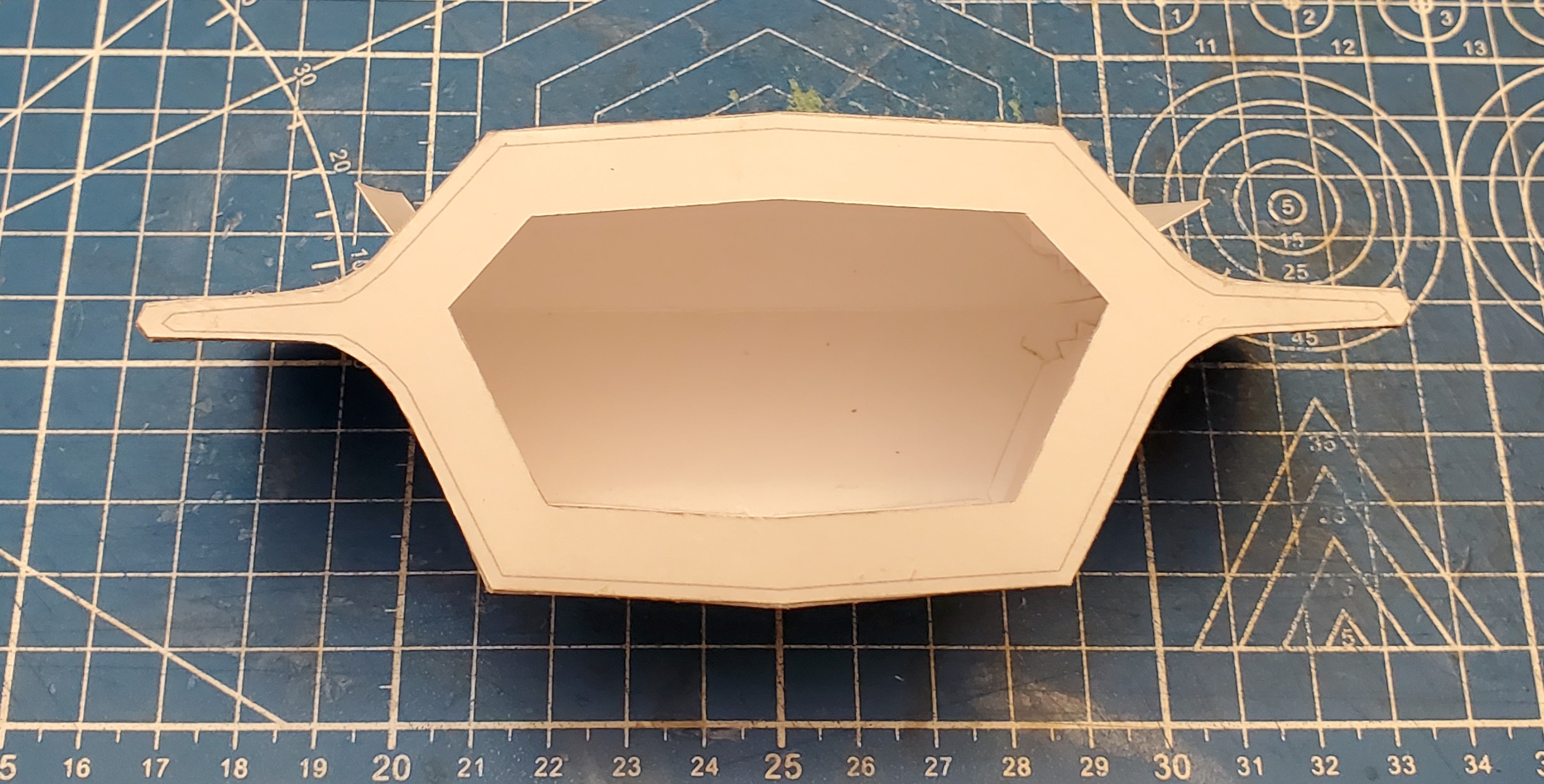

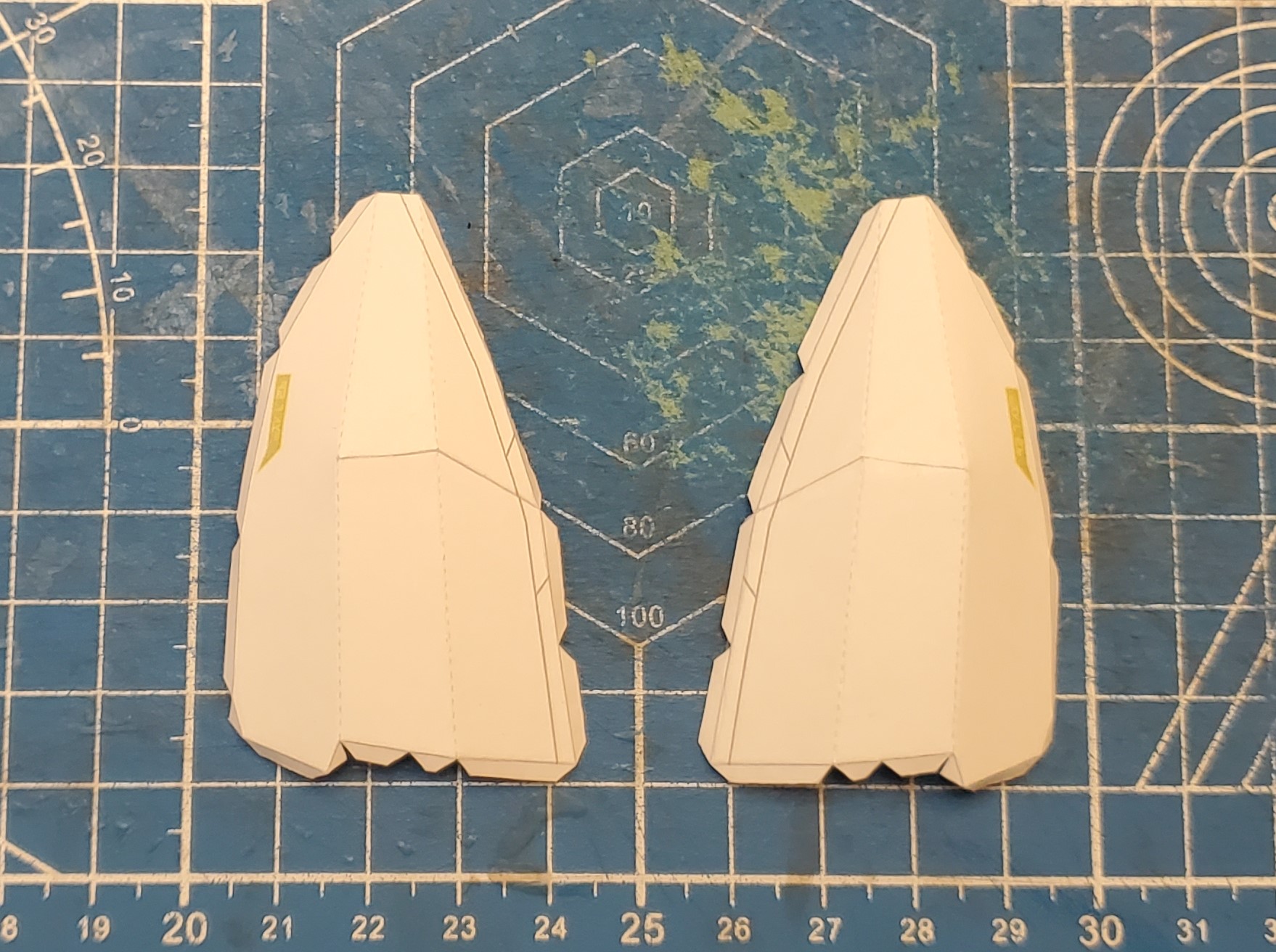

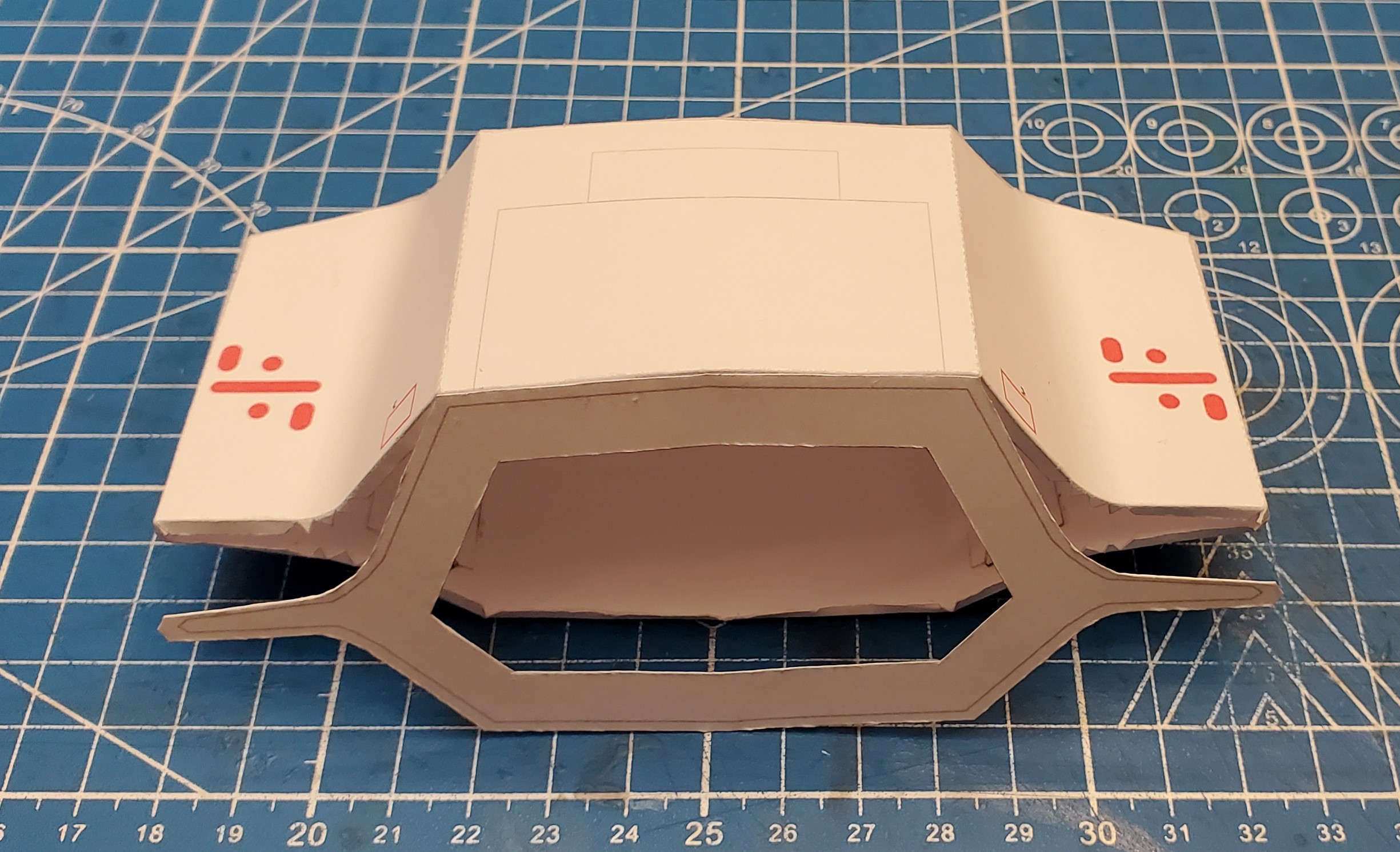

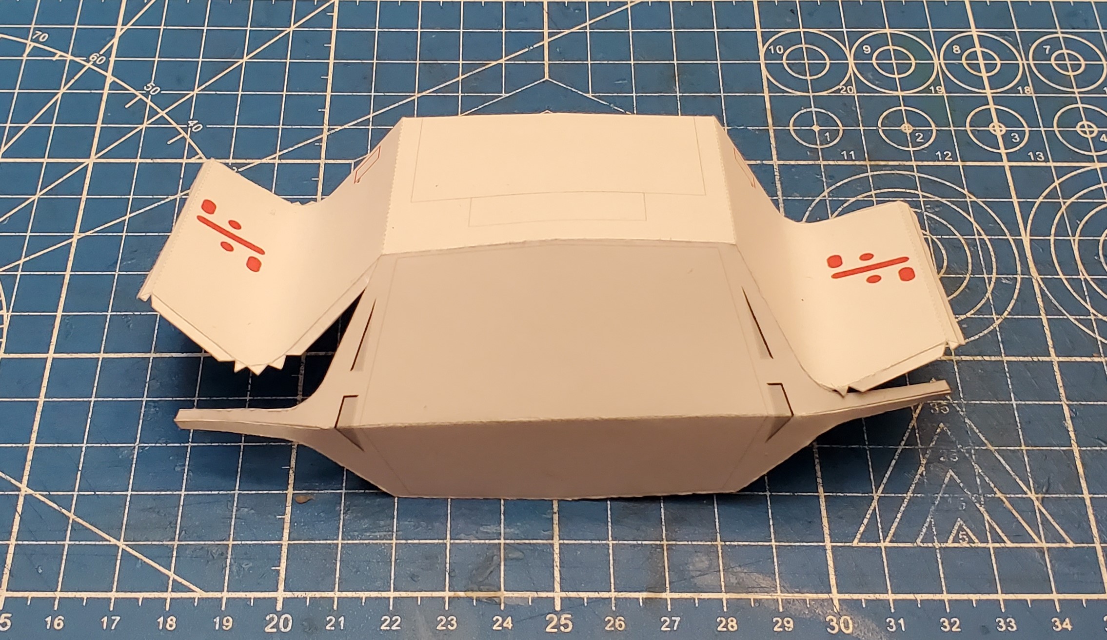

The side pieces for the front section are assembled.
The side pieces are attached to the bottom hull piece.

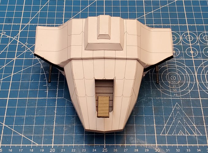

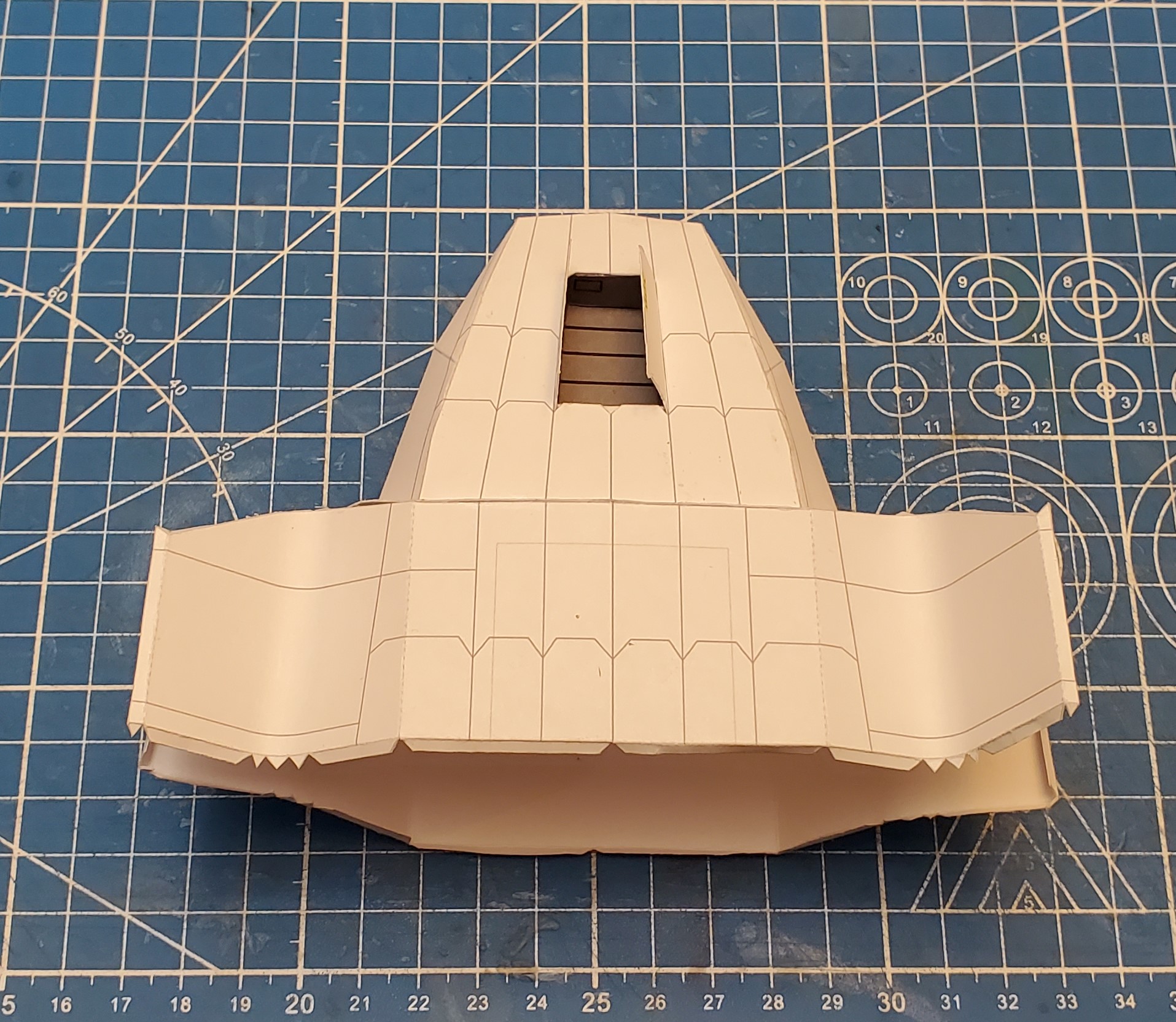

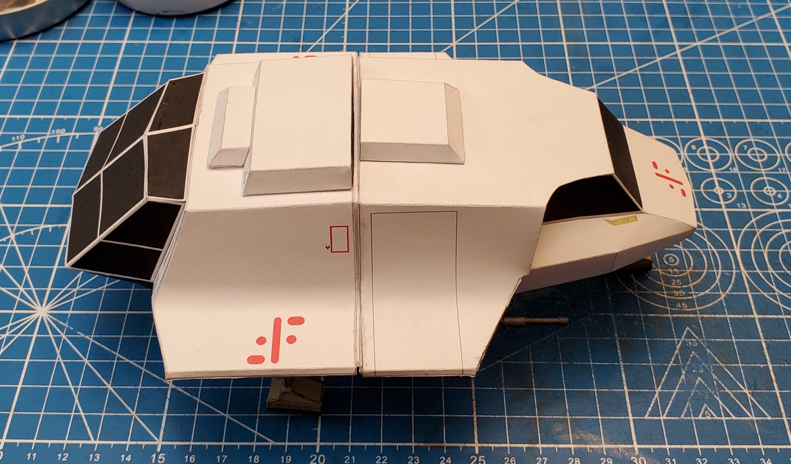

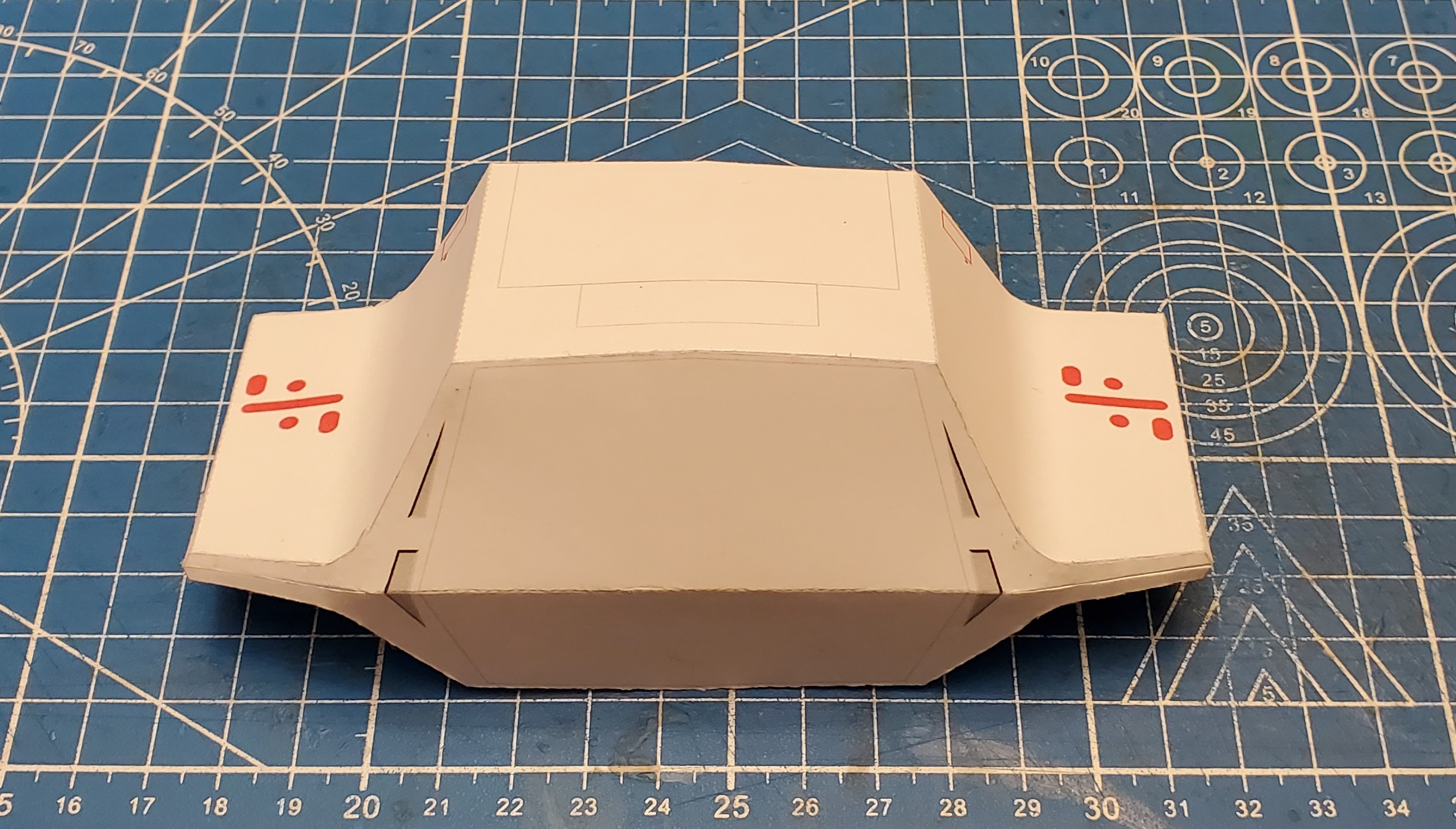

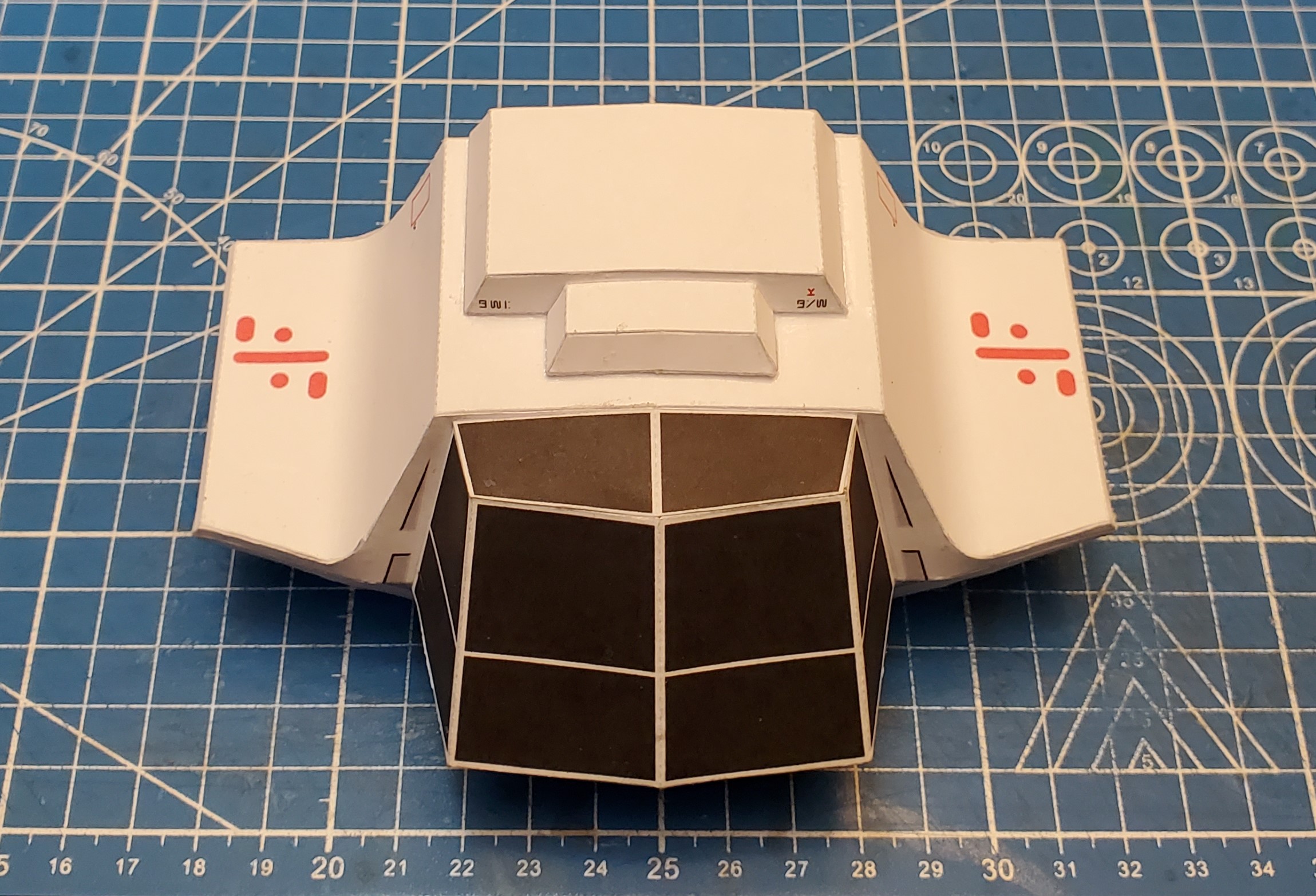

I attached the nose piece.

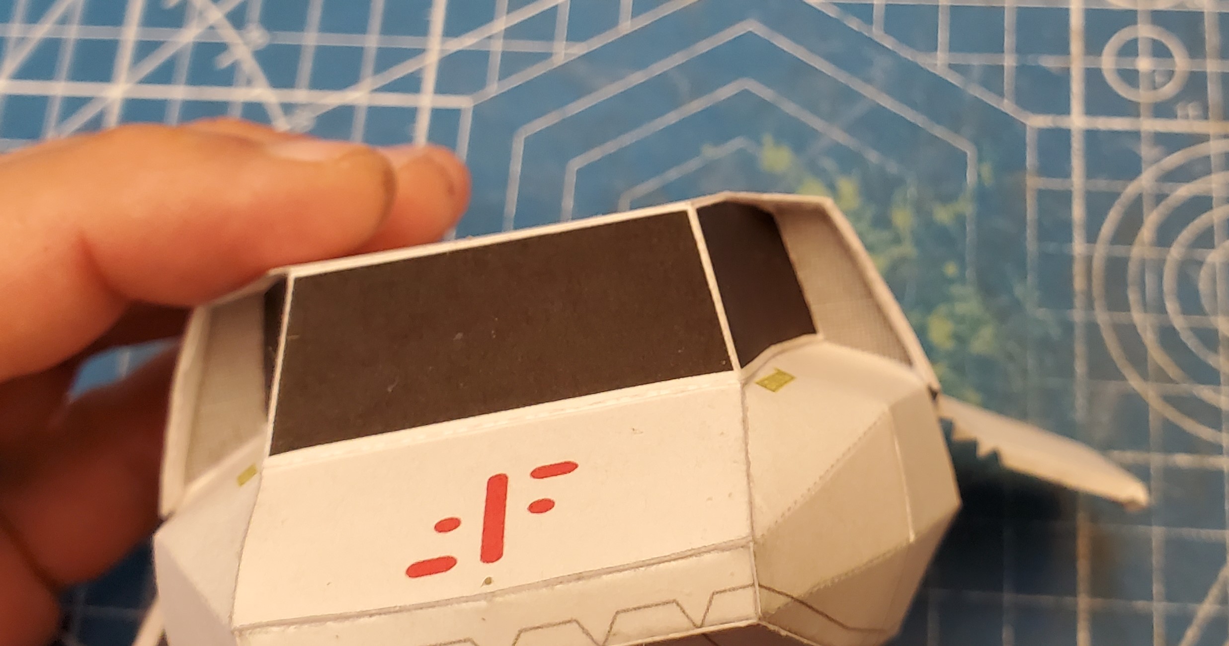

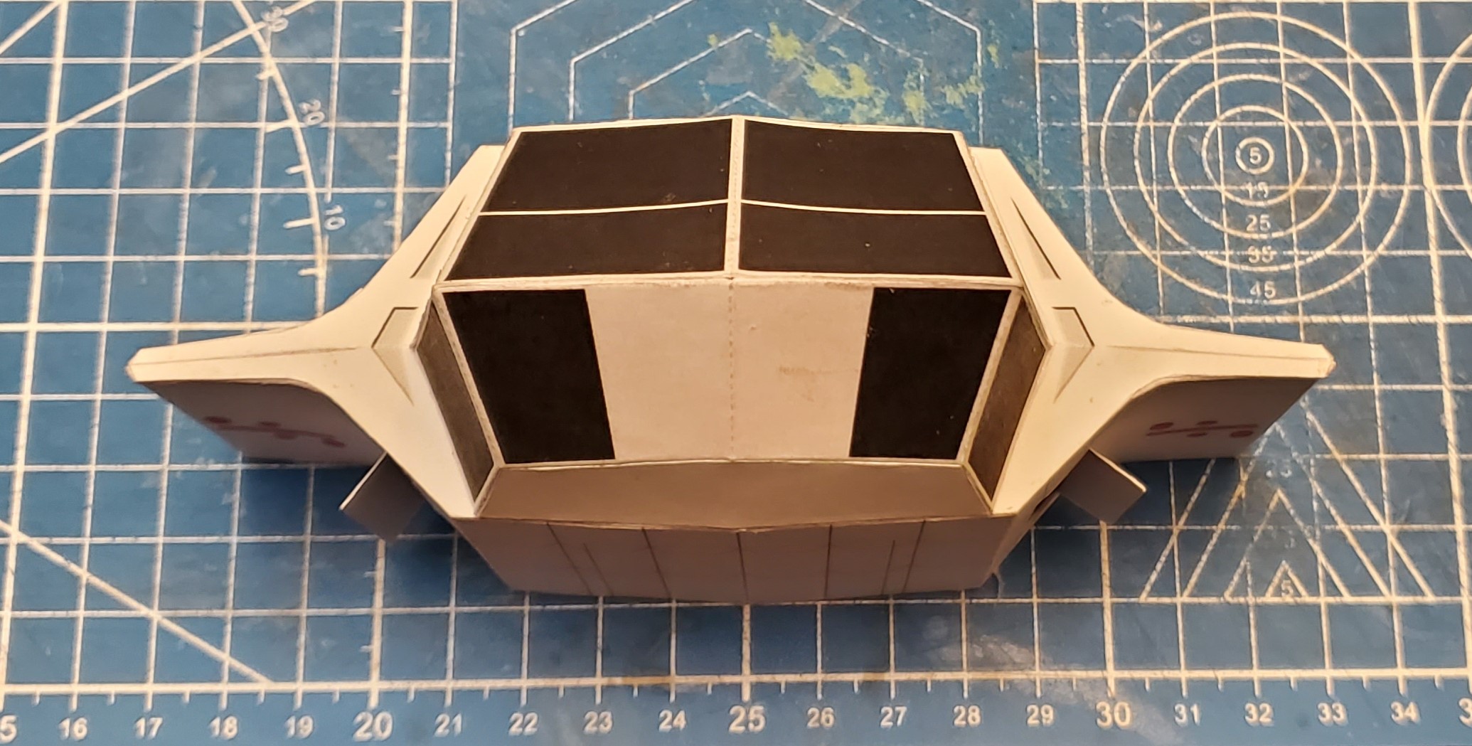

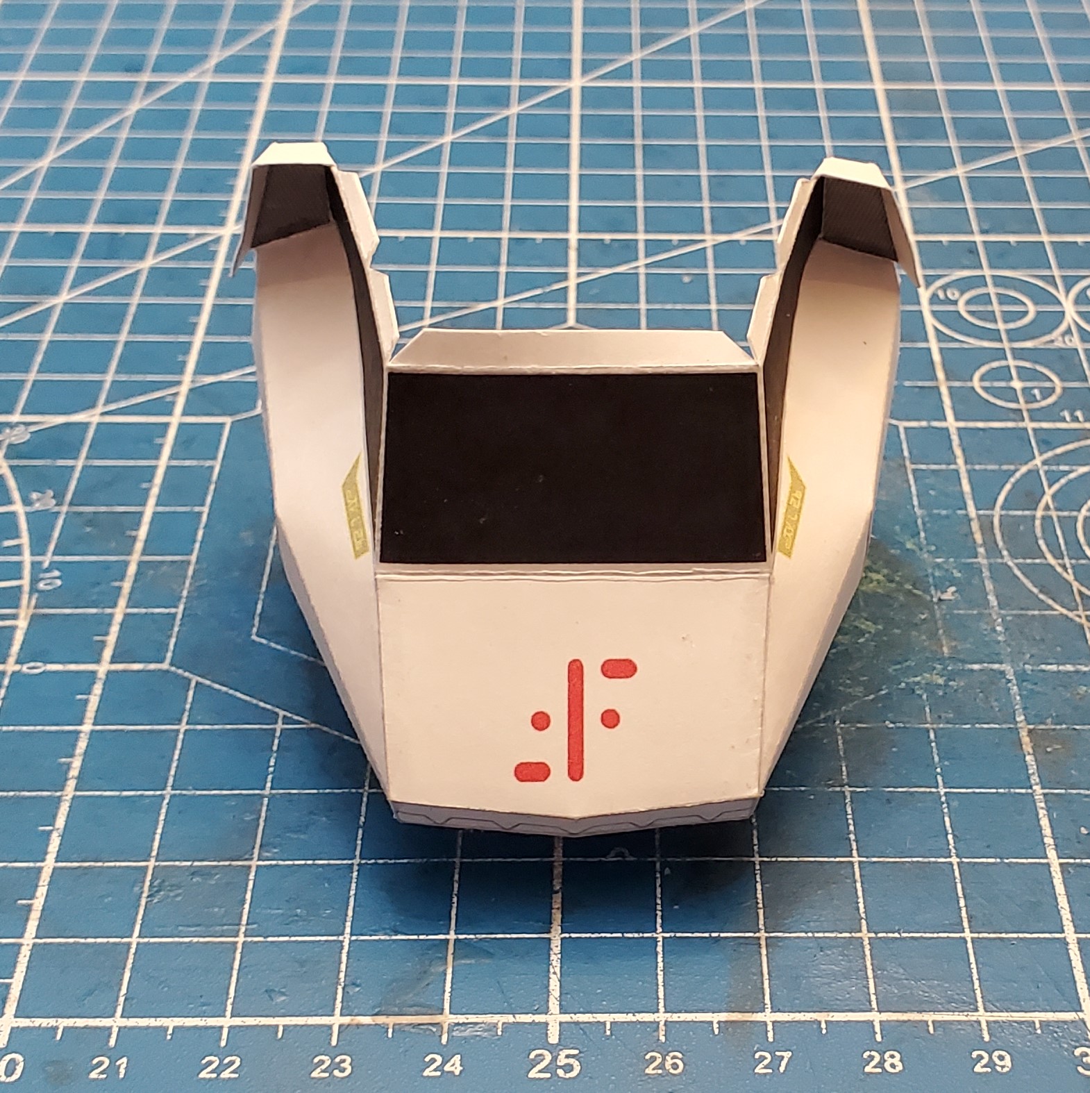

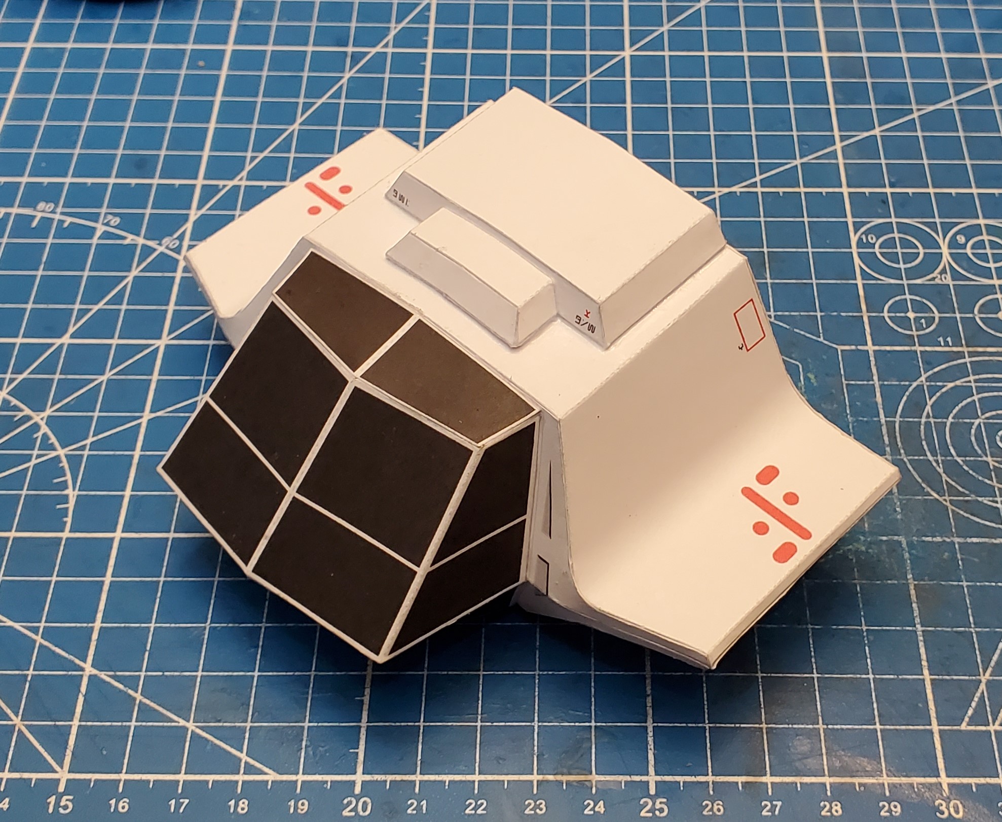

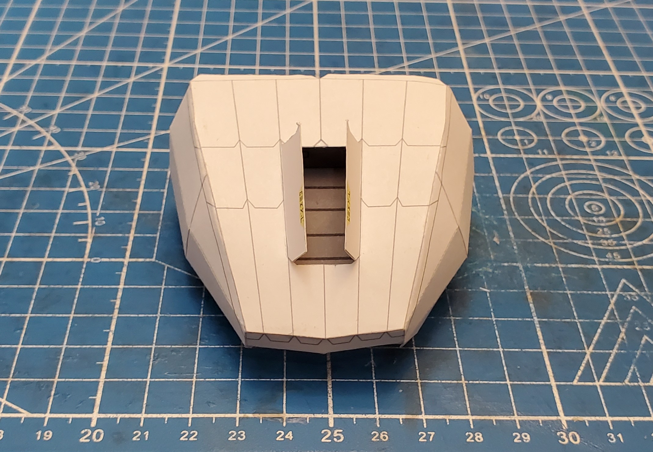

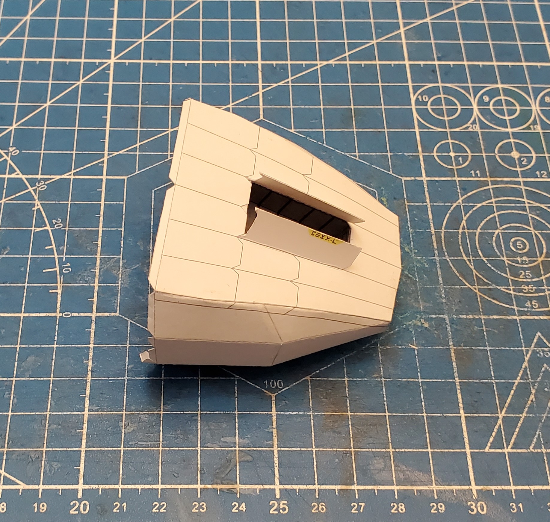

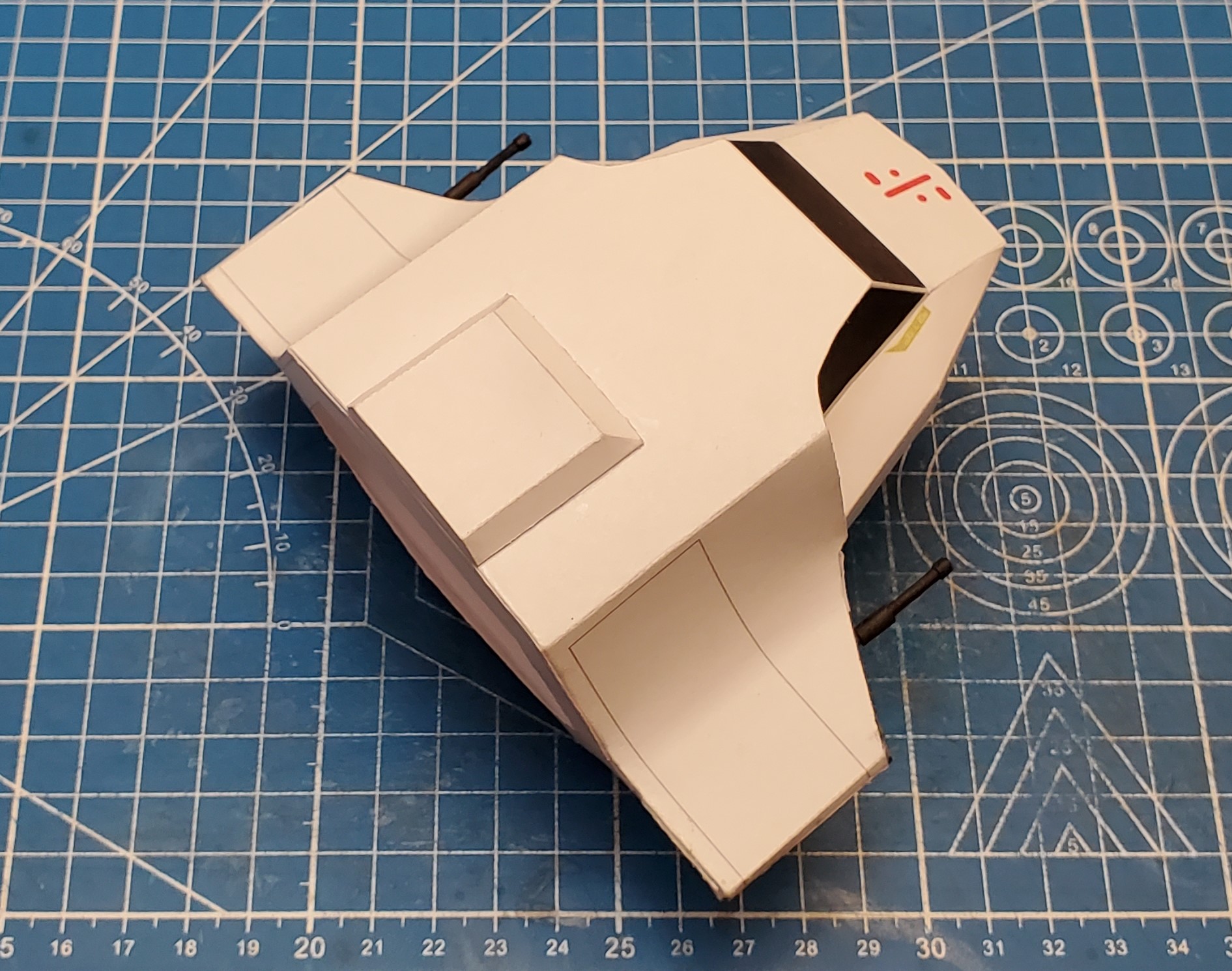

Attaching the windows, intake, and top of the nose. Start with the very front of the nose piece and attach each tab slowly (making certain that the glue and dried enough that it will hold, whilst moving on to the next tab).

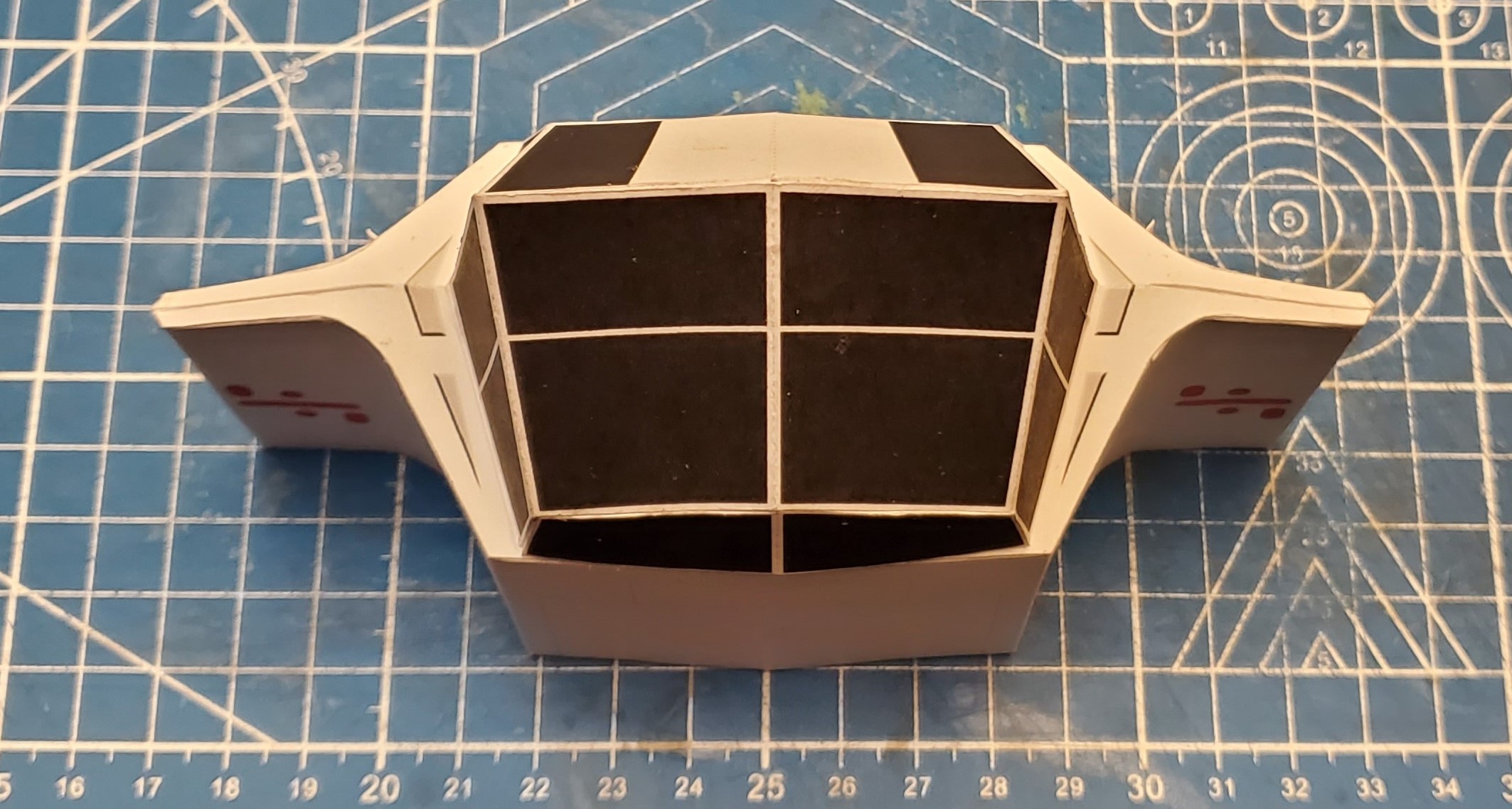

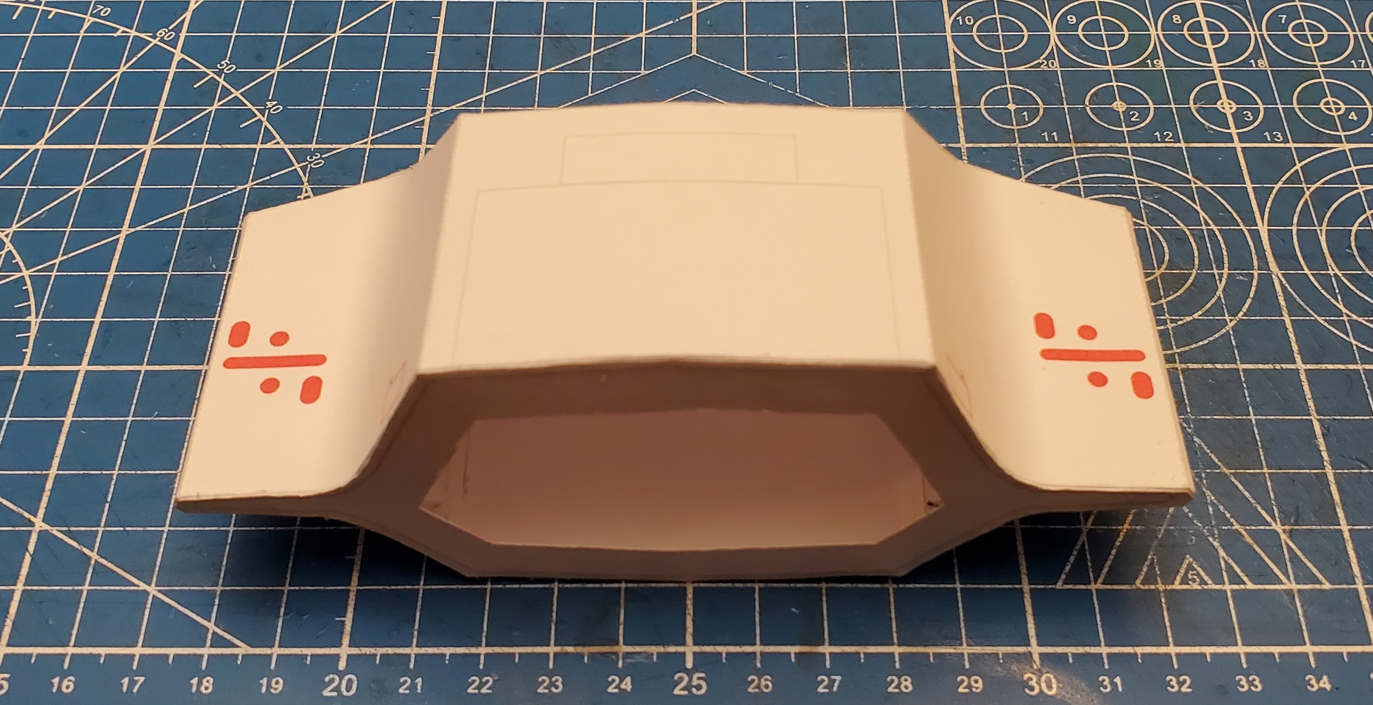

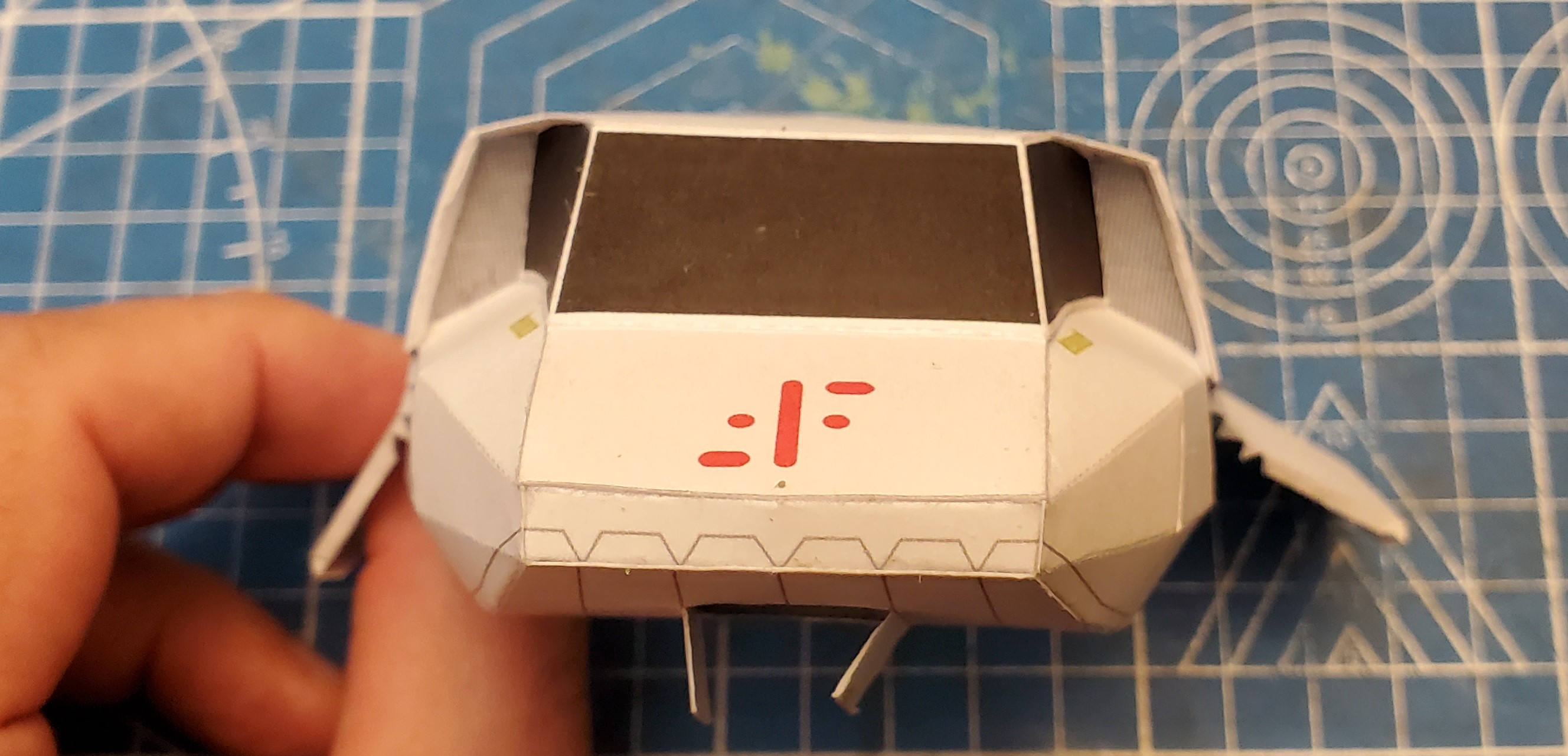

The windows, intake, and top of the nose are now fully attached.
