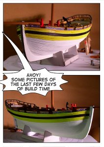

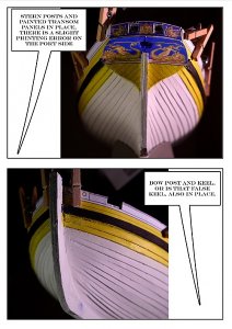

Little bit more progress on the hull front. The gap between covering pieces 6 and 8 was a little dicey but it was clear that the next set of hull parts would fit as intended.
The middle paper covering pieces are printed with the positions for the final planking and the clinker planking was a little nerve racking at first but it came up trumps!
Before anyone asks I have been doing a lot of dry fitting of parts to check dimensions and trying to keep everything the correct distance apart, hence the tiny clothes pegs.
Purists look away I am shamelessly using filler and paint in search of lovely bottom...

Planking; well Le Coureur, the second part of this kit issue is also clinker built. I don't know about the others published by Shipyard. The clinker build technique does have a certain character and a lot of texture.
However, I have to admit I have no idea why these "little" ships were clinker built as opposed to carvel built with flush planks - over to the shipwrights out there.

The register for the port sea monster is off so he almost, but not quite, runs of the edge of the printed area. A very small error and hard to see!

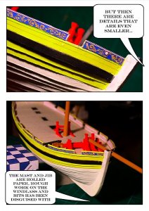

After polishing of the cute fishing cutter Selma and an up scale of Digital Navy's V108 I have returned and have settled down to some fine details before the rigging starts!
Sorry the picture is a bit poor and does not do the subject justice, the big camera has a flat battery... and the comic book presentation will return during the holidays!
Three stages in the making of a cannon...
They are tubes rolled from the parts supplied in the kit, raised detail from 80gsm strips (about 0.5mm wide!) soaked in PVA, dried and turned in the jaws of my Dremel type tool!
Yes, you can turn paper!

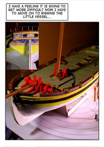

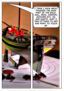

Well I put a bit of work in and thought it was time to pick up the pace.
I ended up spending loads more time than I had intended to on these little chaps.
I might paint them bronze yet. I just don't know if Alert had iron or bronze guns, I suppose the 1770s is far enough in to the Industrial Revolution to warrant iron. (Anyone got the Anatomy of the ship book - Amazon failed me!)
I will do a bit more weathering and see how they go.

The cascabels are plastic tubes with PVA blobs on. Now I have to tart up the gun trucks before trying to rig them on the deck once I finish the fiferails.
Not too sure I would go this way with a frigate or bigger ship. It could eat up a lot of a man's life!

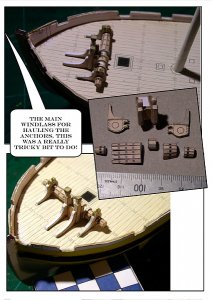

Shipyard do make you think. I would say that the diagrams are only just up to the job of building the windlass and other small subassemblies, but, I may be particularly thick this time of year.

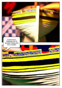

The decorative bulwarks were fiddly but straightforward and very satisfying. I did deviate from the kit parts though, the narrow trimming pieces at the top are home cooked and will be trimmed down rather than kit parts which are too small for me to cut out and manipulate.

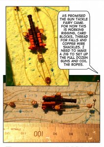

The treat, lets say I have an appointment with the gun tackle fairy...

Trying to stick with card as the primary material is a really dumb thing to do. i am sure some one will make an injection moulded ships block in a variety of sizes. Just cut it of the sprue paint it and use it.
No no no, that's way too easy. Better idea, lets sandwich together a couple of layers of card, drill some holes with a 0.65mm drill, make tiny wire shackles ( I really do not want to count them 3 x 12 guns, 4 x 12 block and tackle, and 4 x 16 for the gun ports).
The card de-laminates... the thread is being dificult and fraying... you know all the usual stuff! I may look for an alternative material for the blocks, probably wood as shown by Jerzy at http://www.boatmodelling.com.
So what do you think?
I still have the thick recoil rope over the cascable to do but a dry run seems to work OK.
