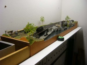

Anyway, I can tell you it IS a pair of flourescent fixtures, the base model you can get from Home Depot or Lowes. Two fixtures with two tubes each, end to end. I'd guess they are between 3' and 4' above the layout. I am not happy with the current distance from the wall...they need to be farther out to avoid some strong shadows. A valance will probably help that also.

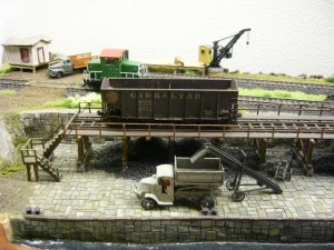

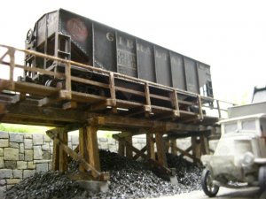

Found these pics while looking for a shot of the lights themselves. The first illustrates the overall lighting look (hard for me to describe because my monitor is wigging out...losing the red color, usually). The next two the difference in shooting from above or below an object, at distance and close up. None of these used flash, all on existing layout lighting as described above.
