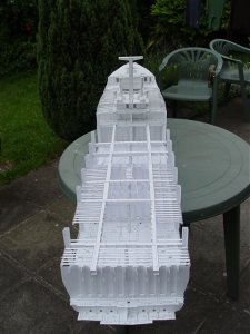

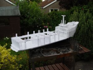

Dont worry I know its card and its a BBQ, but its Ireland...we dont really know what to do with them....
Cheers

What's 3 Years?
Hi John-John,
Not knowing what to do with card models and BBQ's is Ok if you're Irish.
The Irish seem to know what to do with an EU Treaty though...,
Great progress on the SD-14! I'll be tuning in for more...,
+Gil

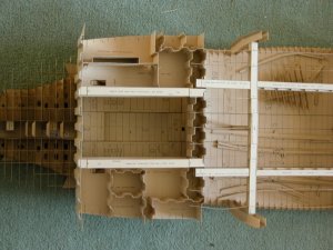

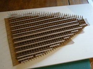

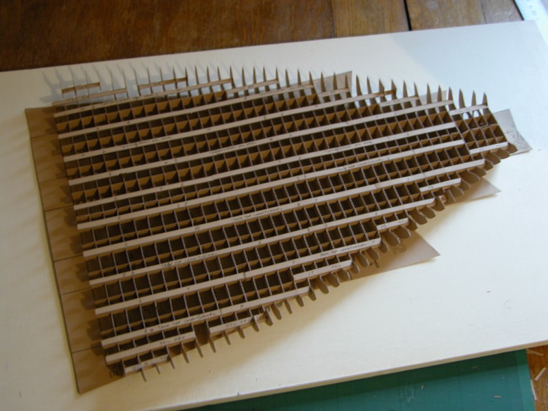

first one is the bow section showing the floors and longitudinal beams that make up the double bottomed Hull and form ballast tanks tank top plates will be put on next.

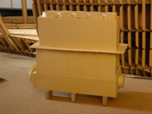

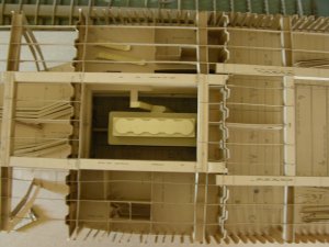

The next picture shows the engine room flats with oil and water tanks on the starboard side and workshops on the port

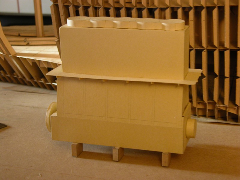

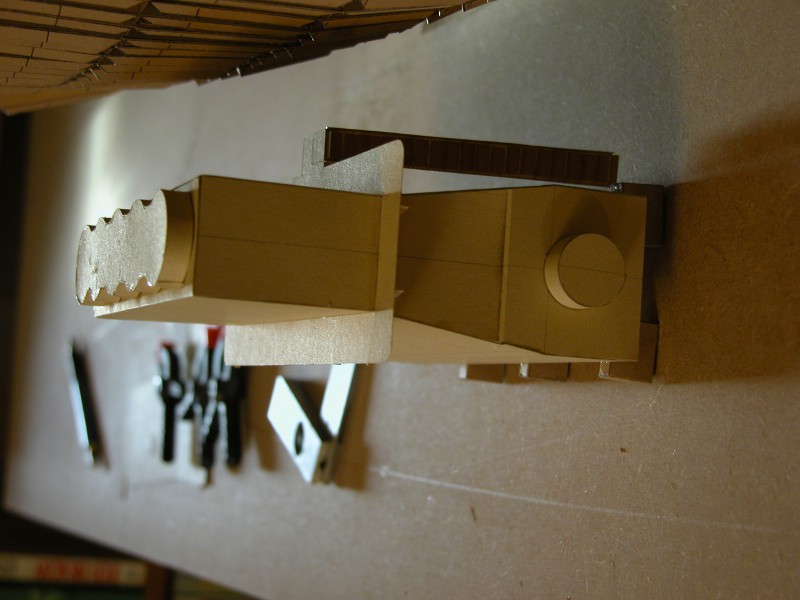

the third is a side view the basic engine. I made to going engine room

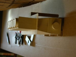

the fourth is in end view of the engine

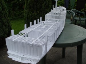

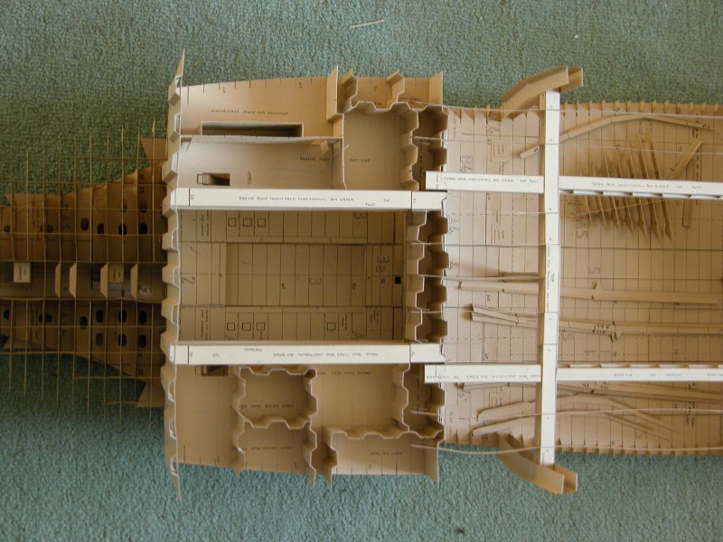

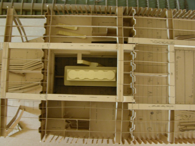

the fifth one is a top view with it in the engine room

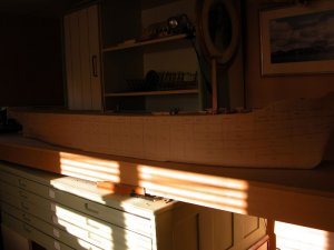

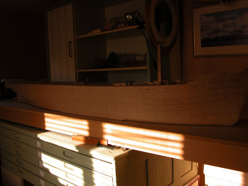

and the six shows the model with the Hull completed and is waiting to be painted . Although I have started on some of the bow deck fittings and the number one hatch and mast

Thanks for uploading the photos - it looks like a really neat construction! If there are as many lightening holes in the frames and longitudinals as in a real v/l then repetitive strain injury must be on the cards?!?! Did you find a way to cut them all out with a dye of some sort perhaps - or was it scalpel blade all the way?
The E/R flats look great with the corrugated bulkheads, very realistic.
Did you make the ladders yourself or are they in the kit?
Brilliant idea with the engine - where did you get the snaps? Is it a Doxford?
And the finished hull David - a real masterpiece!
Would you guesstimate the time taken to date?

Alan I put lightning holes in the longitudinal on the bow section but it made them quite weak, so I didn't do any more. They aren't marked out on the model.
The engine is scratch built and is based on aside elevation from a general arrangement drawing reproduced in John Lingwoods book SD14 the full story which if you haven't got is well worth getting. I got a copy from the local library and then was given a copy. There are ladders included in the kit but I made the ones to go with the engine as the model only builds you the basic steel shell for a British registered ship.as for timescale it is hard to say how long it has taken I started at the end of December2007 and it has been on and off since then and many only at weekends in the winter
