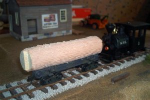

Leafing through a back issue of the NG&SL GAZETTE, I found an article about using "Sculpey", a clay-like material to wrap around dowling, creating "bark" on a log.
I gave it a spin. Here's a shot of a piece after being wrapped and bark detail carved, before baking.
Into The Oven!
Following the directions, the log was baked in a 275 degree (F)
oven for about 25 minutes or so. Once the log came out, the little "fuzzies" from carving could be brushed off. At this point, the log can be cut, carved, sanded, painted, drilled and stained. I stained the log with a base coat of diluted black, trying to get the bark detail to stand out.

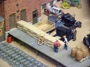

Hi Paul, Here in the US we get Sculpty at craft stores...if you can't find that brand name there are many similar products...just tell them that you want that modeling clay that you bake in the oven.
The Robber Barron is picking up a few sacks of horse feed and Pa and Doofus are discussing who is gonna load his truck.
The feed sacks are made from Sculpty...Didn't have to paint them...they turned "paper brown" when they were baked.

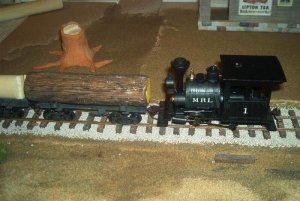

Well,I got kicked off the internet before I could post one last message...I had wanted to know who else had tried this method. According to the article, the next step is to stain the logs with a variety of woody colours. In the second picture, the log is still wet. I found that it took a bit of effort to get the Sculpey to"stick" to the dowling, as it kept trying to unravel. I roughed up the sides with a razor saw to give the dowling a little more texture for the Sculpey to hold on to.
ImaTBF, yes, I did make the stump,too. It had just come out of the oven, and hadn't been painted or stained yet. Thanks for the tip with the mineral oil.
