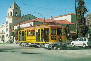

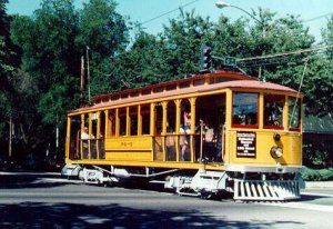

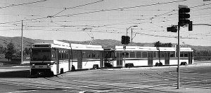

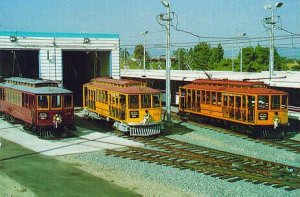

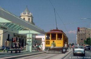

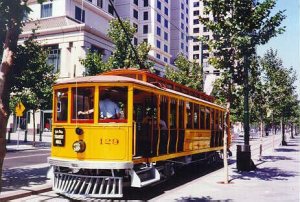

60103: It's just a quickie drawing of overhead cantenary, it's PURELY hypothetical, I just liked the way two-wire looks, and will probably do what's prototypical for SJ when I find correct evidence. ANYBODY HAVE SOME PICS IN THIS REGARD?
Interurban, you're totally correct! :thumb: Thanks everyone! You guys inspire me to work on it! Thanks!
:thumb: Good news the overhead is just one trolly wire even for the bow type pantograph of the new fleet.
These are all I have on my CD.
Enjoy:thumb:
