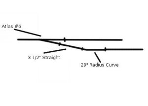

Hi,
Below is a picture of a curve to a parallel track. I'm asking for opinions considering the s-curve in it. Equipment is geeps, 40' & 50' cars.
Thanks

In so many cases, layouts don't have enough room to adequately handle large radius curves, so we are restricted to what doesn't always look good. That in mind, does it work? YES- keep it NO-try to go to a bigger radius, if possible.
If it isn't installed yet, tack it down on foam or cork, and see if your locos can handle it. The cost of sectional track is not so high that something like this can be tested, off layout, before it is installed.
I have several curves similar to this in my switching yard.
All come off of radius curves that will not allow for
anything but slower speeds to enter.
The biggest problem I have encountered is the
binding I will sometimes get on some of my
rolling stock. this can be fixed with some modifications.
You are doing just fine. Heck, I have s curves,
u curves a few g curves and a T curve. :D
Just kidding. Lay it down and see what happens.
Best=it works fine.
Worst=pull up the pins and try something different! :rolleyes:
Russell
A number 6 crossover will work out to about 2" straight and a 46" curve when you substitute for one of the switches. I use a 3" straight and a 32" curve and that works good.

Another question came to my mind. I have aimed for the straight section between curves to be as long as possible, that makes the curves in the end sharper, right? But which is better considering the s-curves effect, longer straight or gentler curves?

It depends on what the "S" curve leads into. If that is a second mainline diverging from one (like the Keddie WYE on the W.P.), make the curve as gentile as possible. If it is a passing siding, the key is that it should fit the entire train on the siding without fowling the main on either end. Whether the siding is straight or curved makes no difference, so if you can curve it and ease the "S" curve, do it. If it is an entrance to an industry, and you are going to use only 40-50 foot cars and gp type loicomotives, it will work fine. You are not going to go through it at high speed anyway.
