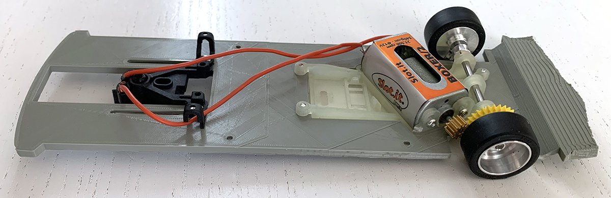

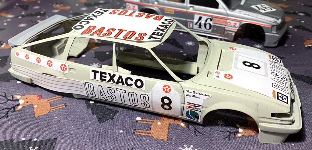

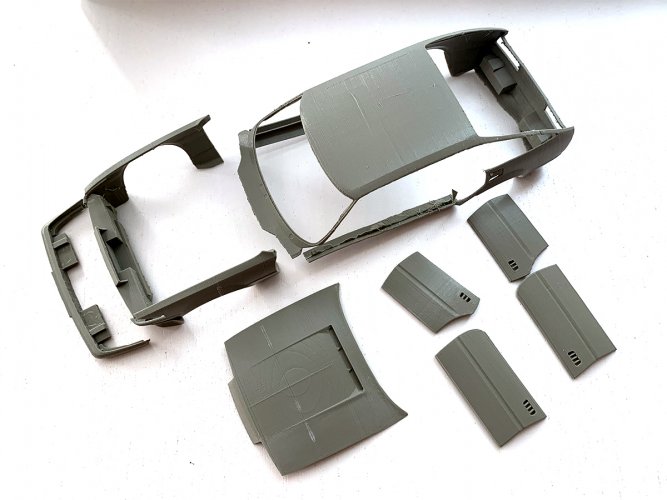

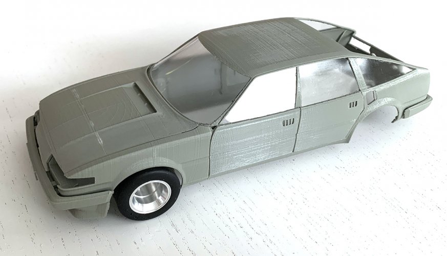

I am 3d printig Rover Vitesse. It is slot car in 1:24 scale. Here are some pictures of a prototype 3d print which is used for testing durability and driving properties of the model.
I was wery affraid of a durability of the body for slot racing. Bumps and desloting hapens a lot. But after few test rides, and one crash test, the car is up and running nicely. During the crash test only the hood and fenders cracked. I was wery surprised, because I expected the car will brake to hunderd pieces. I have reinforced the parts but did not perform another crash test, because i was wery nervous fist time and do not want to life through that again
. The car withstand normal racing colisions and situations without problem.

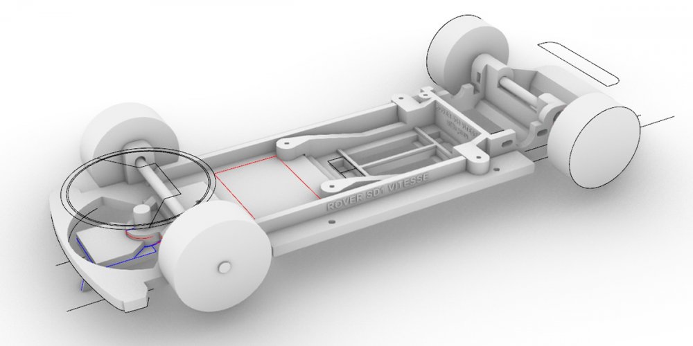

Chassis is adjusted from 1:32 scale just for test purposes. I am working on final chassis with 1:24 parts:
My goal is to make detailed nice looking car as true to original as possible, but with acceptable driving properties. Maybe It will not be the winner (hopefully yes
), but will not be last and will be nicest car on the track for sure
